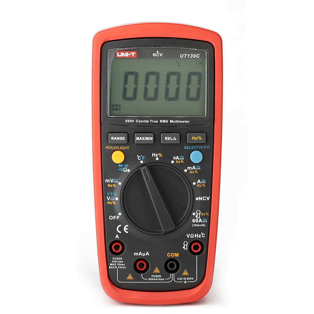

        The UT139C has better mix of features.
        It's a 6000 count multimeter and it can measure capacitance, frequency and temperature.. and it also comes with a temperature probe in the package.
        The UT139A is only 2000count and the UT139B is 4000 count and they don't come with the temperature probe in package.
        I wouldn't get the UT39 simply because of the older style with manual ranging.
        The 139 series is a newer one with a more modern "chipset" which is perfectly fine for beginners and repair shops etc
        Here's a good video review for 139C : https://www.youtube.com/watch?v=3KP1pB4JdGw
        This model was also thoroughly reviewed and discussed on the EEVBlog forum: http://www.eevblog.com/forum/testgea...available-now/
        You can find it at lots of eBay sellers or at stores like DX.com or DinoDirect.com and maybe banggood or whatever is popular these days
        dx : http://www.dx.com/p/uni-t-ut139c-2-6...7#.WPH693klEeM
        bg: http://www.banggood.com/UNI-T-UT139C...p-1020193.html
        ps. Note that Uni-T often used different "chipsets" in the same series of multimeters ... for example UT61E is the only one in the UT61 series that uses a 22000 count Cyrustek chip. Since the number of counts is different between UT139A, UT139B and UT139C ... that's probably the same deal (or the counts are artificially limited by the microcontroller inside the meter)
        The UT139c is worth the money.

          Re: Multimeter Replacement
          Thanks, yes, in fact it's DX I was looking at... since there's quite a selection.
          Will go for the UT139C then mulțumesc!
          EDIT: Found it 7 Euros cheaper on ebay, so the saved money will go for some thin needle style probes.

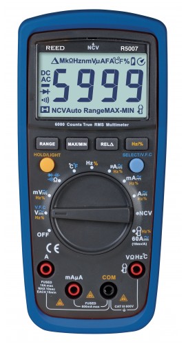

                  I really love this one:
                  http://www.reedinstruments.com/produ...tal-multimeter
                  3v diode test and good capacitance range
                  "Capacitance
                  Range 9.999nF, 99.99nF to 999.9uF, 9.999 to 99.99mF"
                  And I can get it for you for 109$CAD
                        Originally posted by Icitte
                        Reed, like many "tool" manufacturers such as Southwire, MasterCraft (Candian Tire), Extech, Klein, UEI, etc get some Chinese multimeter rebranded in their corporate colors and logos.
                        In this case, the above Reed meter is a really a Uni-T UT139C.
                        You can often get the original Uni-T at a cheaper price. It is going for under $50 CDN + free shipping on ebay. That is, half the price of the Reed.
                          OMG you are so right!!

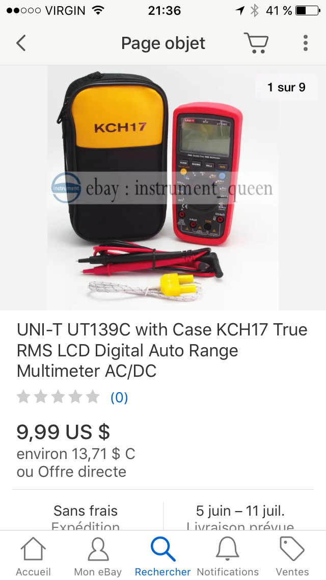

                            That particular one you are looking at is a SCAM. I wrote about just after I posted my thread. See
                            http://www.eevblog.com/forum/buysell...cheap-on-eaby/
                            $50 CDN is the going price for a Uni-T UT139C, not $10 USD.
                              good, thanks a lot for the info
