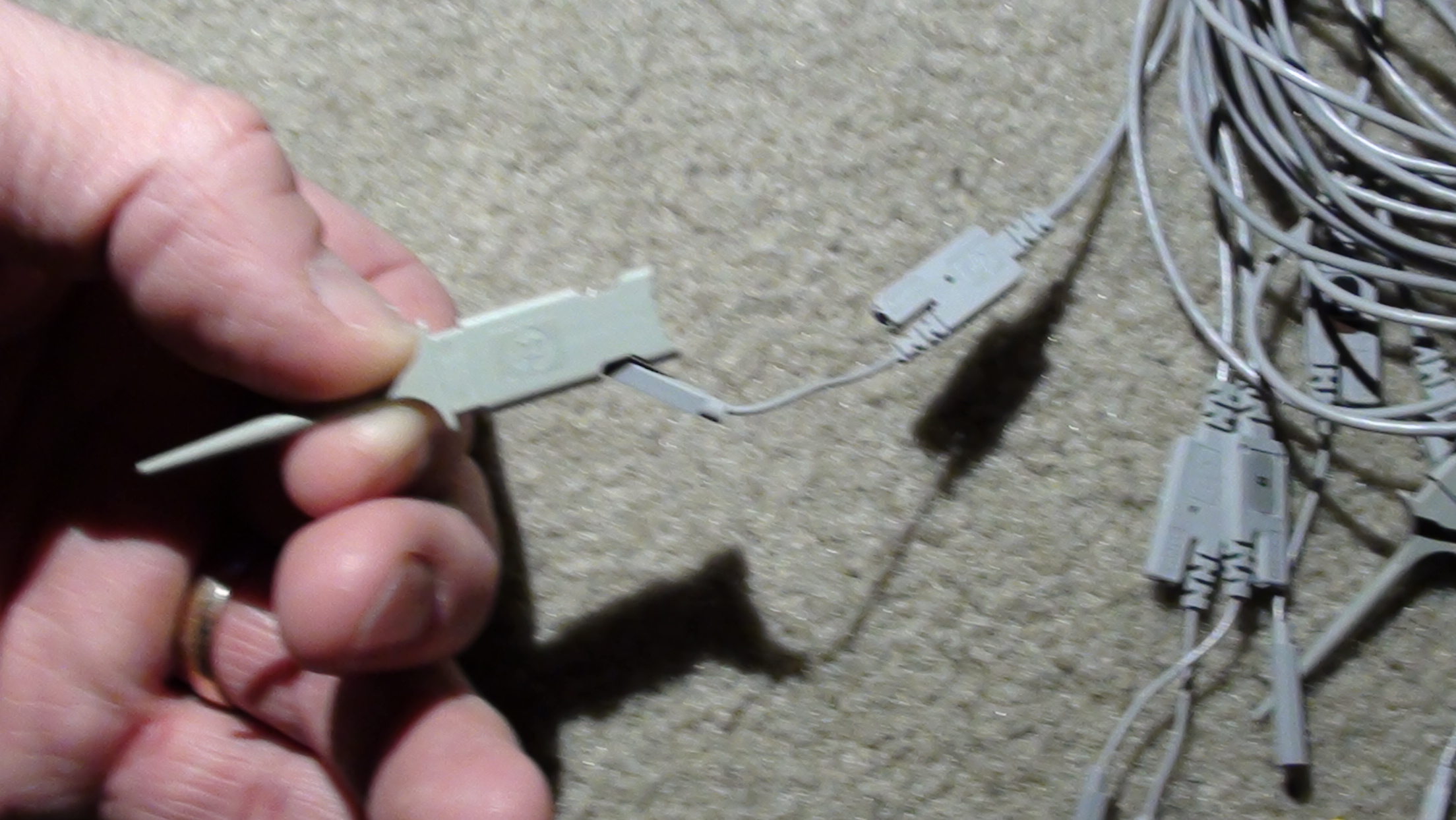

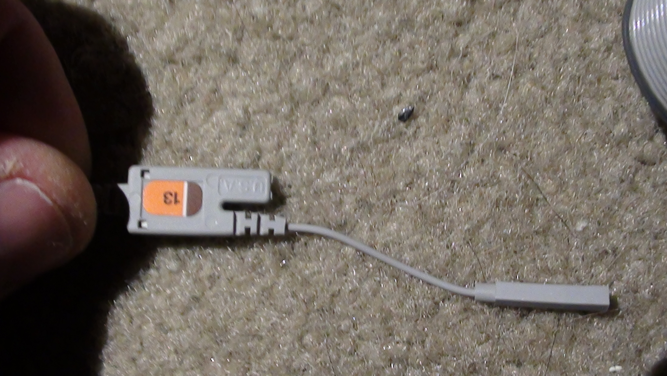

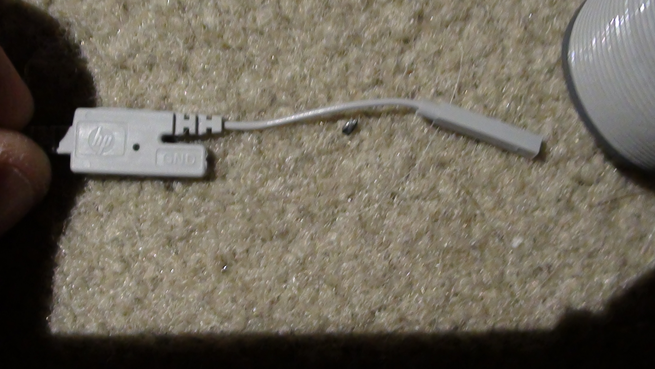

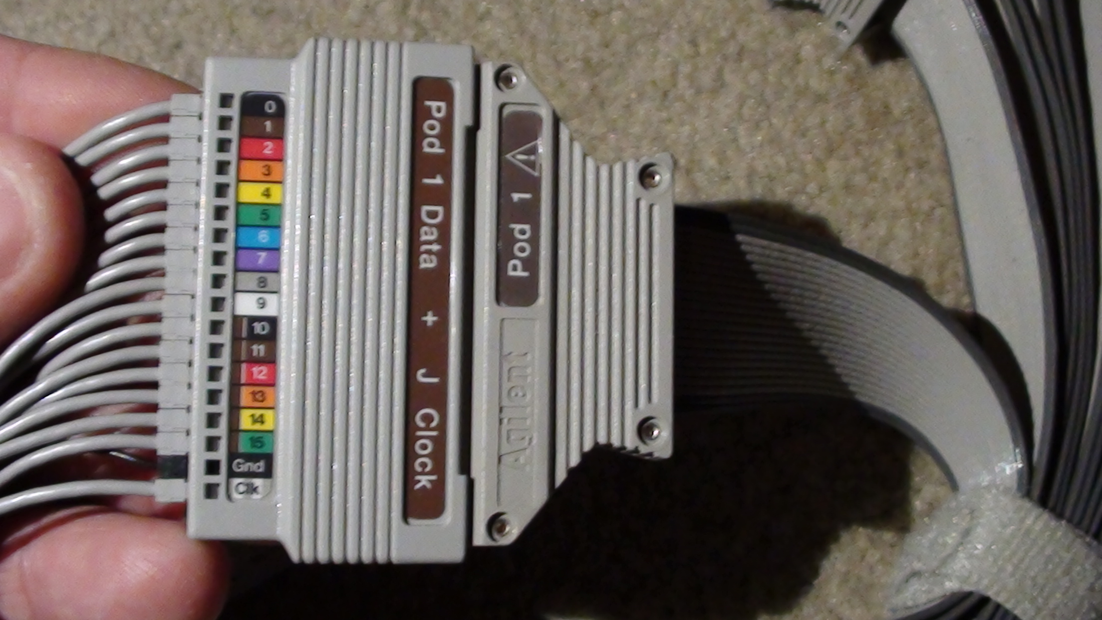

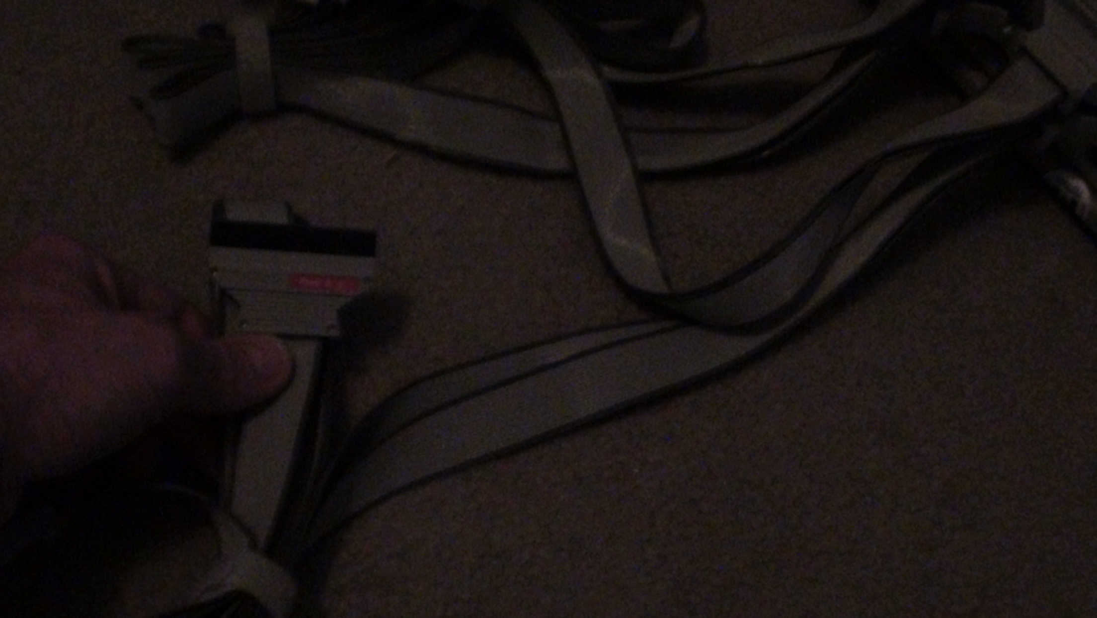

    Here's some pictures, sorry they're so dark.
    The first is what I call a probe but I might be wrong. The pod hooks into that.
    The 2nd is the pod being hooked in.
    The 3rd is one of the various connectors that come off the pod. This is where I'm getting confused.
    The 4th is the other side of the same connector.
    The 5th is with one of the grabbers hooked up. What the heck is the GND used for in the 3rd picture?

      Re: Help with an HP / Agilent / Keysight 16702B and 16717A
      Page 13:
      When connecting logic analyzer probes to the device under test:
      1. Attach the logic analyzer probes to the device under test in a way that
      keeps logically-related channels together.
      2. Be sure to ground each pod.
      You can try using just that one common GND and see.
        Originally posted by budm
        Page 13:
        I tried that when I was trying to read the data coming and going from the EEPROM. The module I have allows me to use the device under test's clock signal or use an independent clock signal. Tomorrow, I'll try hooking it all back up again but selecting the independent clock signal, so I can see if there's data or not. I'll also maybe try with a push button or something.
        Now, the mode I had it in, it said it needed the second pod. But I didn't have anything hooked up to it. I'm not sure what that was all about. I'm pretty certain I configured it correctly, but I still have to verify a few things. I'll play around with maybe a push button and make sure I got the hang of it before I try throwing it on the EEPROM again.
        Thanks Budm!
          It's been a while since I used one of those, but I believe you need to unassign/remove the second pod from your configuration data. I think if you have two pods assigned to the same logic group,I don't remember what it's actually called, it will only recognize the clock coming from one of the pods.
          Don't forget you need to make sure your logic levels are set correctly for the device under test.
            Srhofmann,
            Thank you for your advice. I tried removing the second pod from the configuration and that's when it said it was required for the timing mode that I had. I will try again with different configurations.
            I have the datasheet for the EEPROM ( http://www.datasheetspdf.com/PDF/25Q16BSIG/865306/1 ). There's a Click to Download PDF file link but it's a bit hidden there. In the preview window of the datasheet, it's off to the right a bit.
            Anyway, for the logic levels, I tried two things. I saw the chip was getting around 3.320VDC, so the first time, I picked the option that said 3.3V (1.65V). But after reading through the datasheet, I thought maybe that was incorrect. I saw on page 27 (I believe) this little chart:
              Even with the scope, there's nothing on the SCLK. I even verified the scope was working by using the test probe / calibration part of it. I get a square wave on the test probe / calibration hook but nothing on the SCLK pin.
              I'm going to copy and paste this into the TV subforum where I've been working so people know. But until I get that clock pulse, I don't think there's anything I can do with the logic analyzer....
