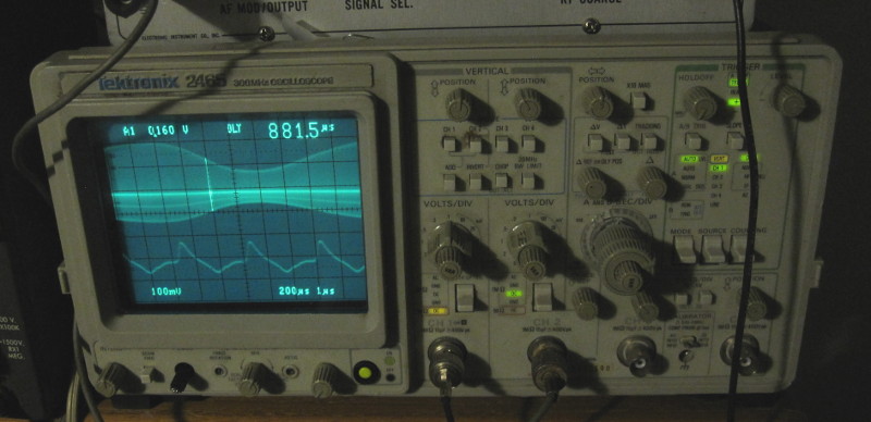

    I'm debating whether I should build a small low frequency DDS sig gen, or perhaps even get a calibrated sig gen instead of using the Eico 320 and 324 that I have for radio experiments... They do work, but look at this carrier wave (from my Eico 324, AM internal audio oscillator modulation of its radio frequency oscillator):
    This does work for radio (AM radios can clearly pick it up, and even FM radios depending on detector), alas amplitude is not stable nor is the shape of the wave, as can be seen...
    The envelope of the RF is also supposed to be a sine wave and you can see that the up slope is slower than the down slope; good enough for testing but that's a very distorted sine wave...
