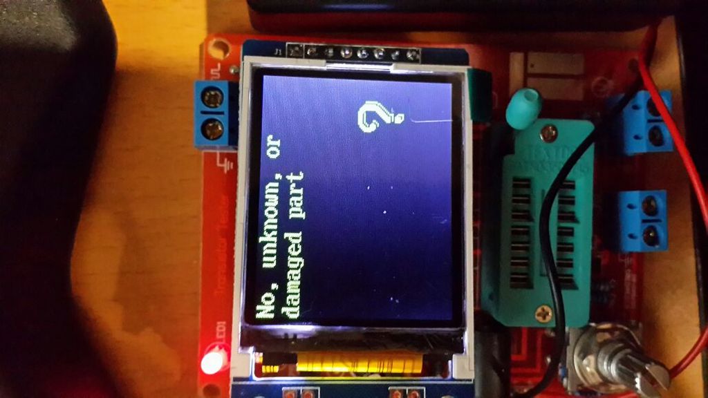

    sjt thanks again and thanks for posting the manual
    Code:
    C:\Program Files (x86)\Arduino\hardware\tools\avr\bin>avrdude -C ../etc/avrdude.
    conf -c avrisp -P COM3 -b 19200 -p m328p -U flash:w:TransistorTester.hex \-U eep
    rom:w:TransistorTester.eep \-U lfuse:w:0xf7:m \-U hfuse:w:0xd9:m \-U efuse:w:0xf
    c:m
    avrdude: AVR device initialized and ready to accept instructions
    Reading | ################################################## | 100% 0.04s
    avrdude: Device signature = 0x1e950f
    avrdude: NOTE: "flash" memory has been specified, an erase cycle will be perform
    ed
             To disable this feature, specify the -D option.
    avrdude: erasing chip
    avrdude: reading input file "TransistorTester.hex"
    avrdude: input file TransistorTester.hex auto detected as Intel Hex
    avrdude: writing flash (29952 bytes):
    Writing | ################################################## | 100% 32.94s
    avrdude: 29952 bytes of flash written
    avrdude: verifying flash memory against TransistorTester.hex:
    avrdude: load data flash data from input file TransistorTester.hex:
    avrdude: input file TransistorTester.hex contains 29952 bytes
    avrdude: reading on-chip flash data:
    Reading | ################################################## | 100% 18.59s
    avrdude: verifying ...
    avrdude: 29952 bytes of flash verified
    avrdude: safemode: Fuses OK (H:07, E:D9, L:62)
    avrdude done.  Thank you.
    Inserted it into the tester socket and same blank LCD so I tryed to redo the fuses
    Code:
    conf -c avrisp -P COM3 -b 19200 -p m328p -U lfuse:w:0xf7:m
    avrdude: reading input file "0xf7"
    avrdude: writing lfuse (1 bytes):
    Writing | ################################################## | 100% 0.03s
    avrdude: 1 bytes of lfuse written
    avrdude: verifying lfuse memory against 0xf7:
    avrdude: load data lfuse data from input file 0xf7:
    avrdude: input file 0xf7 contains 1 bytes
    avrdude: reading on-chip lfuse data:
    Reading | ################################################## | 100% 0.01s
    avrdude: 1 bytes of lfuse verified
    avrdude: safemode: Fuses OK (H:07, E:D9, L:F7)
    conf -c avrisp -P COM3 -b 19200 -p m328p -U hfuse:w:0xd9:m
    avrdude: reading input file "0xd9"
    avrdude: writing hfuse (1 bytes):
    Writing | ################################################## | 100% 0.01s
    avrdude: 1 bytes of hfuse written
    avrdude: verifying hfuse memory against 0xd9:
    avrdude: load data hfuse data from input file 0xd9:
    avrdude: input file 0xd9 contains 1 bytes
    avrdude: reading on-chip hfuse data:
    avrdude: 1 bytes of hfuse verified
    conf -c avrisp -P COM3 -b 19200 -p m328p -U efuse:w:0xfc:m
    Reading | ################################################## | 100% 0.03s
    avrdude: reading input file "0xfc"
    avrdude: writing efuse (1 bytes):
    Writing |                                                    | 0% 0.00s ***faile
    d;
    Writing | ################################################## | 100% 0.07s
    avrdude: 1 bytes of efuse written
    avrdude: verifying efuse memory against 0xfc:
    avrdude: load data efuse data from input file 0xfc:
    avrdude: input file 0xfc contains 1 bytes
    avrdude: reading on-chip efuse data:
    avrdude: verification error, first mismatch at byte 0x0000
             0x04 != 0xfc
    avrdude: verification error; content mismatch
    avrdude: safemode: efuse changed! Was fc, and is now 4
    Would you like this fuse to be changed back? [y/n] y
    If I press Y it stays like that and does nothing
    Thanks again
    I'm trying to learn here
      Re: ESR meter upgrades
      Originally posted by stj View Post
      you did it again, replace m8 with m328p
      maybe read the manual
      thanks for the manual i will have a read.
      and some information i found on a forum if the fuses get locked try this Just put a 1nF cap from OSC1 to ground, and a 370 ohm resistor from OSC1 to Vcc as this resets them
        Thanks let me figure out how to do that I will let you know how it turn out
        Belen
            avrdude -C ../etc/avrdude.conf -c avrisp -P COM3 -b 19200 -p m328p -U efuse:w:0x04:m
              Code:
              avrdude: reading input file "0x04"
              avrdude: verifying efuse memory against 0x04:
              avrdude: load data efuse data from input file 0x04:
              avrdude: input file 0x04 contains 1 bytes
              avrdude: 1 bytes of efuse verified
              avrdude: safemode: Fuses OK (H:04, E:D9, L:F7)
              does it means is ok now?
              On the other hand I did not knew what OSC1 meant so I did a search downloaded the datasheet and it was pin 9 of the chip.
              Now beside my whole setup I also do that? or since apparently the fuses are now ok I do not?
              I'm kind of burned out by now lol
              Thanks again
              Update After that I inserted the reprogrammed chip into the tester and still it stays on for about 3 to 4 seconds then it turns off
              Thanks again
              Belen
              Last edited by bmht; 07-23-2016, 03:36 PM. Reason: Just tested and posting results
                im sure stj will advise you dont add those extra parts yet as you maynot need them
                  put in the code from the zip i posted.
                    Dear sjt
                    Your code only has the Hex file not an epp file still I programmed
                    Code:
                    conf -c avrisp -P COM6 -b 19200 -p m328p -U flash:w:Code.hex \-U lfuse:w:0xf7:m
                    \-U hfuse:w:0xd9:m \-U efuse:w:0xfc:m
                    ed
                    avrdude: reading input file "Code.hex"
                    avrdude: input file Code.hex auto detected as Intel Hex
                    avrdude: writing flash (29702 bytes):
                    Writing | ################################################## | 100% 32.84s
                    avrdude: 29702 bytes of flash written
                    avrdude: verifying flash memory against Code.hex:
                    avrdude: load data flash data from input file Code.hex:
                    avrdude: input file Code.hex contains 29702 bytes
                    Reading | ################################################## | 100% 20.32s
                    avrdude: 29702 bytes of flash verified
                    Now the LCD stays lit and nothing else happens
                    Thanks again
                    Belen
                      the zip has Code.HEX and Data.HEX
                      Data is the eeprom file
                        Again Thank you
                        I reprogrammed
                        Code:

                        conf -c avrisp -P COM6 -b 19200 -p m328p -U flash:w:Code.hex -U flash:w:Data.hex
                         \-U lfuse:w:0xf7:m \-U hfuse:w:0xd9:m \-U efuse:w:0xfc:m
                        ed
                        avrdude: reading input file "Data.hex"
                        avrdude: input file Data.hex auto detected as Intel Hex
                        avrdude: writing flash (806 bytes):
                        Writing | ################################################## | 100% 1.01s
                        avrdude: 806 bytes of flash written
                        avrdude: verifying flash memory against Data.hex:
                        avrdude: load data flash data from input file Data.hex:
                        avrdude: input file Data.hex contains 806 bytes
                        Reading | ################################################## | 100% 0.66s
                                 0x10 != 0x52
                        Got some errors
                        Now back to square one the LCD lights up as long as I got the button pressed. Else it stays off
                        another thing do you happen to know a cheap hv programmer that I can buy to reset the fuses of my usbasp? I know it would make more sense to buy another usbasp but I figured out if I brick more chips I got 10 attinys in here , I rather have the option available that wait for more chips and all. Besides I'm learning wich I love.
                        Thanks for your feedback
                        Belen
                          your making this up as you go instead of understanding the instructions
                          conf -c avrisp -P COM6 -b 19200 -p m328p -U flash:w:Code.hex -U flash:wata.hex \-U lfuse:w:0xf7:m \-U hfuse:w:0xd9:m \-U efuse:w:0xfc:m
                          -U flash = flash memory
                          your flashing both files to the same place.
                          you need -U eeprom:wata.hex
                          to write the data to the eeprom
                            avrdude -C ../etc/avrdude.conf -c avrisp -P COM6 -b 19200 -p m328p -U flash:w:Code.hex -U eeprom:wata.hex \-U lfuse:w:0xf7:m \-U hfuse:w:0xd9:m \-U efuse:w:0x04:m
                            copy & paste that
                              Really
                              Thank you for standing up with me and being VERY patient
                              Code:
                              conf -c avrisp -P COM6 -b 19200 -p m328p -U flash:w:Code.hex -U eeprom:w:Data.he
                              ed
                              Writing | ################################################## | 100% 32.81s
                              avrdude: writing eeprom (1024 bytes):
                              Writing | ################################################## | 100% 49.61s
                              avrdude: 1024 bytes of eeprom written
                              avrdude: verifying eeprom memory against Data.hex:
                              avrdude: load data eeprom data from input file Data.hex:
                              avrdude: input file Data.hex contains 1024 bytes
                              avrdude: reading on-chip eeprom data:
                              Reading | ################################################## | 100% 3.58s
                              avrdude: 1024 bytes of eeprom verified
                              OMG!!!!!!!!
                              I had almost gave up!
                              I owe you big time!!!
                              Thanks Thanks Thanks!!!
                              Now I nee to go through the calibration process
                              As I said to Vince I do know a lot about photography so if by any chance you happen to have any question regarding that you got yourself a slave hehehe
                              Thanks again!!!! Really I do not have words for you that kept up with me.
                              Belen
                                hummm it doesn't go through the calibration procedure weird!!
                                Now my next question would I be able to upgrade it with the Markus Frejek software or some variation?
                                Thnaks again
                                Belen
