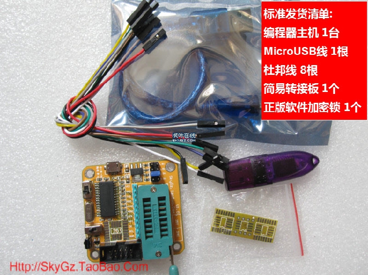

            He is selling three things:
            1) Simplest version, around $5 USD
            This version comes with a license for software version 1.29. The license and a link to the software is sent to your email. Upon launching the software, you are presented with a hardware key, this key is sent to the seller, and he sends you the corresponding unlock codes.
            2) Latest revision, includes purple security dongle.
            The benefit of this version is that you can use later software versions with it, provided you have the dongle plugged into the computer you're running the software on. No license is required for this version, and the software is sent to your email. Free software upgrades. Price is around $10 USD.

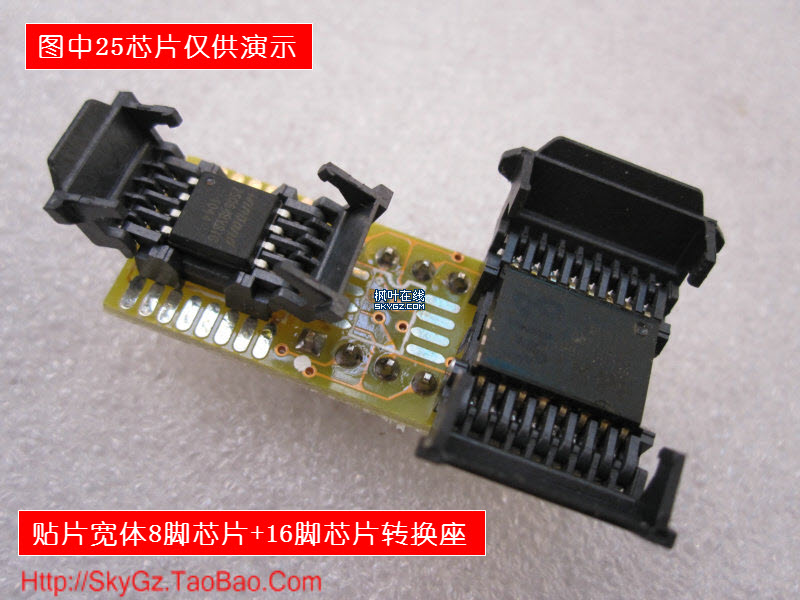

            3) Same as the second item but it also includes this dual SOIC adapter for 8 and 16 pin chips (Price is around $15USD):
            Personally I am only interested in the software. As far as I know, this is the best and most actively developed software available for this sort of thing. So his adapters come as part of the package. Yes, you could get the same thing on eBay for next to nothing, but you would have to use the older software versions which do not support all the chips out there.

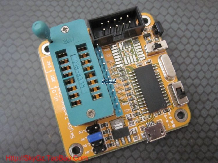

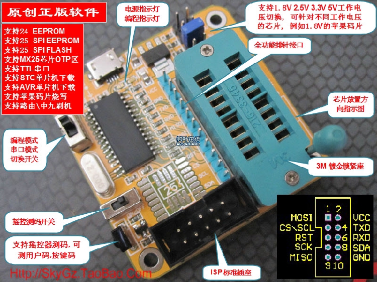

                    It's $20 US for the full fledged version. You get the advanced programmer, a small PCB for SOIC chips, a SOIC converter PCB, and most importantly, the security dongle. Versions of the software after 1.29 will only work with the dongle.
                    This is the only CH341A programmer with a selectable 1.8V setting. But he informed me that the 1.8V requires a mod or slight fix to be operational. Details are in the picture of the listing.

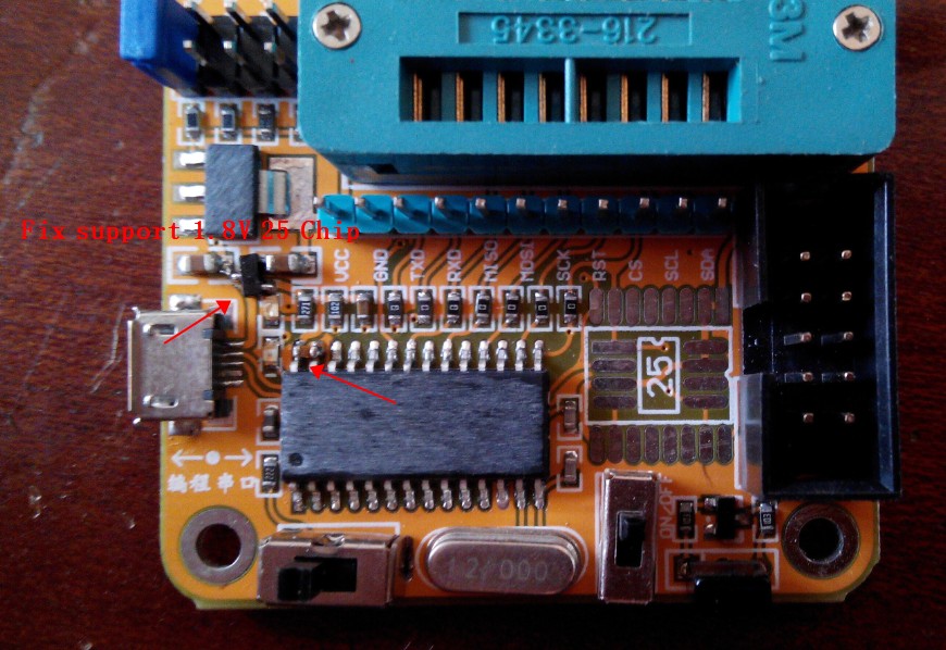

                                    I'm wondering how this programmer can work with 1.8V chips. The CH341A datasheet specifies a minimum VIH voltage of 2.0V on its I/O pins.
                                    As for devices in general, I would think that a generic programming algorithm for SPI flash would suffice for most, if not all, 25xx flash types. The same goes for 24xx EEPROMs. Am I wrong?
                                      Interesting... I'll see if I have a 1.8V chip I can desolder off a board to test for you when the kit arrives.
                                      Incidentally, he did send me version 1.30 overnight, and while we were chatting he also mentioned this:
                                      He said that it's a 1.8V LDO Regulator (SOT-23), and a 50V 1uF cap for the 1.8V fix... But that's just electrically to convert the USB 5V to 1.8V. There's a jumper block on the device to select voltages. As for how he managed to get around the spec, good question, I can ask him. Oh, and I asked him if he could include the regulator and the cap, he said not to worry, it comes with them already bodged in there.
