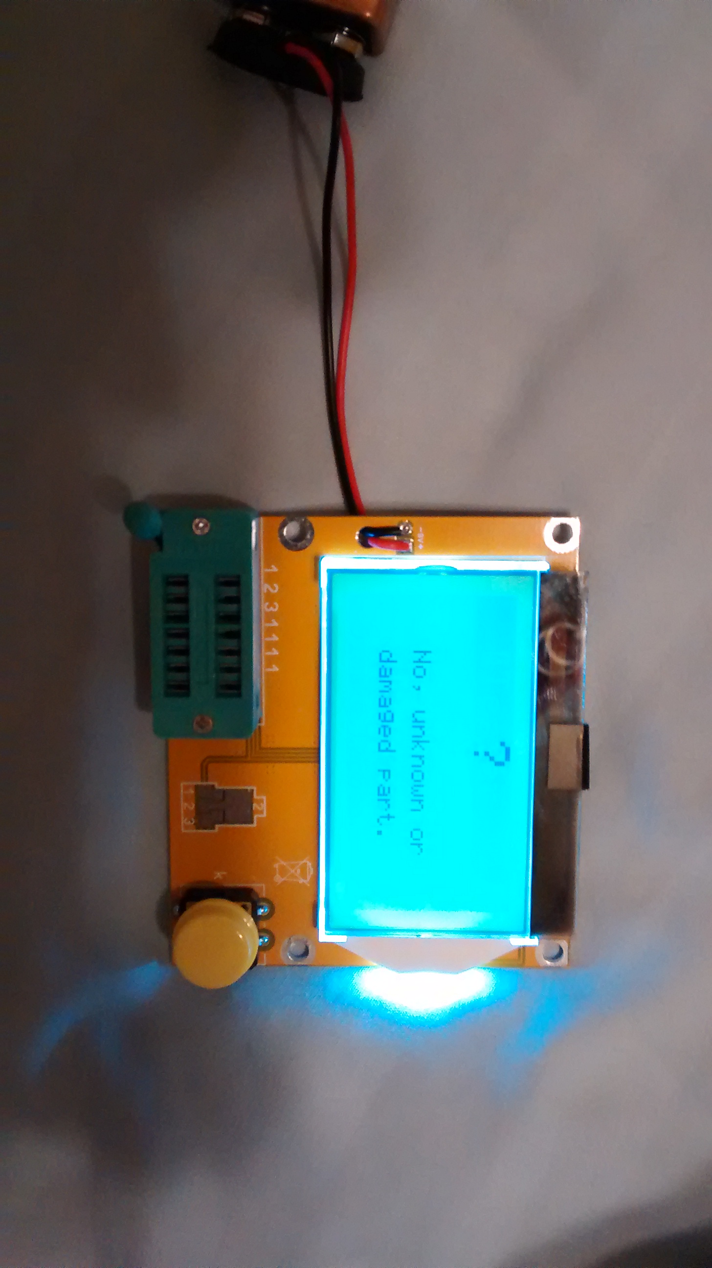

    Hello gents and ladies( i hope there are here) i purchased recently on Aliexpress an esr meter combo meter
    http://www.aliexpress.com/item/Free-...711204254.html
    was it a good choice? or did i screw up

    it's a T4, it's good, but not the best.
    the better one has added input protection and plugin cables among other improvements.
    having said that, the design is improving every day.
    you can add a serial / usb port now so it sends data to the pc.
    how much did you pay is probably a relevent question, the better one is probably an extra 5$

      less than 11 US dollars including shipping

        then you got a very good price!

          How to spot the one with input protection among all those models?
          Also, got any info about differences between T3 and T4?
            • 31183
            Re: New Esr Meter, Is it Good?
            T3 and T4 have different displays, but i dont think you can tell without removing it to read a model number.
            T5 is also around, but i dont know about the details.
            this is probably the best at the moment.
            http://www.ebay.co.uk/itm/181861030068
