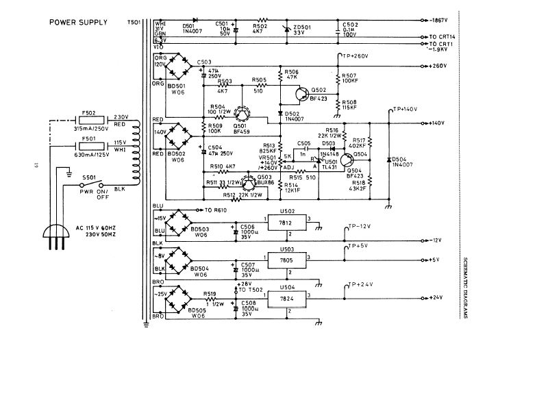

    I bought a 2120 from Ebay and it has a problem(Of course). The display shows the trace in about 1/4 inch square of the screen. It seems like it's working but the display size is too small. I have checked the output of the transformer and it seems within spec. I do have schematic, but not sure where to start looking. Any help is appreciated. Thanks.

        It sounds like it is out of focus, and no horizontal deflection. Does the trace move or blink at really low sweep speeds, or is it in X-Y mode?

          The trace only moves about 1/4 of inch. The best I can get is a 1/4 inch line in center of screen. The focus and intensity adjust work. I need the trace to go completely across screen to see wave form. When I turn off scope the trace will dance to the left half of the screen, leading me to believe the CRT is good. It's like trying to view the world thru a pinhole.
            Re: BK 2120 scope problem
            I would guess the power supply voltage is low for the CRT deflection.
            Take a multimeter and measure the PSU voltages. The +140VDC, +260VDC rails have test points, and +24VDC, +12V, +5V.
            The high voltage -1.9kV you need a HV probe to measure.
            It is set up for the right line voltage 115V/230V?

                    Ok, I got new meter and tested all the voltage test points and the 240v is only 25v. I checked back at the transformer and only getting 130vac. I am thinking the transformer is the culprit. Now I just have to locate a new one. Any suggestions?

                      Not the transformer if you are getting 130VAC, if you look at the Diagram, the 260VDC is generated by stacking the two power supplies. You need to check the components in that section of the circuits.

                          I think I got it now. I am getting 25v out of BD501 and 140v out of BD502. I will order new rectifier. Will post with results.
                            You need to measure the DCV between the two legs of the filter cap C503 for the top power supply, it should have (as you indicated 130VAC reading) 130VAC * 1.414 = about 183VDC.
                            So check the rectifier but I would suspect bad C503.
