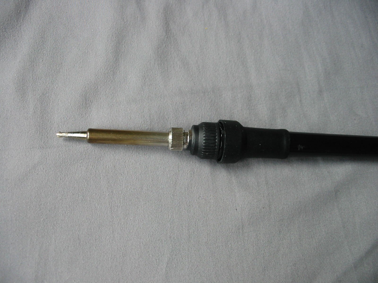

    Here's is your standard 900M iron handle. I put a 3 mm chisel tip on there:

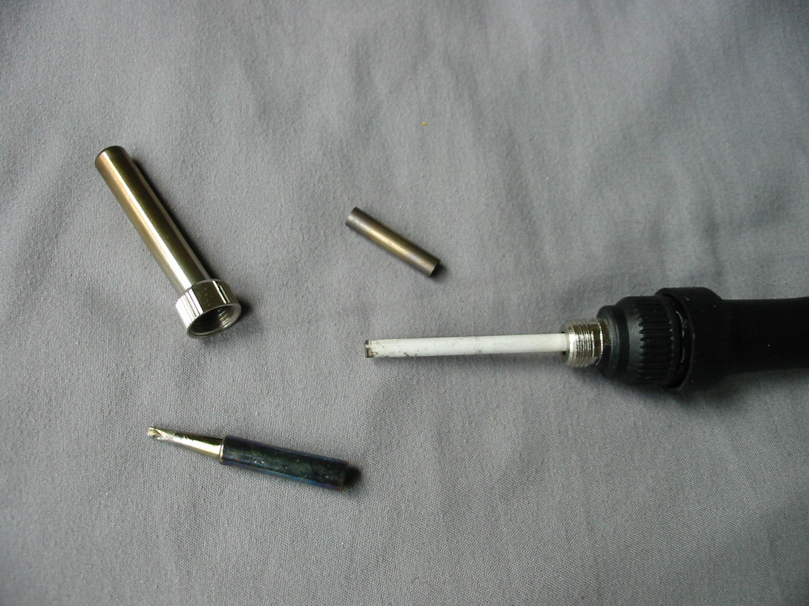

    All taken apart, showing the ceramic heating element:
    https://www.badcaps.net/forum/attach...1&d=1431575036

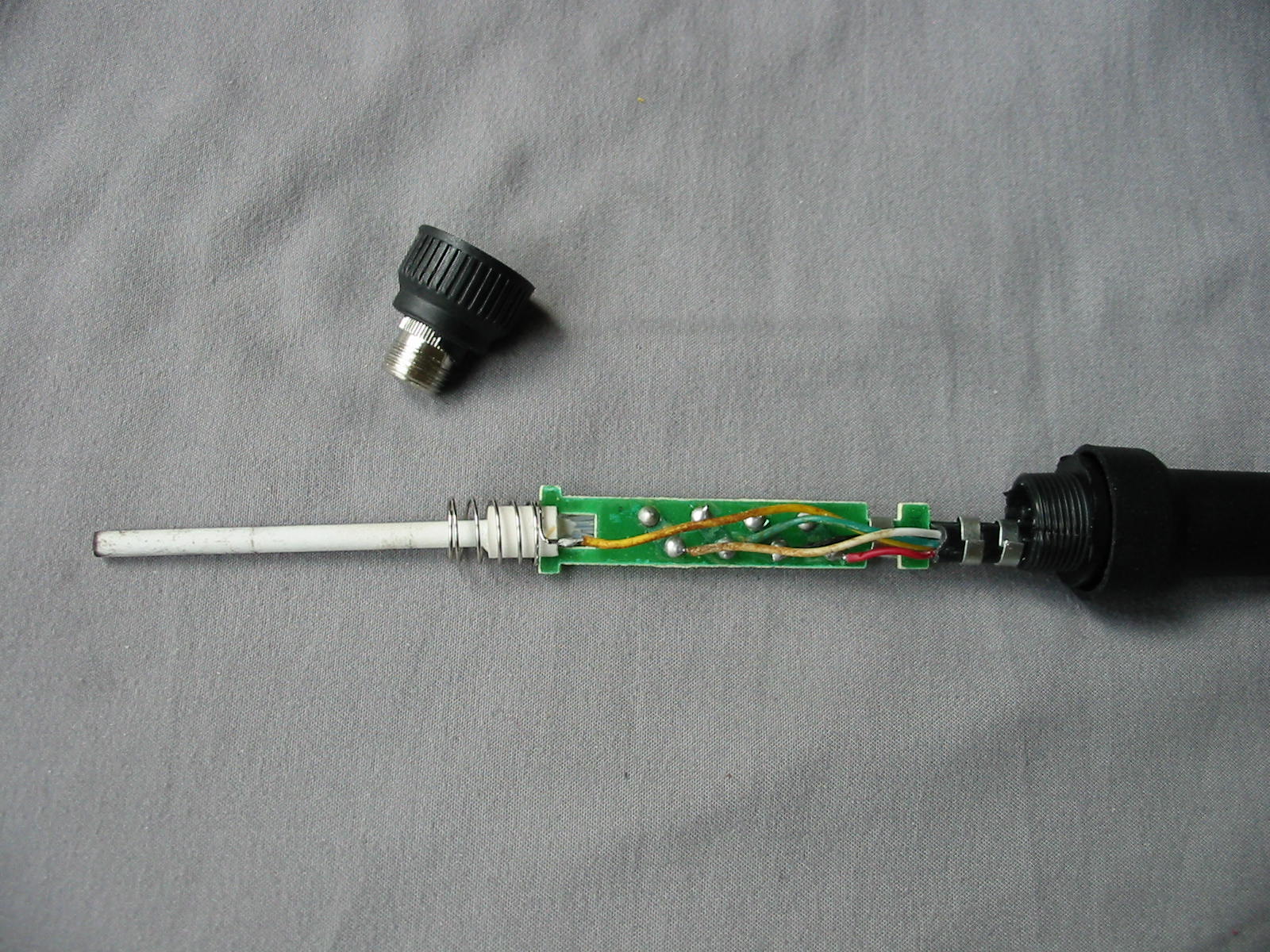

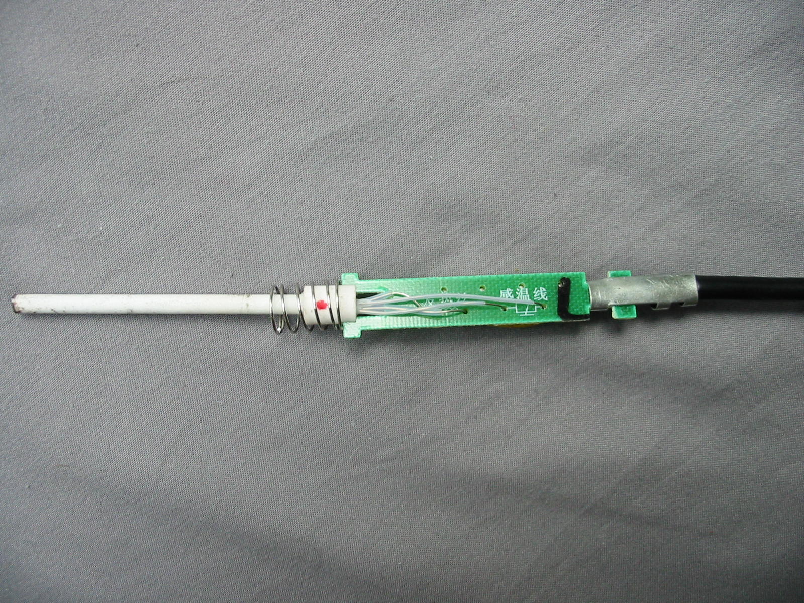

    And the mini PCB pulled from the handle:
    Now, let's note something here: the thermocouple/temperature sensor is inside that thicker base which is holding the heating element to the PCB (under the spring).

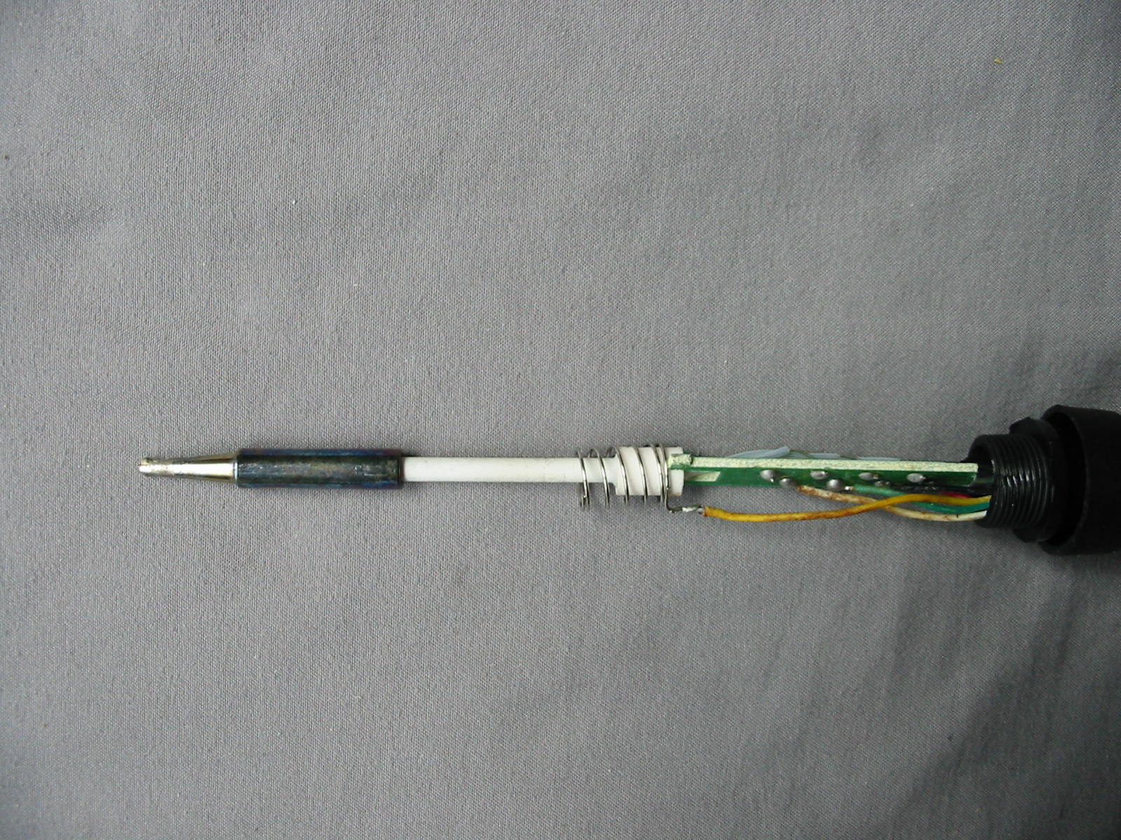

    But now let's see what happens when the tip is on the heating element:
    Anyone see what's wrong with this picture? No, not yet?
    Well, you have the tip on one end (left) of the heating element and the thermocouple/temp sensor all the way on the other end (right). So how exactly is the thermocouple going to pick up the temperature of the soldering tip? Short answer - it won't.
    Rather, the way it works is that the thermocouple just keeps the temperature of the heating element to whatever temperature you set the station to. As the soldering tip sits over the heating element, it eventually equalizes to the heating element's temperature (if the iron is not being used, of course). But once you start soldering, that soldering tip will drop in temperature, whereas the temperature of the heating element won't change drastically. You leave the iron for a bit, and again the tip will get to the heating element's temperature.
    So the result is poor thermal control. And that's why so many people crank these stations up to 300C just for leaded soldering, and much higher for lead-free.
