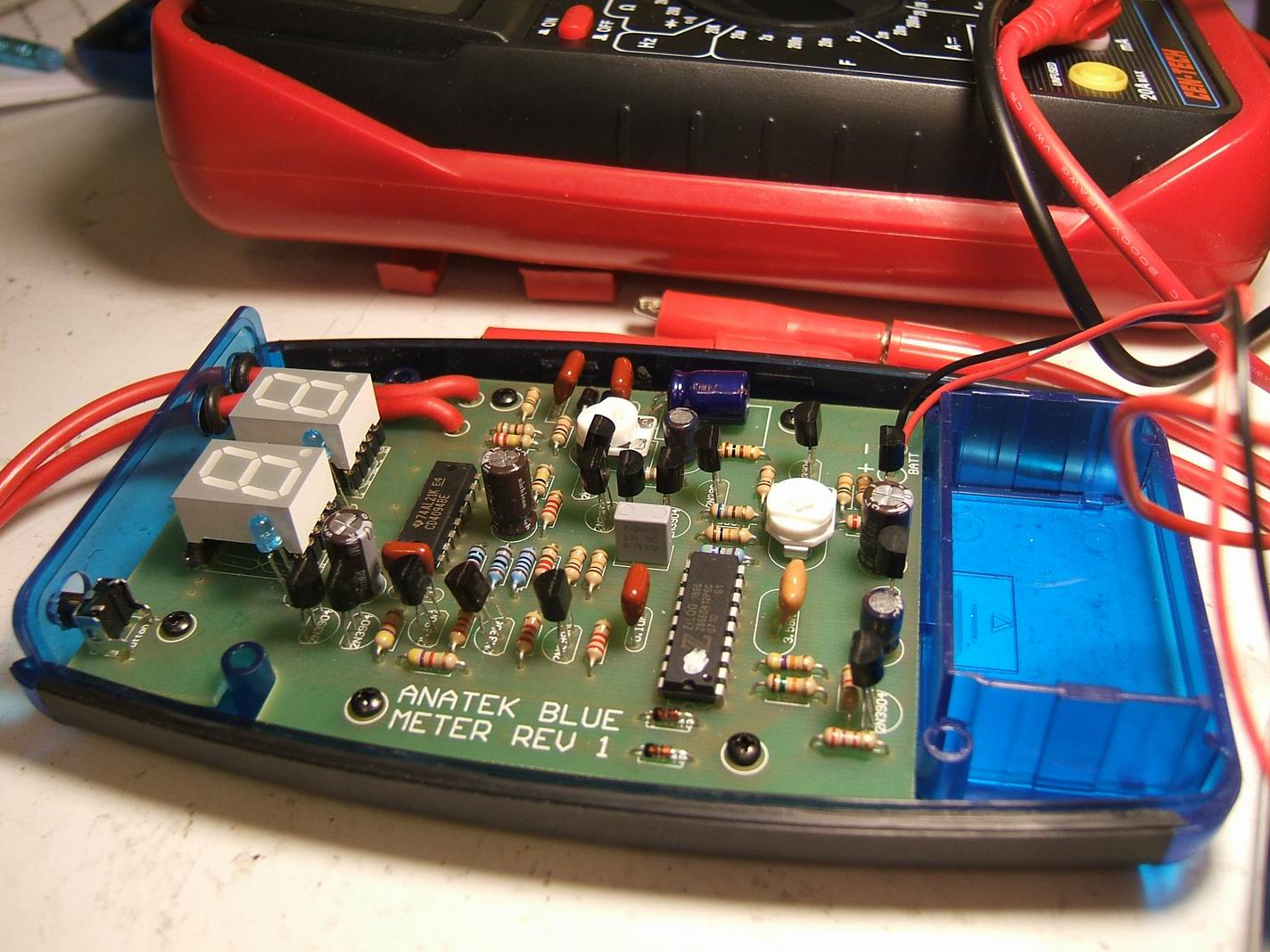

              got my blue esr kit last week. looks great. the case is very good, nice pcb and no skimping on the components, caps are nichicon and panasonic. full report soon.

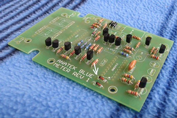

                        well i managed to lift a pad which i dont understand cos i was doing so careful soldering. it still looked connected but i fail the before installation of chips test.
                        early photo just to indicate where the lifted pad is

                              so possibly a fault with pcb
                              or maybe diode was high and you put a bit of force on PCB without realizing it.

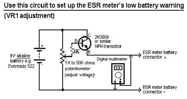

                                      I hope you have a fully variable power supply for setting the low battery indicator. Otherwise you will need to build the little discrete voltage regulator in the manual.
                                        #39
                                        Re: Yet another ESR meter!

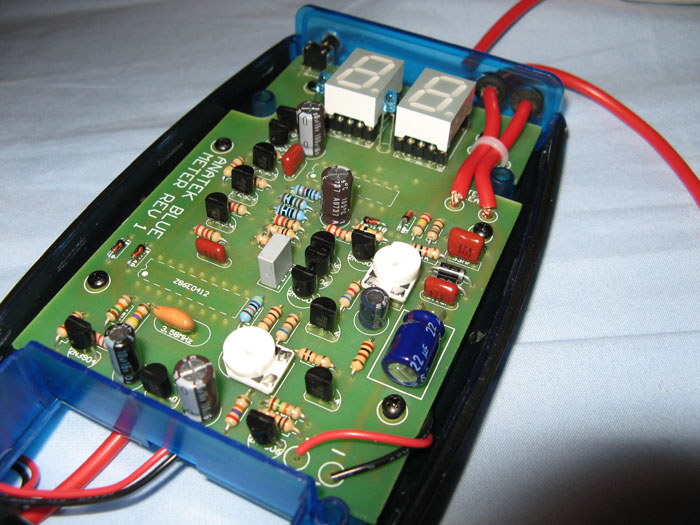

                                        I adjusted the voltage dropout with an el-cheap variable wall wart, no expensive power supply needed. I set it to 3v, attached the 9v lead to the ESR meter, and placed the 82 ohm across as a load. 5.45v was close enough for me. Adjust fast since the 82 ohm resistor heats up quick. Don't try that with the 5.6 ohm resistor unless you have one that can dissipate the max wattage of your transformer up to 5 watts.
                                        I used a 30W Weller Therma boost and tin/lead solder to minimize the likelihood of burning traces. No RoHS for me.
                                        I left my transistors with as long as leads as would fit in the case so I could keep the heat away with a reverse tweezer. I didn't think of this when soldering in the diodes.
                                        I soldered the test resistors right into the ESR meter. One side is soldered to one test lead and the other is wrapped around the case. I can calibrate my meter any time and the resistors never get lost. You can see their little wires poking out just to the right of the 7 segment displays.

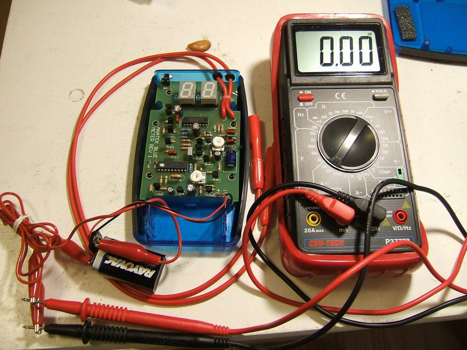

                                        Here's the easy way to hook your amp meter up for the test. Polarity doesn't matter with a digital meter. I get 9ma operating and 0ma off.

                                          i wanna build the variable power circuit but i could not get a 3904 tranny. Of course the shop only had 3903 or 3905..... are these any good?
