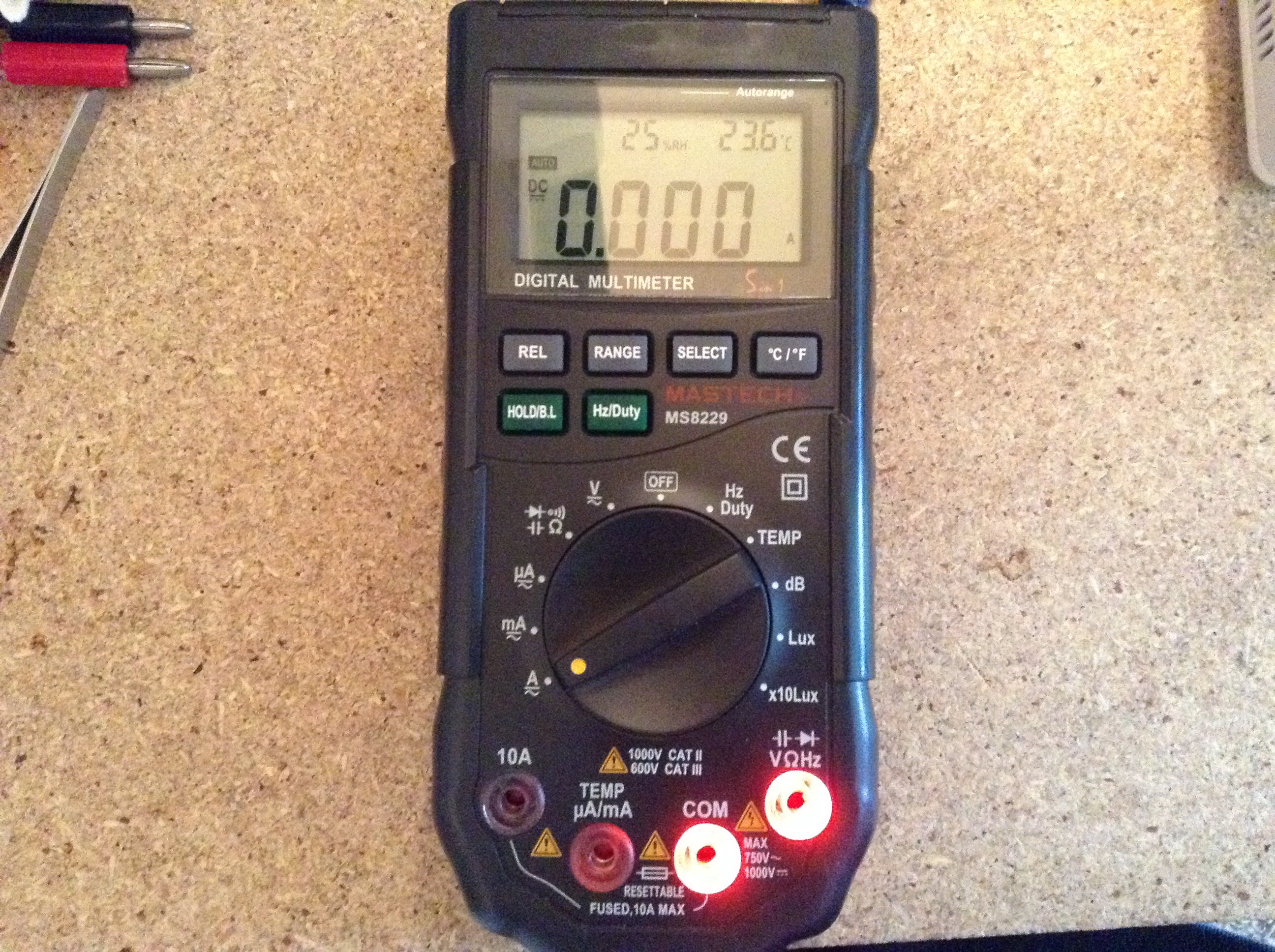

    I know this is an old thread but might someone be able to help? I have a Mastech ms8229 and for some reason it is acting up so weird. I have no idea what I did to get this but it want to measure ohms in the volts position. It won't measure the ohm or even notice any volts(testing with a aaa to not damage it). I opened it and looked carefully around and didn't see any broken parts or anything missing. I don't care about the meter but just want to know what it up with it. I died little over a year ago and I got much nicer ones after it did.

    Re: Protek 6300 "5 in 1" DMM
    Here is the picture. Just so weird.
      Sounds like the rotary switch isn't being interpreted correctly?
      You will have to take it apart and post some clear focused pictures.
      edit: If the rotary switch were on resistance, it should display overload instead of 0.000 with no probes attached. If the rotary switch were on volts, it should show 0.000 with no probes attached, but with V instead of the ohm symbol.

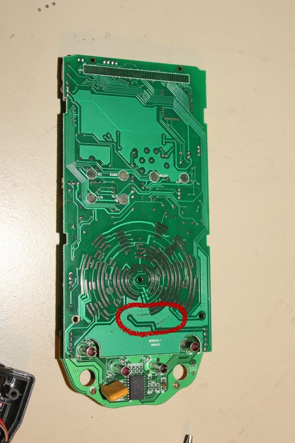

      • retiredcaps
        • Apr 2010
        • 9271
        Re: Mastech ms8229
        I found a picture of the MS8229 front pcb at
        http://fisch.suroot.com/mastechms822...ms8229_004.jpg
        I circled what I believe is dirt/debris that may interfere with the proper operation of the multimeter? You can clean it with isopropyl alcohol.

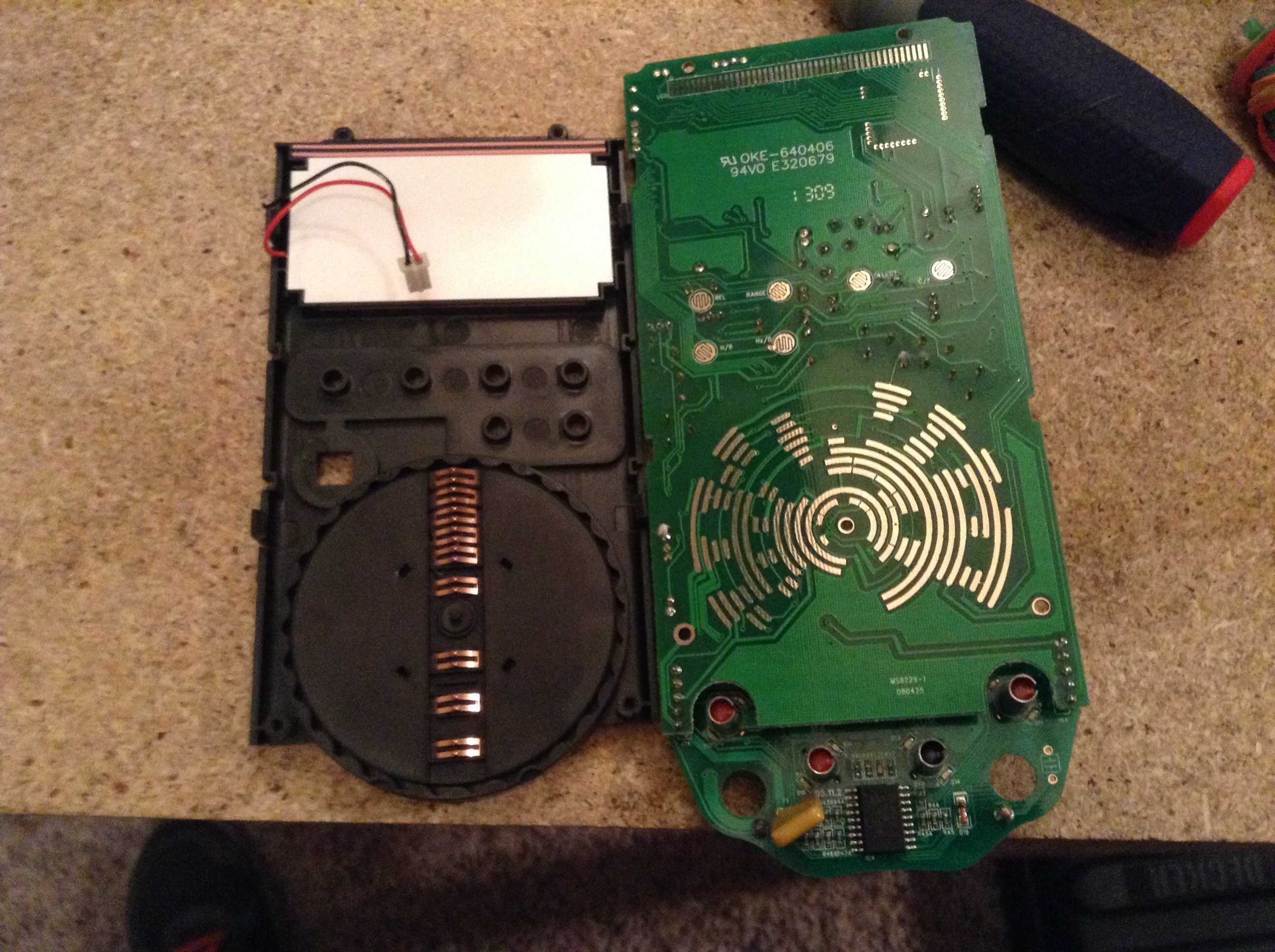

              Here is a picture of the rotor switch

              • Kawooa
                • Apr 2015
                • 16
                Re: Mastech ms8229
                If you can get a picture of the rotor switch. The part that turns for me I ca see if mine has the little contact pieces off and not in the right spot for what ever reason. Thanks for help so far!

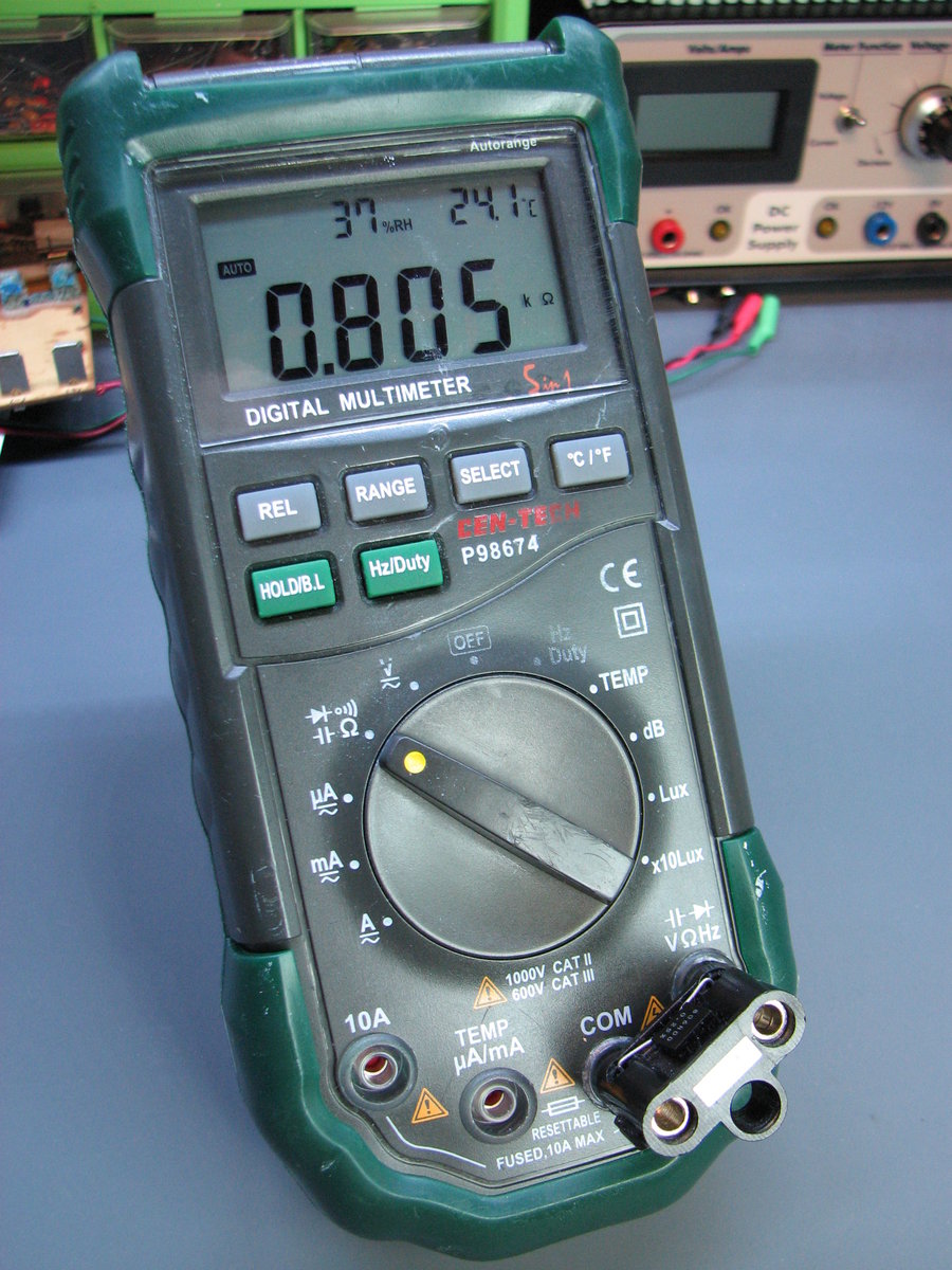

                        • newtothis
                          • Mar 2013
                          • 1556
                          • england
                          Re: Mastech ms8229
                          I have a couple of Mastech 83xx series, maybe same switch. Will look
                          • modemhead
                            Lurking
                            • Jun 2012
                            • 52
                            Re: Mastech ms8229
                            Let me ping someone who has the equivalent multimeter, but Harbor Freight branded.
                            Here you go. It's a Cen-tech P98674, looks pretty much like a Mastech MS8229.

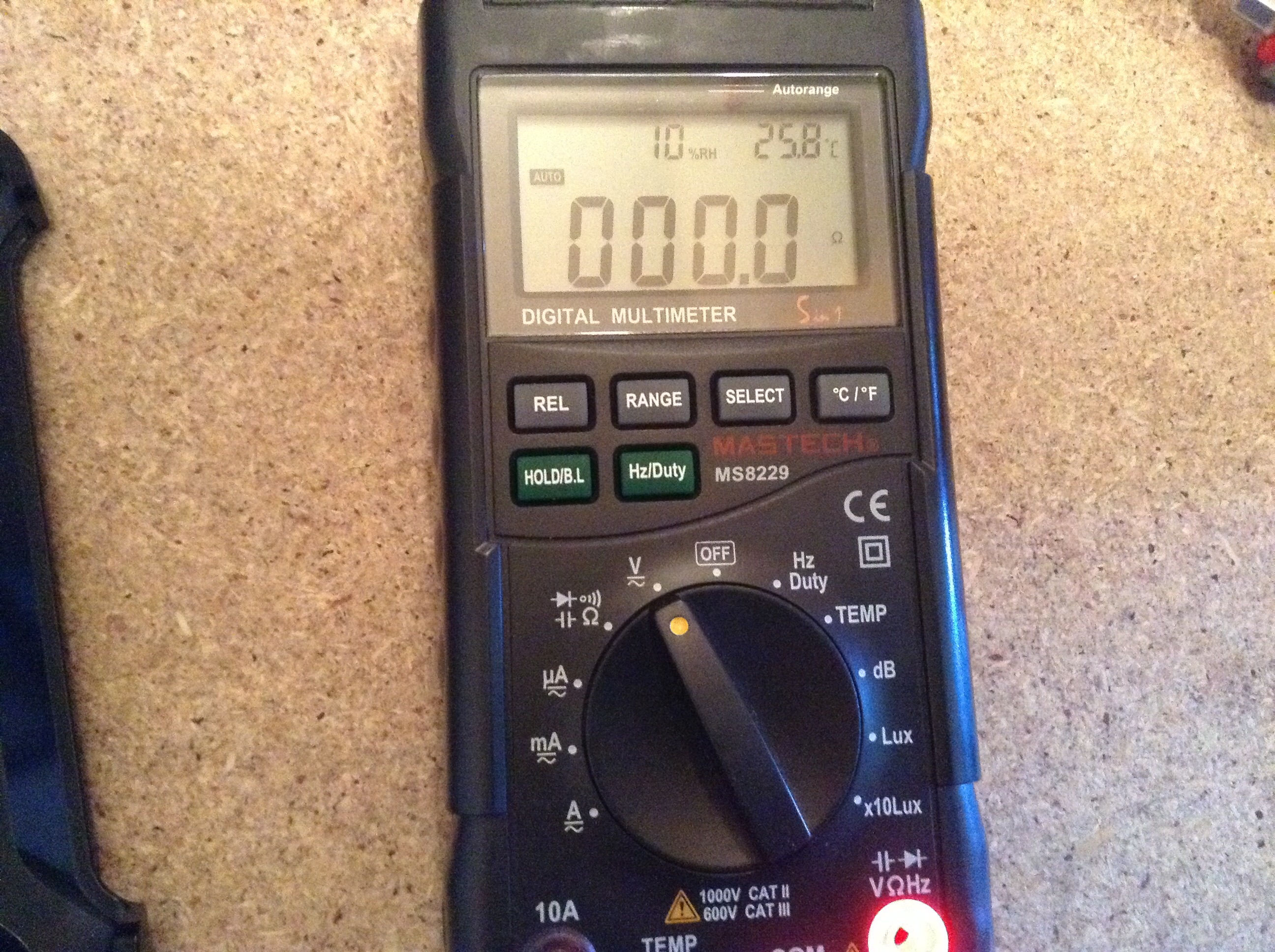

                                • Kawooa
                                  • Apr 2015
                                  • 16
                                  Re: Mastech ms8229
                                  Here are some photos showing ohms in volts range and amps in volts terminal.
                                  Make sense? What fun is there in making sense?- Discord

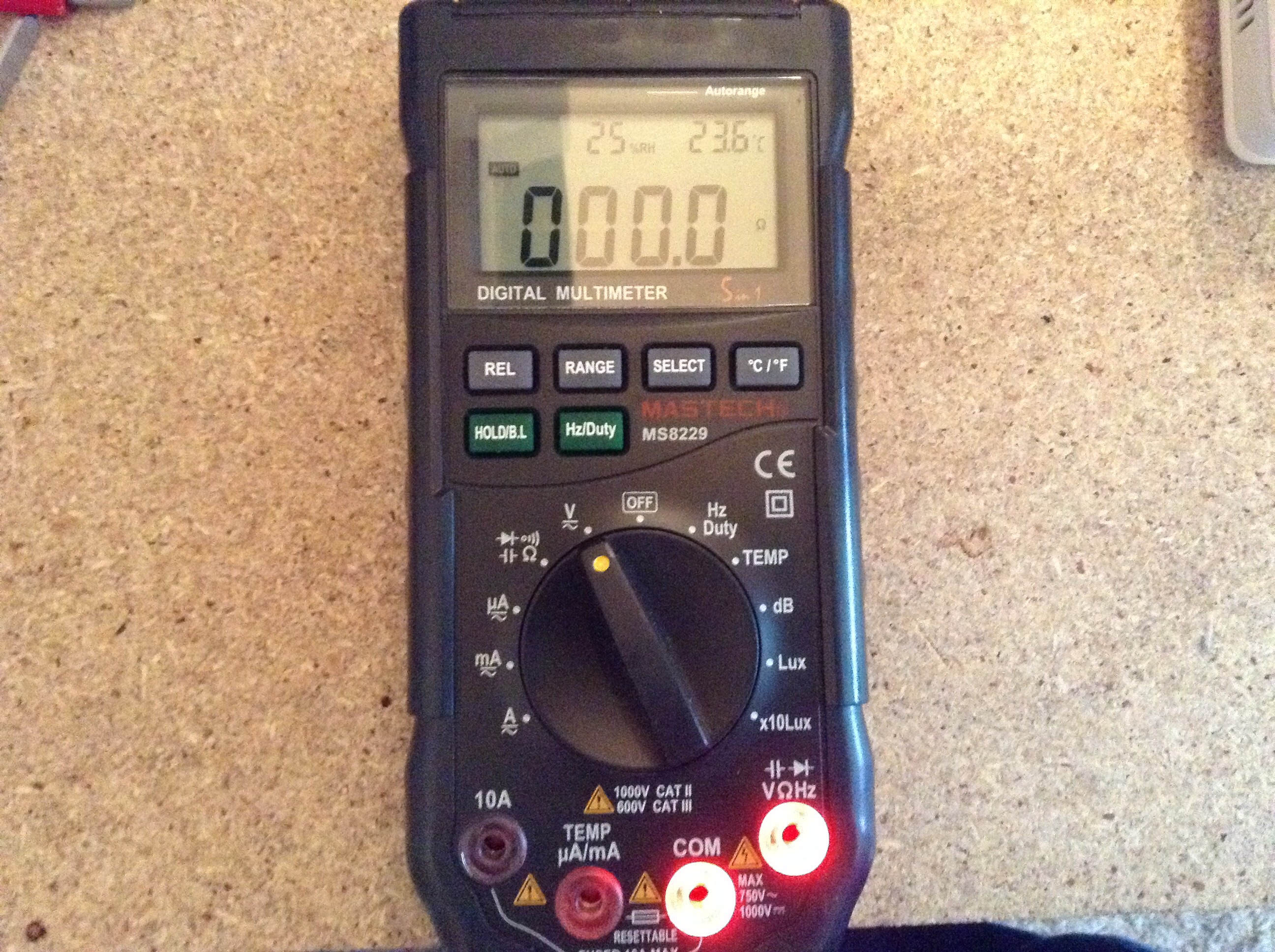

                                  • Kawooa
                                    • Apr 2015
                                    • 16
                                    Re: Mastech ms8229
                                    Having issues due to snow storm and ipad acting up. This should be the ohms in volts position.
