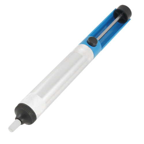

    I'm working on a 4000w amp right now, it has 24 large MOSFETs. Took me several hours just to get 4 of them off. I'm using a 25/40w radioshack soldering iron and copper braid to do it. These things are basically giant heatsinks so the solder hardens the second I remove my iron. They all have 3 pins going through the board with a lot of solder on the back. My current method has been to heat up each joint and pull it up with needle nose pliers, then clean up with the desoldering braid. Already broke one of them this way and it very time consuming, is there a better method? I'm doing this at 40w, my 25w weller could barely flow the solder, I don't think I could go much higher without damaging the chips.
    Re: Need help desoldering MOSFETs.
    I put a little drop of solder on the tip, then go to a joint you want to desolder, it will re-flow much faster. Then I use a desoldering pump to suck up the solder.
    I have the cheapest one, it has worked great so far.
