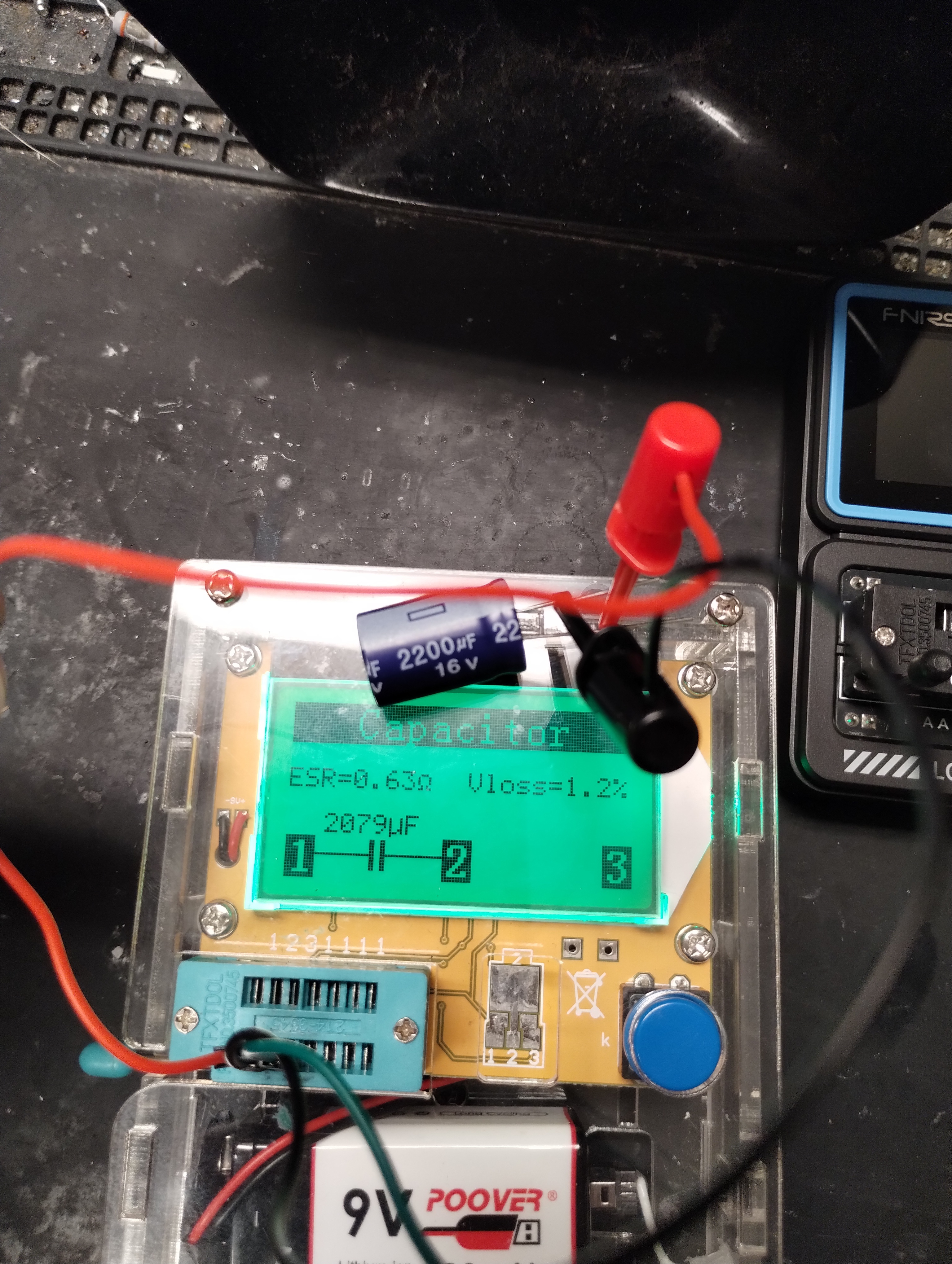

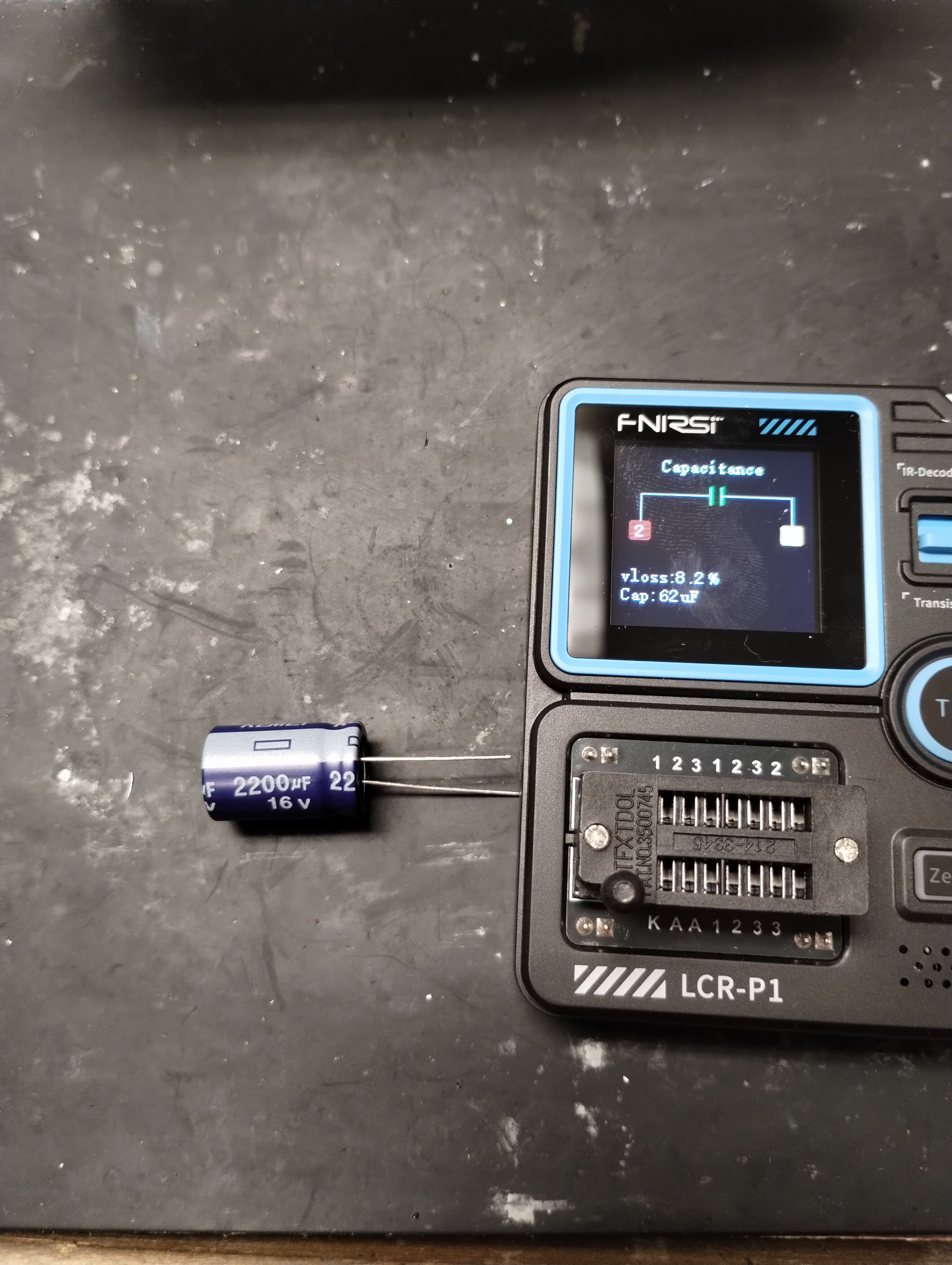

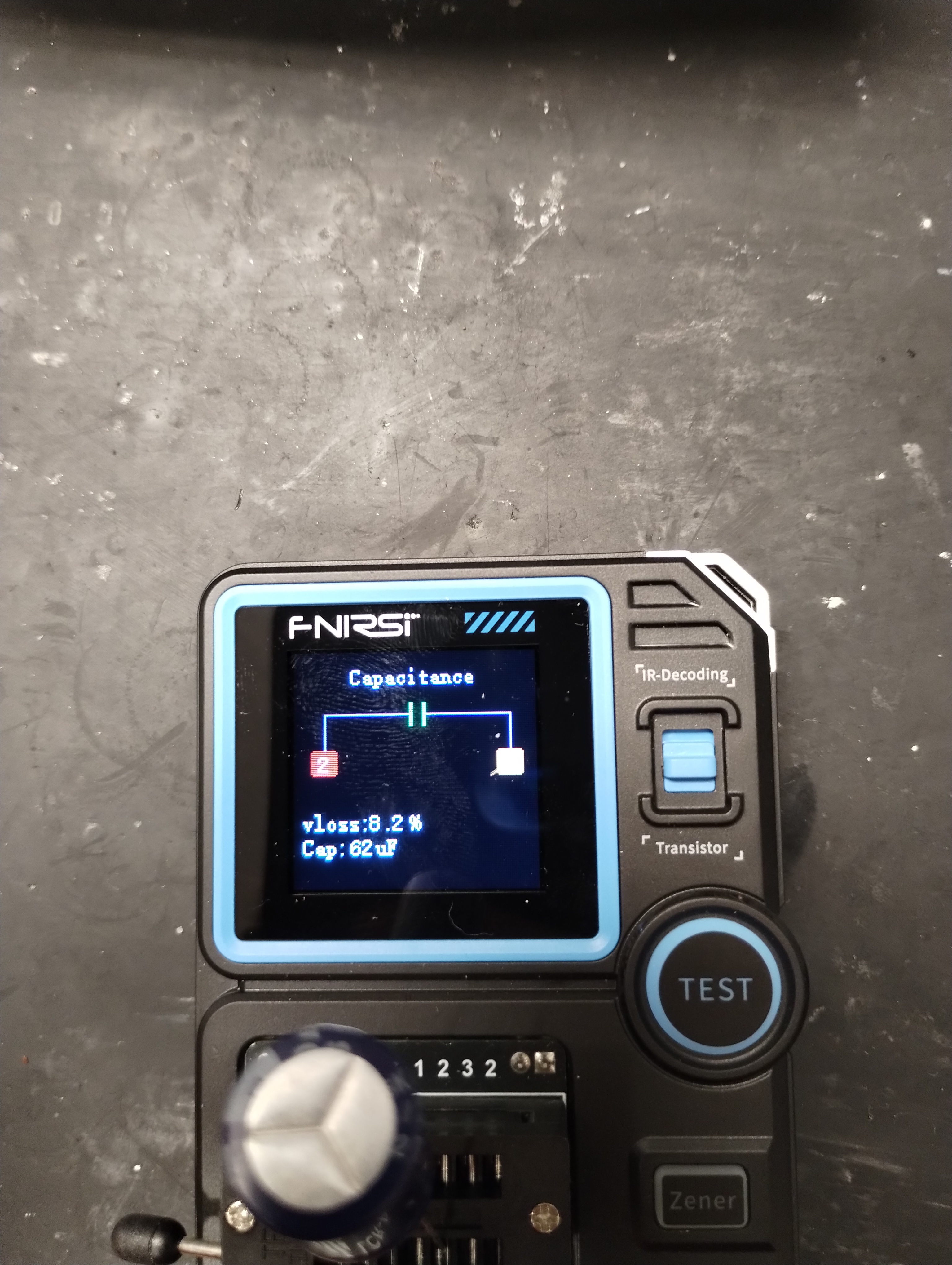

                      I've had some more time using the FNIRSI component tester and I ran into my first major negative today when I was fixing an Atari 2600 with what I thought was a bulging 2200uf 16V cap. I tested it in the FNIRSI and it read at 700uf and thought ok that's to low so I grabbed a new kemet cap with the proper ratings. I decided to check it just out of habit and I got a reading of 62uf which I thought was a little weird. So I retested and got basically the same reading +- 3uf. I popped another one from my bin into the tester and got approximately the same reading again. I pulled out my old tester and tested all three caps, the original atari one, the first one I took out of my bin, and the second one. It read the Atari one almost exactly the same as the FNIRSI tester, but was able to read the new kemet ones properly at around 2070-2100uf.
                      At this point I can't say I trust it for my usual workload for it just off not being able to read new higher value capacitors. I still like it so far for smd transistors, but I'm not sure how much I trust that now either. Probably going to stick with my tried and true cheapo one for now.

                          This is because its measurement range is 25 pF-100 µF
                          • CapLeaker
                            Leaking Member
                            • Dec 2014
                            • 8354
                            That sux if you can’t measure anything higher than 100uF.
                            • harp
                              • Jun 2022
                              • 650
                              • Planet Earth
                              Declarated range 25pF - 100mF, and it is not micro "u" like in inductors range. It will be odd that measure only uF range today...
