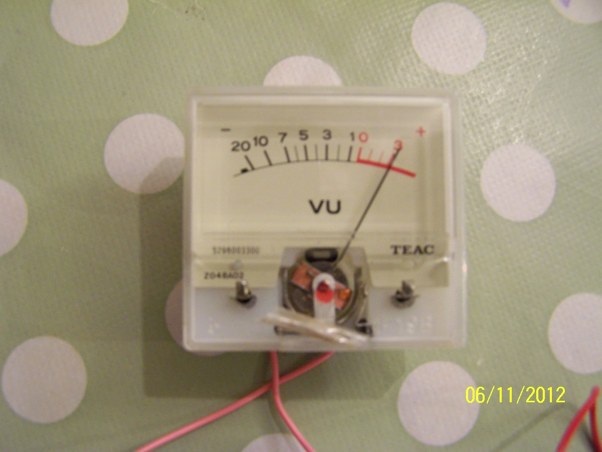

                                  So, I built the meter as per link on post #1, prototyped on a breadboard using 1% 1/4w resistors throughout and a VU meter.
                                  Supply voltage is provided by a 9v dc mains adapter.
                                  +4.5v and -4.5v confirmed at IC TL084 Pins 4 and 11 measured across Pin 1.
                                  With probes open, no LED and no movement on the meter.
                                  When probes shorted the LED illuminates as expected and full deflection on the meter is achieved by adjusting the pot.
                                  Issues I'm having:
                                  When connecting a cap to test probes the deflection on the meter is more than full deflection (when probes shorted).
                                  This may be correct but my logical thinking thinks otherwise.
                                  I would like to confirm 100khz at the probes, I do have an oscilloscope (S51B) with probe but unsure how to use it.
                                    #77

                                        Do you have 1 Ohm, 5 Ohms, 10 Ohms resistors to use and see what reading you will get?
                                          #80
                                          Re: Cheaper ESR meter
                                          Hi I have known 5.1 and 10ohm 1% resistors and also a 2 ohm possibly 1w resistor.
                                          The results are as illustrated which appear to be proportionate according to the resistance ranges.
                                          Pic 1 - Probes shorted
                                          Pic 2 - 2 ohm
                                          Pic 3 - 5.1 ohm
                                          Pic 4 - 10 ohm
