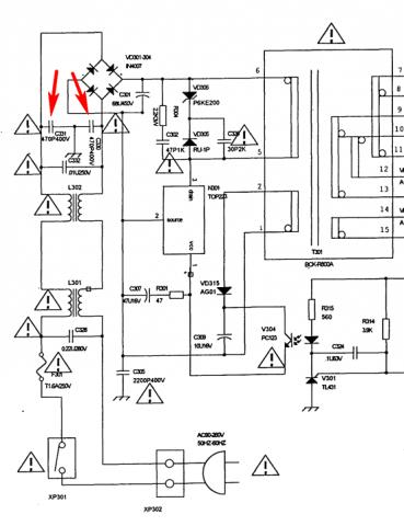

                            Re: Scope probe ground clip sparking on chassis
                            Originally posted by Agent24
                            Can you explain how they would cause the problem? I don't understand, unless you mean if they were leaky too?
                            I hope you can view the attachment. It's the primary side wiring of a Teac DVD player power supply but reasonably typical of that kind of domestic gear. As you can see, it has a two conductor mains lead. Notice the two capacitors with red arrows pointing at them. Each is connected between a mains conductor and the non-earthed chassis. Capacitors pass current when an AC voltage is applied to them. They don't need to be leaky.
                            Do I need to explain in any more detail?
                              I think I understand now, it's when you said 'mains filter capacitors' I thought you meant the big electrolytic(s) after the bridge rectifier.
                              So, if my brain is working correctly: the Y capacitors are like a voltage divider, with the output connected to ground, however because a 470pF cap at 60Hz has reactance of 5.6 Megohms, they won't be passing much of the actual mains current, but any high-frequency crap will see a much lower resistance, and thus get filtered out.
                              So then the 0.5v I measured across chassis and ground is the result of a small current being passed by the capacitor?
                              Is this a reason why isolation transformers should be used?
                              (Note: if none of that made sense, I blame lack of sleep)
                                Sorry, I should have called them something like mains bypass caps to distinguish them from the big electrolytic cap. Yes, their function is to reduce high frequency noise going up and down the mains lead.
                                I'd have expected you to be measuring a considerably higher voltage than 0.5V, considering that you saw small sparks and got a minor shock.
                                It's pretty risky taking measurements around the "hot" (primary) side of a switching power supply. If you really have to do it and you're connecting things like an oscilloscope, an isolation transformer is absolutely essential. I know a guy whose oscilloscope probe lead exploded when he didn't use one. It could have been worse.
                                For measurements on the rest of the circuitry, personally I'd just clip the oscilloscope's ground lead to the chassis and measure away.
                                Now get some sleep!
