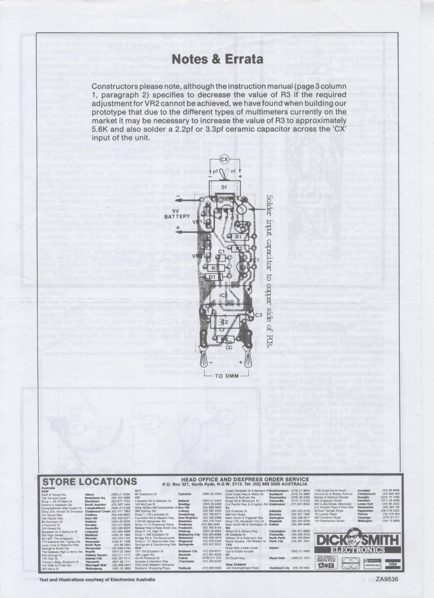

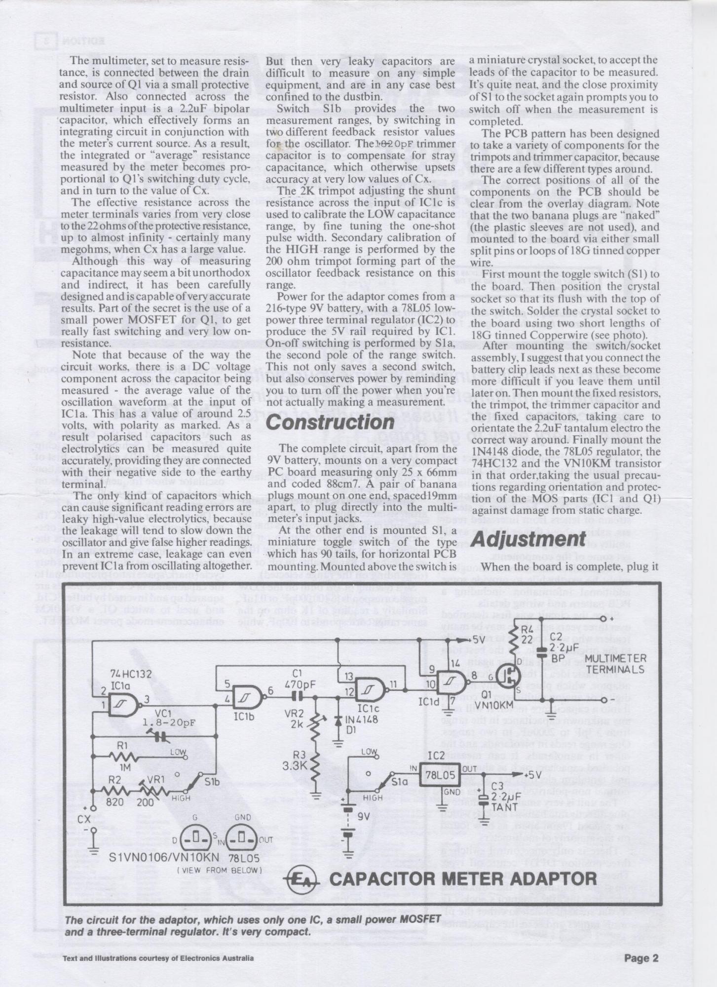

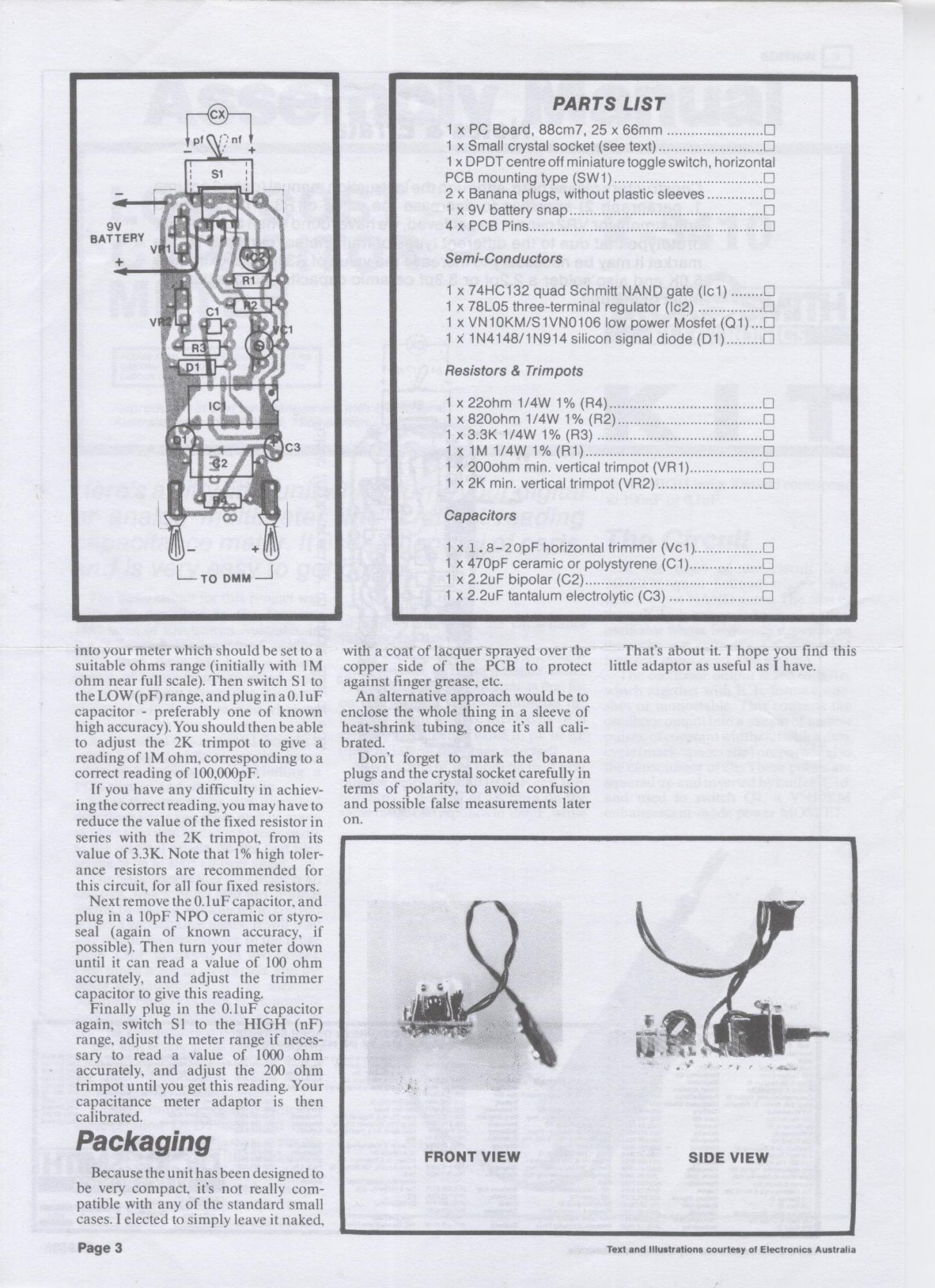

          Sorry I didn't get it sooner but here it is (couldn't remember where I'd put it!)
          I'll upload the files here in case anyone else wants to give it a try too.
          Hopefully it would work better for you than it did for me. Maybe I did something wrong with mine, who knows? I may try to get it working some day...
          Since the forum resizes the images, I've put the originals in a multi-part RAR archive.

            Many thanks for posting the documents.
            I've just skimmed through the article and, on paper, it looks to be ideal for my purpose. I'll gather up the bits and pieces (not sure if I have a 74HC132 to hand at the moment) and give it a go ASAP.
            Oh, and thanks for the rar. files - I'll print off a copy.
            Dave.
