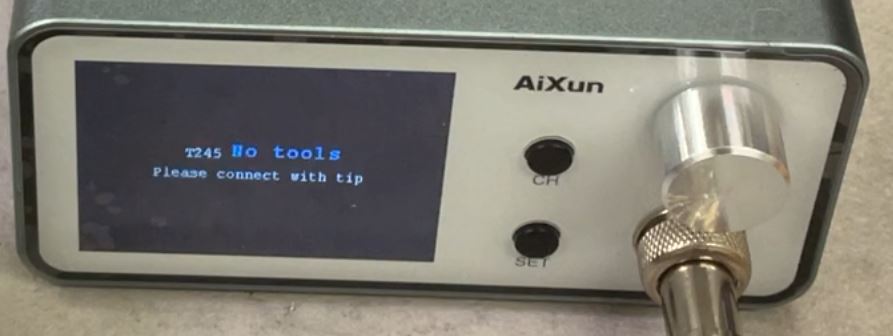

                            I've used the T3A to do some soldering tonight and noticed the display would say "NO TOOL" every now and then. I thought it was my JBC tip so I swapped it for an Axiun. Same issue.
                            Then I realised it was not the tip. EVERY time I was touching some specific pins on the motherboard I was working on, the station does what you see on the video.
                            The MoBo is disconnected, been off for days, no battery.
                            How is that even possible please and, most importantly, what do I do now?
                            I am incredibly confused.
                            https://www.youtube.com/watch?v=o5JEp6sO9Jc
                            This is what the display says when it "flashes"
                            • CapLeaker

                              Re: Aixun T3A overshooting?
                              Mine doesn’t do that. I even soldered big stuff with that iron that shouldn’t be done with one. I am not even sure what firmware or hardware mine is running, but it is about 10 months old now.
                              Looking at your video, it looks like it’s going crazy as soon the main unit ramps power up close to full tilt, losing juice. Weird. If you just got it and depending where you bought it, warranty it?
                                I don’t think it’s got to do with power, I’m barely touching some specific joints. I’ve done the ‘coin’ test with lots of solder and I can dip the tip in a wet sponge and it doesn’t happen.
                                Yes it’s brand new so o guess I’ll ask for a replacement, wish me luck.
                                Still, I can’t think of what could be sensing that is triggering that behaviour.
                                  I have an update. It's ground.
                                  When the PCB I am soldering is grounded, SOME solder joints will cause havoc.
                                  AND, the handle is buzzing.
                                  https://www.youtube.com/watch?v=8OXDOZTy7t0
                                    • 31014
                                    contact Aixun - it's gotta be a psu issue
                                    my guess is the ceramic capacitor between the primary & seconday is missing or the unit is missing a ground connection between the mains earth input and the handle somewhere.
                                    can you use your meter to check resistance between the iron tip and the earth pin on the back of the unit - earth on the iec connector i mean.
                                    while your at it - check your power cable and your house socket
                                    i'v had a few recent "incidents" with power cords with molded plugs on them!!!!
                                    if you buy anything high wattage with a molded plug - check the plug isnt getting hot while it's running - specially fan heaters from Lidl!!
                                      Shall do, I did check that the unit was earthed, I believe everything reads full continuity but the tip which is reading some resistance but not much? I'll double check.
                                      Bear in mind that when I touch ground directly with the tip, it does not happen. It only happens when touching SOME solder joints on an earthed PCB.
                                      I'm not sure about the PSU to be honest. The display would show "undervolt" or something like that, like it does for a brief moment when you power it off.
                                      Someone on EEVBlog says this is normal - I can't accept a soldering iron which cannot be used on grounded equipment, would you agree?
                                        • 31014
                                        it makes no sense.
                                        the tip resistance to mains earth should be almost zero
                                        *unless* it's floating for safety - but i dont think they did that.
                                        weller in the past used to connect the tip to mains earth through a parallel resistor and capacitor to limit current incase you accidentally worked on something live.
                                        i modded my t12 the same way - sometimes i can get leds to glow while soldering them now!
