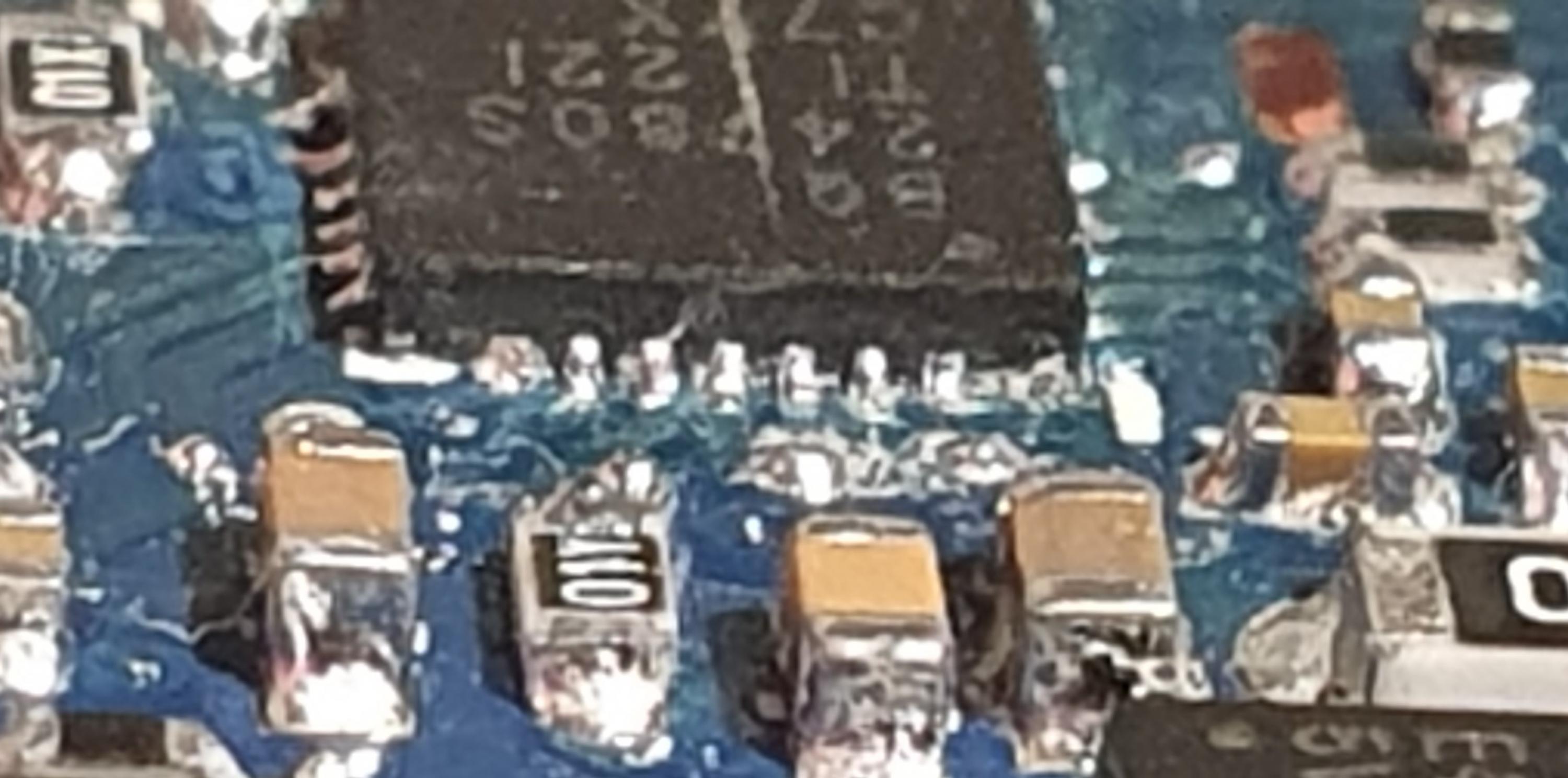

    Hello, I tryed to solder 3 qfn chips recently, and same problem : I press it hard and the chip stay in the air, there is a quarter of millimeter between board and chip, I don't see the sides pads of chip soldered to board and I guess the chip is not properly soldered (not tested).
    I tryed with qfn 20 and 28, the same.
    I start to solder with board pads tinned (lead solder wire), I place the chip without flux under but I put a little bit of flux at two sides of the chip to hold it in place.
    After solder, I reflow (400 degree) while pressing chip, two times at two places of the chip.
    What I'm doing wrong please ?

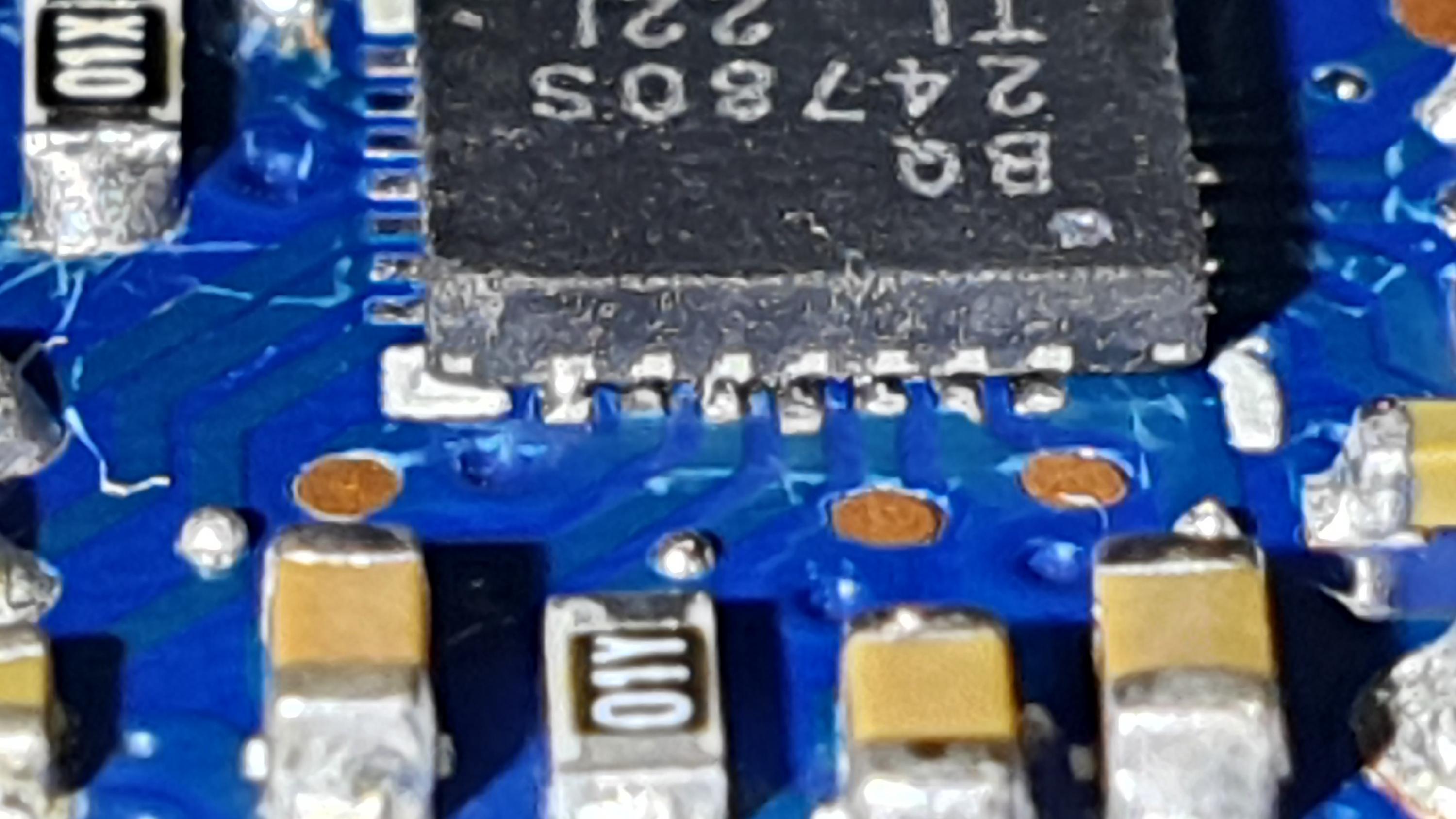

    Re: Soldering qfn problem ; it don't go flat
    See the picture, the chip don't touch the board, maybe it's normal ? The pads at left seems to not have enought tin ?
      No, this is not normal, you can drop a flux and walk with a thin conical tip of a soldering iron.
        Are you using a hot are station? you must also melt the solder under the ic. so make sure to add flux to the old pad. If you don't melt the solder under the ic it will not go flat to the board. Also check that you didn't deform the pad during chip removal, the solder pad should be flat.

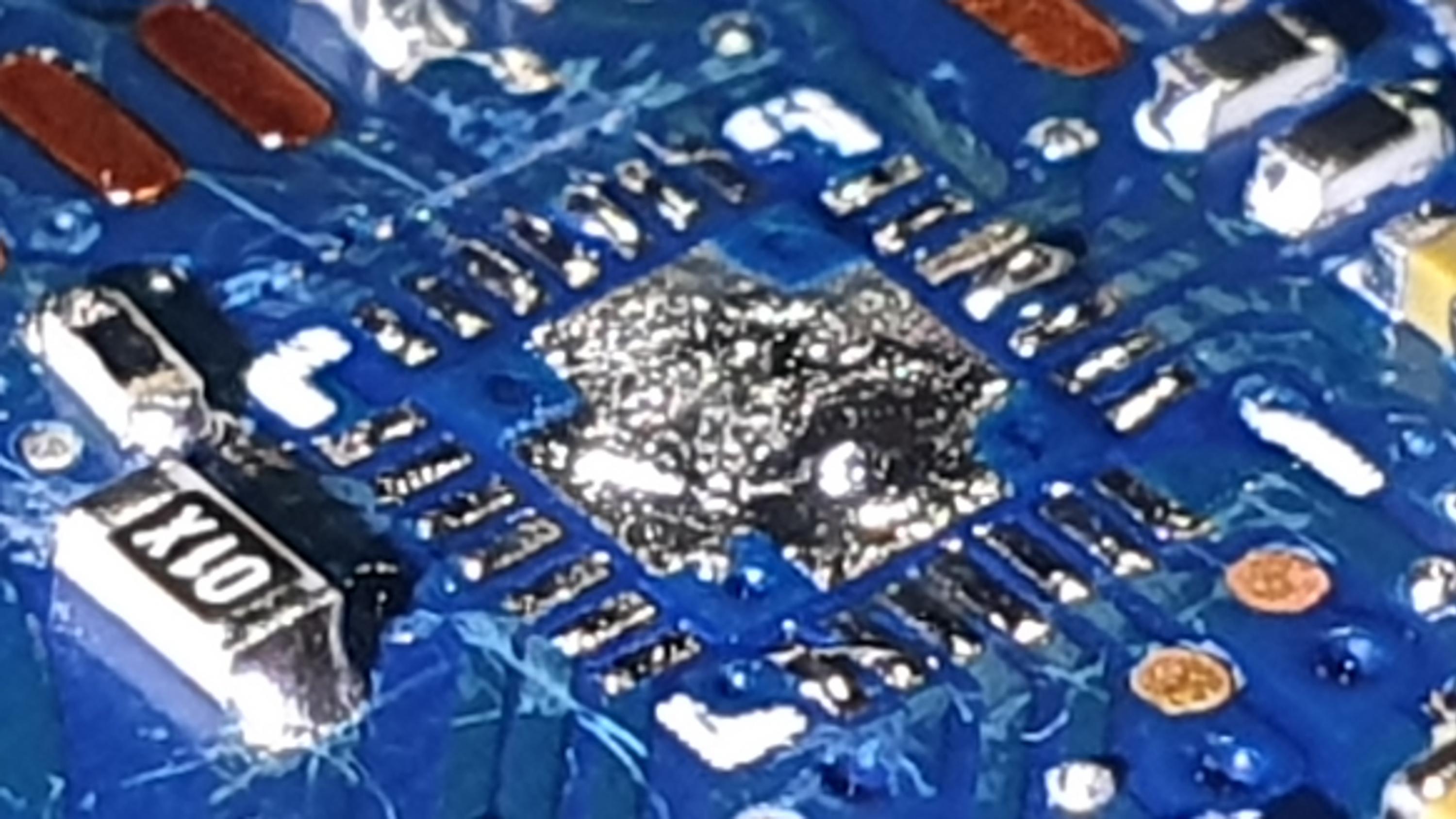

                Picture of the chip desoldered, probably not enought tinned, but that can't explain why it don't go flat ?
                  Too much solder What solder are you using ? I expect the centre pad to look smooth and shiny. Perhaps you're not hot enough or haven't given it long enough to melt properly.
                    I use solder wire Mechanic 63-37. (I have 2UUL solder paste too, melt point : 183 degree C but not yet tested).
                    Too much on the central pad ? There is less than when I desoldered the original chip.
                    Not long enough, yes maybe, the blob on the central pad is at the same side where the chip was the highest. I will retry soon (without chip for checking the melting time at first). Thanks for help
                      remove solder and sit chip down on the pcb to see if its looking good then .if so use solder paste .
                        I was on my phone earlier, I can see there's not much solder now. I don't think it's melting, it's a ground pad so will require more time to melt than the pads around the outside.
                          I removed the solder at ground pad and droped solder paste, and I added solder paste (to wire solder) on pins. I don't like this 2UUL solder paste; it's very liquid and can't control where I put it.
                          With hot air, I used the biggest nozzle, 480 degree C and 45% airflow and the result is good, and noticed no short with meter.
