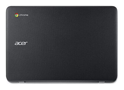

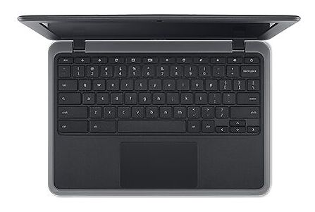

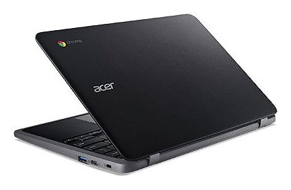

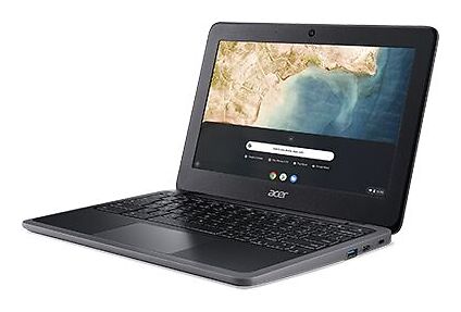

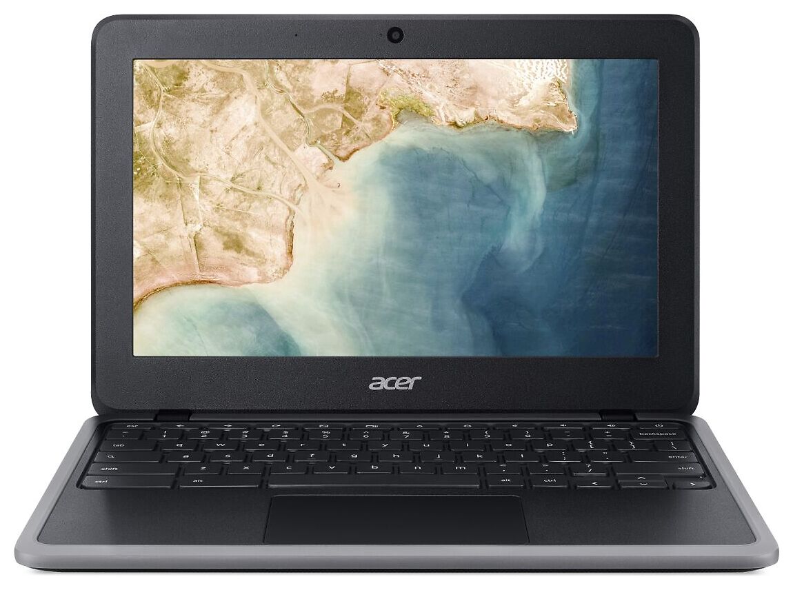

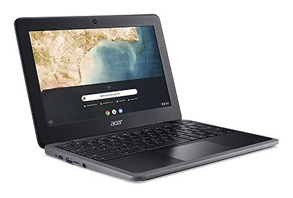

Acer Chromebook C733-C0L7 Chromebook 311 Specification for Upgrade or Repair
    Acer Chromebook C733-C0L7 Chromebook 311 Specification for Upgrade or Repair
    This specification for the Acer Chromebook C733-C0L7 Chromebook can be useful for upgrading or repairing a laptop that is not working. As a community we are working through our specifications to add valuable data like the C733-C0L7 boardview and C733-C0L7 schematic. Our users have donated over 1 million documents which are being added to the site. This page will be updated soon with additional information. Alternatively you can request additional help from our users directly on the relevant badcaps forum. Please note that we offer no warranties that any specification, datasheet, or download for Acer Chromebook C733-C0L7 Chromebook is accurate, safe, error free, or the fix you require.
    Design > Brand: Acer
    Design > Family: Chromebook
    Design > Model Name: C733-C0L7
    Design > Part Number: NX.ATSET.001
    Design > Release Date: 22/07/2021
    Design > Series: 311
    Display > HD Type: HD
    Display > Panel Type: LCD
    Graphics > On-board Graphics Card ID: 0x3185
    Specification > Battery: 12 hrs 3920mAh
    Specification > Processor: N4020 1.1GHz
    Specification > Storage: 32GB Flash
    Memory > Internal Memory: 4GB
    Processor > Processor Codename: Gemini Lake Refresh
    Processor > Processor Family: Intel Celeron N
    Processor > Processor Model: N4020
    Product Code: NX.ATSET.001
    Battery > Battery Capacity: 3920mAh
    Weight And Dimensions > Depth: 209mm
    Weight And Dimensions > Height: 21.3mm
    Weight And Dimensions > Width: 302mm
    Acer Chromebook C733-C0L7 Chromebook 311 Specification for Upgrade or Repair
    Acer Chromebook C771T-56G3 Chromebook 11 Specification for Upgrade or Repair
    This specification for the Acer Chromebook C771T-56G3 Chromebook can be useful for upgrading or repairing a laptop that is not working. As a community we are working through our specifications to add valuable data like the C771T-56G3 boardview and C771T-56G3 schematic. Our users have donated over 1 million documents which are being added to the site. This page will be updated soon with additional information. Alternatively you can request additional help from our users directly on the relevant badcaps forum. Please note that we offer no warranties that any specification, datasheet, or download...
    09-06-2024, 06:06 AM
    Acer Chromebook CP713-1WN-866Q Chromebook Spin 13 Specification for Upgrade or Repair
    This specification for the Acer Chromebook CP713-1WN-866Q Chromebook can be useful for upgrading or repairing a laptop that is not working. As a community we are working through our specifications to add valuable data like the CP713-1WN-866Q boardview and CP713-1WN-866Q schematic. Our users have donated over 1 million documents which are being added to the site. This page will be updated soon with additional information. Alternatively you can request additional help from our users directly on the relevant badcaps forum. Please note that we offer no warranties that any specification, datasheet,...
    09-06-2024, 07:14 AM
    Acer Chromebook CB713-1W-5549 Chromebook 13 Specification for Upgrade or Repair
    This specification for the Acer Chromebook CB713-1W-5549 Chromebook can be useful for upgrading or repairing a laptop that is not working. As a community we are working through our specifications to add valuable data like the CB713-1W-5549 boardview and CB713-1W-5549 schematic. Our users have donated over 1 million documents which are being added to the site. This page will be updated soon with additional information. Alternatively you can request additional help from our users directly on the relevant badcaps forum. Please note that we offer no warranties that any specification, datasheet, or...
    09-06-2024, 11:05 AM
    Acer Chromebook CB715-1WT-5591 Chromebook 715 Specification for Upgrade or Repair
    This specification for the Acer Chromebook CB715-1WT-5591 Chromebook can be useful for upgrading or repairing a laptop that is not working. As a community we are working through our specifications to add valuable data like the CB715-1WT-5591 boardview and CB715-1WT-5591 schematic. Our users have donated over 1 million documents which are being added to the site. This page will be updated soon with additional information. Alternatively you can request additional help from our users directly on the relevant badcaps forum. Please note that we offer no warranties that any specification, datasheet,...
    09-06-2024, 09:45 AM
    Acer Chromebook CP713-1WN-813G Chromebook Spin 13 Specification for Upgrade or Repair
    This specification for the Acer Chromebook CP713-1WN-813G Chromebook can be useful for upgrading or repairing a laptop that is not working. As a community we are working through our specifications to add valuable data like the CP713-1WN-813G boardview and CP713-1WN-813G schematic. Our users have donated over 1 million documents which are being added to the site. This page will be updated soon with additional information. Alternatively you can request additional help from our users directly on the relevant badcaps forum. Please note that we offer no warranties that any specification, datasheet,...
    09-06-2024, 09:32 AM
