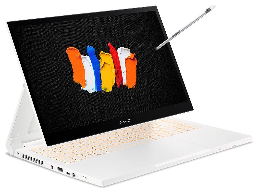

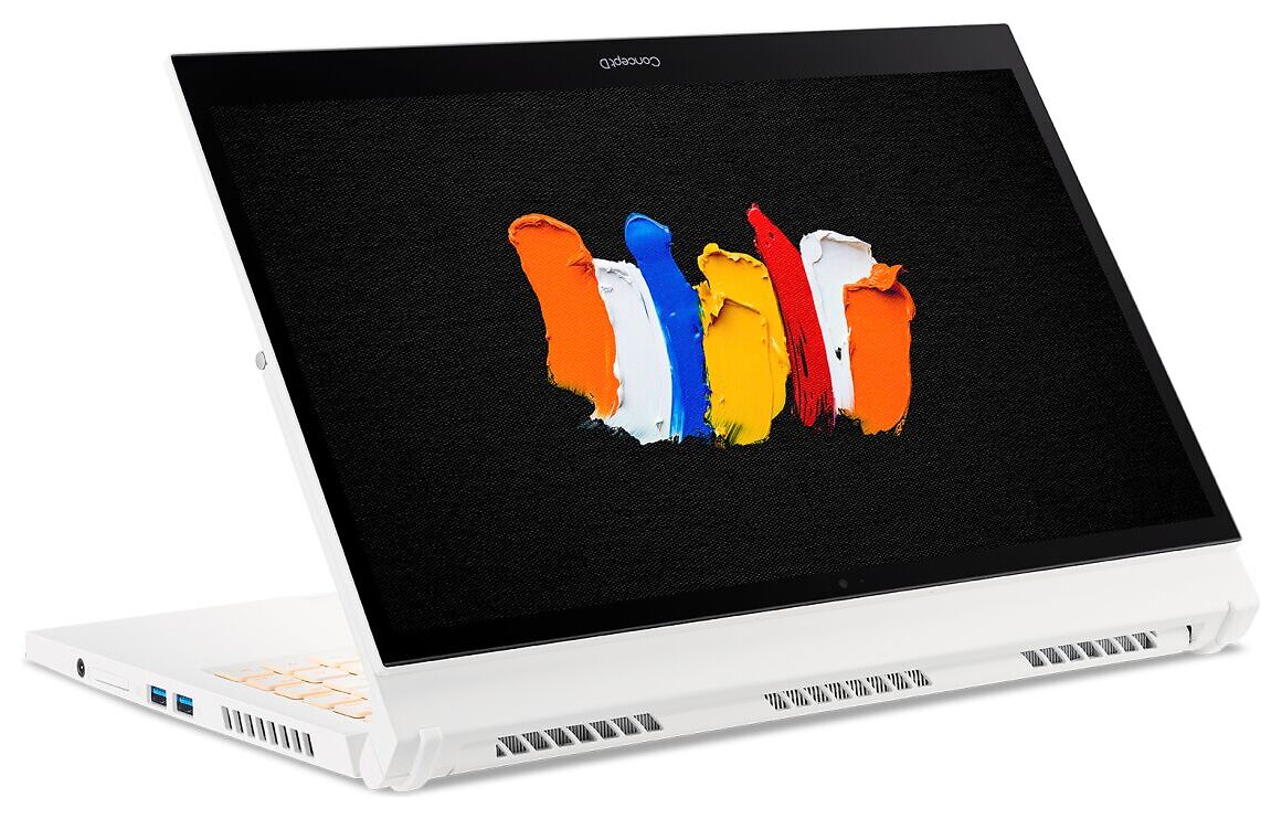

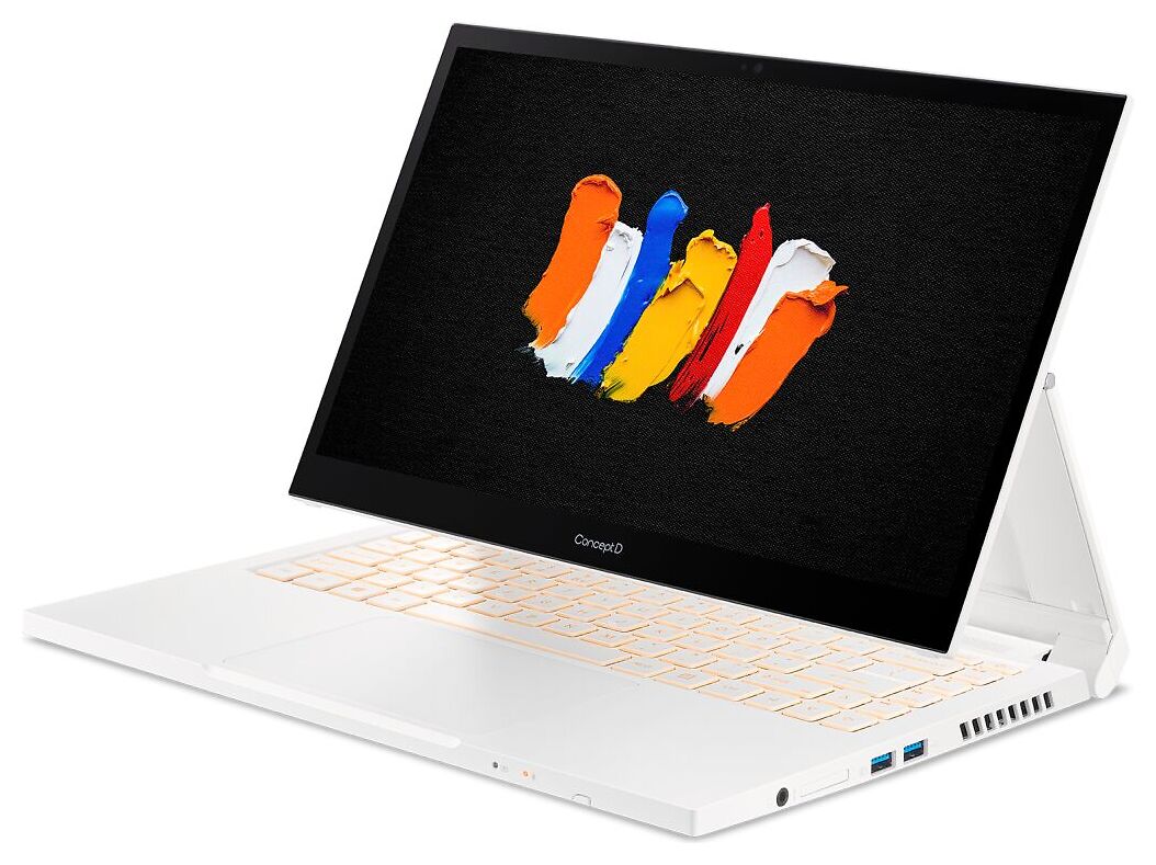

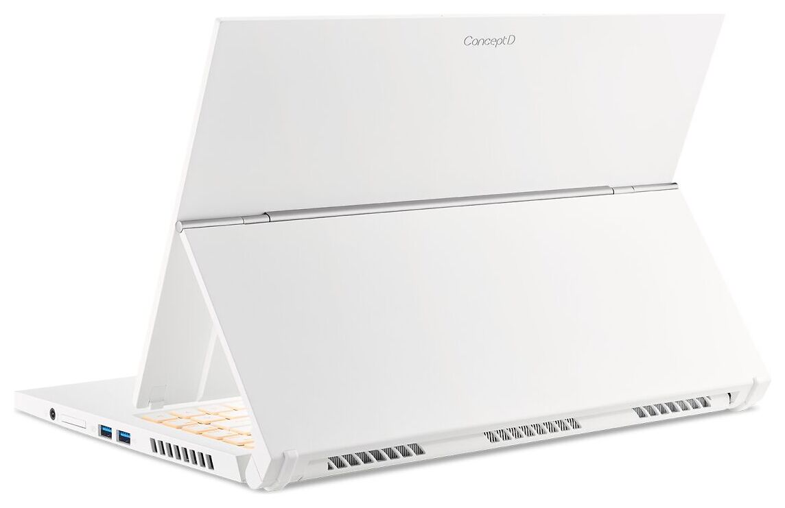

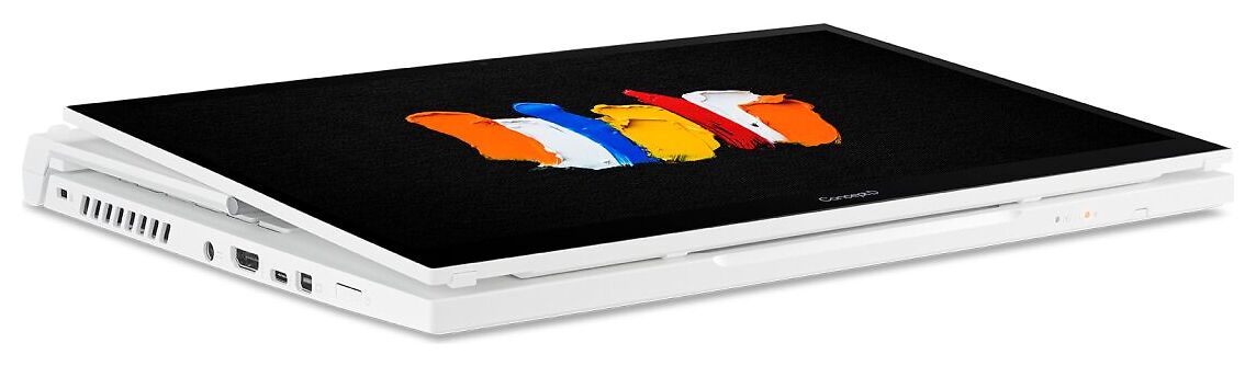

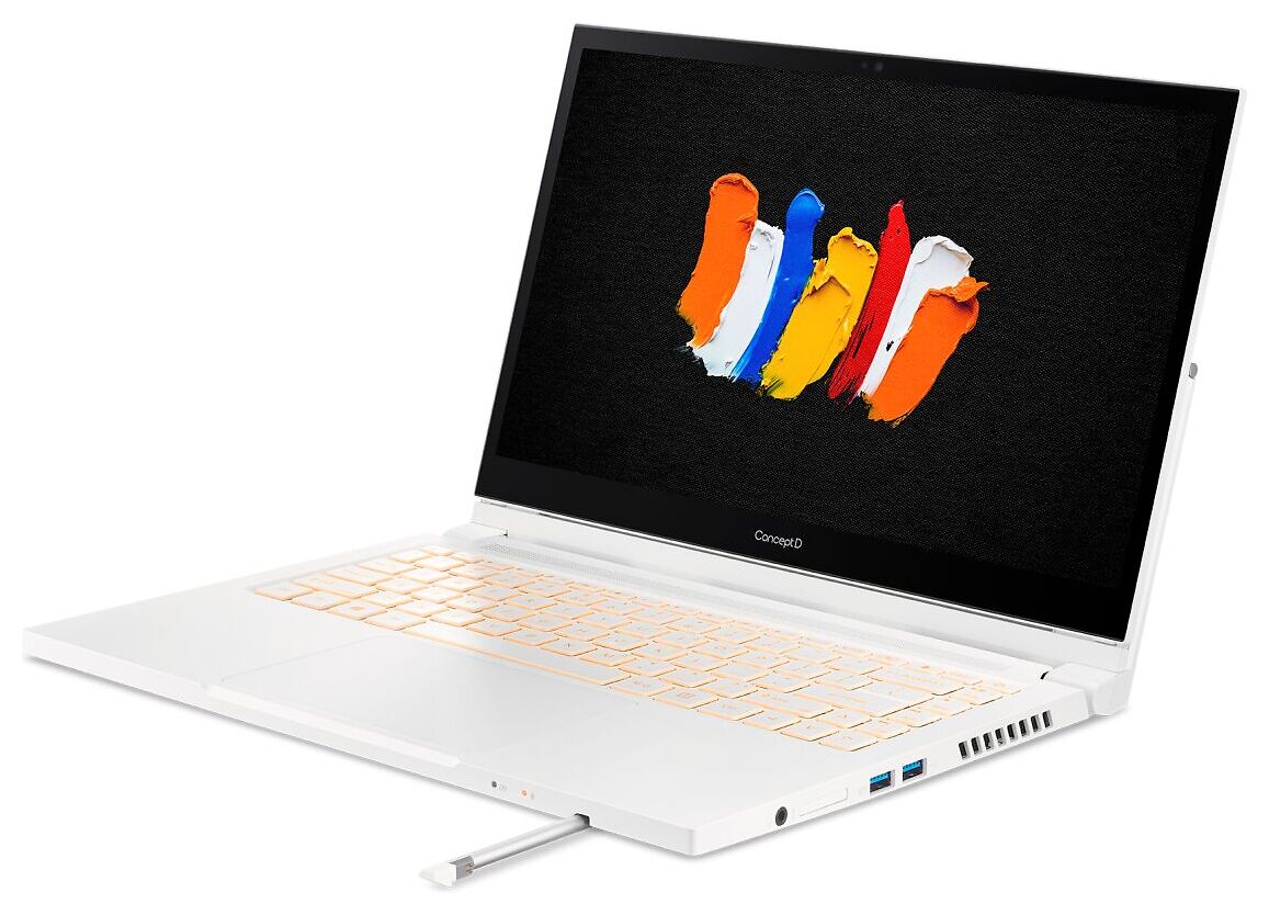

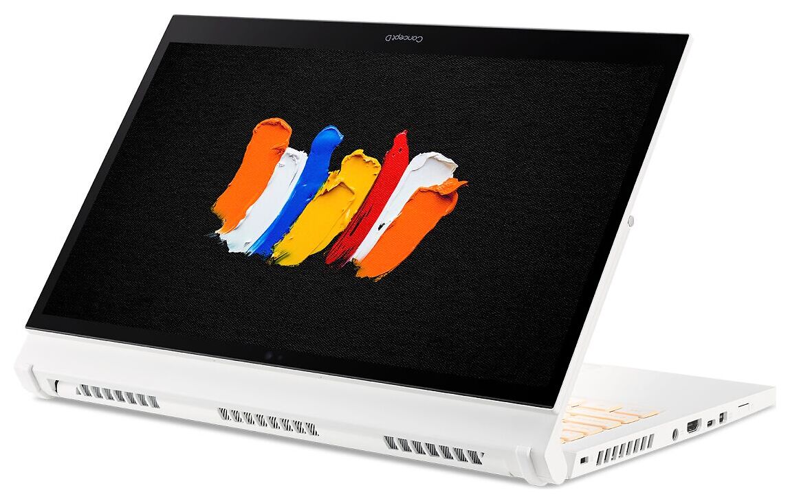

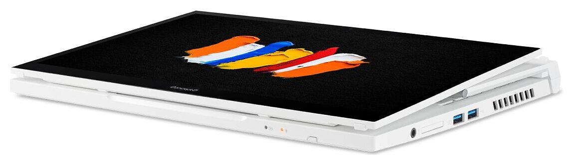

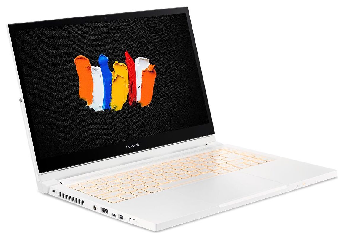

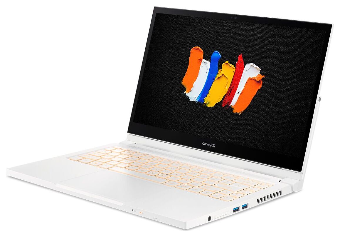

Acer ConceptD CC314-72G-79PF Hybrid (2-in-1) 3 Ezel Specification for Upgrade or Repair
    Acer ConceptD CC314-72G-79PF Hybrid (2-in-1) 3 Ezel Specification for Upgrade or Repair
    This specification for the Acer ConceptD CC314-72G-79PF Hybrid (2-in-1) can be useful for upgrading or repairing a laptop that is not working. As a community we are working through our specifications to add valuable data like the CC314-72G-79PF boardview and CC314-72G-79PF schematic. Our users have donated over 1 million documents which are being added to the site. This page will be updated soon with additional information. Alternatively you can request additional help from our users directly on the relevant badcaps forum. Please note that we offer no warranties that any specification, datasheet, or download for Acer ConceptD CC314-72G-79PF Hybrid (2-in-1) is accurate, safe, error free, or the fix you require.
    Design > Brand: Acer
    Design > Family: ConceptD
    Design > Form Factor: Convertible (Ezel)
    Design > Model Name: CC314-72G-79PF
    Design > Part Number: NX.C5HET.001
    Design > Release Date: 07/02/2021
    Design > Series: 3 Ezel
    Specification > Battery: 13.5 hrs
    Specification > Weight: 1.9kg
    Product Code: NX.C5HET.001
    Battery > Battery Life (max): 13.5 h
    Weight And Dimensions > Depth: 229mm
    Weight And Dimensions > Height (front): 2.39 cm
    Weight And Dimensions > Height (rear): 1.79 cm
    Weight And Dimensions > Width: 326.7mm
    Acer ConceptD CC314-72G-79PF Hybrid (2-in-1) 3 Ezel Specification for Upgrade or Repair
    Acer ConceptD 3 Ezel Pro CC315-72P-76A7 Hybrid (2-in-1) 3 Ezel Specification for Upgrade or Repair
    This specification for the Acer ConceptD 3 Ezel Pro CC315-72P-76A7 Hybrid (2-in-1) can be useful for upgrading or repairing a laptop that is not working. As a community we are working through our specifications to add valuable data like the 3 Ezel Pro CC315-72P-76A7 boardview and 3 Ezel Pro CC315-72P-76A7 schematic. Our users have donated over 1 million documents which are being added to the site. This page will be updated soon with additional information. Alternatively you can request additional help from our users directly on the relevant badcaps forum. Please note that we offer no warranties...
    09-06-2024, 09:10 PM
    Acer ConceptD 3 Ezel Pro CC315-72P-72DP Hybrid (2-in-1) 3 Ezel Specification for Upgrade or Repair
    This specification for the Acer ConceptD 3 Ezel Pro CC315-72P-72DP Hybrid (2-in-1) can be useful for upgrading or repairing a laptop that is not working. As a community we are working through our specifications to add valuable data like the 3 Ezel Pro CC315-72P-72DP boardview and 3 Ezel Pro CC315-72P-72DP schematic. Our users have donated over 1 million documents which are being added to the site. This page will be updated soon with additional information. Alternatively you can request additional help from our users directly on the relevant badcaps forum. Please note that we offer no warranties...
    09-06-2024, 09:10 PM
    Acer ConceptD Ezel CC314-73G Hybrid (2-in-1) 3 Ezel Specification for Upgrade or Repair
    This specification for the Acer ConceptD Ezel CC314-73G Hybrid (2-in-1) can be useful for upgrading or repairing a laptop that is not working. As a community we are working through our specifications to add valuable data like the Ezel CC314-73G boardview and Ezel CC314-73G schematic. Our users have donated over 1 million documents which are being added to the site. This page will be updated soon with additional information. Alternatively you can request additional help from our users directly on the relevant badcaps forum. Please note that we offer no warranties that any specification, datasheet,...
    09-07-2024, 02:50 AM
    Acer ConceptD 7 Ezel CC715-71-78MV Hybrid (2-in-1) Specification for Upgrade or Repair
    This specification for the Acer ConceptD 7 Ezel CC715-71-78MV Hybrid (2-in-1) can be useful for upgrading or repairing a laptop that is not working. As a community we are working through our specifications to add valuable data like the 7 Ezel CC715-71-78MV boardview and 7 Ezel CC715-71-78MV schematic. Our users have donated over 1 million documents which are being added to the site. This page will be updated soon with additional information. Alternatively you can request additional help from our users directly on the relevant badcaps forum. Please note that we offer no warranties that any specification,...
    09-06-2024, 03:30 PM
    Acer ConceptD CC314-73G-75UK Hybrid (2-in-1) 3 Ezel Specification for Upgrade or Repair
    This specification for the Acer ConceptD CC314-73G-75UK Hybrid (2-in-1) can be useful for upgrading or repairing a laptop that is not working. As a community we are working through our specifications to add valuable data like the CC314-73G-75UK boardview and CC314-73G-75UK schematic. Our users have donated over 1 million documents which are being added to the site. This page will be updated soon with additional information. Alternatively you can request additional help from our users directly on the relevant badcaps forum. Please note that we offer no warranties that any specification, datasheet,...
    09-07-2024, 06:21 AM
