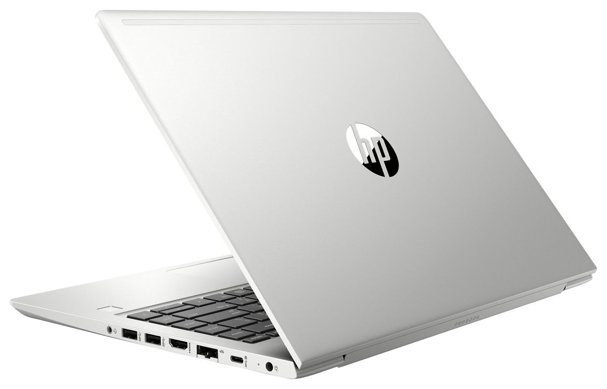

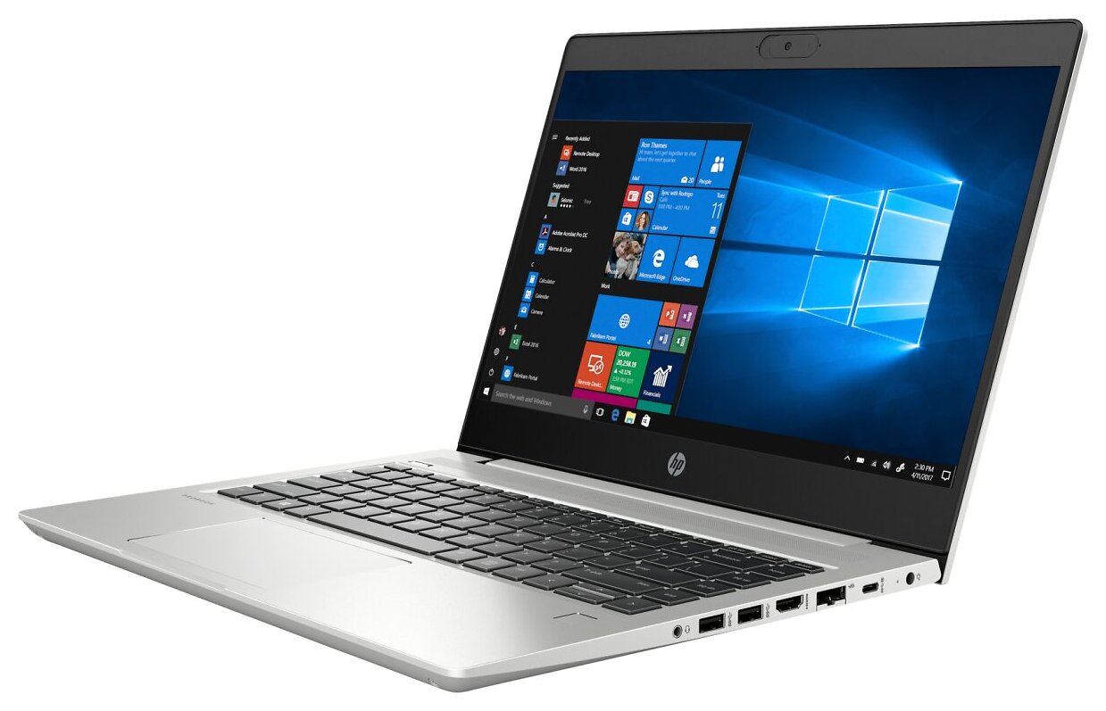

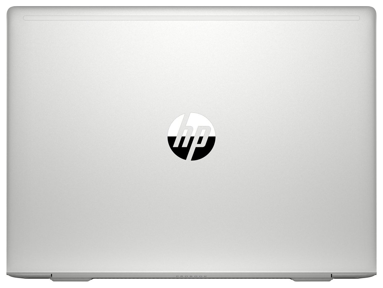

HP ProBook 440 G7 Notebook 400 Specification for Upgrade or Repair
    HP ProBook 440 G7 Notebook 400 Specification for Upgrade or Repair
    This specification for the HP ProBook 440 G7 Notebook can be useful for upgrading or repairing a laptop that is not working. As a community we are working through our specifications to add valuable data like the 440 G7 boardview and 440 G7 schematic. Our users have donated over 1 million documents which are being added to the site. This page will be updated soon with additional information. Alternatively you can request additional help from our users directly on the relevant badcaps forum. Please note that we offer no warranties that any specification, datasheet, or download for HP ProBook 440 G7 Notebook is accurate, safe, error free, or the fix you require.
    Design > Family: ProBook
    Design > Market Positioning: Everyday
    Design > Model Name: 440 G7
    Design > Part Number: 1Q2X3ES
    Design > Release Date: 25/07/2020
    Design > Series: 400
    Specification > Battery: 45 Wh
    Product Code: 1Q2X3ES
    Weight And Dimensions > Depth: 237.7mm
    Weight And Dimensions > Width: 324.2mm
    HP ProBook 440 G7 Notebook 400 Specification for Upgrade or Repair
    HP ProBook ProBook 440 G3 Notebook PC (ENERGY STAR) Notebook 400 Specification for Upgrade or Repair
    This specification for the HP ProBook ProBook 440 G3 Notebook PC (ENERGY STAR) Notebook can be useful for upgrading or repairing a laptop that is not working. As a community we are working through our specifications to add valuable data like the ProBook 440 G3 Notebook PC (ENERGY STAR) boardview and ProBook 440 G3 Notebook PC (ENERGY STAR) schematic. Our users have donated over 1 million documents which are being added to the site. This page will be updated soon with additional information. Alternatively you can request additional help from our users directly on the relevant badcaps forum. Please...
    09-06-2024, 05:30 AM
    HP ProBook ProBook 470 G5 Notebook PC Notebook 400 Specification for Upgrade or Repair
    This specification for the HP ProBook ProBook 470 G5 Notebook PC Notebook can be useful for upgrading or repairing a laptop that is not working. As a community we are working through our specifications to add valuable data like the ProBook 470 G5 Notebook PC boardview and ProBook 470 G5 Notebook PC schematic. Our users have donated over 1 million documents which are being added to the site. This page will be updated soon with additional information. Alternatively you can request additional help from our users directly on the relevant badcaps forum. Please note that we offer no warranties that...
    09-06-2024, 06:40 AM
    HP ProBook 650 G2 Notebook 600 Specification for Upgrade or Repair
    This specification for the HP ProBook 650 G2 Notebook can be useful for upgrading or repairing a laptop that is not working. As a community we are working through our specifications to add valuable data like the 650 G2 boardview and 650 G2 schematic. Our users have donated over 1 million documents which are being added to the site. This page will be updated soon with additional information. Alternatively you can request additional help from our users directly on the relevant badcaps forum. Please note that we offer no warranties that any specification, datasheet, or download for HP ProBook 650...
    09-06-2024, 05:33 AM
    HP ProBook ProBook 470 G5 Notebook PC Notebook 400 Specification for Upgrade or Repair
    This specification for the HP ProBook ProBook 470 G5 Notebook PC Notebook can be useful for upgrading or repairing a laptop that is not working. As a community we are working through our specifications to add valuable data like the ProBook 470 G5 Notebook PC boardview and ProBook 470 G5 Notebook PC schematic. Our users have donated over 1 million documents which are being added to the site. This page will be updated soon with additional information. Alternatively you can request additional help from our users directly on the relevant badcaps forum. Please note that we offer no warranties that...
    09-06-2024, 06:40 AM
    HP ProBook ProBook 450 G5 Notebook PC Notebook 400 Specification for Upgrade or Repair
    This specification for the HP ProBook ProBook 450 G5 Notebook PC Notebook can be useful for upgrading or repairing a laptop that is not working. As a community we are working through our specifications to add valuable data like the ProBook 450 G5 Notebook PC boardview and ProBook 450 G5 Notebook PC schematic. Our users have donated over 1 million documents which are being added to the site. This page will be updated soon with additional information. Alternatively you can request additional help from our users directly on the relevant badcaps forum. Please note that we offer no warranties that...
    09-06-2024, 06:00 AM
