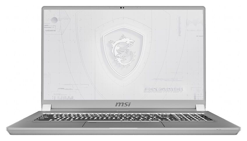

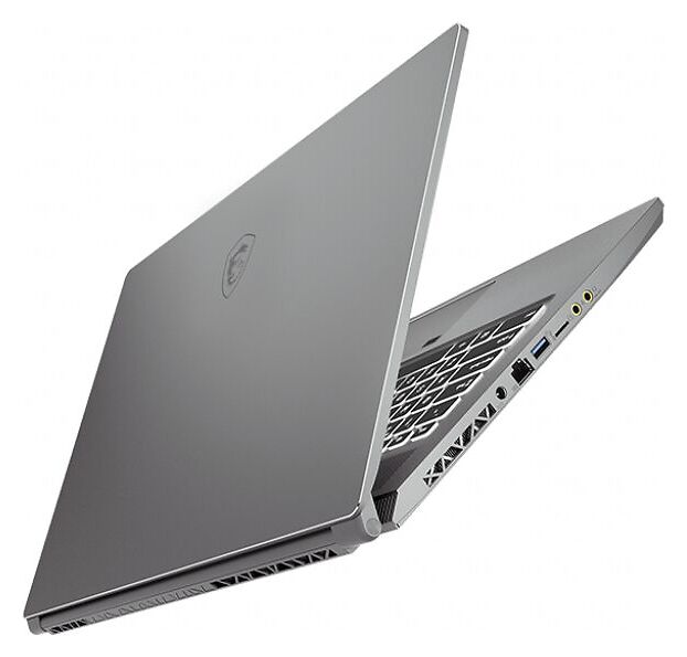

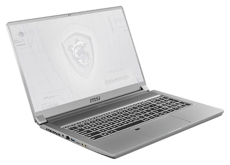

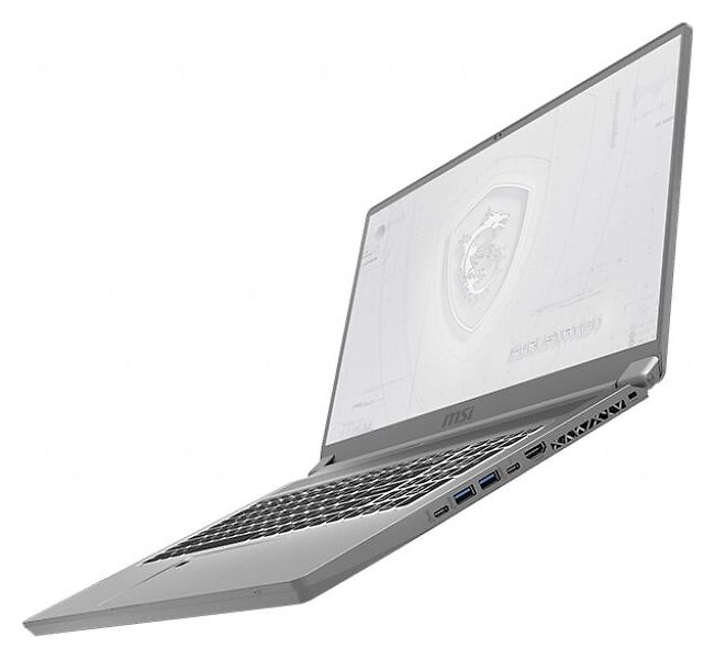

MSI Workstation WS75 10TL-463 Mobile workstation WS75 Specification for Upgrade or Repair
    MSI Workstation WS75 10TL-463 Mobile workstation WS75 Specification for Upgrade or Repair
    This specification for the MSI Workstation WS75 10TL-463 Mobile workstation can be useful for upgrading or repairing a laptop that is not working. As a community we are working through our specifications to add valuable data like the WS75 10TL-463 boardview and WS75 10TL-463 schematic. Our users have donated over 1 million documents which are being added to the site. This page will be updated soon with additional information. Alternatively you can request additional help from our users directly on the relevant badcaps forum. Please note that we offer no warranties that any specification, datasheet, or download for MSI Workstation WS75 10TL-463 Mobile workstation is accurate, safe, error free, or the fix you require.
    Design > Brand: MSI
    Design > Family: Workstation
    Design > Model Name: WS75 10TL-463
    Design > Part Number: WS75 10TL-463
    Design > Product Colour: Gray
    Design > Release Date: 22/07/2020
    Design > Series: WS75
    Graphics > Discrete Graphics Adapter Model: NVIDIA Quadro RTX 4000
    Specification > Processor: i7-10875H 2.3GHz
    Specification > Weight: 2.5kg
    Processor > Processor Boost Frequency: 5.1GHz
    Processor > Processor Model: i7-10875H
    Product Code: WS75 10TL-463
    Weight And Dimensions > Depth: 259.4mm
    Weight And Dimensions > Height: 20.2mm
    Weight And Dimensions > Weight: 2.5kg
    Weight And Dimensions > Width: 396.1mm
    MSI Workstation WS75 10TL-463 Mobile workstation WS75 Specification for Upgrade or Repair
    MSI Workstation WS75 9TK-498 Mobile workstation WS75 Specification for Upgrade or Repair
    This specification for the MSI Workstation WS75 9TK-498 Mobile workstation can be useful for upgrading or repairing a laptop that is not working. As a community we are working through our specifications to add valuable data like the WS75 9TK-498 boardview and WS75 9TK-498 schematic. Our users have donated over 1 million documents which are being added to the site. This page will be updated soon with additional information. Alternatively you can request additional help from our users directly on the relevant badcaps forum. Please note that we offer no warranties that any specification, datasheet,...
    09-06-2024, 08:58 AM
    MSI Workstation WS75 9TK-610ES Mobile workstation WS75 Specification for Upgrade or Repair
    This specification for the MSI Workstation WS75 9TK-610ES Mobile workstation can be useful for upgrading or repairing a laptop that is not working. As a community we are working through our specifications to add valuable data like the WS75 9TK-610ES boardview and WS75 9TK-610ES schematic. Our users have donated over 1 million documents which are being added to the site. This page will be updated soon with additional information. Alternatively you can request additional help from our users directly on the relevant badcaps forum. Please note that we offer no warranties that any specification, datasheet,...
    09-06-2024, 11:40 AM
    MSI Workstation WS75 9TK-499 Mobile workstation WS75 Specification for Upgrade or Repair
    This specification for the MSI Workstation WS75 9TK-499 Mobile workstation can be useful for upgrading or repairing a laptop that is not working. As a community we are working through our specifications to add valuable data like the WS75 9TK-499 boardview and WS75 9TK-499 schematic. Our users have donated over 1 million documents which are being added to the site. This page will be updated soon with additional information. Alternatively you can request additional help from our users directly on the relevant badcaps forum. Please note that we offer no warranties that any specification, datasheet,...
    09-06-2024, 08:58 AM
    MSI Workstation WS75 9TJ-002 Mobile workstation WS75 Specification for Upgrade or Repair
    This specification for the MSI Workstation WS75 9TJ-002 Mobile workstation can be useful for upgrading or repairing a laptop that is not working. As a community we are working through our specifications to add valuable data like the WS75 9TJ-002 boardview and WS75 9TJ-002 schematic. Our users have donated over 1 million documents which are being added to the site. This page will be updated soon with additional information. Alternatively you can request additional help from our users directly on the relevant badcaps forum. Please note that we offer no warranties that any specification, datasheet,...
    09-06-2024, 09:01 AM
    MSI Workstation WS75 9TK-637 Mobile workstation WS75 Specification for Upgrade or Repair
    This specification for the MSI Workstation WS75 9TK-637 Mobile workstation can be useful for upgrading or repairing a laptop that is not working. As a community we are working through our specifications to add valuable data like the WS75 9TK-637 boardview and WS75 9TK-637 schematic. Our users have donated over 1 million documents which are being added to the site. This page will be updated soon with additional information. Alternatively you can request additional help from our users directly on the relevant badcaps forum. Please note that we offer no warranties that any specification, datasheet,...
    09-06-2024, 09:09 AM
