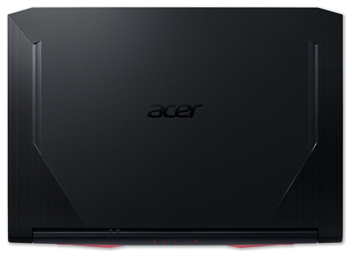

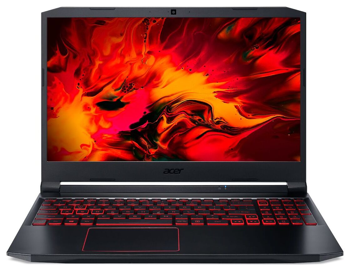

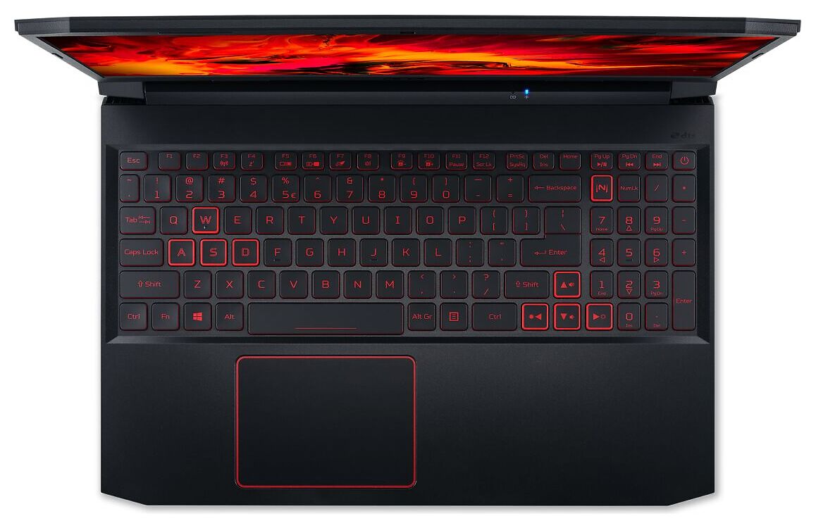

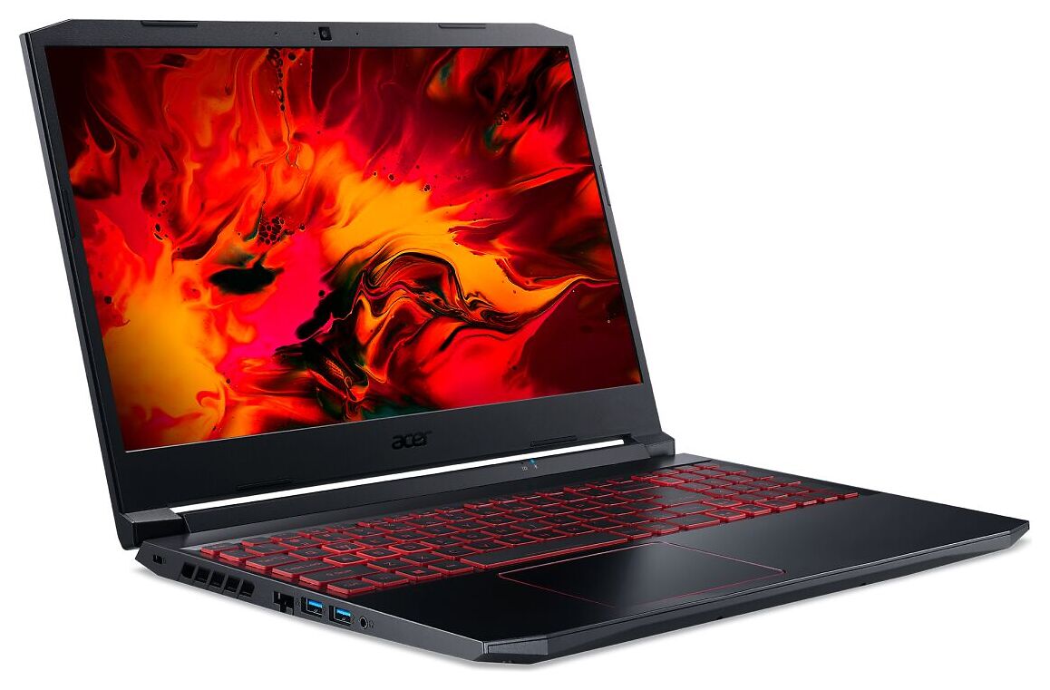

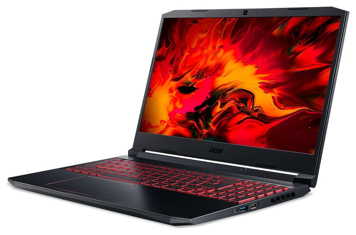

Acer Nitro AN515-55-7153 Notebook 5 Specification for Upgrade or Repair
    Acer Nitro AN515-55-7153 Notebook 5 Specification for Upgrade or Repair
    This specification for the Acer Nitro AN515-55-7153 Notebook can be useful for upgrading or repairing a laptop that is not working. As a community we are working through our specifications to add valuable data like the AN515-55-7153 boardview and AN515-55-7153 schematic. Our users have donated over 1 million documents which are being added to the site. This page will be updated soon with additional information. Alternatively you can request additional help from our users directly on the relevant badcaps forum. Please note that we offer no warranties that any specification, datasheet, or download for Acer Nitro AN515-55-7153 Notebook is accurate, safe, error free, or the fix you require.
    Design > Brand: Acer
    Design > Family: Nitro
    Design > Model Name: AN515-55-7153
    Design > Part Number: NH.Q7QET.004
    Design > Release Date: 19/06/2020
    Design > Series: 5
    Specification > Battery: 8 hrs 3560mAh
    Specification > Weight: 2.3kg
    Product Code: NH.Q7QET.004
    Battery > Battery Capacity: 3560mAh
    Acer Nitro AN515-55-7153 Notebook 5 Specification for Upgrade or Repair
    Acer Nitro Nitro AN515-52-55B9 Notebook 5 Specification for Upgrade or Repair
    This specification for the Acer Nitro Nitro AN515-52-55B9 Notebook can be useful for upgrading or repairing a laptop that is not working. As a community we are working through our specifications to add valuable data like the Nitro AN515-52-55B9 boardview and Nitro AN515-52-55B9 schematic. Our users have donated over 1 million documents which are being added to the site. This page will be updated soon with additional information. Alternatively you can request additional help from our users directly on the relevant badcaps forum. Please note that we offer no warranties that any specification, datasheet,...
    09-06-2024, 06:34 AM
    Acer Nitro Nitro 5 Notebook 5 Specification for Upgrade or Repair
    This specification for the Acer Nitro Nitro 5 Notebook can be useful for upgrading or repairing a laptop that is not working. As a community we are working through our specifications to add valuable data like the Nitro 5 boardview and Nitro 5 schematic. Our users have donated over 1 million documents which are being added to the site. This page will be updated soon with additional information. Alternatively you can request additional help from our users directly on the relevant badcaps forum. Please note that we offer no warranties that any specification, datasheet, or download for Acer Nitro...
    09-06-2024, 09:30 PM
    Acer Nitro AN515-52-746R Notebook 5 Specification for Upgrade or Repair
    This specification for the Acer Nitro AN515-52-746R Notebook can be useful for upgrading or repairing a laptop that is not working. As a community we are working through our specifications to add valuable data like the AN515-52-746R boardview and AN515-52-746R schematic. Our users have donated over 1 million documents which are being added to the site. This page will be updated soon with additional information. Alternatively you can request additional help from our users directly on the relevant badcaps forum. Please note that we offer no warranties that any specification, datasheet, or download...
    09-06-2024, 08:52 AM
    Acer Nitro NP515-51-88MT Hybrid (2-in-1) 5 Spin Specification for Upgrade or Repair
    This specification for the Acer Nitro NP515-51-88MT Hybrid (2-in-1) can be useful for upgrading or repairing a laptop that is not working. As a community we are working through our specifications to add valuable data like the NP515-51-88MT boardview and NP515-51-88MT schematic. Our users have donated over 1 million documents which are being added to the site. This page will be updated soon with additional information. Alternatively you can request additional help from our users directly on the relevant badcaps forum. Please note that we offer no warranties that any specification, datasheet, or...
    09-06-2024, 07:29 AM
    Acer Nitro AN515-52-51QL Notebook 5 Specification for Upgrade or Repair
    This specification for the Acer Nitro AN515-52-51QL Notebook can be useful for upgrading or repairing a laptop that is not working. As a community we are working through our specifications to add valuable data like the AN515-52-51QL boardview and AN515-52-51QL schematic. Our users have donated over 1 million documents which are being added to the site. This page will be updated soon with additional information. Alternatively you can request additional help from our users directly on the relevant badcaps forum. Please note that we offer no warranties that any specification, datasheet, or download...
    09-06-2024, 08:35 AM
