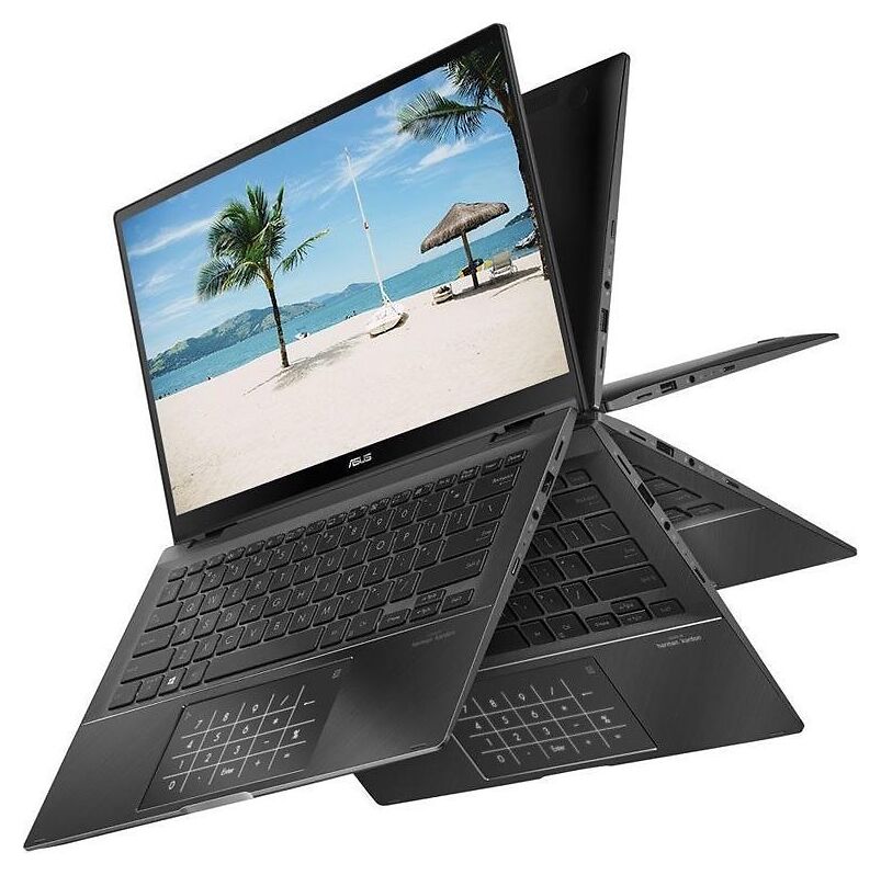

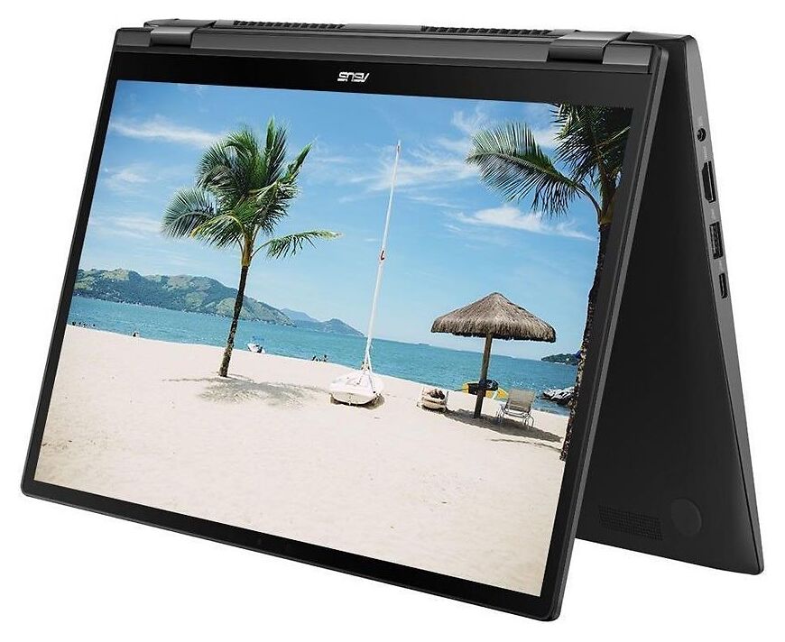

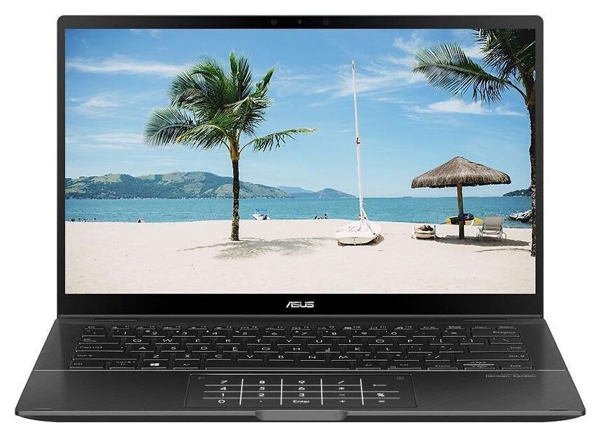

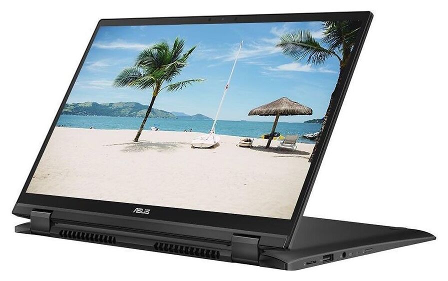

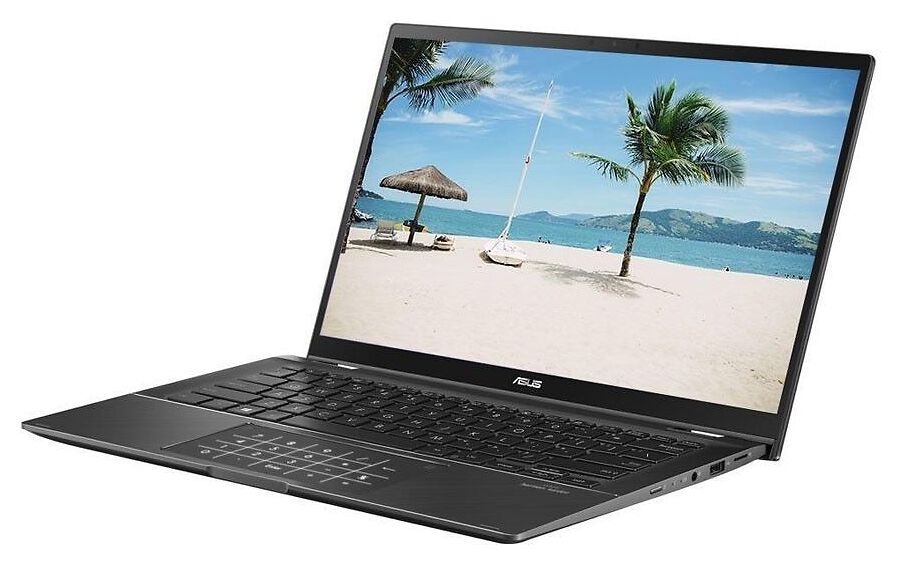

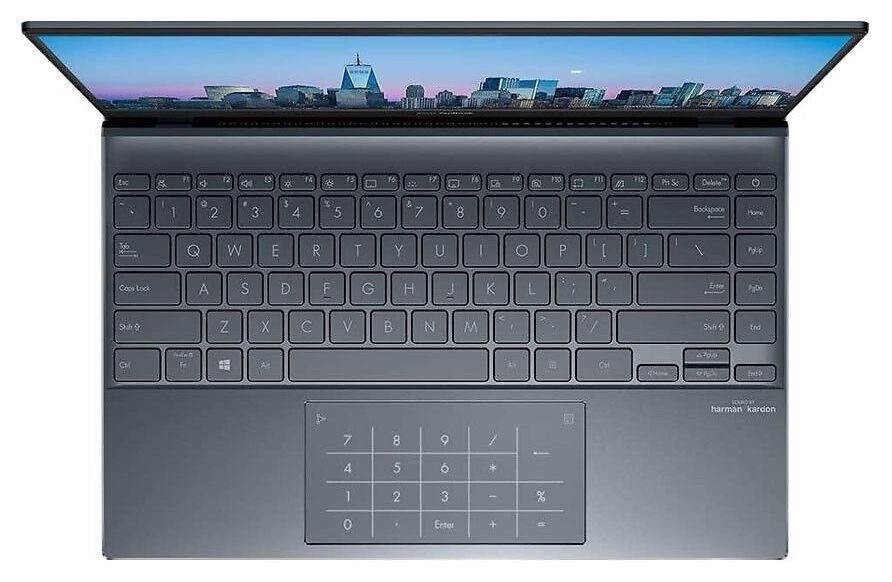

ASUS ZenBook UX463FL Hybrid (2-in-1) Flip 14 Specification for Upgrade or Repair
    ASUS ZenBook UX463FL Hybrid (2-in-1) Flip 14 Specification for Upgrade or Repair
    This specification for the ASUS ZenBook UX463FL Hybrid (2-in-1) can be useful for upgrading or repairing a laptop that is not working. As a community we are working through our specifications to add valuable data like the UX463FL boardview and UX463FL schematic. Our users have donated over 1 million documents which are being added to the site. This page will be updated soon with additional information. Alternatively you can request additional help from our users directly on the relevant badcaps forum. Please note that we offer no warranties that any specification, datasheet, or download for ASUS ZenBook UX463FL Hybrid (2-in-1) is accurate, safe, error free, or the fix you require.
    Design > Brand: ASUS
    Design > Family: ZenBook
    Design > Form Factor: Convertible (Swivel)
    Design > Model Name: UX463FL
    Design > Part Number: UX463FL-AI096T
    Design > Release Date: 07/06/2020
    Design > Series: Flip 14
    Display > Colour Gamut: 0.72
    Specification > Weight: 1.4kg
    Product Code: UX463FL-AI096T
    Audio > Speaker Power: 1W
    Display Diagonal (metric): 35.56 cm
    Optical Drive > Optical Drive Type: HD DVD-ROM
    Weight And Dimensions > Depth: 206mm
    Weight And Dimensions > Width: 320mm
    ASUS ZenBook UX463FL Hybrid (2-in-1) Flip 14 Specification for Upgrade or Repair
    ASUS ZenBook UX463FL-AI031R Hybrid (2-in-1) Flip 14 Specification for Upgrade or Repair
    This specification for the ASUS ZenBook UX463FL-AI031R Hybrid (2-in-1) can be useful for upgrading or repairing a laptop that is not working. As a community we are working through our specifications to add valuable data like the UX463FL-AI031R boardview and UX463FL-AI031R schematic. Our users have donated over 1 million documents which are being added to the site. This page will be updated soon with additional information. Alternatively you can request additional help from our users directly on the relevant badcaps forum. Please note that we offer no warranties that any specification, datasheet,...
    09-06-2024, 11:14 AM
    ASUS ZenBook UX463FL-AI023R Hybrid (2-in-1) Flip 14 Specification for Upgrade or Repair
    This specification for the ASUS ZenBook UX463FL-AI023R Hybrid (2-in-1) can be useful for upgrading or repairing a laptop that is not working. As a community we are working through our specifications to add valuable data like the UX463FL-AI023R boardview and UX463FL-AI023R schematic. Our users have donated over 1 million documents which are being added to the site. This page will be updated soon with additional information. Alternatively you can request additional help from our users directly on the relevant badcaps forum. Please note that we offer no warranties that any specification, datasheet,...
    09-06-2024, 09:53 AM
    ASUS ZenBook UX463FL-AI055T Hybrid (2-in-1) Flip 14 Specification for Upgrade or Repair
    This specification for the ASUS ZenBook UX463FL-AI055T Hybrid (2-in-1) can be useful for upgrading or repairing a laptop that is not working. As a community we are working through our specifications to add valuable data like the UX463FL-AI055T boardview and UX463FL-AI055T schematic. Our users have donated over 1 million documents which are being added to the site. This page will be updated soon with additional information. Alternatively you can request additional help from our users directly on the relevant badcaps forum. Please note that we offer no warranties that any specification, datasheet,...
    09-06-2024, 04:10 PM
    ASUS ZenBook UX463FL-AI064T Hybrid (2-in-1) Flip 14 Specification for Upgrade or Repair
    This specification for the ASUS ZenBook UX463FL-AI064T Hybrid (2-in-1) can be useful for upgrading or repairing a laptop that is not working. As a community we are working through our specifications to add valuable data like the UX463FL-AI064T boardview and UX463FL-AI064T schematic. Our users have donated over 1 million documents which are being added to the site. This page will be updated soon with additional information. Alternatively you can request additional help from our users directly on the relevant badcaps forum. Please note that we offer no warranties that any specification, datasheet,...
    09-06-2024, 04:10 PM
    ASUS ZenBook UX463FL-AI070T Hybrid (2-in-1) Flip 14 Specification for Upgrade or Repair
    This specification for the ASUS ZenBook UX463FL-AI070T Hybrid (2-in-1) can be useful for upgrading or repairing a laptop that is not working. As a community we are working through our specifications to add valuable data like the UX463FL-AI070T boardview and UX463FL-AI070T schematic. Our users have donated over 1 million documents which are being added to the site. This page will be updated soon with additional information. Alternatively you can request additional help from our users directly on the relevant badcaps forum. Please note that we offer no warranties that any specification, datasheet,...
    09-06-2024, 04:10 PM
