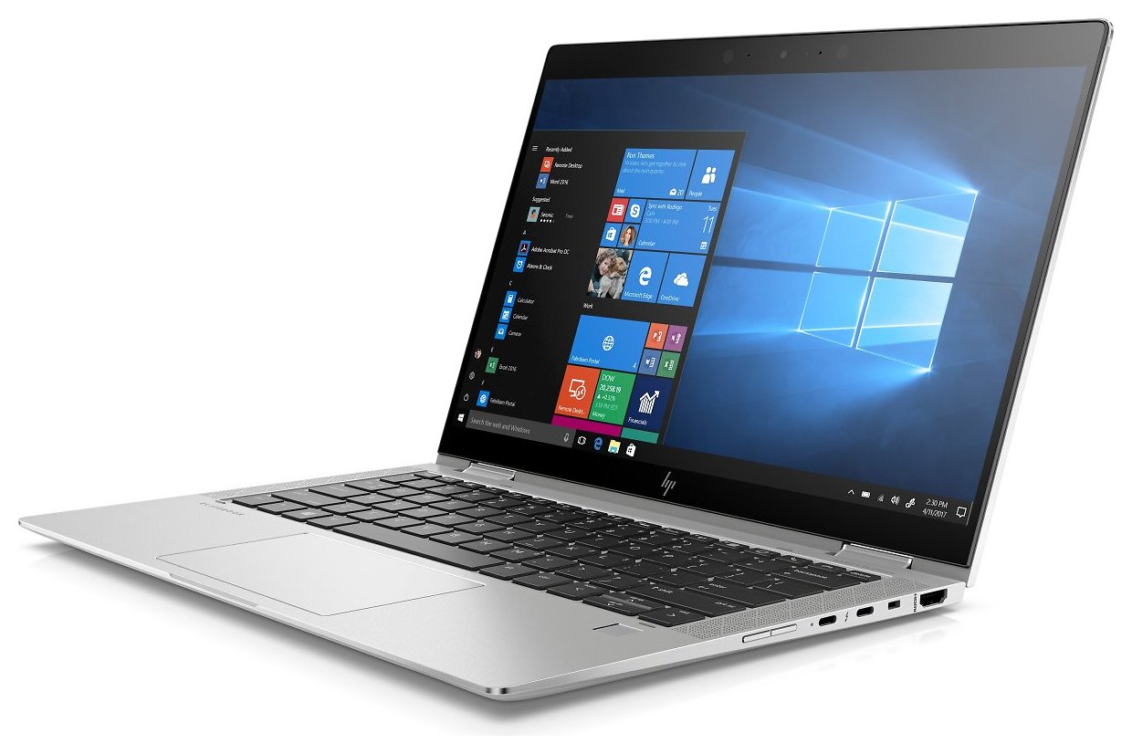

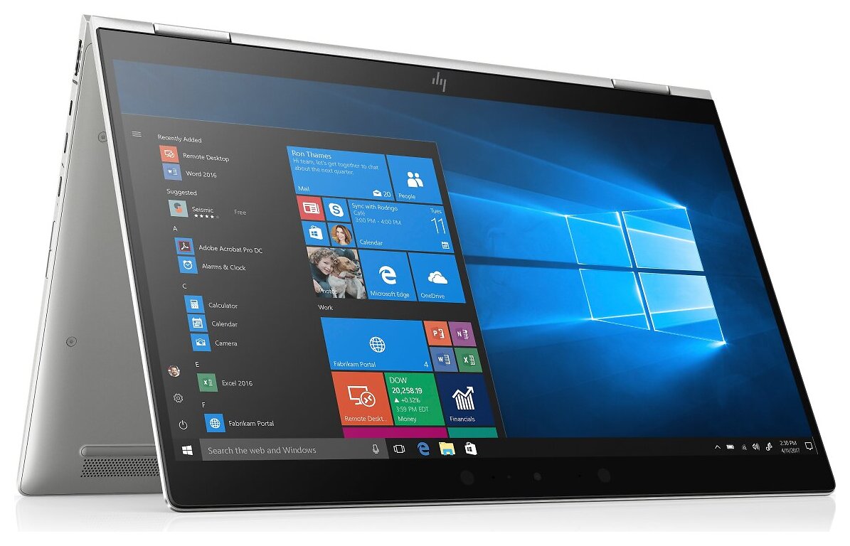

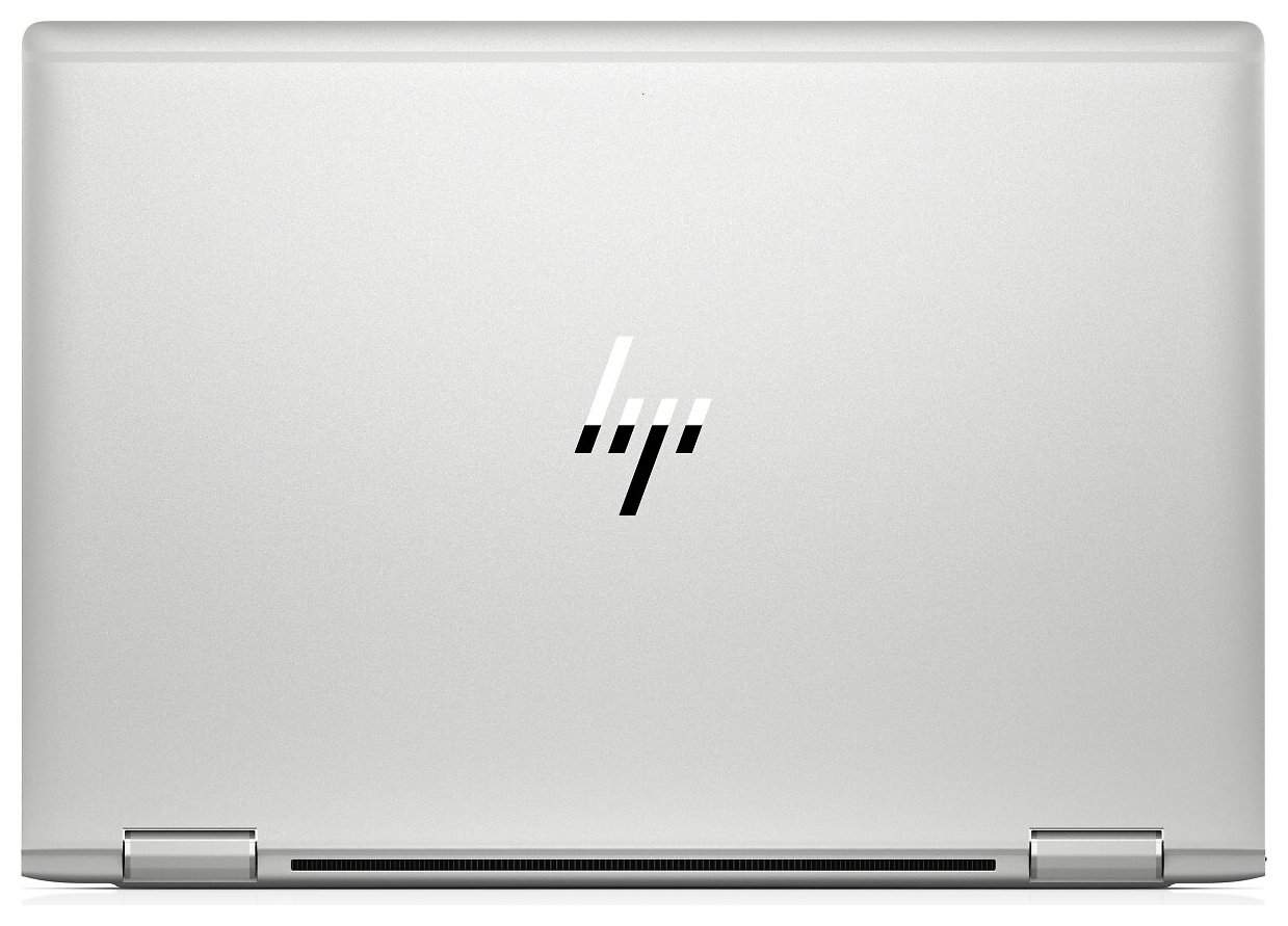

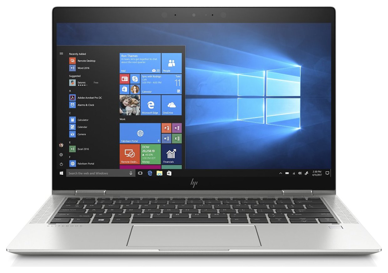

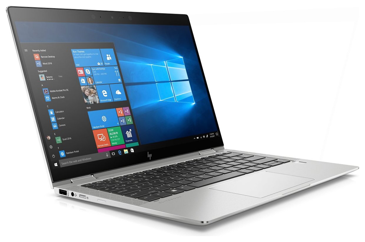

HP EliteBook x360 1030 G4 Hybrid (2-in-1) Specification for Upgrade or Repair
    HP EliteBook x360 1030 G4 Hybrid (2-in-1) Specification for Upgrade or Repair
    This specification for the HP EliteBook x360 1030 G4 Hybrid (2-in-1) can be useful for upgrading or repairing a laptop that is not working. As a community we are working through our specifications to add valuable data like the 1030 G4 boardview and 1030 G4 schematic. Our users have donated over 1 million documents which are being added to the site. This page will be updated soon with additional information. Alternatively you can request additional help from our users directly on the relevant badcaps forum. Please note that we offer no warranties that any specification, datasheet, or download for HP EliteBook x360 1030 G4 Hybrid (2-in-1) is accurate, safe, error free, or the fix you require.
    Design > Model Name: 1030 G4
    Design > Part Number: 8MK21ES
    Design > Release Date: 04/06/2020
    Specification > Battery: 56.2 Wh
    Specification > Weight: 1.27kg
    Product Code: 8MK21ES
    Battery > Battery Capacity: 56.2 Wh
    Weight And Dimensions > Depth: 205mm
    Weight And Dimensions > Height: 15.8mm
    Weight And Dimensions > Weight: 1.27kg
    Weight And Dimensions > Width: 305.8mm
    HP EliteBook x360 1030 G4 Hybrid (2-in-1) Specification for Upgrade or Repair
    HP EliteBook x360 EliteBook x360 1030 G2 Hybrid (2-in-1) Specification for Upgrade or Repair
    This specification for the HP EliteBook x360 EliteBook x360 1030 G2 Hybrid (2-in-1) can be useful for upgrading or repairing a laptop that is not working. As a community we are working through our specifications to add valuable data like the EliteBook x360 1030 G2 boardview and EliteBook x360 1030 G2 schematic. Our users have donated over 1 million documents which are being added to the site. This page will be updated soon with additional information. Alternatively you can request additional help from our users directly on the relevant badcaps forum. Please note that we offer no warranties that...
    09-06-2024, 08:27 AM
    HP EliteBook x360 EliteBook x360 1030 G2 (ENERGY STAR) Hybrid (2-in-1) Specification for Upgrade or Repair
    This specification for the HP EliteBook x360 EliteBook x360 1030 G2 (ENERGY STAR) Hybrid (2-in-1) can be useful for upgrading or repairing a laptop that is not working. As a community we are working through our specifications to add valuable data like the EliteBook x360 1030 G2 (ENERGY STAR) boardview and EliteBook x360 1030 G2 (ENERGY STAR) schematic. Our users have donated over 1 million documents which are being added to the site. This page will be updated soon with additional information. Alternatively you can request additional help from our users directly on the relevant badcaps forum. Please...
    09-06-2024, 05:33 AM
    HP EliteBook x360 EliteBook x360 1030 G2 (ENERGY STAR) Hybrid (2-in-1) Specification for Upgrade or Repair
    This specification for the HP EliteBook x360 EliteBook x360 1030 G2 (ENERGY STAR) Hybrid (2-in-1) can be useful for upgrading or repairing a laptop that is not working. As a community we are working through our specifications to add valuable data like the EliteBook x360 1030 G2 (ENERGY STAR) boardview and EliteBook x360 1030 G2 (ENERGY STAR) schematic. Our users have donated over 1 million documents which are being added to the site. This page will be updated soon with additional information. Alternatively you can request additional help from our users directly on the relevant badcaps forum. Please...
    09-06-2024, 06:40 AM
    HP EliteBook x360 EliteBook x360 1030 G2 (ENERGY STAR) Hybrid (2-in-1) Specification for Upgrade or Repair
    This specification for the HP EliteBook x360 EliteBook x360 1030 G2 (ENERGY STAR) Hybrid (2-in-1) can be useful for upgrading or repairing a laptop that is not working. As a community we are working through our specifications to add valuable data like the EliteBook x360 1030 G2 (ENERGY STAR) boardview and EliteBook x360 1030 G2 (ENERGY STAR) schematic. Our users have donated over 1 million documents which are being added to the site. This page will be updated soon with additional information. Alternatively you can request additional help from our users directly on the relevant badcaps forum. Please...
    09-06-2024, 05:33 AM
    HP EliteBook x360 EquipoEliteBook x360 1030 G4 Hybrid (2-in-1) Specification for Upgrade or Repair
    This specification for the HP EliteBook x360 EquipoEliteBook x360 1030 G4 Hybrid (2-in-1) can be useful for upgrading or repairing a laptop that is not working. As a community we are working through our specifications to add valuable data like the EquipoEliteBook x360 1030 G4 boardview and EquipoEliteBook x360 1030 G4 schematic. Our users have donated over 1 million documents which are being added to the site. This page will be updated soon with additional information. Alternatively you can request additional help from our users directly on the relevant badcaps forum. Please note that we offer...
    09-06-2024, 11:32 AM
