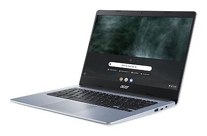

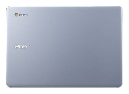

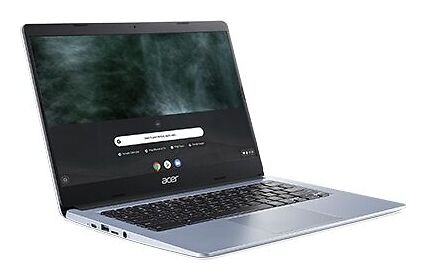

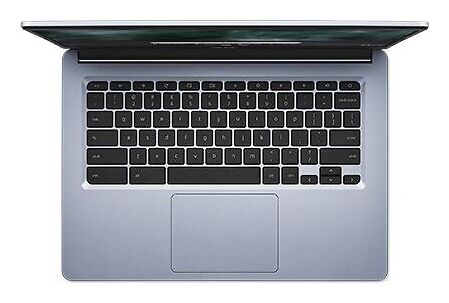

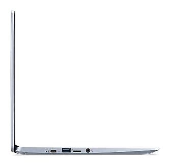

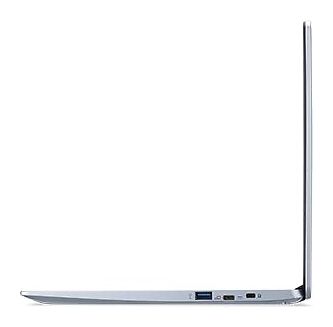

Acer Chromebook CB314-1H-C66Z Chromebook 314 Specification for Upgrade or Repair
    Acer Chromebook CB314-1H-C66Z Chromebook 314 Specification for Upgrade or Repair
    This specification for the Acer Chromebook CB314-1H-C66Z Chromebook can be useful for upgrading or repairing a laptop that is not working. As a community we are working through our specifications to add valuable data like the CB314-1H-C66Z boardview and CB314-1H-C66Z schematic. Our users have donated over 1 million documents which are being added to the site. This page will be updated soon with additional information. Alternatively you can request additional help from our users directly on the relevant badcaps forum. Please note that we offer no warranties that any specification, datasheet, or download for Acer Chromebook CB314-1H-C66Z Chromebook is accurate, safe, error free, or the fix you require.
    Design > Brand: Acer
    Design > Family: Chromebook
    Design > Model Name: CB314-1H-C66Z
    Design > Part Number: NX.HKDAA.002
    Design > Release Date: 31/05/2020
    Design > Series: 314
    Display > Display Resolution: 1366x786 pixels
    Display > HD Type: HD
    Display > Panel Type: LCD
    Graphics > On-board Graphics Adapter Dynamic Frequency (max): 650MHz
    Specification > Battery: 12.5 hrs
    Specification > Processor: N4000 1.1GHz
    Specification > Storage: 32GB Flash
    Specification > Weight: 1.7kg
    Memory > Internal Memory: 4GB
    Product Code: NX.HKDAA.002
    Battery > Battery Life (max): 12.5 h
    Battery > Removable Battery: Yes
    Display Diagonal (metric): 35.56 cm
    Weight And Dimensions > Depth: 231.1mm
    Weight And Dimensions > Height: 19.8mm
    Weight And Dimensions > Width: 325.1mm
    Acer Chromebook CB314-1H-C66Z Chromebook 314 Specification for Upgrade or Repair
    Acer Chromebook C771T-56G3 Chromebook 11 Specification for Upgrade or Repair
    This specification for the Acer Chromebook C771T-56G3 Chromebook can be useful for upgrading or repairing a laptop that is not working. As a community we are working through our specifications to add valuable data like the C771T-56G3 boardview and C771T-56G3 schematic. Our users have donated over 1 million documents which are being added to the site. This page will be updated soon with additional information. Alternatively you can request additional help from our users directly on the relevant badcaps forum. Please note that we offer no warranties that any specification, datasheet, or download...
    09-06-2024, 06:06 AM
    Acer Chromebook CP713-1WN-866Q Chromebook Spin 13 Specification for Upgrade or Repair
    This specification for the Acer Chromebook CP713-1WN-866Q Chromebook can be useful for upgrading or repairing a laptop that is not working. As a community we are working through our specifications to add valuable data like the CP713-1WN-866Q boardview and CP713-1WN-866Q schematic. Our users have donated over 1 million documents which are being added to the site. This page will be updated soon with additional information. Alternatively you can request additional help from our users directly on the relevant badcaps forum. Please note that we offer no warranties that any specification, datasheet,...
    09-06-2024, 07:14 AM
    Acer Chromebook CB713-1W-5549 Chromebook 13 Specification for Upgrade or Repair
    This specification for the Acer Chromebook CB713-1W-5549 Chromebook can be useful for upgrading or repairing a laptop that is not working. As a community we are working through our specifications to add valuable data like the CB713-1W-5549 boardview and CB713-1W-5549 schematic. Our users have donated over 1 million documents which are being added to the site. This page will be updated soon with additional information. Alternatively you can request additional help from our users directly on the relevant badcaps forum. Please note that we offer no warranties that any specification, datasheet, or...
    09-06-2024, 11:05 AM
    Acer Chromebook CB715-1WT-5591 Chromebook 715 Specification for Upgrade or Repair
    This specification for the Acer Chromebook CB715-1WT-5591 Chromebook can be useful for upgrading or repairing a laptop that is not working. As a community we are working through our specifications to add valuable data like the CB715-1WT-5591 boardview and CB715-1WT-5591 schematic. Our users have donated over 1 million documents which are being added to the site. This page will be updated soon with additional information. Alternatively you can request additional help from our users directly on the relevant badcaps forum. Please note that we offer no warranties that any specification, datasheet,...
    09-06-2024, 09:45 AM
    Acer Chromebook CP713-1WN-56T1 Chromebook Spin 13 Specification for Upgrade or Repair
    This specification for the Acer Chromebook CP713-1WN-56T1 Chromebook can be useful for upgrading or repairing a laptop that is not working. As a community we are working through our specifications to add valuable data like the CP713-1WN-56T1 boardview and CP713-1WN-56T1 schematic. Our users have donated over 1 million documents which are being added to the site. This page will be updated soon with additional information. Alternatively you can request additional help from our users directly on the relevant badcaps forum. Please note that we offer no warranties that any specification, datasheet,...
    09-06-2024, 09:32 AM
