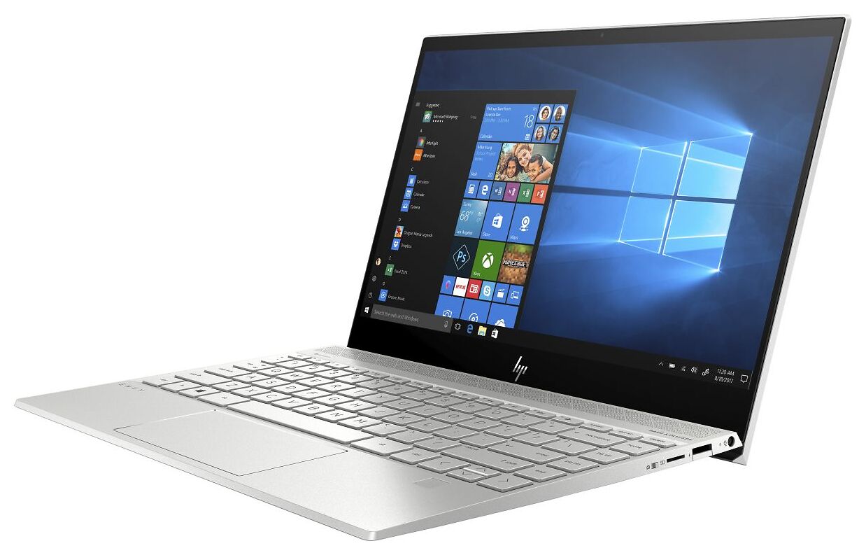

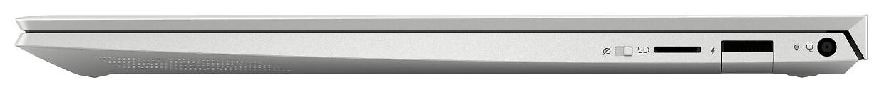

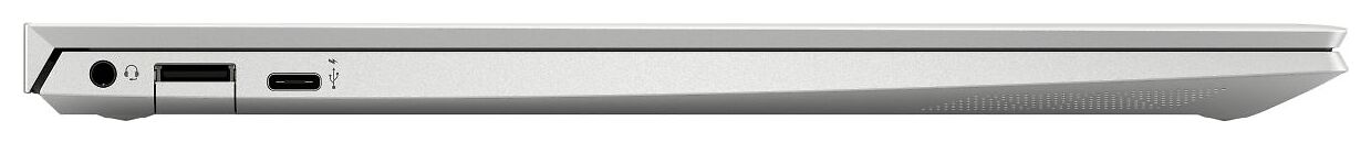

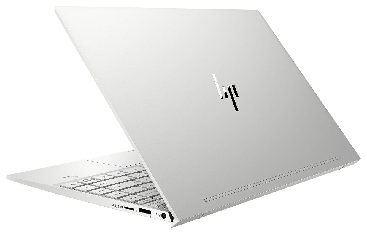

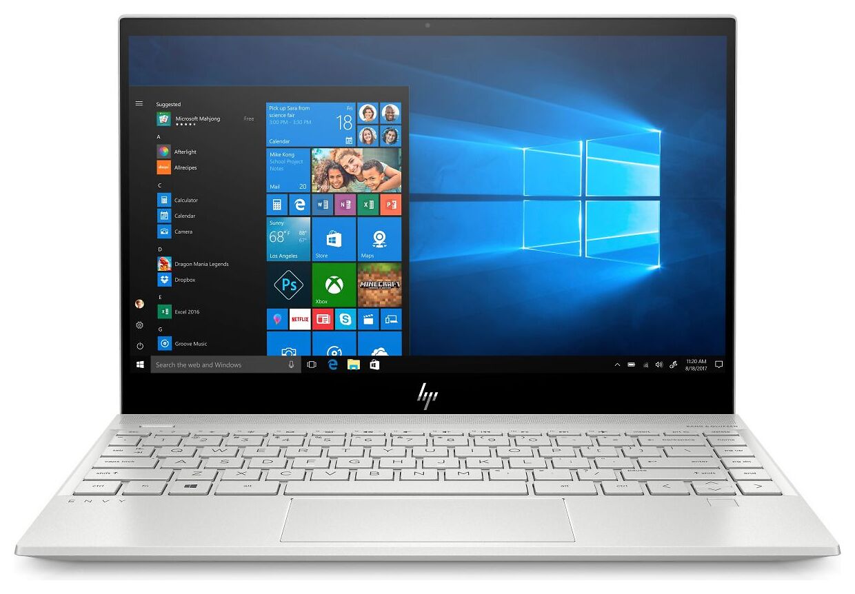

HP ENVY 13-aq1015ur Notebook 13 Specification for Upgrade or Repair
    HP ENVY 13-aq1015ur Notebook 13 Specification for Upgrade or Repair
    This specification for the HP ENVY 13-aq1015ur Notebook can be useful for upgrading or repairing a laptop that is not working. As a community we are working through our specifications to add valuable data like the 13-aq1015ur boardview and 13-aq1015ur schematic. Our users have donated over 1 million documents which are being added to the site. This page will be updated soon with additional information. Alternatively you can request additional help from our users directly on the relevant badcaps forum. Please note that we offer no warranties that any specification, datasheet, or download for HP ENVY 13-aq1015ur Notebook is accurate, safe, error free, or the fix you require.
    Design > Family: ENVY
    Design > Model Name: 13-aq1015ur
    Design > Part Number: 10A60EA
    Design > Release Date: 10/04/2020
    Design > Series: 13
    Specification > Weight: 1.17kg
    Product Code: 10A60EA
    Battery > Quick Charge: Yes
    Ports & Interfaces > USB Sleep-and-Charge Ports: 2
    Software > Pre-installed Software: Dropbox
    Software > Trial Software: McAfee LiveSafe, Microsoft Office 365
    Weight And Dimensions > Depth: 211.5mm
    Weight And Dimensions > Height: 14.7mm
    Weight And Dimensions > Weight: 1.17kg
    Weight And Dimensions > Width: 307mm
    HP ENVY 13-aq1015ur Notebook 13 Specification for Upgrade or Repair
    HP ENVY x360 - Hybrid (2-in-1) Specification for Upgrade or Repair
    This specification for the HP ENVY x360 - Hybrid (2-in-1) can be useful for upgrading or repairing a laptop that is not working. As a community we are working through our specifications to add valuable data like the - boardview and - schematic. Our users have donated over 1 million documents which are being added to the site. This page will be updated soon with additional information. Alternatively you can request additional help from our users directly on the relevant badcaps forum. Please note that we offer no warranties that any specification, datasheet, or download for HP ENVY x360 - Hybrid...
    09-06-2024, 07:05 AM
    HP ENVY x360 15-cn0007na Hybrid (2-in-1) Specification for Upgrade or Repair
    This specification for the HP ENVY x360 15-cn0007na Hybrid (2-in-1) can be useful for upgrading or repairing a laptop that is not working. As a community we are working through our specifications to add valuable data like the 15-cn0007na boardview and 15-cn0007na schematic. Our users have donated over 1 million documents which are being added to the site. This page will be updated soon with additional information. Alternatively you can request additional help from our users directly on the relevant badcaps forum. Please note that we offer no warranties that any specification, datasheet, or download...
    09-06-2024, 07:05 AM
    HP ENVY x360 15-cn0008na Hybrid (2-in-1) Specification for Upgrade or Repair
    This specification for the HP ENVY x360 15-cn0008na Hybrid (2-in-1) can be useful for upgrading or repairing a laptop that is not working. As a community we are working through our specifications to add valuable data like the 15-cn0008na boardview and 15-cn0008na schematic. Our users have donated over 1 million documents which are being added to the site. This page will be updated soon with additional information. Alternatively you can request additional help from our users directly on the relevant badcaps forum. Please note that we offer no warranties that any specification, datasheet, or download...
    09-06-2024, 07:05 AM
    HP ENVY x360 15-cn0506na Hybrid (2-in-1) Specification for Upgrade or Repair
    This specification for the HP ENVY x360 15-cn0506na Hybrid (2-in-1) can be useful for upgrading or repairing a laptop that is not working. As a community we are working through our specifications to add valuable data like the 15-cn0506na boardview and 15-cn0506na schematic. Our users have donated over 1 million documents which are being added to the site. This page will be updated soon with additional information. Alternatively you can request additional help from our users directly on the relevant badcaps forum. Please note that we offer no warranties that any specification, datasheet, or download...
    09-06-2024, 07:05 AM
    HP ENVY x360 15-cn0505na Hybrid (2-in-1) Specification for Upgrade or Repair
    This specification for the HP ENVY x360 15-cn0505na Hybrid (2-in-1) can be useful for upgrading or repairing a laptop that is not working. As a community we are working through our specifications to add valuable data like the 15-cn0505na boardview and 15-cn0505na schematic. Our users have donated over 1 million documents which are being added to the site. This page will be updated soon with additional information. Alternatively you can request additional help from our users directly on the relevant badcaps forum. Please note that we offer no warranties that any specification, datasheet, or download...
    09-06-2024, 07:05 AM
