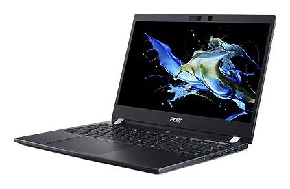

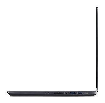

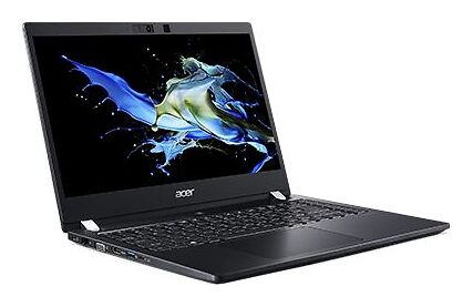

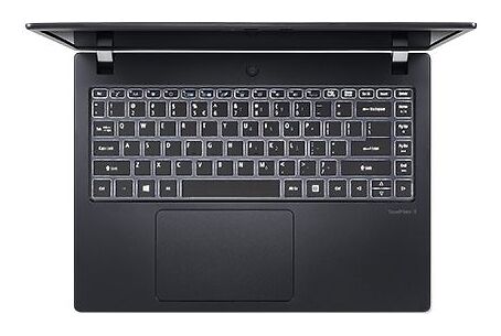

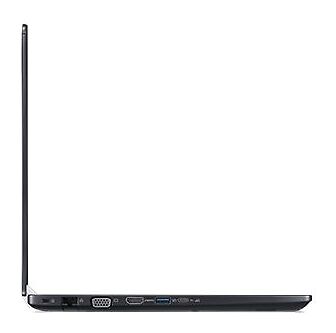

Acer TravelMate X314-51-MG Notebook X3 Specification for Upgrade or Repair
    Acer TravelMate X314-51-MG Notebook X3 Specification for Upgrade or Repair
    This specification for the Acer TravelMate X314-51-MG Notebook can be useful for upgrading or repairing a laptop that is not working. As a community we are working through our specifications to add valuable data like the X314-51-MG boardview and X314-51-MG schematic. Our users have donated over 1 million documents which are being added to the site. This page will be updated soon with additional information. Alternatively you can request additional help from our users directly on the relevant badcaps forum. Please note that we offer no warranties that any specification, datasheet, or download for Acer TravelMate X314-51-MG Notebook is accurate, safe, error free, or the fix you require.
    Design > Brand: Acer
    Design > Family: TravelMate
    Design > Model Name: X314-51-MG
    Design > Part Number: NX.VJUEB.005
    Design > Release Date: 01/11/2019
    Design > Series: X3
    Display > Panel Type: LCD
    Graphics > Discrete Graphics Adapter Model: NVIDIA GeForce MX230
    Specification > Battery: 15 hrs 5360mAh
    Specification > Weight: 1.6kg
    Product Code: NX.VJUEB.005
    Battery > Battery Capacity: 5360mAh
    Battery > Battery Life (max): 15 h
    Weight And Dimensions > Depth: 238mm
    Acer TravelMate X314-51-MG Notebook X3 Specification for Upgrade or Repair
    Acer TravelMate P258-MG-52PV Notebook P2 Specification for Upgrade or Repair
    This specification for the Acer TravelMate P258-MG-52PV Notebook can be useful for upgrading or repairing a laptop that is not working. As a community we are working through our specifications to add valuable data like the P258-MG-52PV boardview and P258-MG-52PV schematic. Our users have donated over 1 million documents which are being added to the site. This page will be updated soon with additional information. Alternatively you can request additional help from our users directly on the relevant badcaps forum. Please note that we offer no warranties that any specification, datasheet, or download...
    09-06-2024, 05:59 AM
    Acer TravelMate TMX3410-MG-50LB Notebook X3 Specification for Upgrade or Repair
    This specification for the Acer TravelMate TMX3410-MG-50LB Notebook can be useful for upgrading or repairing a laptop that is not working. As a community we are working through our specifications to add valuable data like the TMX3410-MG-50LB boardview and TMX3410-MG-50LB schematic. Our users have donated over 1 million documents which are being added to the site. This page will be updated soon with additional information. Alternatively you can request additional help from our users directly on the relevant badcaps forum. Please note that we offer no warranties that any specification, datasheet,...
    09-06-2024, 07:20 AM
    Acer TravelMate P2410-M-562N Notebook P2 Specification for Upgrade or Repair
    This specification for the Acer TravelMate P2410-M-562N Notebook can be useful for upgrading or repairing a laptop that is not working. As a community we are working through our specifications to add valuable data like the P2410-M-562N boardview and P2410-M-562N schematic. Our users have donated over 1 million documents which are being added to the site. This page will be updated soon with additional information. Alternatively you can request additional help from our users directly on the relevant badcaps forum. Please note that we offer no warranties that any specification, datasheet, or download...
    09-06-2024, 06:10 AM
    Acer TravelMate P2510-G2-MG-50VW Notebook P2 Specification for Upgrade or Repair
    This specification for the Acer TravelMate P2510-G2-MG-50VW Notebook can be useful for upgrading or repairing a laptop that is not working. As a community we are working through our specifications to add valuable data like the P2510-G2-MG-50VW boardview and P2510-G2-MG-50VW schematic. Our users have donated over 1 million documents which are being added to the site. This page will be updated soon with additional information. Alternatively you can request additional help from our users directly on the relevant badcaps forum. Please note that we offer no warranties that any specification, datasheet,...
    09-06-2024, 07:50 AM
    Acer TravelMate X3410-MG-5783 Notebook X3 Specification for Upgrade or Repair
    This specification for the Acer TravelMate X3410-MG-5783 Notebook can be useful for upgrading or repairing a laptop that is not working. As a community we are working through our specifications to add valuable data like the X3410-MG-5783 boardview and X3410-MG-5783 schematic. Our users have donated over 1 million documents which are being added to the site. This page will be updated soon with additional information. Alternatively you can request additional help from our users directly on the relevant badcaps forum. Please note that we offer no warranties that any specification, datasheet, or download...
    09-06-2024, 07:25 AM
