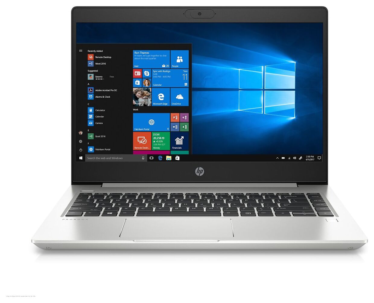

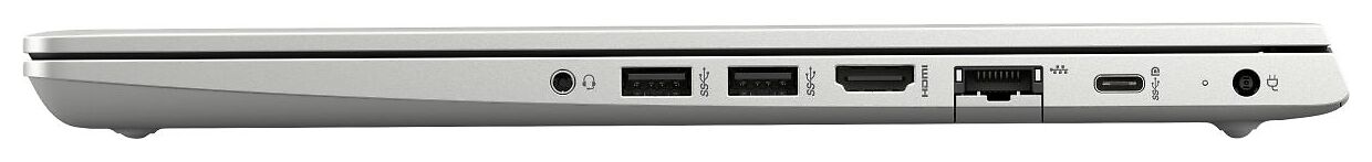

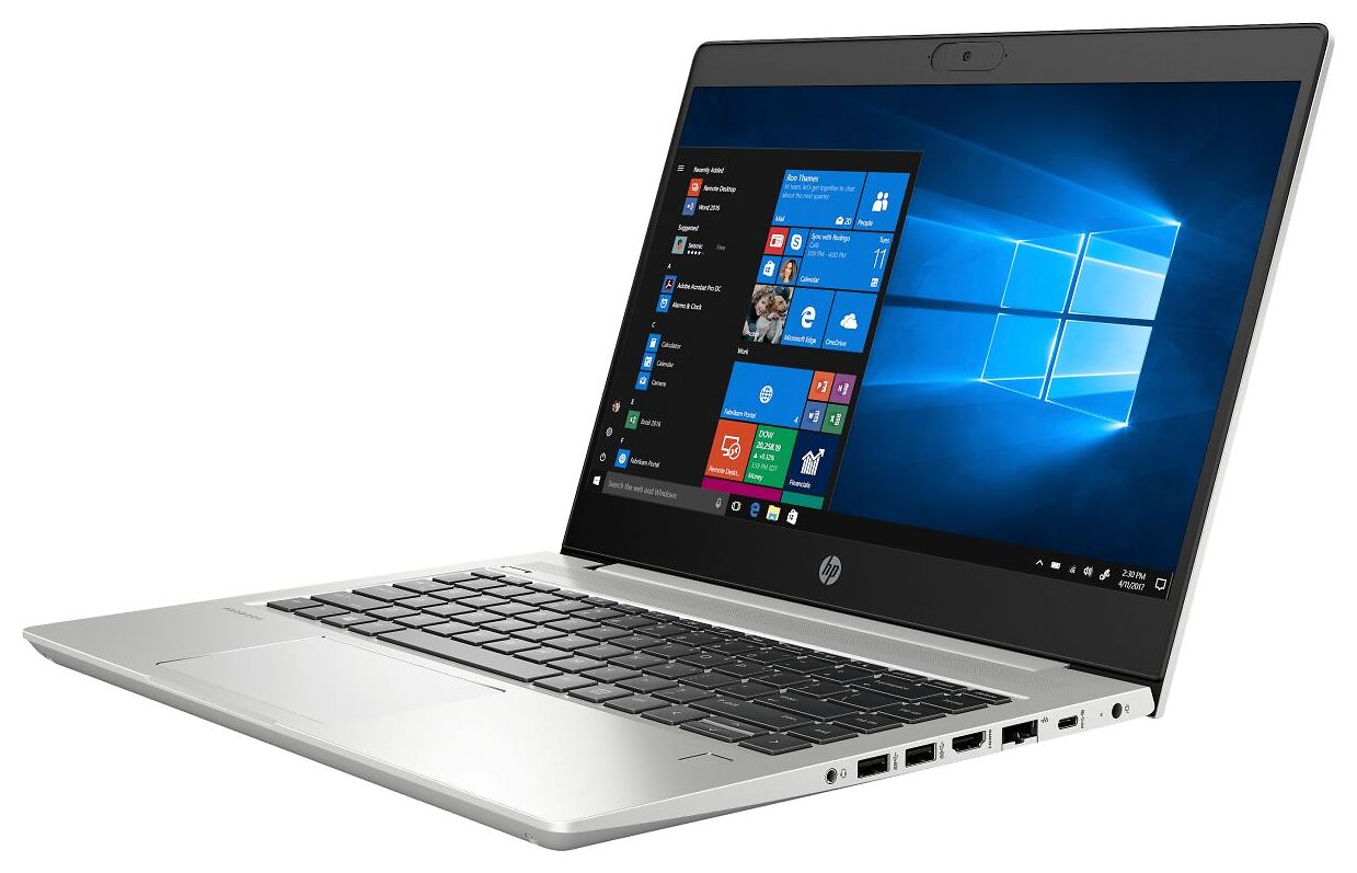

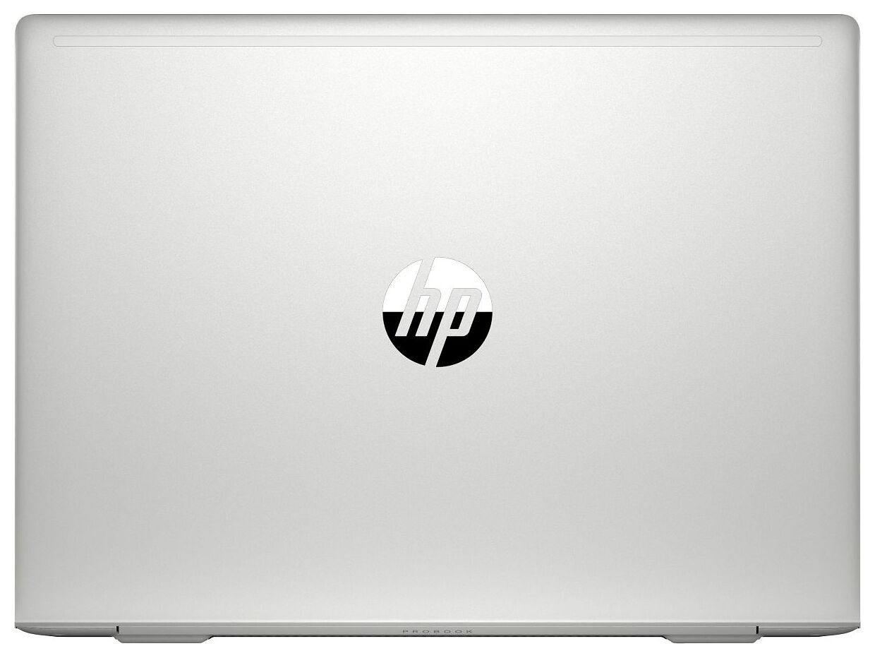

HP ProBook 440 G7 Notebook 400 Specification for Upgrade or Repair
    HP ProBook 440 G7 Notebook 400 Specification for Upgrade or Repair
    This specification for the HP ProBook 440 G7 Notebook can be useful for upgrading or repairing a laptop that is not working. As a community we are working through our specifications to add valuable data like the 440 G7 boardview and 440 G7 schematic. Our users have donated over 1 million documents which are being added to the site. This page will be updated soon with additional information. Alternatively you can request additional help from our users directly on the relevant badcaps forum. Please note that we offer no warranties that any specification, datasheet, or download for HP ProBook 440 G7 Notebook is accurate, safe, error free, or the fix you require.
    Design > Family: ProBook
    Design > Model Name: 440 G7
    Design > Part Number: 9EL13PA
    Design > Release Date: 12/10/2019
    Design > Series: 400
    Display > HD Type: HD
    Display > Panel Type: SVA
    Specification > Battery: 45 Wh
    Specification > Weight: 1.6kg
    Memory > Internal Memory: 4GB
    Product Code: 9EL13PA
    Battery > Battery Capacity (Watt Hours): 45Wh
    Networking > WLAN Controller Model: Intel AX200
    Storage > HDD Interface: SATA
    Storage > HDD Speed: 5400RPM
    Storage > Storage Media: HDD
    Weight And Dimensions > Depth: 237.7mm
    Weight And Dimensions > Width: 324.2mm
    HP ProBook 440 G7 Notebook 400 Specification for Upgrade or Repair
    HP ProBook ProBook 470 G5 Notebook PC Notebook 400 Specification for Upgrade or Repair
    This specification for the HP ProBook ProBook 470 G5 Notebook PC Notebook can be useful for upgrading or repairing a laptop that is not working. As a community we are working through our specifications to add valuable data like the ProBook 470 G5 Notebook PC boardview and ProBook 470 G5 Notebook PC schematic. Our users have donated over 1 million documents which are being added to the site. This page will be updated soon with additional information. Alternatively you can request additional help from our users directly on the relevant badcaps forum. Please note that we offer no warranties that...
    09-06-2024, 06:40 AM
    HP ProBook ProBook 5320m Notebook 5000 Specification for Upgrade or Repair
    This specification for the HP ProBook ProBook 5320m Notebook can be useful for upgrading or repairing a laptop that is not working. As a community we are working through our specifications to add valuable data like the ProBook 5320m boardview and ProBook 5320m schematic. Our users have donated over 1 million documents which are being added to the site. This page will be updated soon with additional information. Alternatively you can request additional help from our users directly on the relevant badcaps forum. Please note that we offer no warranties that any specification, datasheet, or download...
    09-06-2024, 05:27 AM
    HP ProBook ProBook 440 G5 Notebook PC Notebook 400 Specification for Upgrade or Repair
    This specification for the HP ProBook ProBook 440 G5 Notebook PC Notebook can be useful for upgrading or repairing a laptop that is not working. As a community we are working through our specifications to add valuable data like the ProBook 440 G5 Notebook PC boardview and ProBook 440 G5 Notebook PC schematic. Our users have donated over 1 million documents which are being added to the site. This page will be updated soon with additional information. Alternatively you can request additional help from our users directly on the relevant badcaps forum. Please note that we offer no warranties that...
    09-06-2024, 06:40 AM
    HP ProBook NOTEBOOK BUNDEL (2SY27EA + 2SC66ET) ProBook 450 + business slim bag Notebook 400 Specification for Upgrade or Repair
    This specification for the HP ProBook NOTEBOOK BUNDEL (2SY27EA + 2SC66ET) ProBook 450 + business slim bag Notebook can be useful for upgrading or repairing a laptop that is not working. As a community we are working through our specifications to add valuable data like the NOTEBOOK BUNDEL (2SY27EA + 2SC66ET) ProBook 450 + business slim bag boardview and NOTEBOOK BUNDEL (2SY27EA + 2SC66ET) ProBook 450 + business slim bag schematic. Our users have donated over 1 million documents which are being added to the site. This page will be updated soon with additional information. Alternatively you can request...
    09-06-2024, 06:08 AM
    HP ProBook ProBook 4520s Notebook PC 4000 Specification for Upgrade or Repair
    This specification for the HP ProBook ProBook 4520s Notebook PC can be useful for upgrading or repairing a laptop that is not working. As a community we are working through our specifications to add valuable data like the ProBook 4520s Notebook PC boardview and ProBook 4520s Notebook PC schematic. Our users have donated over 1 million documents which are being added to the site. This page will be updated soon with additional information. Alternatively you can request additional help from our users directly on the relevant badcaps forum. Please note that we offer no warranties that any specification,...
    09-06-2024, 05:27 AM
