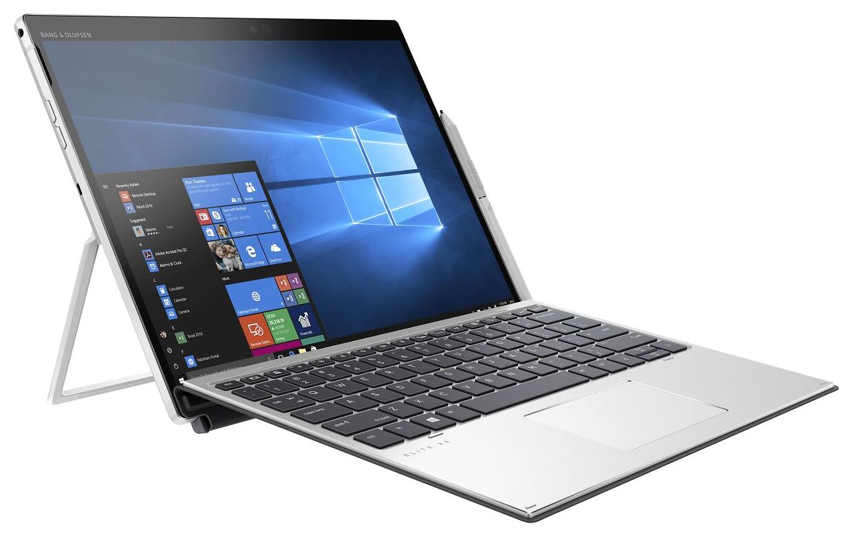

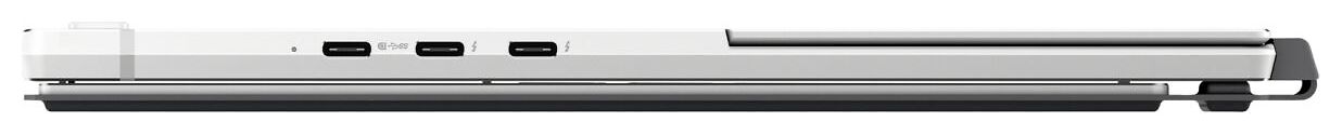

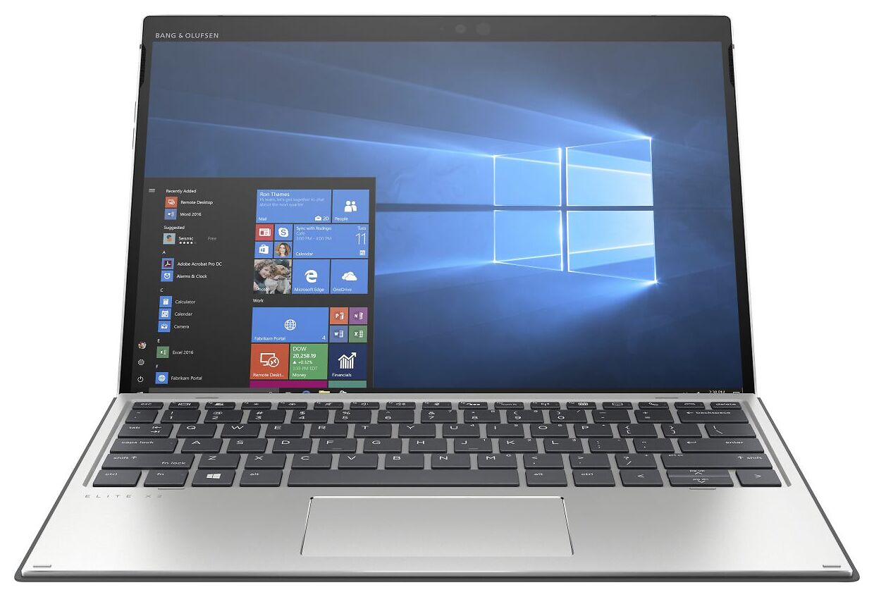

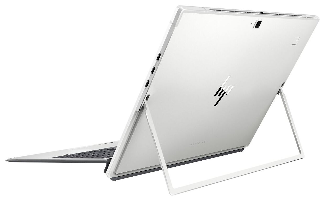

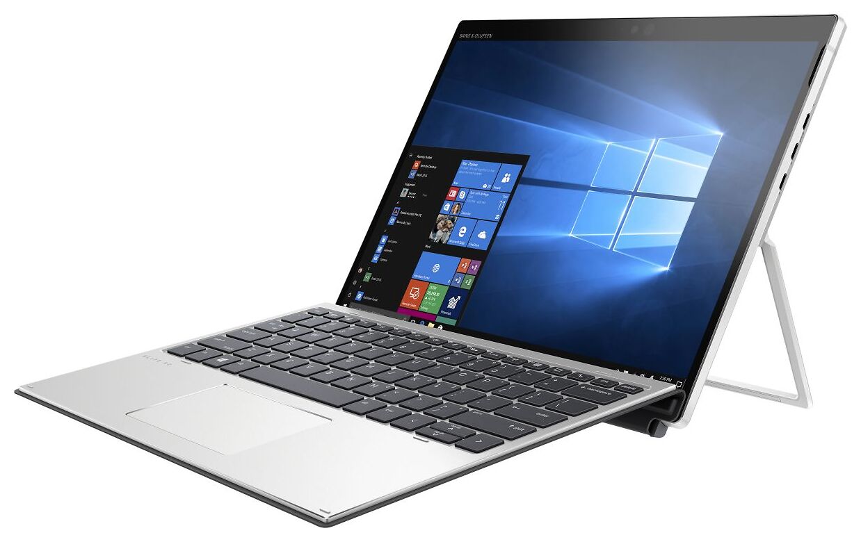

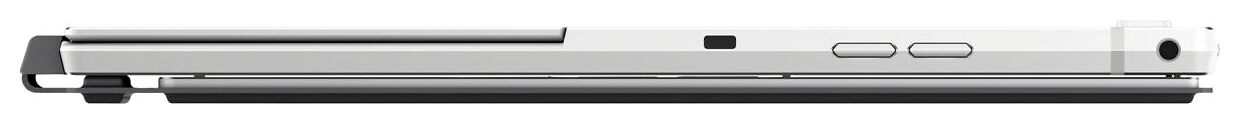

HP Elite x2 G4 Hybrid (2-in-1) Specification for Upgrade or Repair
    HP Elite x2 G4 Hybrid (2-in-1) Specification for Upgrade or Repair
    This specification for the HP Elite x2 G4 Hybrid (2-in-1) can be useful for upgrading or repairing a laptop that is not working. As a community we are working through our specifications to add valuable data like the G4 boardview and G4 schematic. Our users have donated over 1 million documents which are being added to the site. This page will be updated soon with additional information. Alternatively you can request additional help from our users directly on the relevant badcaps forum. Please note that we offer no warranties that any specification, datasheet, or download for HP Elite x2 G4 Hybrid (2-in-1) is accurate, safe, error free, or the fix you require.
    Design > EAN/UPC Code: 0193905761265, 193905761265
    Design > Family: Elite x2
    Design > Model Name: G4
    Design > Part Number: 7KN90EA#ABH
    Design > Release Date: 01/09/2019
    Display > Display Diagonal: 12.3 inch
    Display > Display Resolution: 1920x1280 pixels
    Display > HD Type: WUXGA+
    Specification > Battery: 12.3 hrs 47 Wh
    Specification > Display Diagonal: 12.3 inch
    Specification > Weight: 1.17kg
    Product Code: 7KN90EA#ABH
    Battery > Battery Capacity: 47 Wh
    Battery > Battery Capacity (Watt Hours): 47Wh
    Battery > Battery Life (max): 12.3 h
    Battery > Quick Charge: Yes
    Brand-specific Features > HP Front Camera: HP Webcam HD IR
    Camera > Privacy Camera: Yes
    Networking > MIMO: Yes
    Networking > SIM Card Support: Yes
    Networking > WLAN Controller Model: Intel AX200
    Performance > Electronic Compass: Yes
    Performance > Gyroscope: Yes
    Ports & Interfaces > USB 3.0 (3.1 Gen 1) Type-C Ports Qty: 3
    Ports & Interfaces > USB 3.2 Gen 1 (3.1 Gen 1) Type-C Ports Qty: 3
    Weight And Dimensions > Depth: 215.8mm
    Weight And Dimensions > Depth (tablet Mode): 21.6 cm
    Weight And Dimensions > Height: 14.2mm
    Weight And Dimensions > Height (tablet Mode): 8.8mm
    Weight And Dimensions > Weight: 1.17kg
    Weight And Dimensions > Weight (tablet Mode): 820g
    Weight And Dimensions > Width: 289.3mm
    Weight And Dimensions > Width (tablet Mode): 28.9 cm
    HP Elite x2 G4 Hybrid (2-in-1) Specification for Upgrade or Repair
