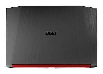

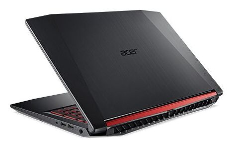

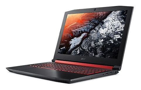

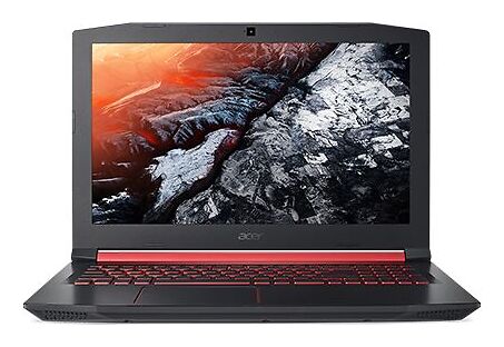

Acer Nitro AN515-52-78CU Notebook 5 Specification for Upgrade or Repair
    Acer Nitro AN515-52-78CU Notebook 5 Specification for Upgrade or Repair
    This specification for the Acer Nitro AN515-52-78CU Notebook can be useful for upgrading or repairing a laptop that is not working. As a community we are working through our specifications to add valuable data like the AN515-52-78CU boardview and AN515-52-78CU schematic. Our users have donated over 1 million documents which are being added to the site. This page will be updated soon with additional information. Alternatively you can request additional help from our users directly on the relevant badcaps forum. Please note that we offer no warranties that any specification, datasheet, or download for Acer Nitro AN515-52-78CU Notebook is accurate, safe, error free, or the fix you require.
    Design > Brand: Acer
    Design > Family: Nitro
    Design > Model Name: AN515-52-78CU
    Design > Part Number: NH.Q3MEF.020
    Design > Product Colour: Black, Red
    Design > Release Date: 27/08/2019
    Design > Series: 5
    Specification > Battery: 3320mAh
    Specification > Weight: 2.7kg
    Product Code: NH.Q3MEF.020
    Battery > Battery Capacity: 3320mAh
    Software > Operating System Installed: Endless OS
    Storage > Compatible Memory Cards: SD, SDXC
    Storage > HDD Interface: SATA
    Storage > HDD Speed: 5400RPM
    Storage > SSD Capacity: 128GB
    Weight And Dimensions > Depth: 266mm
    Weight And Dimensions > Height: 26.8mm
    Weight And Dimensions > Weight: 2.7kg
    Weight And Dimensions > Width: 390mm
    Acer Nitro AN515-52-78CU Notebook 5 Specification for Upgrade or Repair
    Acer Nitro Nitro AN515-52-55B9 Notebook 5 Specification for Upgrade or Repair
    This specification for the Acer Nitro Nitro AN515-52-55B9 Notebook can be useful for upgrading or repairing a laptop that is not working. As a community we are working through our specifications to add valuable data like the Nitro AN515-52-55B9 boardview and Nitro AN515-52-55B9 schematic. Our users have donated over 1 million documents which are being added to the site. This page will be updated soon with additional information. Alternatively you can request additional help from our users directly on the relevant badcaps forum. Please note that we offer no warranties that any specification, datasheet,...
    09-06-2024, 06:34 AM
    Acer Nitro AN515-52-746R Notebook 5 Specification for Upgrade or Repair
    This specification for the Acer Nitro AN515-52-746R Notebook can be useful for upgrading or repairing a laptop that is not working. As a community we are working through our specifications to add valuable data like the AN515-52-746R boardview and AN515-52-746R schematic. Our users have donated over 1 million documents which are being added to the site. This page will be updated soon with additional information. Alternatively you can request additional help from our users directly on the relevant badcaps forum. Please note that we offer no warranties that any specification, datasheet, or download...
    09-06-2024, 08:52 AM
    Acer Nitro NP515-51-88MT Hybrid (2-in-1) 5 Spin Specification for Upgrade or Repair
    This specification for the Acer Nitro NP515-51-88MT Hybrid (2-in-1) can be useful for upgrading or repairing a laptop that is not working. As a community we are working through our specifications to add valuable data like the NP515-51-88MT boardview and NP515-51-88MT schematic. Our users have donated over 1 million documents which are being added to the site. This page will be updated soon with additional information. Alternatively you can request additional help from our users directly on the relevant badcaps forum. Please note that we offer no warranties that any specification, datasheet, or...
    09-06-2024, 07:29 AM
    Acer Nitro AN515-52-51QL Notebook 5 Specification for Upgrade or Repair
    This specification for the Acer Nitro AN515-52-51QL Notebook can be useful for upgrading or repairing a laptop that is not working. As a community we are working through our specifications to add valuable data like the AN515-52-51QL boardview and AN515-52-51QL schematic. Our users have donated over 1 million documents which are being added to the site. This page will be updated soon with additional information. Alternatively you can request additional help from our users directly on the relevant badcaps forum. Please note that we offer no warranties that any specification, datasheet, or download...
    09-06-2024, 08:35 AM
    Acer Nitro AN515-52-588Y Notebook 5 Specification for Upgrade or Repair
    This specification for the Acer Nitro AN515-52-588Y Notebook can be useful for upgrading or repairing a laptop that is not working. As a community we are working through our specifications to add valuable data like the AN515-52-588Y boardview and AN515-52-588Y schematic. Our users have donated over 1 million documents which are being added to the site. This page will be updated soon with additional information. Alternatively you can request additional help from our users directly on the relevant badcaps forum. Please note that we offer no warranties that any specification, datasheet, or download...
    09-06-2024, 08:20 AM
