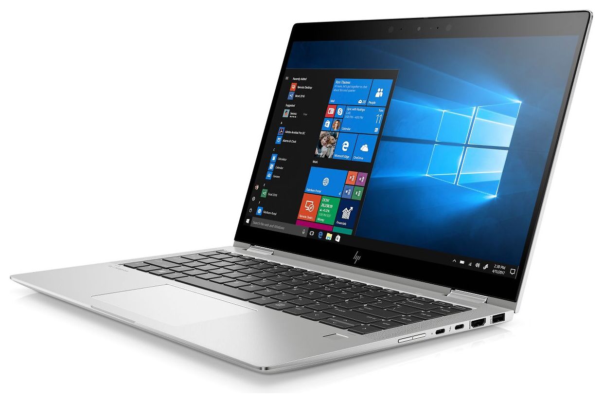

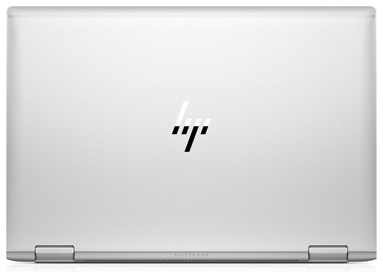

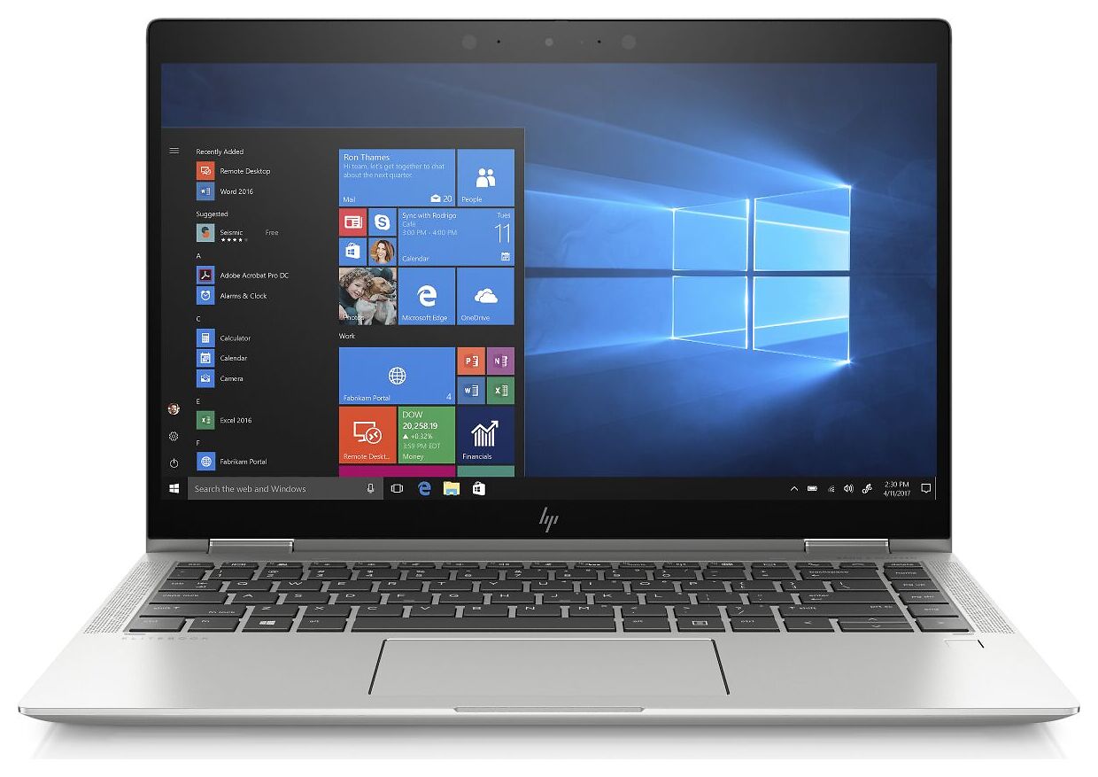

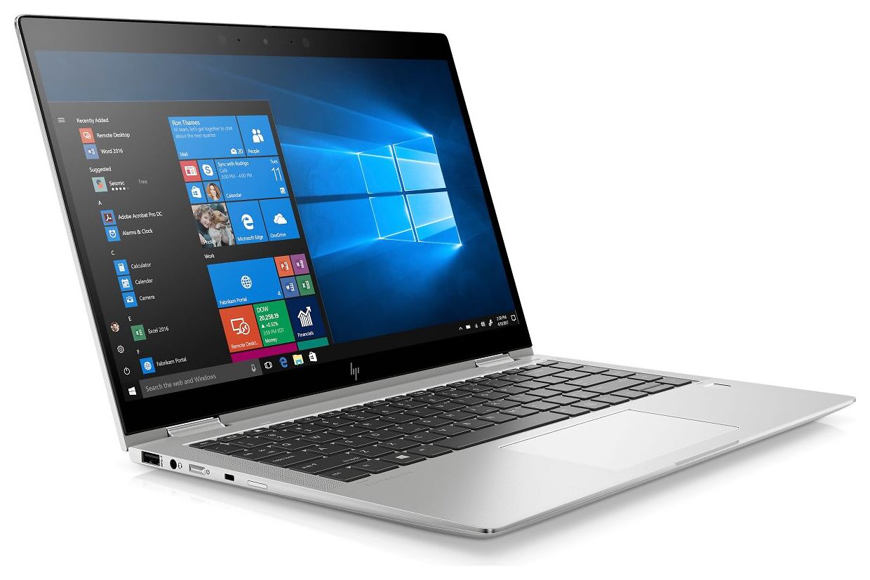

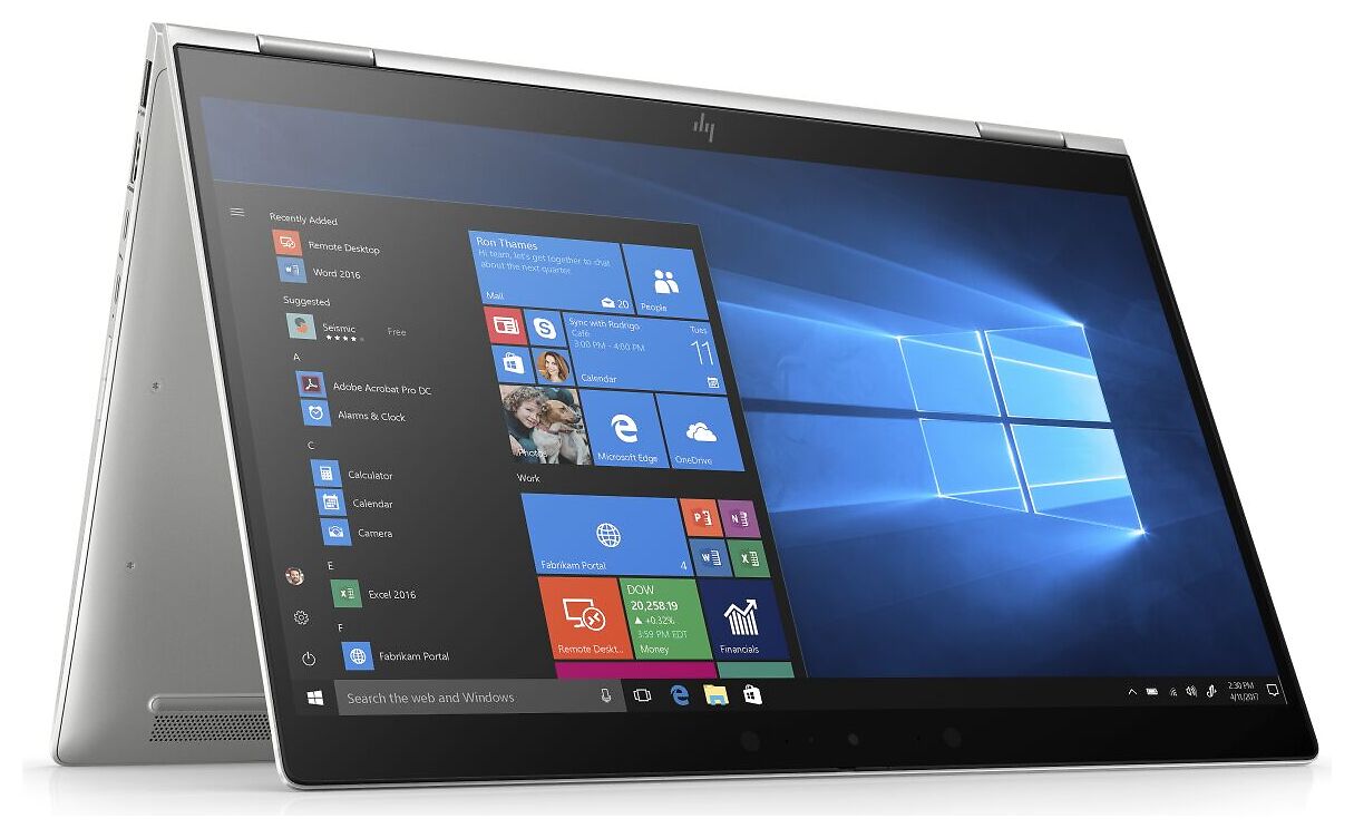

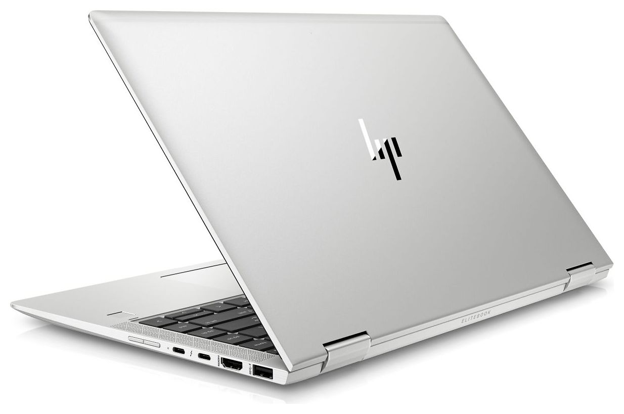

HP EliteBook x360 1040 G6 Hybrid (2-in-1) Specification for Upgrade or Repair
    HP EliteBook x360 1040 G6 Hybrid (2-in-1) Specification for Upgrade or Repair
    This specification for the HP EliteBook x360 1040 G6 Hybrid (2-in-1) can be useful for upgrading or repairing a laptop that is not working. As a community we are working through our specifications to add valuable data like the 1040 G6 boardview and 1040 G6 schematic. Our users have donated over 1 million documents which are being added to the site. This page will be updated soon with additional information. Alternatively you can request additional help from our users directly on the relevant badcaps forum. Please note that we offer no warranties that any specification, datasheet, or download for HP EliteBook x360 1040 G6 Hybrid (2-in-1) is accurate, safe, error free, or the fix you require.
    Design > EAN/UPC Code: 0194441383621, 194441383621
    Design > Model Name: 1040 G6
    Design > Part Number: 7YM10ES
    Design > Release Date: 16/08/2019
    Product Code: 7YM10ES
    Performance > Gyroscope: Yes
    Weight And Dimensions > Depth: 215mm
    Weight And Dimensions > Width: 321.4mm
    HP EliteBook x360 1040 G6 Hybrid (2-in-1) Specification for Upgrade or Repair
    HP EliteBook EliteBook x360 1040 G5 Notebook PC Notebook 1000 Specification for Upgrade or Repair
    This specification for the HP EliteBook EliteBook x360 1040 G5 Notebook PC Notebook can be useful for upgrading or repairing a laptop that is not working. As a community we are working through our specifications to add valuable data like the EliteBook x360 1040 G5 Notebook PC boardview and EliteBook x360 1040 G5 Notebook PC schematic. Our users have donated over 1 million documents which are being added to the site. This page will be updated soon with additional information. Alternatively you can request additional help from our users directly on the relevant badcaps forum. Please note that we...
    09-06-2024, 09:53 AM
    HP EliteBook EliteBook x360 1040 G5 Notebook PC Notebook 1000 Specification for Upgrade or Repair
    This specification for the HP EliteBook EliteBook x360 1040 G5 Notebook PC Notebook can be useful for upgrading or repairing a laptop that is not working. As a community we are working through our specifications to add valuable data like the EliteBook x360 1040 G5 Notebook PC boardview and EliteBook x360 1040 G5 Notebook PC schematic. Our users have donated over 1 million documents which are being added to the site. This page will be updated soon with additional information. Alternatively you can request additional help from our users directly on the relevant badcaps forum. Please note that we...
    09-06-2024, 07:20 AM
    HP EliteBook x360 1040 G7 Hybrid (2-in-1) Specification for Upgrade or Repair
    This specification for the HP EliteBook x360 1040 G7 Hybrid (2-in-1) can be useful for upgrading or repairing a laptop that is not working. As a community we are working through our specifications to add valuable data like the 1040 G7 boardview and 1040 G7 schematic. Our users have donated over 1 million documents which are being added to the site. This page will be updated soon with additional information. Alternatively you can request additional help from our users directly on the relevant badcaps forum. Please note that we offer no warranties that any specification, datasheet, or download for...
    09-06-2024, 10:20 PM
    HP EliteBook x360 1040 G7 Hybrid (2-in-1) Specification for Upgrade or Repair
    This specification for the HP EliteBook x360 1040 G7 Hybrid (2-in-1) can be useful for upgrading or repairing a laptop that is not working. As a community we are working through our specifications to add valuable data like the 1040 G7 boardview and 1040 G7 schematic. Our users have donated over 1 million documents which are being added to the site. This page will be updated soon with additional information. Alternatively you can request additional help from our users directly on the relevant badcaps forum. Please note that we offer no warranties that any specification, datasheet, or download for...
    09-06-2024, 09:30 PM
    HP EliteBook x360 1040 G7 Ultraportable Specification for Upgrade or Repair
    This specification for the HP EliteBook x360 1040 G7 Ultraportable can be useful for upgrading or repairing a laptop that is not working. As a community we are working through our specifications to add valuable data like the 1040 G7 boardview and 1040 G7 schematic. Our users have donated over 1 million documents which are being added to the site. This page will be updated soon with additional information. Alternatively you can request additional help from our users directly on the relevant badcaps forum. Please note that we offer no warranties that any specification, datasheet, or download for...
    09-06-2024, 09:30 PM
