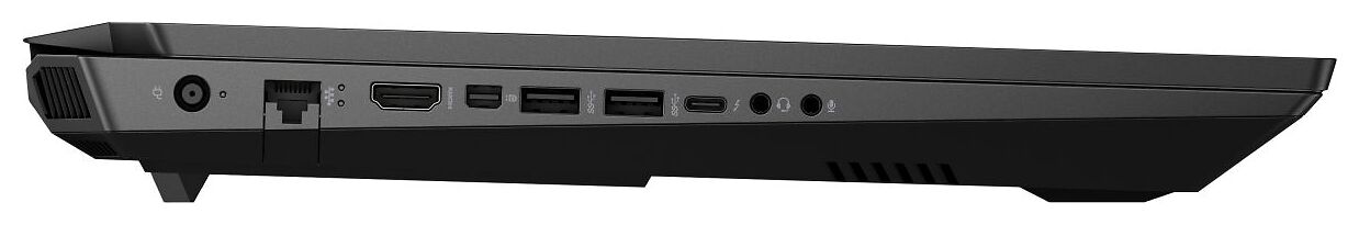

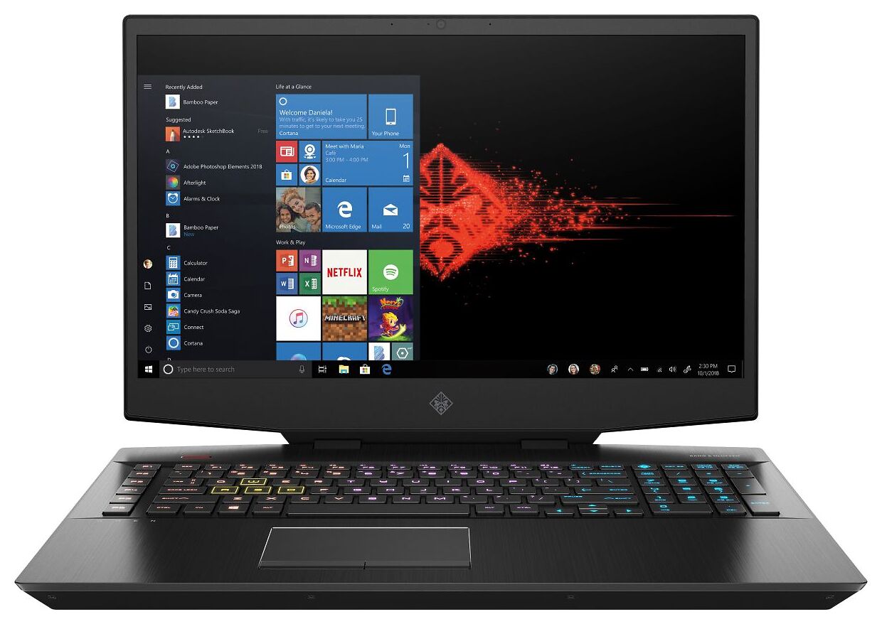

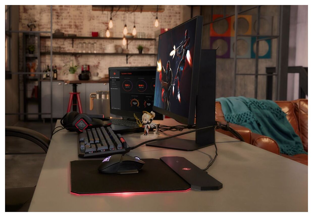

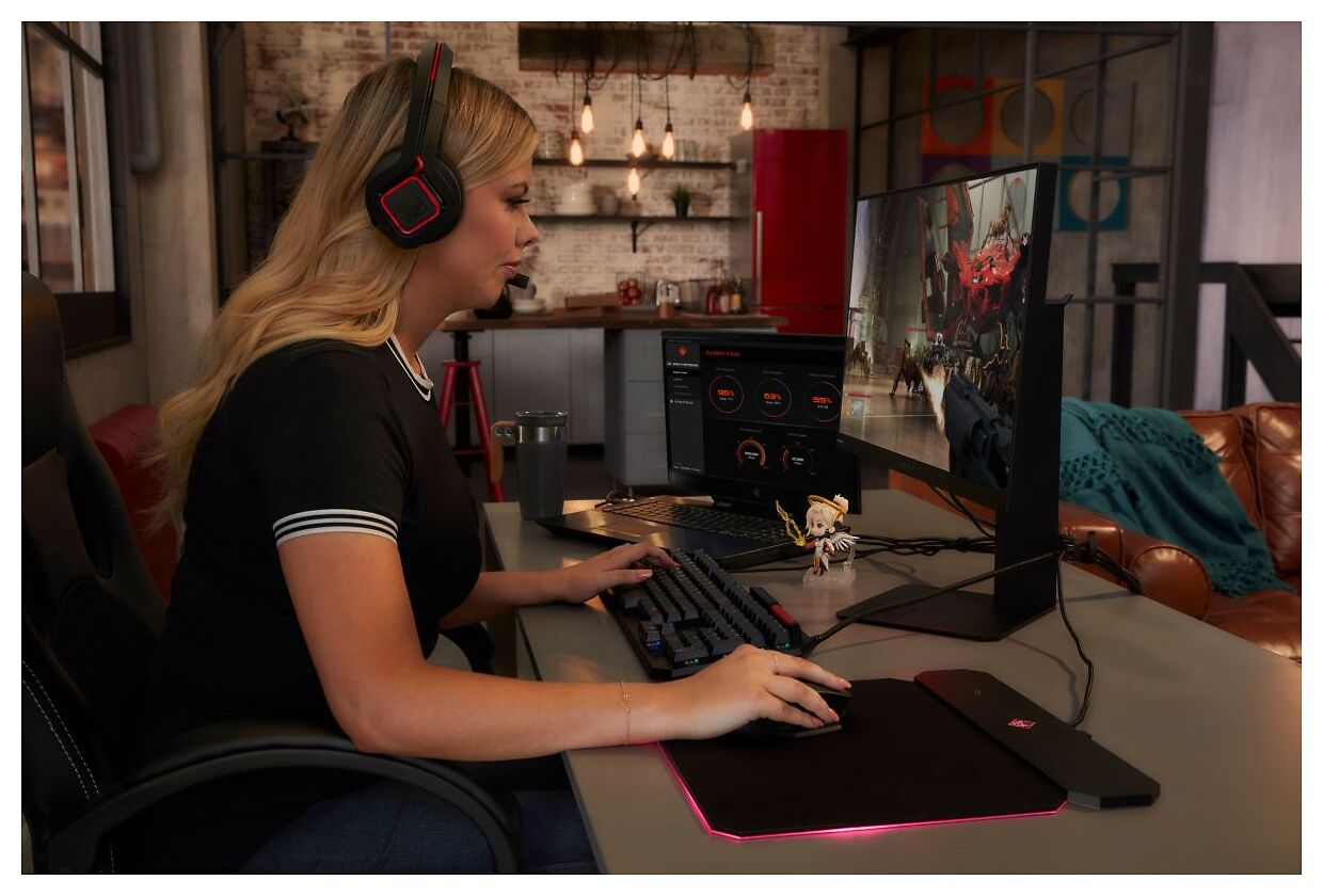

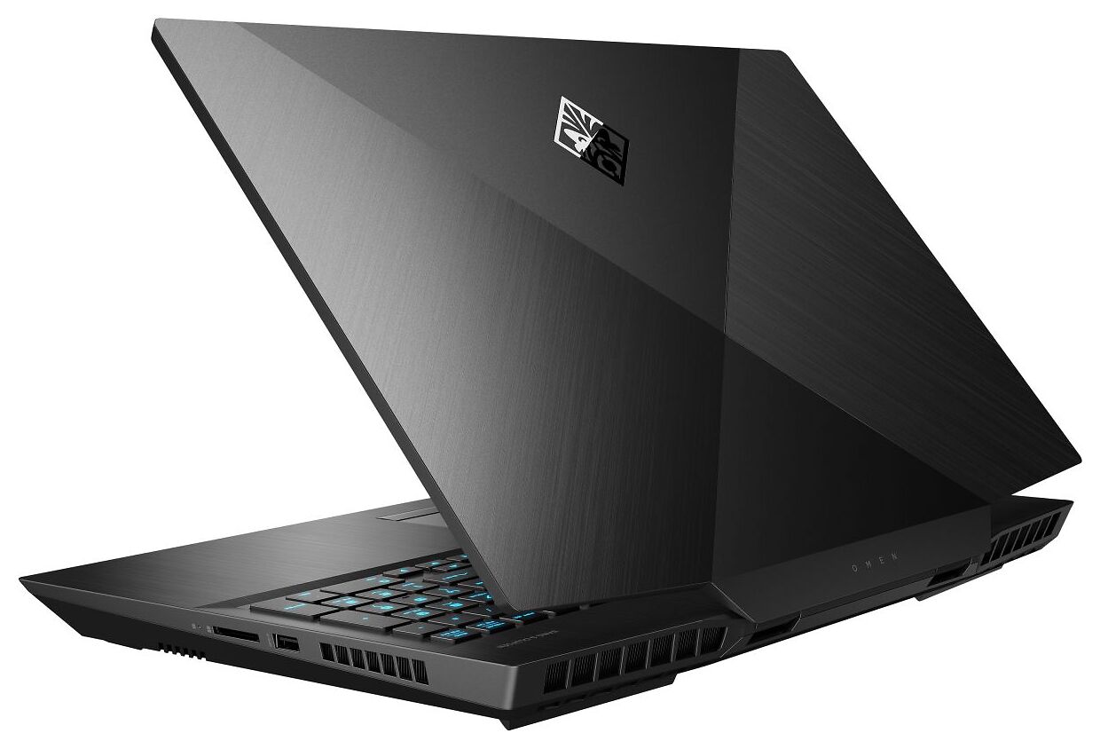

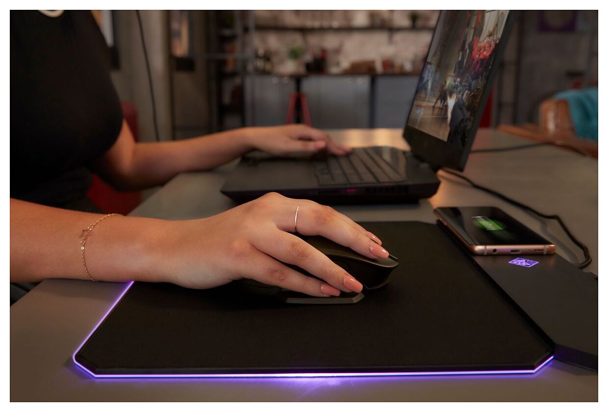

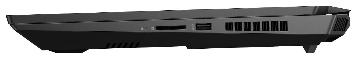

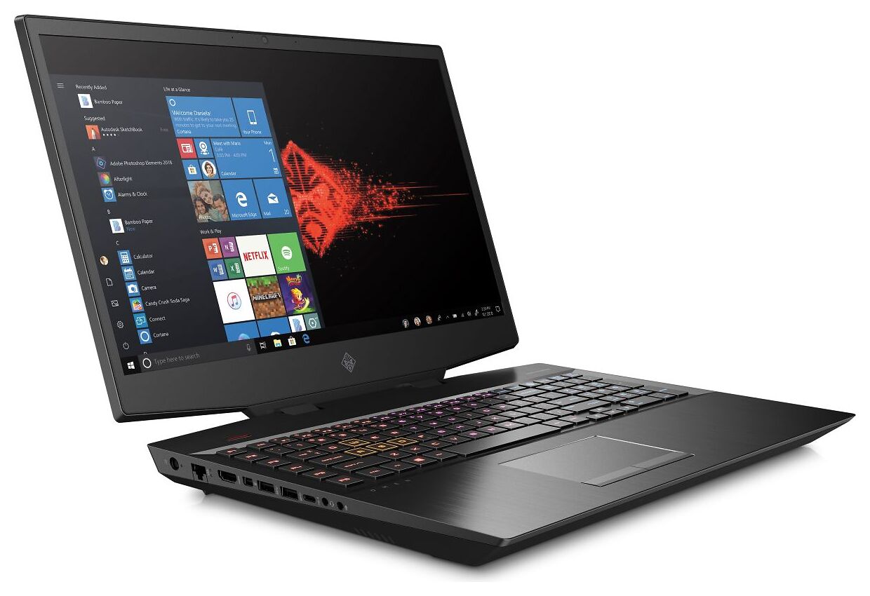

HP OMEN 17-cb0042nf Notebook 17 Specification for Upgrade or Repair
    HP OMEN 17-cb0042nf Notebook 17 Specification for Upgrade or Repair
    This specification for the HP OMEN 17-cb0042nf Notebook can be useful for upgrading or repairing a laptop that is not working. As a community we are working through our specifications to add valuable data like the 17-cb0042nf boardview and 17-cb0042nf schematic. Our users have donated over 1 million documents which are being added to the site. This page will be updated soon with additional information. Alternatively you can request additional help from our users directly on the relevant badcaps forum. Please note that we offer no warranties that any specification, datasheet, or download for HP OMEN 17-cb0042nf Notebook is accurate, safe, error free, or the fix you require.
    Design > Family: OMEN
    Design > Model Name: 17-cb0042nf
    Design > Part Number: 7SD53EA
    Design > Release Date: 07/08/2019
    Design > Series: 17
    Graphics > Discrete Graphics Adapter Model: NVIDIA GeForce RTX 2070
    Specification > Battery: 5 hrs 70 Wh
    Specification > Weight: 3.31kg
    Product Code: 7SD53EA
    Battery > Battery Capacity (Watt Hours): 70Wh
    Battery > Battery Life (max): 5 h
    Battery > Quick Charge: Yes
    Software > Bundled Software: Dropbox
    Software > Trial Software: McAfee LiveSafe, Microsoft Office 365
    Storage > HDD Interface: SATA
    Storage > HDD Speed: 7200RPM
    Weight And Dimensions > Depth: 295mm
    Weight And Dimensions > Height: 27mm
    Weight And Dimensions > Weight: 3.31kg
    Weight And Dimensions > Width: 405mm
    HP OMEN 17-cb0042nf Notebook 17 Specification for Upgrade or Repair
    HP OMEN X OMEN X by - 17-ap099na Notebook Specification for Upgrade or Repair
    This specification for the HP OMEN X OMEN X by - 17-ap099na Notebook can be useful for upgrading or repairing a laptop that is not working. As a community we are working through our specifications to add valuable data like the OMEN X by - 17-ap099na boardview and OMEN X by - 17-ap099na schematic. Our users have donated over 1 million documents which are being added to the site. This page will be updated soon with additional information. Alternatively you can request additional help from our users directly on the relevant badcaps forum. Please note that we offer no warranties that any specification,...
    09-06-2024, 08:58 AM
    HP OMEN OMEN by - 17-an026na Notebook 17 Specification for Upgrade or Repair
    This specification for the HP OMEN OMEN by - 17-an026na Notebook can be useful for upgrading or repairing a laptop that is not working. As a community we are working through our specifications to add valuable data like the OMEN by - 17-an026na boardview and OMEN by - 17-an026na schematic. Our users have donated over 1 million documents which are being added to the site. This page will be updated soon with additional information. Alternatively you can request additional help from our users directly on the relevant badcaps forum. Please note that we offer no warranties that any specification, datasheet,...
    09-06-2024, 06:08 AM
    HP OMEN OMEN by 17-cb0588na Notebook 17 Specification for Upgrade or Repair
    This specification for the HP OMEN OMEN by 17-cb0588na Notebook can be useful for upgrading or repairing a laptop that is not working. As a community we are working through our specifications to add valuable data like the OMEN by 17-cb0588na boardview and OMEN by 17-cb0588na schematic. Our users have donated over 1 million documents which are being added to the site. This page will be updated soon with additional information. Alternatively you can request additional help from our users directly on the relevant badcaps forum. Please note that we offer no warranties that any specification, datasheet,...
    09-06-2024, 09:09 AM
    HP OMEN OMEN by - 15-ce029nl Notebook 15 Specification for Upgrade or Repair
    This specification for the HP OMEN OMEN by - 15-ce029nl Notebook can be useful for upgrading or repairing a laptop that is not working. As a community we are working through our specifications to add valuable data like the OMEN by - 15-ce029nl boardview and OMEN by - 15-ce029nl schematic. Our users have donated over 1 million documents which are being added to the site. This page will be updated soon with additional information. Alternatively you can request additional help from our users directly on the relevant badcaps forum. Please note that we offer no warranties that any specification, datasheet,...
    09-06-2024, 06:10 AM
    HP OMEN X OMEN X by - 17-ap051nr Notebook Specification for Upgrade or Repair
    This specification for the HP OMEN X OMEN X by - 17-ap051nr Notebook can be useful for upgrading or repairing a laptop that is not working. As a community we are working through our specifications to add valuable data like the OMEN X by - 17-ap051nr boardview and OMEN X by - 17-ap051nr schematic. Our users have donated over 1 million documents which are being added to the site. This page will be updated soon with additional information. Alternatively you can request additional help from our users directly on the relevant badcaps forum. Please note that we offer no warranties that any specification,...
    09-06-2024, 06:08 AM
