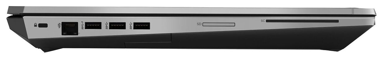

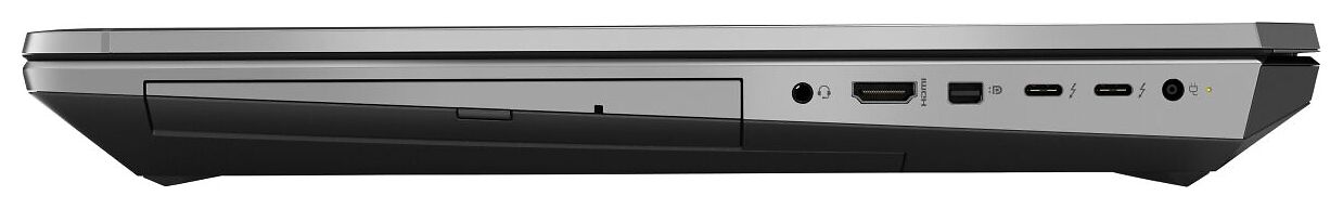

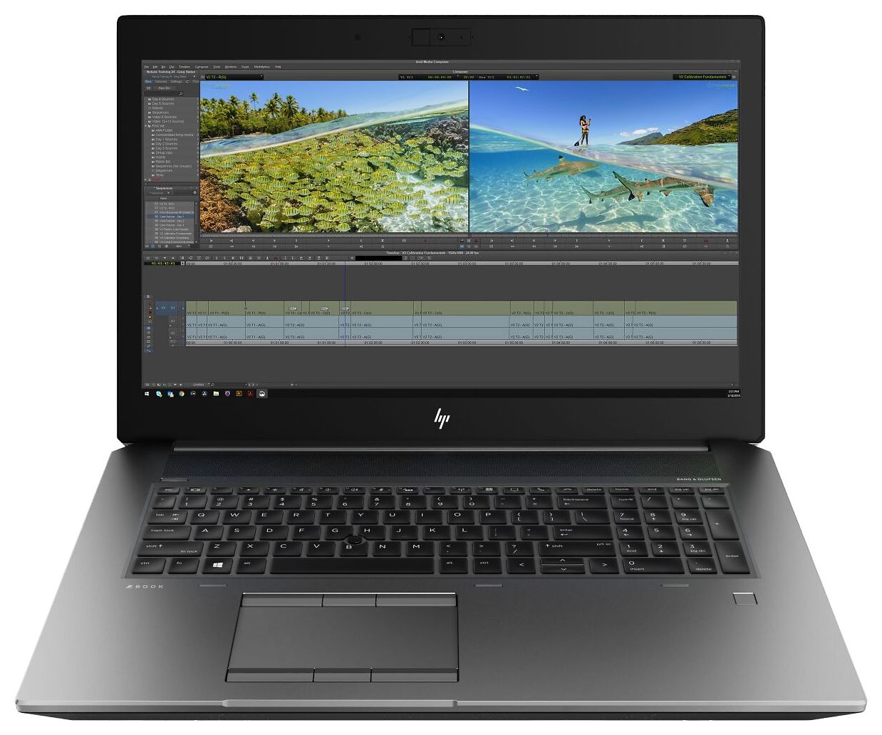

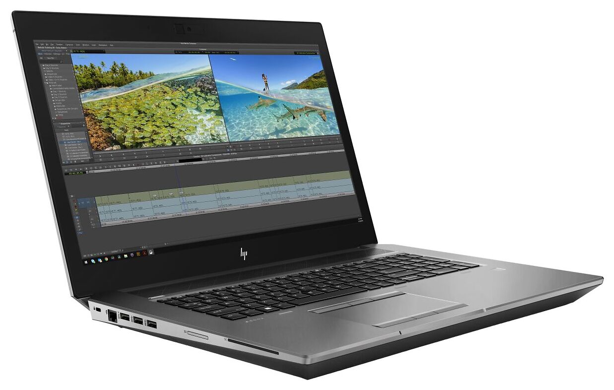

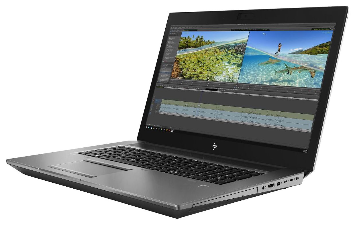

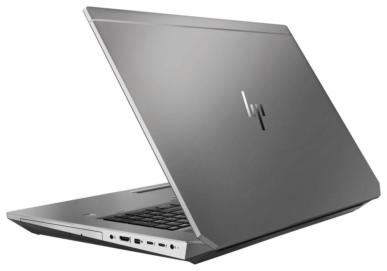

HP ZBook 17 G6 Mobile workstation 17 Specification for Upgrade or Repair
    HP ZBook 17 G6 Mobile workstation 17 Specification for Upgrade or Repair
    This specification for the HP ZBook 17 G6 Mobile workstation can be useful for upgrading or repairing a laptop that is not working. As a community we are working through our specifications to add valuable data like the 17 G6 boardview and 17 G6 schematic. Our users have donated over 1 million documents which are being added to the site. This page will be updated soon with additional information. Alternatively you can request additional help from our users directly on the relevant badcaps forum. Please note that we offer no warranties that any specification, datasheet, or download for HP ZBook 17 G6 Mobile workstation is accurate, safe, error free, or the fix you require.
    Design > Family: ZBook
    Design > Model Name: 17 G6
    Design > Part Number: 6TV08EA#ABB
    Design > Release Date: 01/08/2019
    Design > Series: 17
    Graphics > Discrete Graphics Card Model: NVIDIA Quadro RTX 4000
    Specification > Processor: i7-9850H 2.6GHz
    Specification > Weight: 3.2kg
    Processor > Processor Generation: 9th gen Intel Core i7
    Processor > Processor Model: i7-9850H
    Product Code: 6TV08EA#ABB
    Power > AC Adapter Power: 200W
    Weight And Dimensions > Depth: 288mm
    Weight And Dimensions > Height: 33mm
    Weight And Dimensions > Weight: 3.2kg
    Weight And Dimensions > Width: 416mm
    HP ZBook 17 G6 Mobile workstation 17 Specification for Upgrade or Repair
    HP ZBook ZBook 15u G3 Mobile Workstation Mobile workstation 15 Specification for Upgrade or Repair
    This specification for the HP ZBook ZBook 15u G3 Mobile Workstation Mobile workstation can be useful for upgrading or repairing a laptop that is not working. As a community we are working through our specifications to add valuable data like the ZBook 15u G3 Mobile Workstation boardview and ZBook 15u G3 Mobile Workstation schematic. Our users have donated over 1 million documents which are being added to the site. This page will be updated soon with additional information. Alternatively you can request additional help from our users directly on the relevant badcaps forum. Please note that we offer...
    09-06-2024, 05:30 AM
    HP ZBook ZBook 14u G6 Mobile Workstation Mobile workstation 14u Specification for Upgrade or Repair
    This specification for the HP ZBook ZBook 14u G6 Mobile Workstation Mobile workstation can be useful for upgrading or repairing a laptop that is not working. As a community we are working through our specifications to add valuable data like the ZBook 14u G6 Mobile Workstation boardview and ZBook 14u G6 Mobile Workstation schematic. Our users have donated over 1 million documents which are being added to the site. This page will be updated soon with additional information. Alternatively you can request additional help from our users directly on the relevant badcaps forum. Please note that we offer...
    09-06-2024, 09:10 AM
    HP ZBook ZBook 17 G3 Mobile Workstation Mobile workstation 17 Specification for Upgrade or Repair
    This specification for the HP ZBook ZBook 17 G3 Mobile Workstation Mobile workstation can be useful for upgrading or repairing a laptop that is not working. As a community we are working through our specifications to add valuable data like the ZBook 17 G3 Mobile Workstation boardview and ZBook 17 G3 Mobile Workstation schematic. Our users have donated over 1 million documents which are being added to the site. This page will be updated soon with additional information. Alternatively you can request additional help from our users directly on the relevant badcaps forum. Please note that we offer...
    09-06-2024, 05:30 AM
    HP ZBook ZBook Studio G5 Mobile Workstation Mobile workstation Studio Specification for Upgrade or Repair
    This specification for the HP ZBook ZBook Studio G5 Mobile Workstation Mobile workstation can be useful for upgrading or repairing a laptop that is not working. As a community we are working through our specifications to add valuable data like the ZBook Studio G5 Mobile Workstation boardview and ZBook Studio G5 Mobile Workstation schematic. Our users have donated over 1 million documents which are being added to the site. This page will be updated soon with additional information. Alternatively you can request additional help from our users directly on the relevant badcaps forum. Please note that...
    09-06-2024, 07:05 AM
    HP ZBook ZBook 15u G3 Mobile Workstation Mobile workstation 15 Specification for Upgrade or Repair
    This specification for the HP ZBook ZBook 15u G3 Mobile Workstation Mobile workstation can be useful for upgrading or repairing a laptop that is not working. As a community we are working through our specifications to add valuable data like the ZBook 15u G3 Mobile Workstation boardview and ZBook 15u G3 Mobile Workstation schematic. Our users have donated over 1 million documents which are being added to the site. This page will be updated soon with additional information. Alternatively you can request additional help from our users directly on the relevant badcaps forum. Please note that we offer...
    09-06-2024, 05:30 AM
