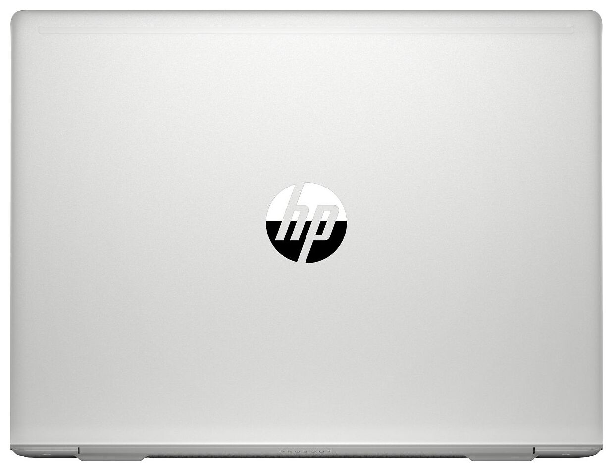

HP ProBook 430 G6 + Casio G-SHOCK Notebook 400 Specification for Upgrade or Repair
    • 115471
    HP ProBook 430 G6 + Casio G-SHOCK Notebook 400 Specification for Upgrade or Repair
    This specification for the HP ProBook 430 G6 + Casio G-SHOCK Notebook can be useful for upgrading or repairing a laptop that is not working. As a community we are working through our specifications to add valuable data like the 430 G6 + Casio G-SHOCK boardview and 430 G6 + Casio G-SHOCK schematic. Our users have donated over 1 million documents which are being added to the site. This page will be updated soon with additional information. Alternatively you can request additional help from our users directly on the relevant badcaps forum. Please note that we offer no warranties that any specification, datasheet, or download for HP ProBook 430 G6 + Casio G-SHOCK Notebook is accurate, safe, error free, or the fix you require.
    Design > Family: ProBook
    Design > Model Name: 430 G6 + Casio G-SHOCK
    Design > Part Number: 6BF79PA-G-SHOCK
    Design > Release Date: 01/08/2019
    Design > Series: 400
    Specification > Battery: 45 Wh
    Product Code: 6BF79PA-G-SHOCK
    Battery > Battery Capacity (Watt Hours): 45Wh
    Networking > Miracast: Yes
    Weight And Dimensions > Depth: 231mm
    Weight And Dimensions > Width: 308.5mm
    HP ProBook 430 G6 + Casio G-SHOCK Notebook 400 Specification for Upgrade or Repair
    HP ProBook 450 G5 + Casio G-SHOCK Notebook 400 Specification for Upgrade or Repair
    This specification for the HP ProBook 450 G5 + Casio G-SHOCK Notebook can be useful for upgrading or repairing a laptop that is not working. As a community we are working through our specifications to add valuable data like the 450 G5 + Casio G-SHOCK boardview and 450 G5 + Casio G-SHOCK schematic. Our users have donated over 1 million documents which are being added to the site. This page will be updated soon with additional information. Alternatively you can request additional help from our users directly on the relevant badcaps forum. Please note that we offer no warranties that any specification,...
    09-06-2024, 08:16 AM
    HP ProBook 430 G5 + Casio G-SHOCK Notebook 400 Specification for Upgrade or Repair
    This specification for the HP ProBook 430 G5 + Casio G-SHOCK Notebook can be useful for upgrading or repairing a laptop that is not working. As a community we are working through our specifications to add valuable data like the 430 G5 + Casio G-SHOCK boardview and 430 G5 + Casio G-SHOCK schematic. Our users have donated over 1 million documents which are being added to the site. This page will be updated soon with additional information. Alternatively you can request additional help from our users directly on the relevant badcaps forum. Please note that we offer no warranties that any specification,...
    09-06-2024, 08:16 AM
    HP ProBook 430 G6 + Casio G-SHOCK Notebook 400 Specification for Upgrade or Repair
    This specification for the HP ProBook 430 G6 + Casio G-SHOCK Notebook can be useful for upgrading or repairing a laptop that is not working. As a community we are working through our specifications to add valuable data like the 430 G6 + Casio G-SHOCK boardview and 430 G6 + Casio G-SHOCK schematic. Our users have donated over 1 million documents which are being added to the site. This page will be updated soon with additional information. Alternatively you can request additional help from our users directly on the relevant badcaps forum. Please note that we offer no warranties that any specification,...
    09-06-2024, 08:16 AM
    HP ProBook 450 G6 + Casio G-SHOCK Notebook 400 Specification for Upgrade or Repair
    This specification for the HP ProBook 450 G6 + Casio G-SHOCK Notebook can be useful for upgrading or repairing a laptop that is not working. As a community we are working through our specifications to add valuable data like the 450 G6 + Casio G-SHOCK boardview and 450 G6 + Casio G-SHOCK schematic. Our users have donated over 1 million documents which are being added to the site. This page will be updated soon with additional information. Alternatively you can request additional help from our users directly on the relevant badcaps forum. Please note that we offer no warranties that any specification,...
    09-06-2024, 08:16 AM
    HP ProBook 450 G6 + Casio G-SHOCK Notebook 400 Specification for Upgrade or Repair
    This specification for the HP ProBook 450 G6 + Casio G-SHOCK Notebook can be useful for upgrading or repairing a laptop that is not working. As a community we are working through our specifications to add valuable data like the 450 G6 + Casio G-SHOCK boardview and 450 G6 + Casio G-SHOCK schematic. Our users have donated over 1 million documents which are being added to the site. This page will be updated soon with additional information. Alternatively you can request additional help from our users directly on the relevant badcaps forum. Please note that we offer no warranties that any specification,...
    09-06-2024, 08:16 AM
