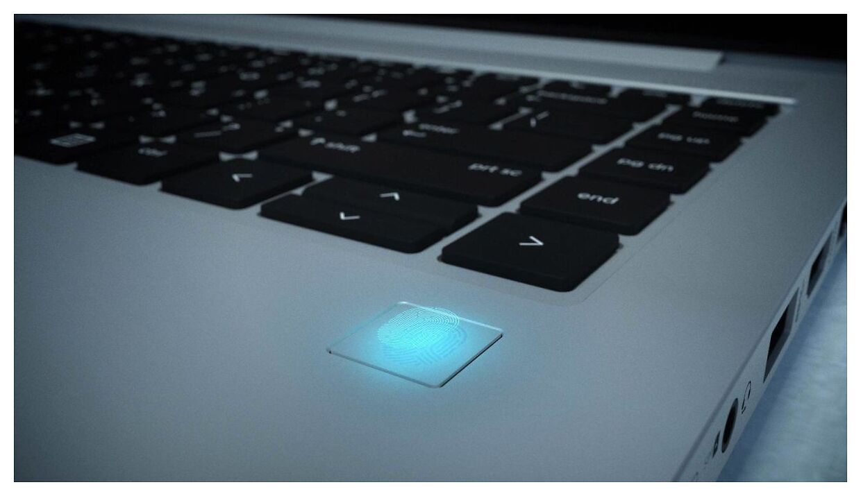

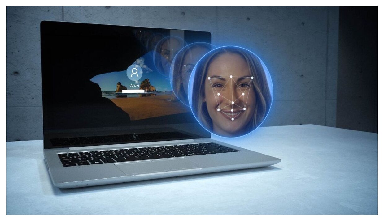

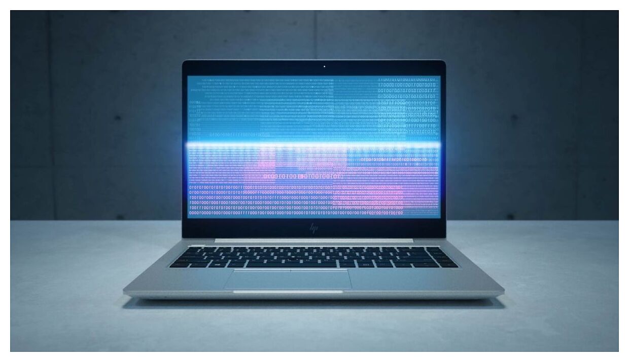

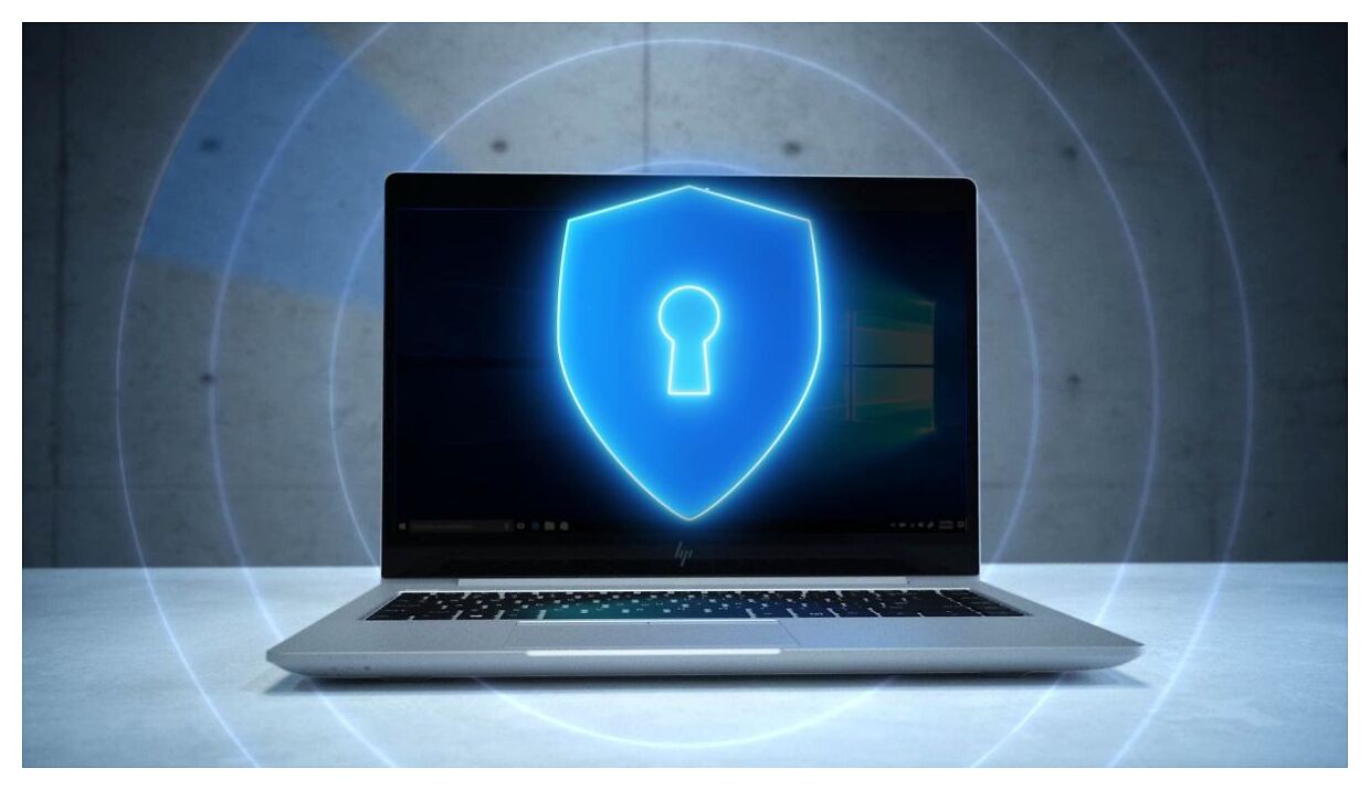

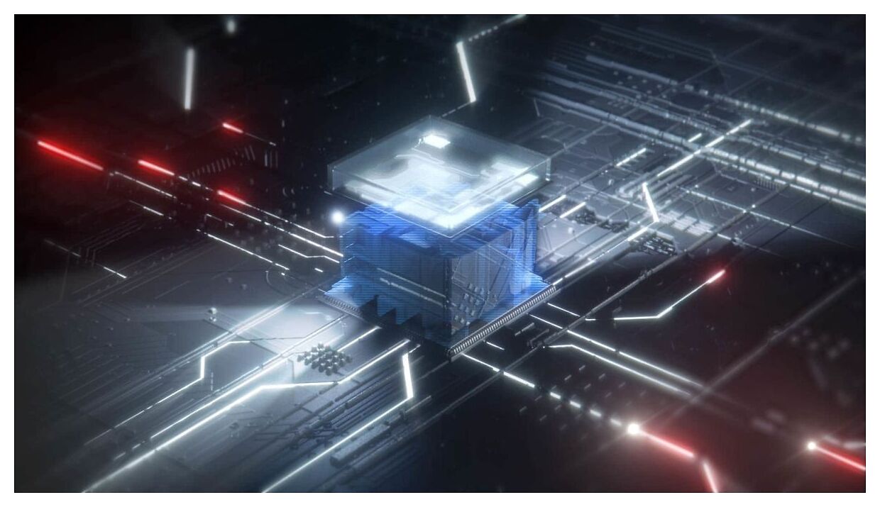

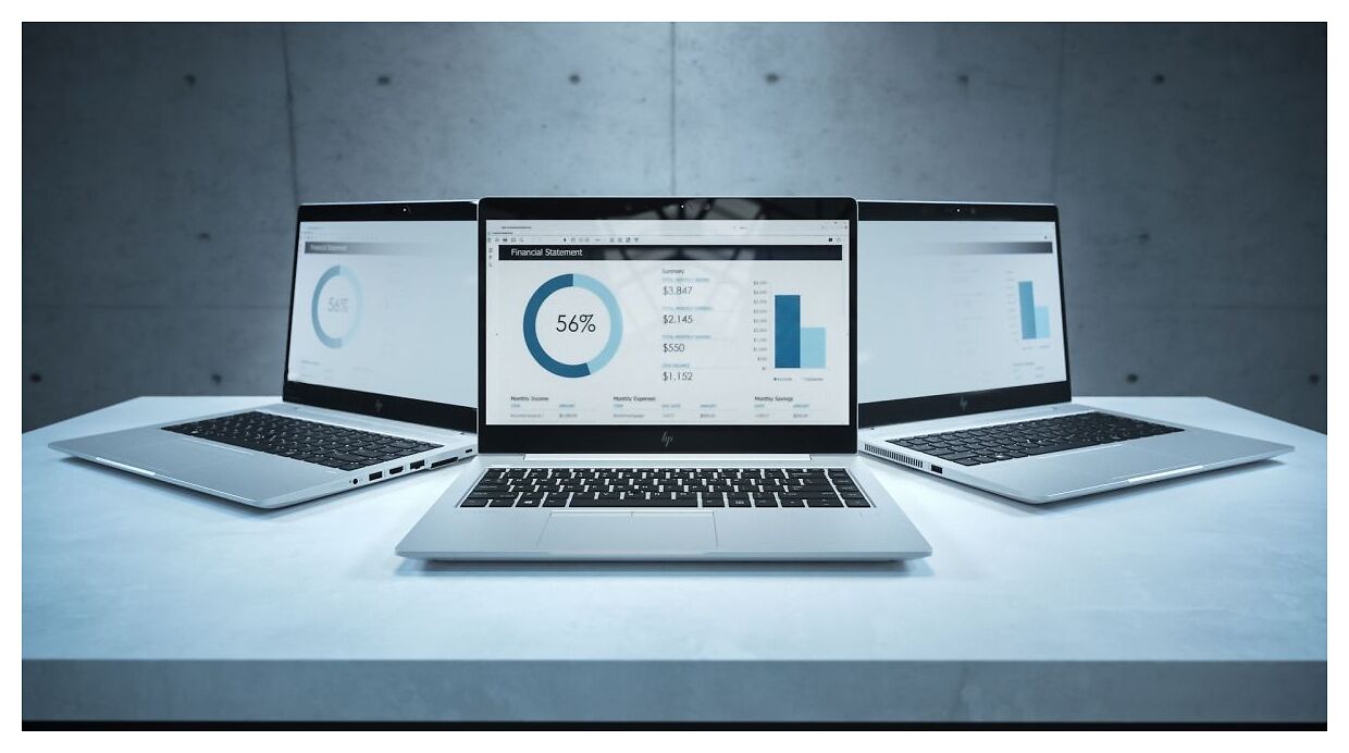

HP EliteBook x360 830 G6 Hybrid (2-in-1) Specification for Upgrade or Repair
    HP EliteBook x360 830 G6 Hybrid (2-in-1) Specification for Upgrade or Repair
    This specification for the HP EliteBook x360 830 G6 Hybrid (2-in-1) can be useful for upgrading or repairing a laptop that is not working. As a community we are working through our specifications to add valuable data like the 830 G6 boardview and 830 G6 schematic. Our users have donated over 1 million documents which are being added to the site. This page will be updated soon with additional information. Alternatively you can request additional help from our users directly on the relevant badcaps forum. Please note that we offer no warranties that any specification, datasheet, or download for HP EliteBook x360 830 G6 Hybrid (2-in-1) is accurate, safe, error free, or the fix you require.
    Design > EAN/UPC Code: 0193905332892, 0193905332885, 0193905456963, 0194850051944, 0193905678426, 0194441108668, 0193905604241, 0194441108606, 0194441818239, 0193905332830
    Design > Model Name: 830 G6
    Design > Part Number: 6XD35EA
    Design > Release Date: 01/08/2019
    Display > 3D: No
    Specification > Battery: 53 Wh
    Product Code: 6XD35EA
    Battery > Battery Capacity (Watt Hours): 53Wh
    Brand-specific Features > HP Front Camera: HP Webcam HD IR
    Weight And Dimensions > Depth: 215.2mm
    Weight And Dimensions > Width: 306.6mm
    HP EliteBook x360 830 G6 Hybrid (2-in-1) Specification for Upgrade or Repair
    HP EliteBook x360 EliteBook x360 1030 G2 Hybrid (2-in-1) Specification for Upgrade or Repair
    This specification for the HP EliteBook x360 EliteBook x360 1030 G2 Hybrid (2-in-1) can be useful for upgrading or repairing a laptop that is not working. As a community we are working through our specifications to add valuable data like the EliteBook x360 1030 G2 boardview and EliteBook x360 1030 G2 schematic. Our users have donated over 1 million documents which are being added to the site. This page will be updated soon with additional information. Alternatively you can request additional help from our users directly on the relevant badcaps forum. Please note that we offer no warranties that...
    09-06-2024, 08:27 AM
    HP EliteBook x360 EliteBook x360 1030 G2 (ENERGY STAR) Hybrid (2-in-1) Specification for Upgrade or Repair
    This specification for the HP EliteBook x360 EliteBook x360 1030 G2 (ENERGY STAR) Hybrid (2-in-1) can be useful for upgrading or repairing a laptop that is not working. As a community we are working through our specifications to add valuable data like the EliteBook x360 1030 G2 (ENERGY STAR) boardview and EliteBook x360 1030 G2 (ENERGY STAR) schematic. Our users have donated over 1 million documents which are being added to the site. This page will be updated soon with additional information. Alternatively you can request additional help from our users directly on the relevant badcaps forum. Please...
    09-06-2024, 05:33 AM
    HP EliteBook x360 EliteBook x360 1030 G2 (ENERGY STAR) Hybrid (2-in-1) Specification for Upgrade or Repair
    This specification for the HP EliteBook x360 EliteBook x360 1030 G2 (ENERGY STAR) Hybrid (2-in-1) can be useful for upgrading or repairing a laptop that is not working. As a community we are working through our specifications to add valuable data like the EliteBook x360 1030 G2 (ENERGY STAR) boardview and EliteBook x360 1030 G2 (ENERGY STAR) schematic. Our users have donated over 1 million documents which are being added to the site. This page will be updated soon with additional information. Alternatively you can request additional help from our users directly on the relevant badcaps forum. Please...
    09-06-2024, 06:40 AM
    HP EliteBook x360 EliteBook x360 1030 G2 (ENERGY STAR) Hybrid (2-in-1) Specification for Upgrade or Repair
    This specification for the HP EliteBook x360 EliteBook x360 1030 G2 (ENERGY STAR) Hybrid (2-in-1) can be useful for upgrading or repairing a laptop that is not working. As a community we are working through our specifications to add valuable data like the EliteBook x360 1030 G2 (ENERGY STAR) boardview and EliteBook x360 1030 G2 (ENERGY STAR) schematic. Our users have donated over 1 million documents which are being added to the site. This page will be updated soon with additional information. Alternatively you can request additional help from our users directly on the relevant badcaps forum. Please...
    09-06-2024, 05:33 AM
    HP EliteBook x360 EliteBook x360 1020 G2 Notebook Specification for Upgrade or Repair
    This specification for the HP EliteBook x360 EliteBook x360 1020 G2 Notebook can be useful for upgrading or repairing a laptop that is not working. As a community we are working through our specifications to add valuable data like the EliteBook x360 1020 G2 boardview and EliteBook x360 1020 G2 schematic. Our users have donated over 1 million documents which are being added to the site. This page will be updated soon with additional information. Alternatively you can request additional help from our users directly on the relevant badcaps forum. Please note that we offer no warranties that any specification,...
    09-06-2024, 06:10 AM
