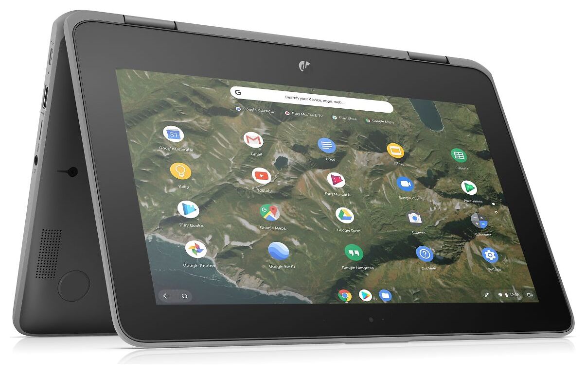

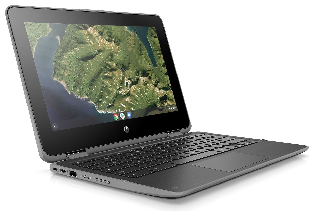

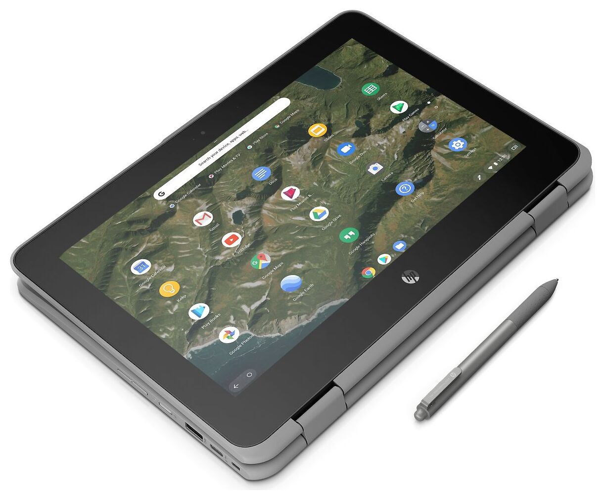

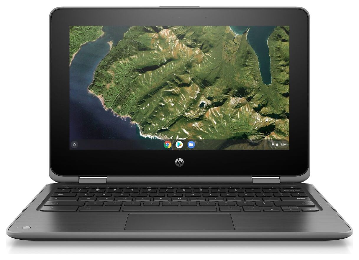

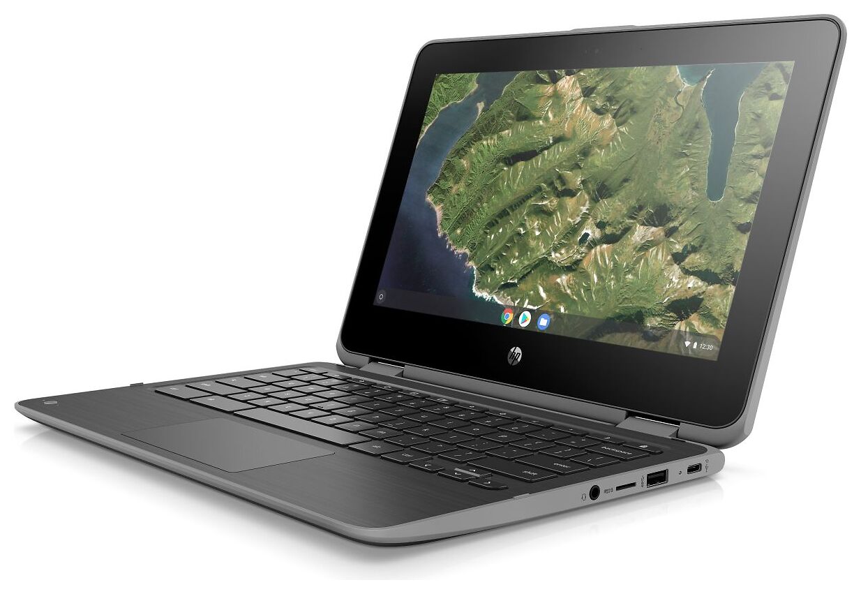

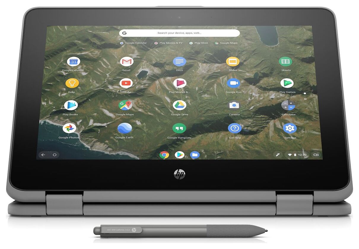

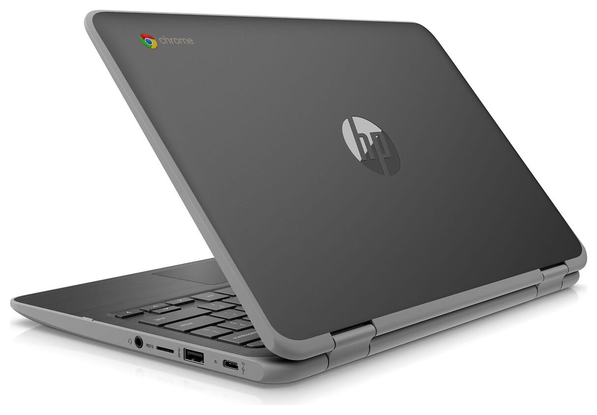

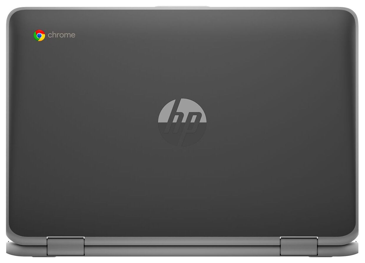

HP Chromebook x360 11 G2 EE Chromebook 11 Specification for Upgrade or Repair
    HP Chromebook x360 11 G2 EE Chromebook 11 Specification for Upgrade or Repair
    This specification for the HP Chromebook x360 11 G2 EE Chromebook can be useful for upgrading or repairing a laptop that is not working. As a community we are working through our specifications to add valuable data like the 11 G2 EE boardview and 11 G2 EE schematic. Our users have donated over 1 million documents which are being added to the site. This page will be updated soon with additional information. Alternatively you can request additional help from our users directly on the relevant badcaps forum. Please note that we offer no warranties that any specification, datasheet, or download for HP Chromebook x360 11 G2 EE Chromebook is accurate, safe, error free, or the fix you require.
    Design > EAN/UPC Code: 0193905611904, 193905611904, 0193905968756, 193905968756
    Design > Family: Chromebook x360
    Design > Model Name: 11 G2 EE
    Design > Part Number: 6UN01EA
    Design > Release Date: 01/08/2019
    Design > Series: 11
    Display > Colour Gamut: 0.5
    Display > HD Type: HD
    Graphics > On-board Graphics Card ID: 0x3185
    Specification > Battery: 47.36 Wh
    Specification > Processor: N4100 1.1GHz
    Specification > Storage: 32GB eMMC
    Memory > ECC: No
    Memory > Internal Memory: 4GB
    Processor > Processor Boost Frequency: 2.4GHz
    Processor > Processor Model: N4100
    Product Code: 6UN01EA
    Battery > Battery Capacity: 47 Wh
    Battery > Battery Capacity (Watt Hours): 47.36Wh
    Networking > WLAN Controller Model: Intel Dual Band Wireless-AC 9260
    Ports & Interfaces > USB 3.0 (3.1 Gen 1) Type-C Ports Qty: 2
    Ports & Interfaces > USB Sleep-and-Charge Ports: 2
    Software > Operating System Installed: ChromeOS
    Storage > Storage Media: eMMC
    Weight And Dimensions > Depth: 208mm
    Weight And Dimensions > Height: 21.1mm
    Weight And Dimensions > Width: 306mm
    HP Chromebook x360 11 G2 EE Chromebook 11 Specification for Upgrade or Repair
    HP Chromebook x360 Chromebook x360 12-h0500sa Chromebook 12 Specification for Upgrade or Repair
    This specification for the HP Chromebook x360 Chromebook x360 12-h0500sa Chromebook can be useful for upgrading or repairing a laptop that is not working. As a community we are working through our specifications to add valuable data like the Chromebook x360 12-h0500sa boardview and Chromebook x360 12-h0500sa schematic. Our users have donated over 1 million documents which are being added to the site. This page will be updated soon with additional information. Alternatively you can request additional help from our users directly on the relevant badcaps forum. Please note that we offer no warranties...
    09-06-2024, 11:39 AM
    HP Chromebook x360 14-da0001na Chromebook Specification for Upgrade or Repair
    This specification for the HP Chromebook x360 14-da0001na Chromebook can be useful for upgrading or repairing a laptop that is not working. As a community we are working through our specifications to add valuable data like the 14-da0001na boardview and 14-da0001na schematic. Our users have donated over 1 million documents which are being added to the site. This page will be updated soon with additional information. Alternatively you can request additional help from our users directly on the relevant badcaps forum. Please note that we offer no warranties that any specification, datasheet, or download...
    09-06-2024, 07:42 AM
    HP Chromebook x360 14 G1 Chromebook 14 Specification for Upgrade or Repair
    This specification for the HP Chromebook x360 14 G1 Chromebook can be useful for upgrading or repairing a laptop that is not working. As a community we are working through our specifications to add valuable data like the 14 G1 boardview and 14 G1 schematic. Our users have donated over 1 million documents which are being added to the site. This page will be updated soon with additional information. Alternatively you can request additional help from our users directly on the relevant badcaps forum. Please note that we offer no warranties that any specification, datasheet, or download for HP Chromebook...
    09-06-2024, 07:50 AM
    HP Chromebook x360 Chromebook x360 - 11-ae010nr Chromebook Specification for Upgrade or Repair
    This specification for the HP Chromebook x360 Chromebook x360 - 11-ae010nr Chromebook can be useful for upgrading or repairing a laptop that is not working. As a community we are working through our specifications to add valuable data like the Chromebook x360 - 11-ae010nr boardview and Chromebook x360 - 11-ae010nr schematic. Our users have donated over 1 million documents which are being added to the site. This page will be updated soon with additional information. Alternatively you can request additional help from our users directly on the relevant badcaps forum. Please note that we offer no...
    09-06-2024, 06:00 AM
    HP Chromebook x360 14c-ca0501na Chromebook 14 Specification for Upgrade or Repair
    This specification for the HP Chromebook x360 14c-ca0501na Chromebook can be useful for upgrading or repairing a laptop that is not working. As a community we are working through our specifications to add valuable data like the 14c-ca0501na boardview and 14c-ca0501na schematic. Our users have donated over 1 million documents which are being added to the site. This page will be updated soon with additional information. Alternatively you can request additional help from our users directly on the relevant badcaps forum. Please note that we offer no warranties that any specification, datasheet, or...
    09-06-2024, 07:20 PM
