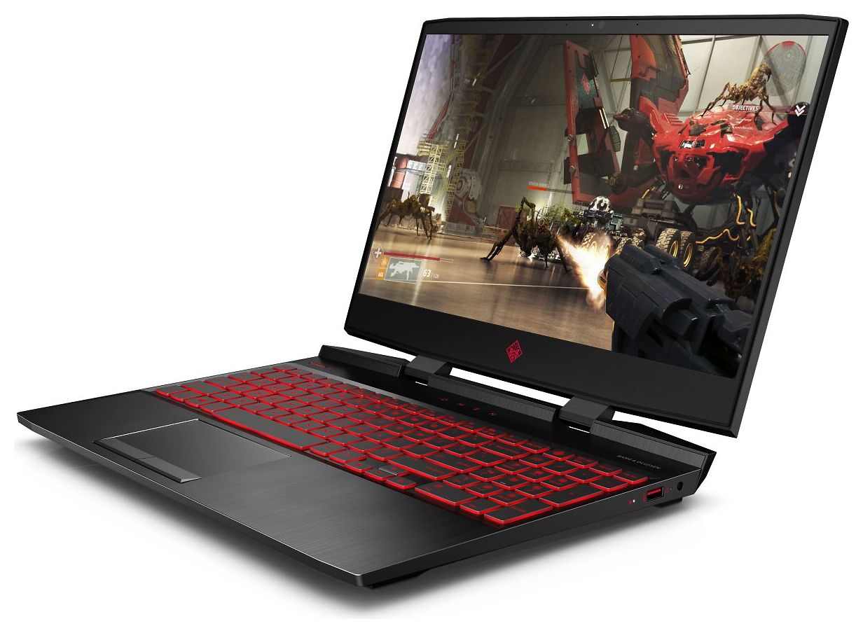

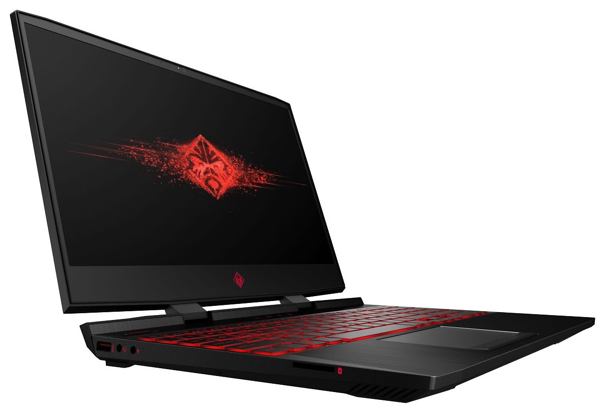

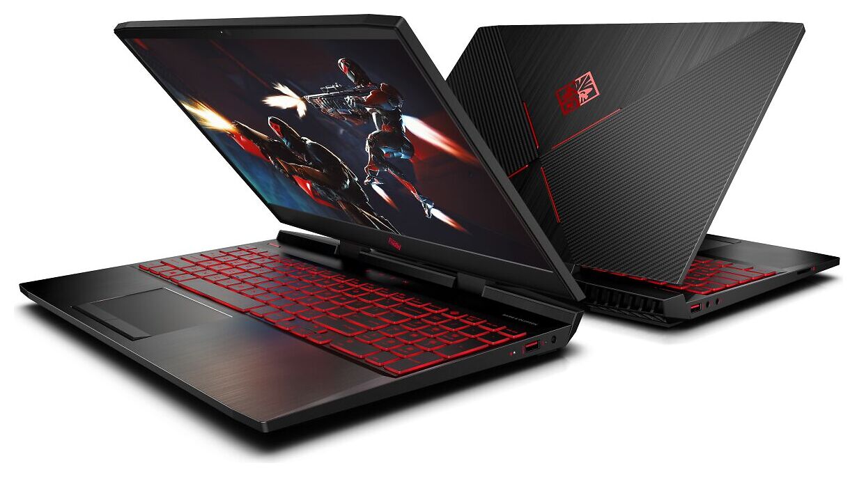

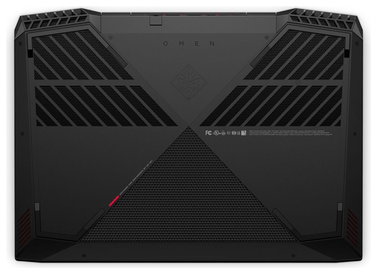

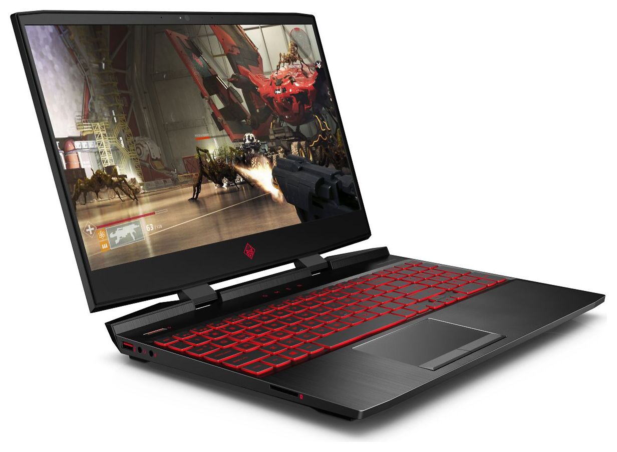

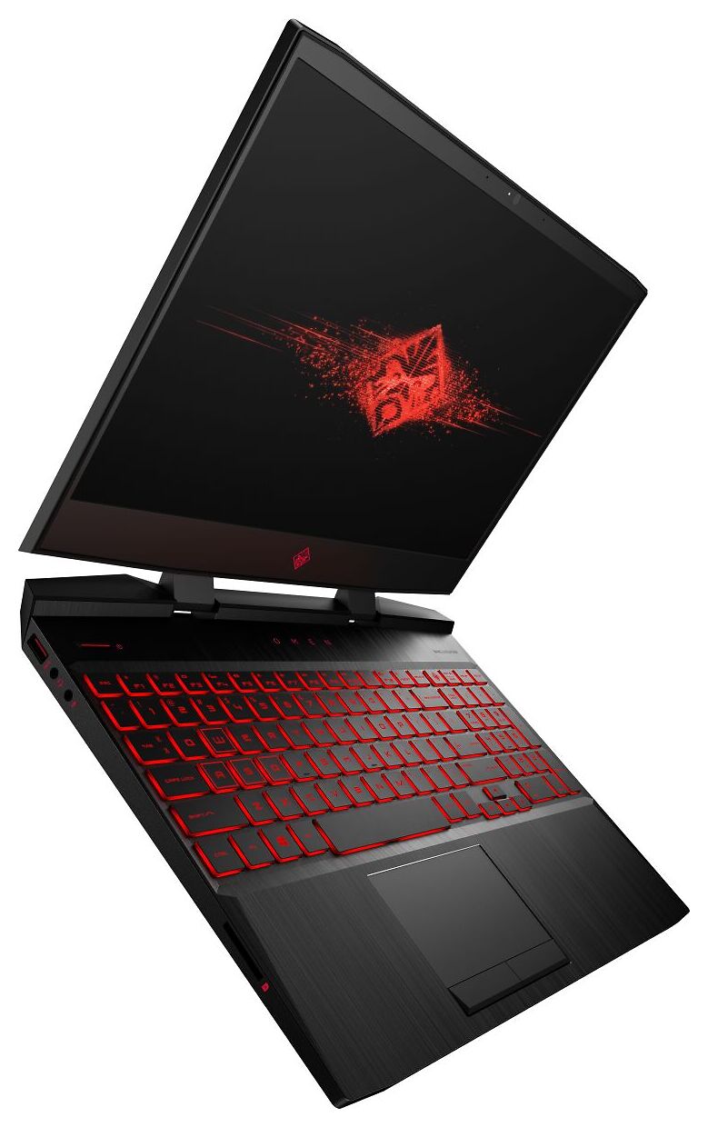

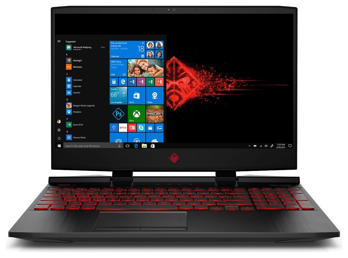

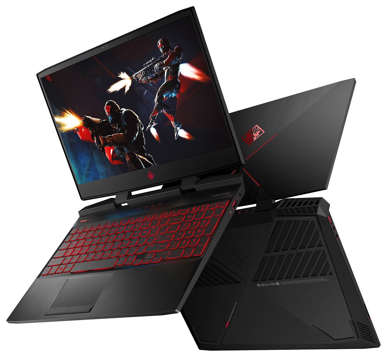

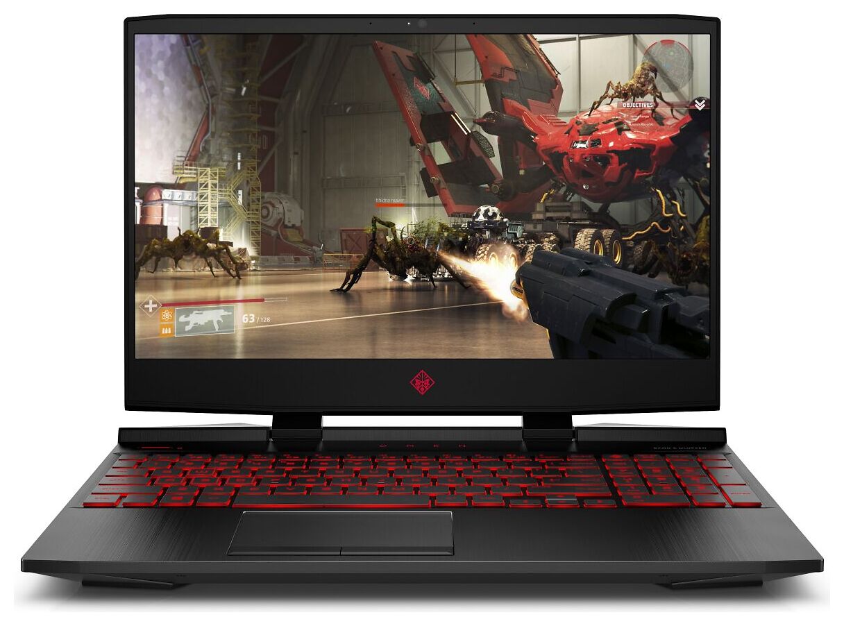

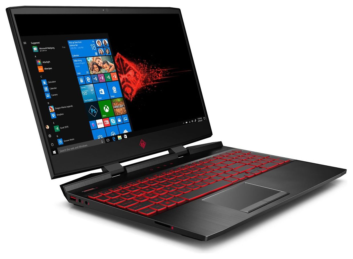

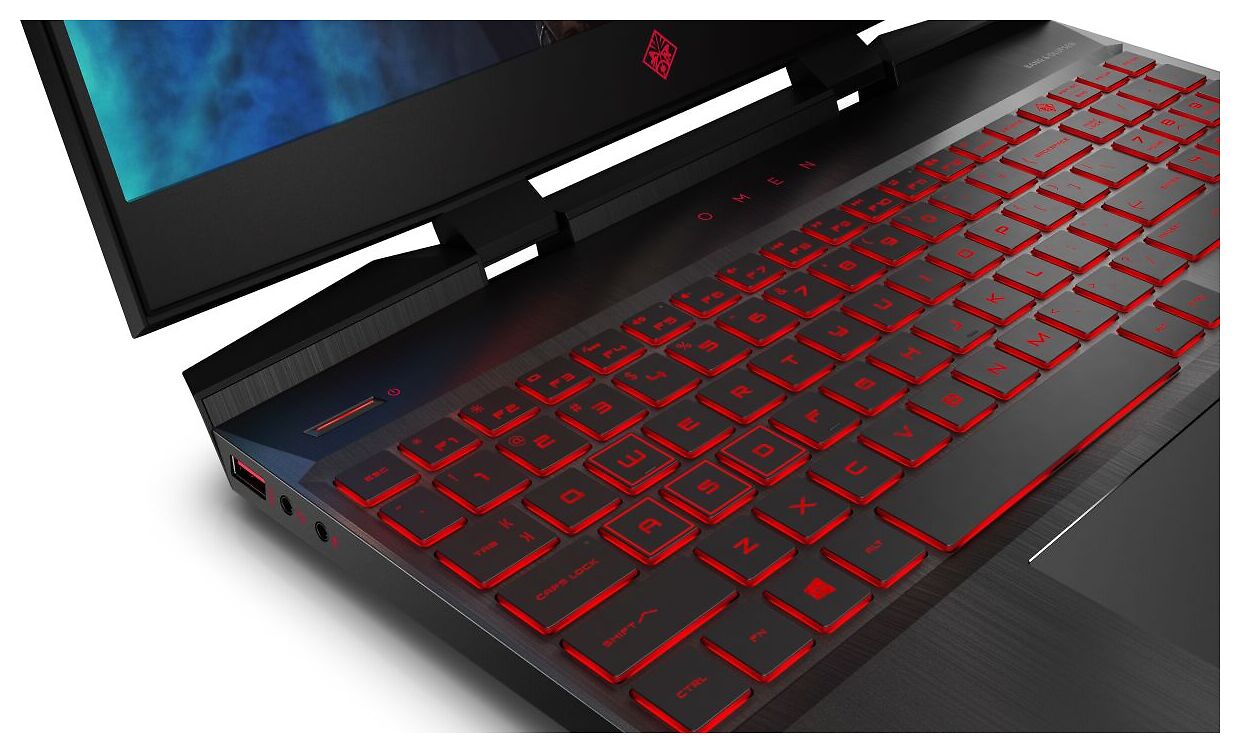

HP OMEN 15-dc0091cl Notebook 15 Specification for Upgrade or Repair
    HP OMEN 15-dc0091cl Notebook 15 Specification for Upgrade or Repair
    This specification for the HP OMEN 15-dc0091cl Notebook can be useful for upgrading or repairing a laptop that is not working. As a community we are working through our specifications to add valuable data like the 15-dc0091cl boardview and 15-dc0091cl schematic. Our users have donated over 1 million documents which are being added to the site. This page will be updated soon with additional information. Alternatively you can request additional help from our users directly on the relevant badcaps forum. Please note that we offer no warranties that any specification, datasheet, or download for HP OMEN 15-dc0091cl Notebook is accurate, safe, error free, or the fix you require.
    Design > Family: OMEN
    Design > Model Name: 15-dc0091cl
    Design > Part Number: 4LU25UAR
    Design > Release Date: 31/07/2019
    Design > Series: 15
    Graphics > Discrete Graphics Card Model: NVIDIA GeForce GTX 1050 Ti
    Specification > Battery: 6 hrs
    Specification > Weight: 2.3kg
    Product Code: 4LU25UAR
    Audio > Speakers Manufacturer: Bang & Olufsen
    Brand-specific Features > HP EPrint: Yes
    Brand-specific Features > HP Recovery Manager: Yes
    Keyboard > Keyboard Backlit Colour: Red
    Ports & Interfaces > USB Sleep-and-Charge Ports: 2
    Storage > HDD Interface: SATA
    Storage > HDD Speed: 7200RPM
    Storage > Intel Optane Memory Module Capacity: 16GB
    Storage > Intel Optane Memory Module Installed: Yes
    Storage > Storage Media: HDD
    Weight And Dimensions > Depth: 263mm
    Weight And Dimensions > Height: 26mm
    HP OMEN 15-dc0091cl Notebook 15 Specification for Upgrade or Repair
    HP OMEN OMEN by 17-cb0588na Notebook 17 Specification for Upgrade or Repair
    This specification for the HP OMEN OMEN by 17-cb0588na Notebook can be useful for upgrading or repairing a laptop that is not working. As a community we are working through our specifications to add valuable data like the OMEN by 17-cb0588na boardview and OMEN by 17-cb0588na schematic. Our users have donated over 1 million documents which are being added to the site. This page will be updated soon with additional information. Alternatively you can request additional help from our users directly on the relevant badcaps forum. Please note that we offer no warranties that any specification, datasheet,...
    09-06-2024, 09:09 AM
    HP OMEN 15-dc1007na Notebook 15 Specification for Upgrade or Repair
    This specification for the HP OMEN 15-dc1007na Notebook can be useful for upgrading or repairing a laptop that is not working. As a community we are working through our specifications to add valuable data like the 15-dc1007na boardview and 15-dc1007na schematic. Our users have donated over 1 million documents which are being added to the site. This page will be updated soon with additional information. Alternatively you can request additional help from our users directly on the relevant badcaps forum. Please note that we offer no warranties that any specification, datasheet, or download for HP...
    09-06-2024, 08:35 AM
    HP OMEN OMEN by Desktop PC - 870-060na (ENERGY STAR) OMEN i7-6700 Specification for Upgrade or Repair
    This specification for the HP OMEN OMEN by Desktop PC - 870-060na (ENERGY STAR) can be useful for upgrading or repairing a desktop PC that is not working. As a community we are working through our specifications to add valuable data like the OMEN OMEN by Desktop PC - 870-060na (ENERGY STAR) boardview and OMEN OMEN by Desktop PC - 870-060na (ENERGY STAR) schematic. Our users have donated over 1 million documents which are being added to the site. This page will be updated soon with additional information. Alternatively you can request additional help from our users directly on the relevant badcaps...
    09-12-2024, 03:44 PM
    HP OMEN OMEN by Desktop PC - 870-010na (ENERGY STAR) OMEN i5-6400 Specification for Upgrade or Repair
    This specification for the HP OMEN OMEN by Desktop PC - 870-010na (ENERGY STAR) can be useful for upgrading or repairing a desktop PC that is not working. As a community we are working through our specifications to add valuable data like the OMEN OMEN by Desktop PC - 870-010na (ENERGY STAR) boardview and OMEN OMEN by Desktop PC - 870-010na (ENERGY STAR) schematic. Our users have donated over 1 million documents which are being added to the site. This page will be updated soon with additional information. Alternatively you can request additional help from our users directly on the relevant badcaps...
    09-12-2024, 03:44 PM
    HP OMEN X OMEN X by - 17-ap099na Notebook Specification for Upgrade or Repair
    This specification for the HP OMEN X OMEN X by - 17-ap099na Notebook can be useful for upgrading or repairing a laptop that is not working. As a community we are working through our specifications to add valuable data like the OMEN X by - 17-ap099na boardview and OMEN X by - 17-ap099na schematic. Our users have donated over 1 million documents which are being added to the site. This page will be updated soon with additional information. Alternatively you can request additional help from our users directly on the relevant badcaps forum. Please note that we offer no warranties that any specification,...
    09-06-2024, 08:58 AM
