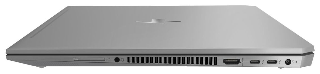

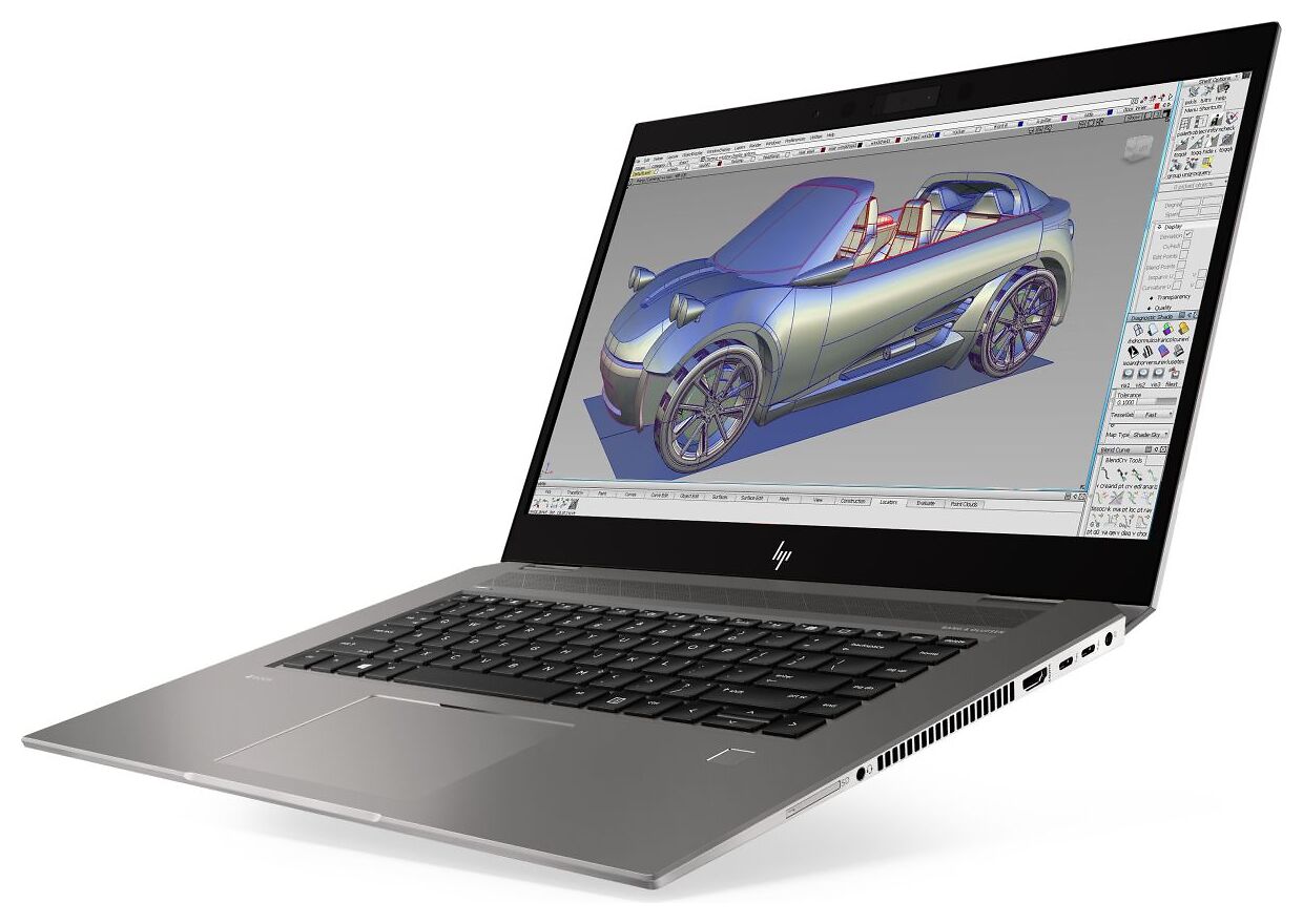

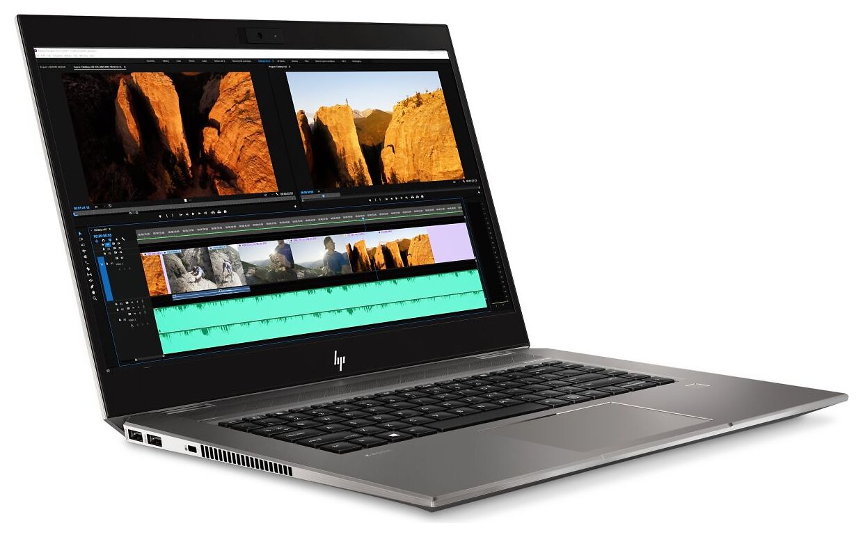

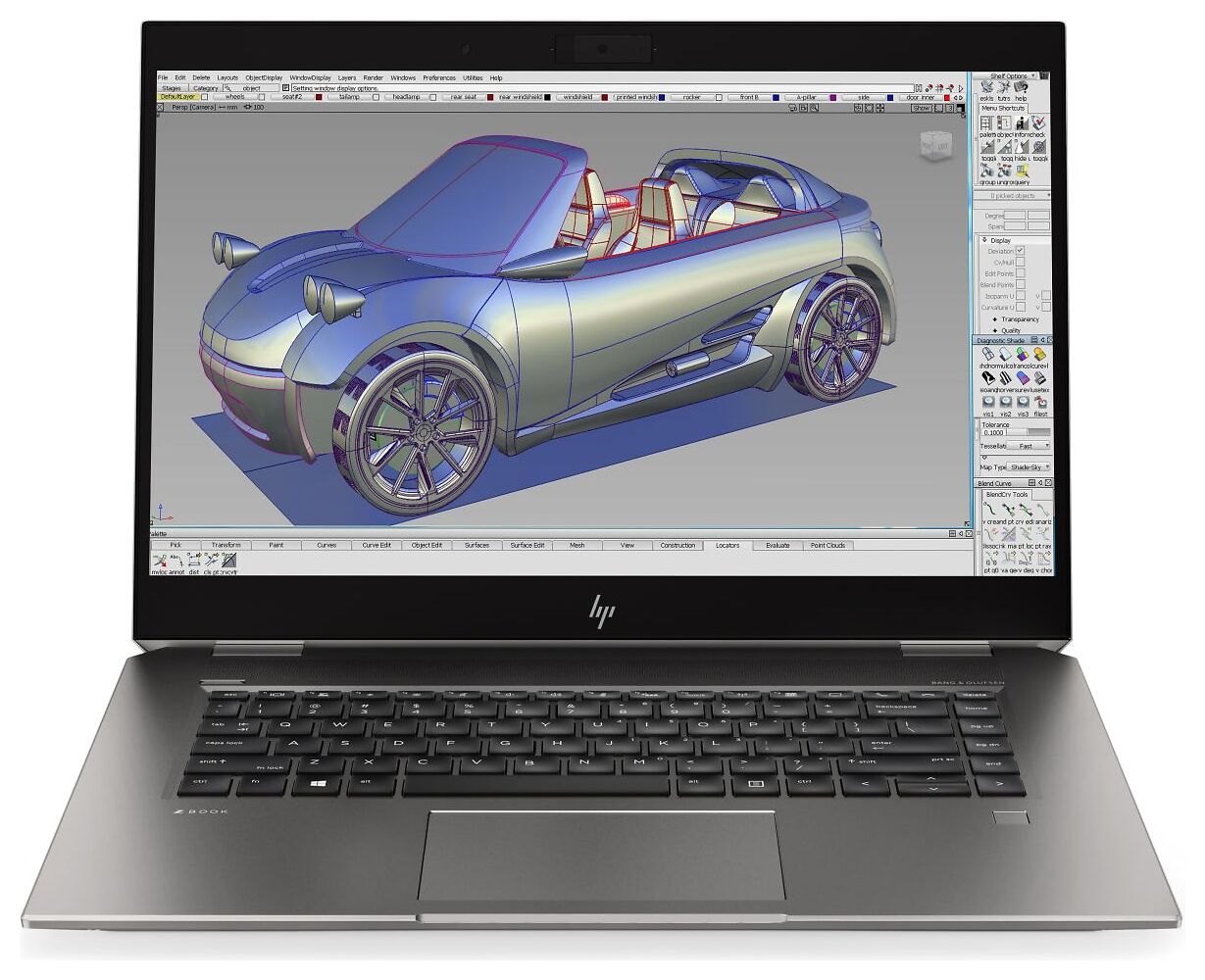

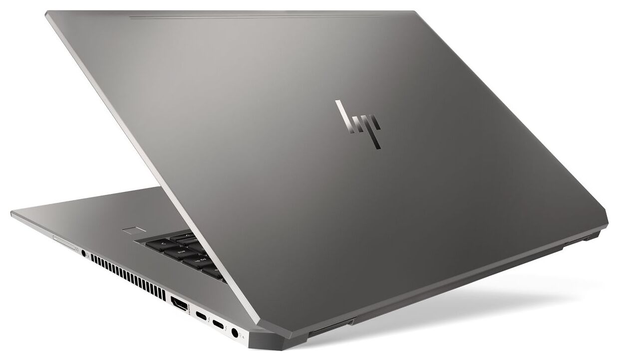

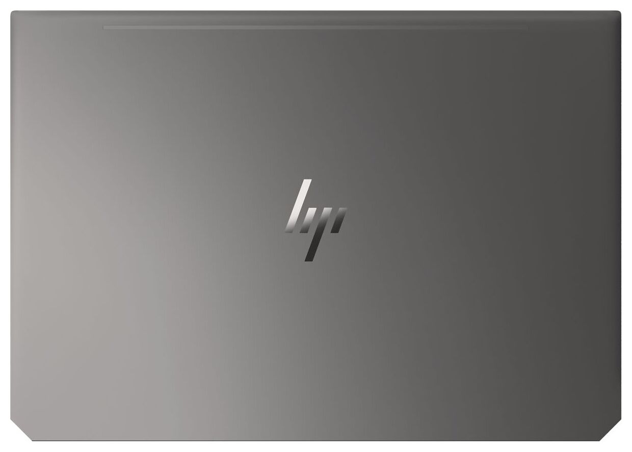

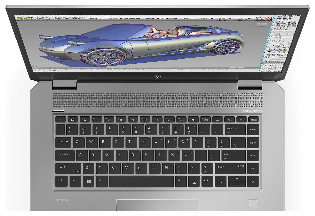

HP ZBook Studio G5 Mobile workstation Studio Specification for Upgrade or Repair
    • 115471
    HP ZBook Studio G5 Mobile workstation Studio Specification for Upgrade or Repair
    This specification for the HP ZBook Studio G5 Mobile workstation can be useful for upgrading or repairing a laptop that is not working. As a community we are working through our specifications to add valuable data like the Studio G5 boardview and Studio G5 schematic. Our users have donated over 1 million documents which are being added to the site. This page will be updated soon with additional information. Alternatively you can request additional help from our users directly on the relevant badcaps forum. Please note that we offer no warranties that any specification, datasheet, or download for HP ZBook Studio G5 Mobile workstation is accurate, safe, error free, or the fix you require.
    Design > Family: ZBook
    Design > Model Name: Studio G5
    Design > Part Number: 5DV36US
    Design > Release Date: 22/07/2019
    Design > Series: Studio
    Display > 3D: No
    Product Code: 5DV36US
    HP ZBook Studio G5 Mobile workstation Studio Specification for Upgrade or Repair
    HP ZBook ZBook Studio G3 Mobile Workstation Mobile workstation Studio Specification for Upgrade or Repair
    This specification for the HP ZBook ZBook Studio G3 Mobile Workstation Mobile workstation can be useful for upgrading or repairing a laptop that is not working. As a community we are working through our specifications to add valuable data like the ZBook Studio G3 Mobile Workstation boardview and ZBook Studio G3 Mobile Workstation schematic. Our users have donated over 1 million documents which are being added to the site. This page will be updated soon with additional information. Alternatively you can request additional help from our users directly on the relevant badcaps forum. Please note that...
    09-06-2024, 06:02 AM
    HP ZBook ZBook Studio G5 Mobile Workstation Mobile workstation Studio Specification for Upgrade or Repair
    This specification for the HP ZBook ZBook Studio G5 Mobile Workstation Mobile workstation can be useful for upgrading or repairing a laptop that is not working. As a community we are working through our specifications to add valuable data like the ZBook Studio G5 Mobile Workstation boardview and ZBook Studio G5 Mobile Workstation schematic. Our users have donated over 1 million documents which are being added to the site. This page will be updated soon with additional information. Alternatively you can request additional help from our users directly on the relevant badcaps forum. Please note that...
    09-06-2024, 07:05 AM
    HP ZBook ZBook Studio G3 Mobile Workstation Ultrabook Studio Specification for Upgrade or Repair
    This specification for the HP ZBook ZBook Studio G3 Mobile Workstation Ultrabook can be useful for upgrading or repairing a laptop that is not working. As a community we are working through our specifications to add valuable data like the ZBook Studio G3 Mobile Workstation boardview and ZBook Studio G3 Mobile Workstation schematic. Our users have donated over 1 million documents which are being added to the site. This page will be updated soon with additional information. Alternatively you can request additional help from our users directly on the relevant badcaps forum. Please note that we offer...
    09-06-2024, 05:30 AM
    HP ZBook ZBook 15u G3 Mobile Workstation Mobile workstation 15 Specification for Upgrade or Repair
    This specification for the HP ZBook ZBook 15u G3 Mobile Workstation Mobile workstation can be useful for upgrading or repairing a laptop that is not working. As a community we are working through our specifications to add valuable data like the ZBook 15u G3 Mobile Workstation boardview and ZBook 15u G3 Mobile Workstation schematic. Our users have donated over 1 million documents which are being added to the site. This page will be updated soon with additional information. Alternatively you can request additional help from our users directly on the relevant badcaps forum. Please note that we offer...
    09-06-2024, 05:30 AM
    HP ZBook ZBook Studio G3 Mobile Workstation Ultrabook Specification for Upgrade or Repair
    This specification for the HP ZBook ZBook Studio G3 Mobile Workstation Ultrabook can be useful for upgrading or repairing a laptop that is not working. As a community we are working through our specifications to add valuable data like the ZBook Studio G3 Mobile Workstation boardview and ZBook Studio G3 Mobile Workstation schematic. Our users have donated over 1 million documents which are being added to the site. This page will be updated soon with additional information. Alternatively you can request additional help from our users directly on the relevant badcaps forum. Please note that we offer...
    09-06-2024, 05:30 AM
