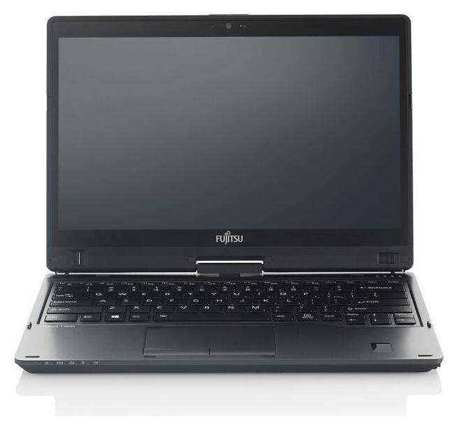

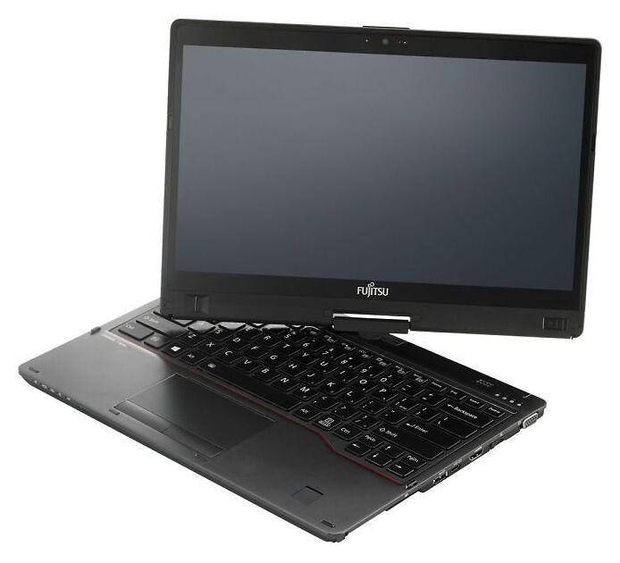

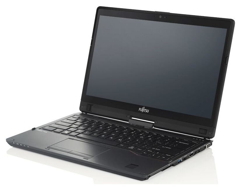

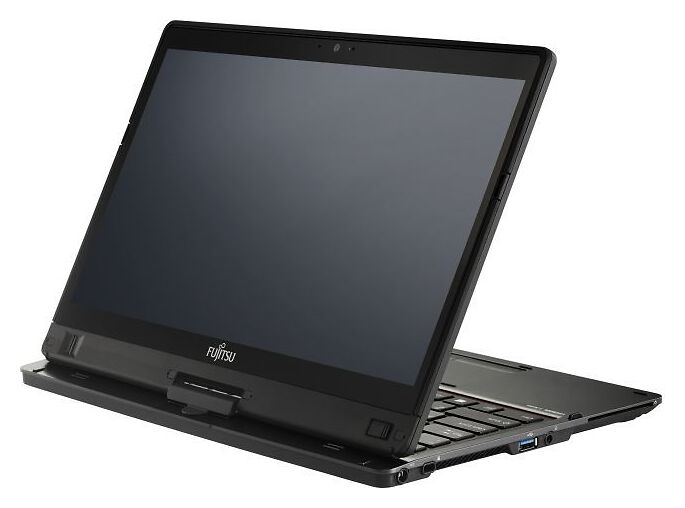

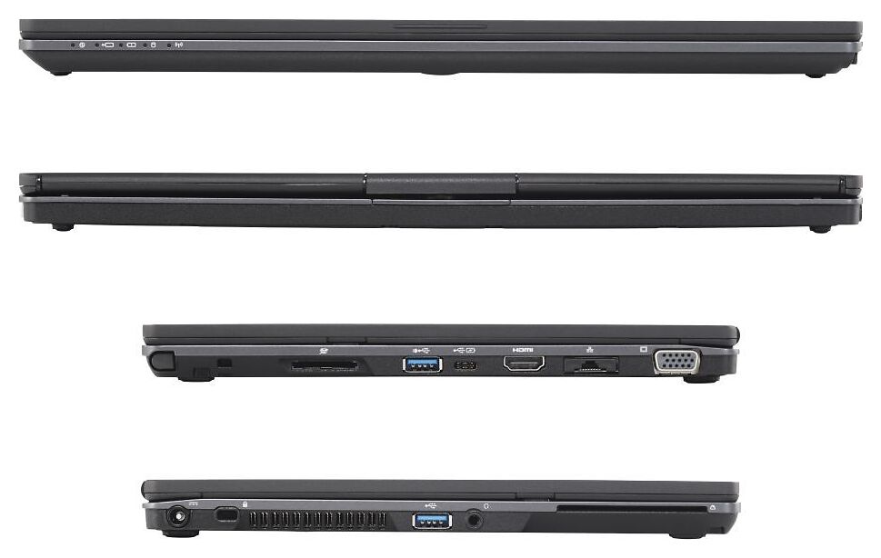

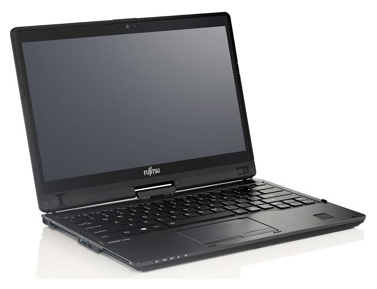

Fujitsu LIFEBOOK T939 Hybrid (2-in-1) T Specification for Upgrade or Repair
    Fujitsu LIFEBOOK T939 Hybrid (2-in-1) T Specification for Upgrade or Repair
    This specification for the Fujitsu LIFEBOOK T939 Hybrid (2-in-1) can be useful for upgrading or repairing a laptop that is not working. As a community we are working through our specifications to add valuable data like the T939 boardview and T939 schematic. Our users have donated over 1 million documents which are being added to the site. This page will be updated soon with additional information. Alternatively you can request additional help from our users directly on the relevant badcaps forum. Please note that we offer no warranties that any specification, datasheet, or download for Fujitsu LIFEBOOK T939 Hybrid (2-in-1) is accurate, safe, error free, or the fix you require.
    Design > Brand: Fujitsu
    Design > Family: LIFEBOOK
    Design > Form Factor: Convertible (Swivel)
    Design > Model Name: T939
    Design > Part Number: VFY:T9390MP790DE
    Design > Release Date: 28/06/2019
    Design > Series: T
    Display > Display Brightness: 285 cd/m^2
    Specification > Battery: 50 Wh
    Specification > Processor: i7-8665U 1.9GHz
    Specification > Storage: 1.02 TB SSD
    Specification > Weight: 1.3kg
    Processor > Processor Model: i7-8665U
    Product Code: VFY:T9390MP790DE
    Battery > Battery Capacity (Watt Hours): 50Wh
    Networking > 3G: Yes
    Networking > 4G: Yes
    Performance > Electronic Compass: Yes
    Performance > Gyroscope: Yes
    Performance > Orientation Sensor: Yes
    Storage > SSD Capacity: 1.02 TB
    Storage > Total Storage Capacity: 1.02 TB
    Weight And Dimensions > Depth: 224mm
    Weight And Dimensions > Height: 19.8mm
    Weight And Dimensions > Width: 318mm
    Fujitsu LIFEBOOK T939 Hybrid (2-in-1) T Specification for Upgrade or Repair
    Fujitsu LIFEBOOK T939 Hybrid (2-in-1) T Specification for Upgrade or Repair
    This specification for the Fujitsu LIFEBOOK T939 Hybrid (2-in-1) can be useful for upgrading or repairing a laptop that is not working. As a community we are working through our specifications to add valuable data like the T939 boardview and T939 schematic. Our users have donated over 1 million documents which are being added to the site. This page will be updated soon with additional information. Alternatively you can request additional help from our users directly on the relevant badcaps forum. Please note that we offer no warranties that any specification, datasheet, or download for Fujitsu...
    09-06-2024, 09:06 AM
    Fujitsu LIFEBOOK T939 Hybrid (2-in-1) T Specification for Upgrade or Repair
    This specification for the Fujitsu LIFEBOOK T939 Hybrid (2-in-1) can be useful for upgrading or repairing a laptop that is not working. As a community we are working through our specifications to add valuable data like the T939 boardview and T939 schematic. Our users have donated over 1 million documents which are being added to the site. This page will be updated soon with additional information. Alternatively you can request additional help from our users directly on the relevant badcaps forum. Please note that we offer no warranties that any specification, datasheet, or download for Fujitsu...
    09-06-2024, 09:00 AM
    Fujitsu LIFEBOOK T939 Hybrid (2-in-1) T Specification for Upgrade or Repair
    This specification for the Fujitsu LIFEBOOK T939 Hybrid (2-in-1) can be useful for upgrading or repairing a laptop that is not working. As a community we are working through our specifications to add valuable data like the T939 boardview and T939 schematic. Our users have donated over 1 million documents which are being added to the site. This page will be updated soon with additional information. Alternatively you can request additional help from our users directly on the relevant badcaps forum. Please note that we offer no warranties that any specification, datasheet, or download for Fujitsu...
    09-06-2024, 09:00 AM
    Fujitsu LIFEBOOK T939 Hybrid (2-in-1) T Specification for Upgrade or Repair
    This specification for the Fujitsu LIFEBOOK T939 Hybrid (2-in-1) can be useful for upgrading or repairing a laptop that is not working. As a community we are working through our specifications to add valuable data like the T939 boardview and T939 schematic. Our users have donated over 1 million documents which are being added to the site. This page will be updated soon with additional information. Alternatively you can request additional help from our users directly on the relevant badcaps forum. Please note that we offer no warranties that any specification, datasheet, or download for Fujitsu...
    09-06-2024, 09:00 AM
    Fujitsu LIFEBOOK T939 Hybrid (2-in-1) T Specification for Upgrade or Repair
    This specification for the Fujitsu LIFEBOOK T939 Hybrid (2-in-1) can be useful for upgrading or repairing a laptop that is not working. As a community we are working through our specifications to add valuable data like the T939 boardview and T939 schematic. Our users have donated over 1 million documents which are being added to the site. This page will be updated soon with additional information. Alternatively you can request additional help from our users directly on the relevant badcaps forum. Please note that we offer no warranties that any specification, datasheet, or download for Fujitsu...
    09-06-2024, 09:00 AM
