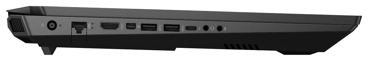

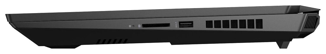

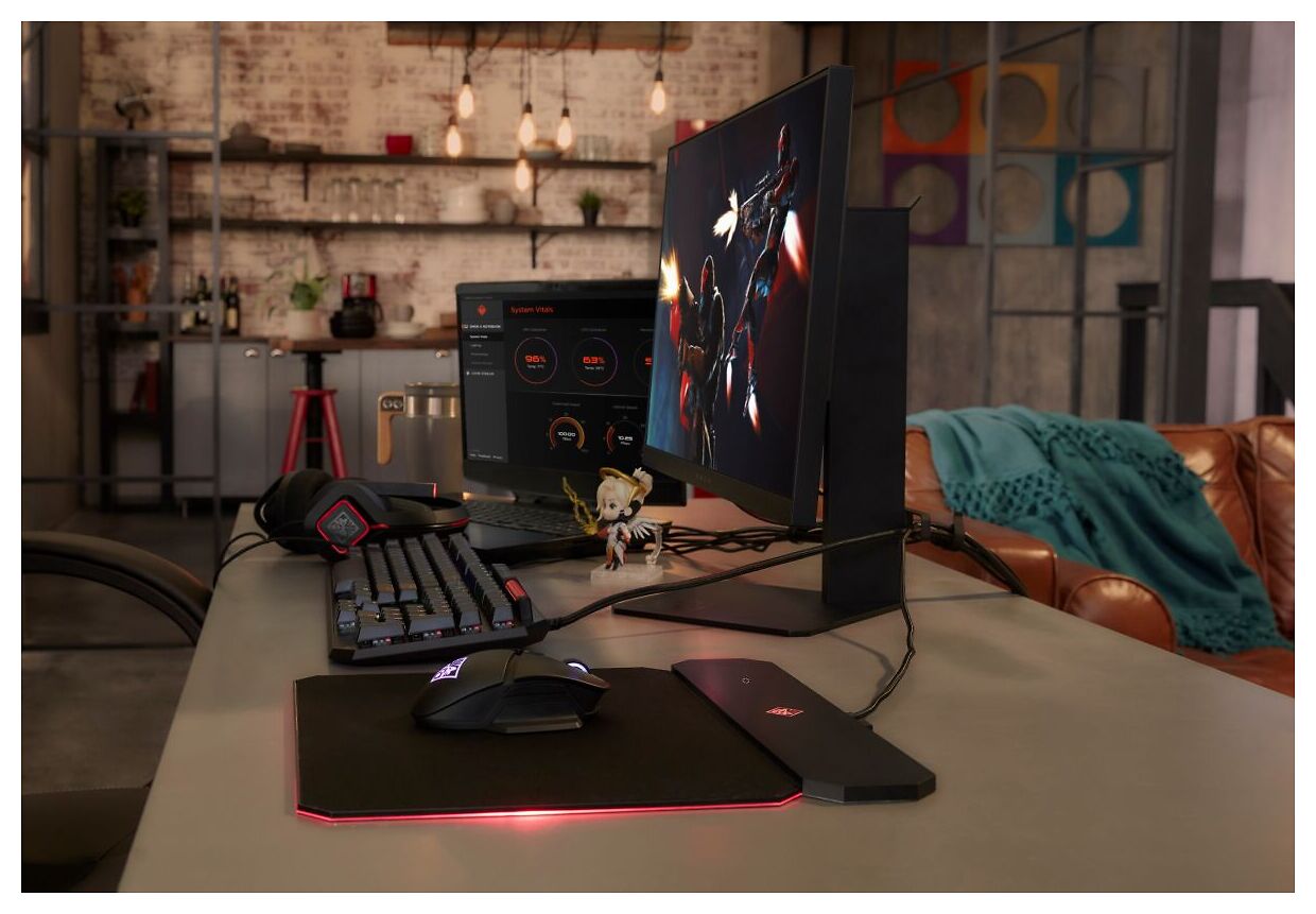

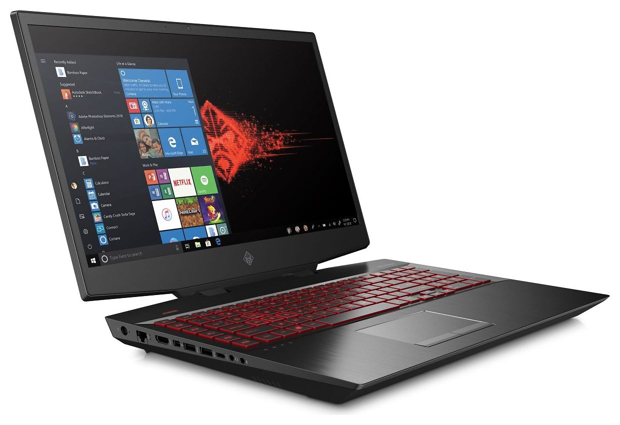

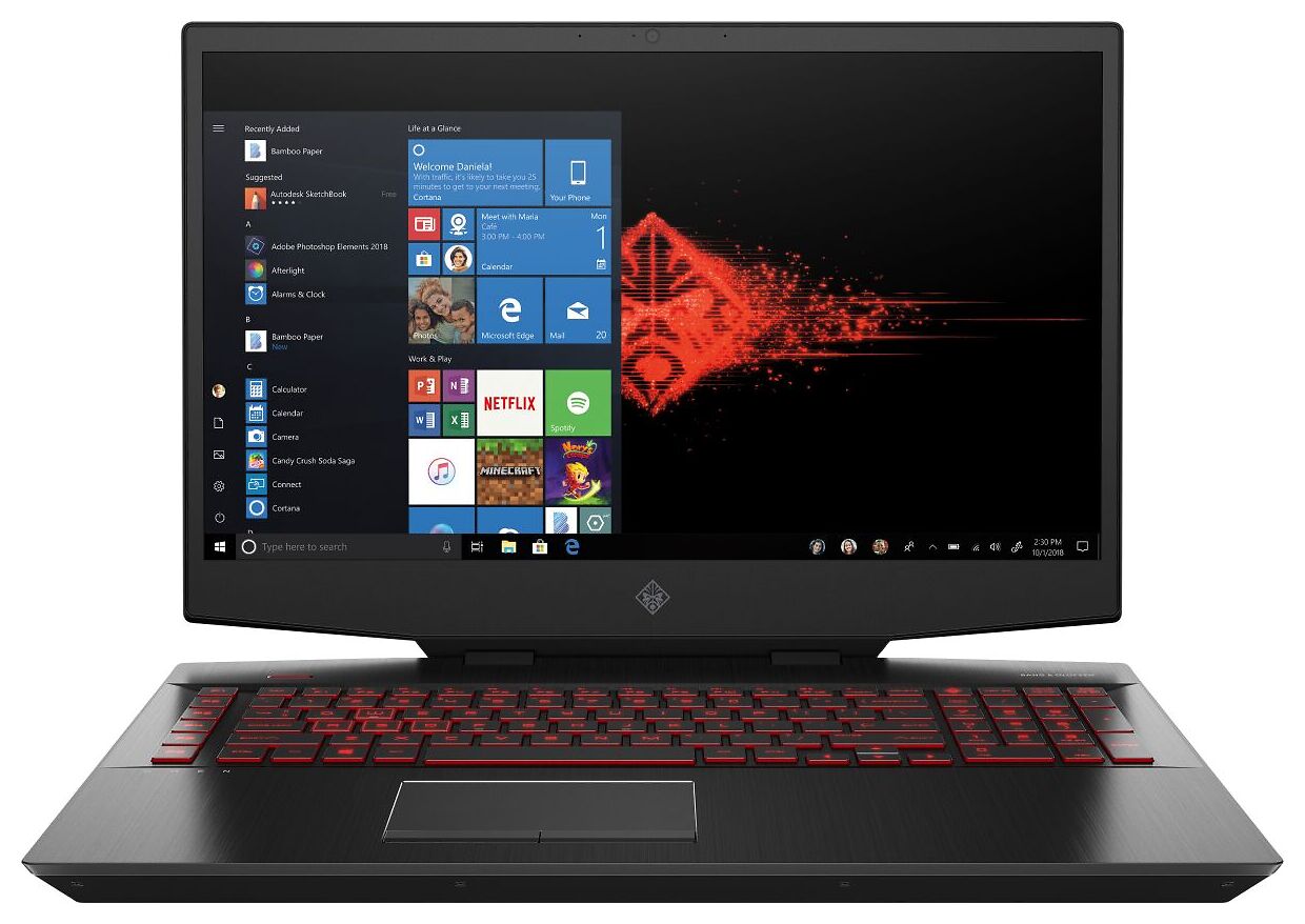

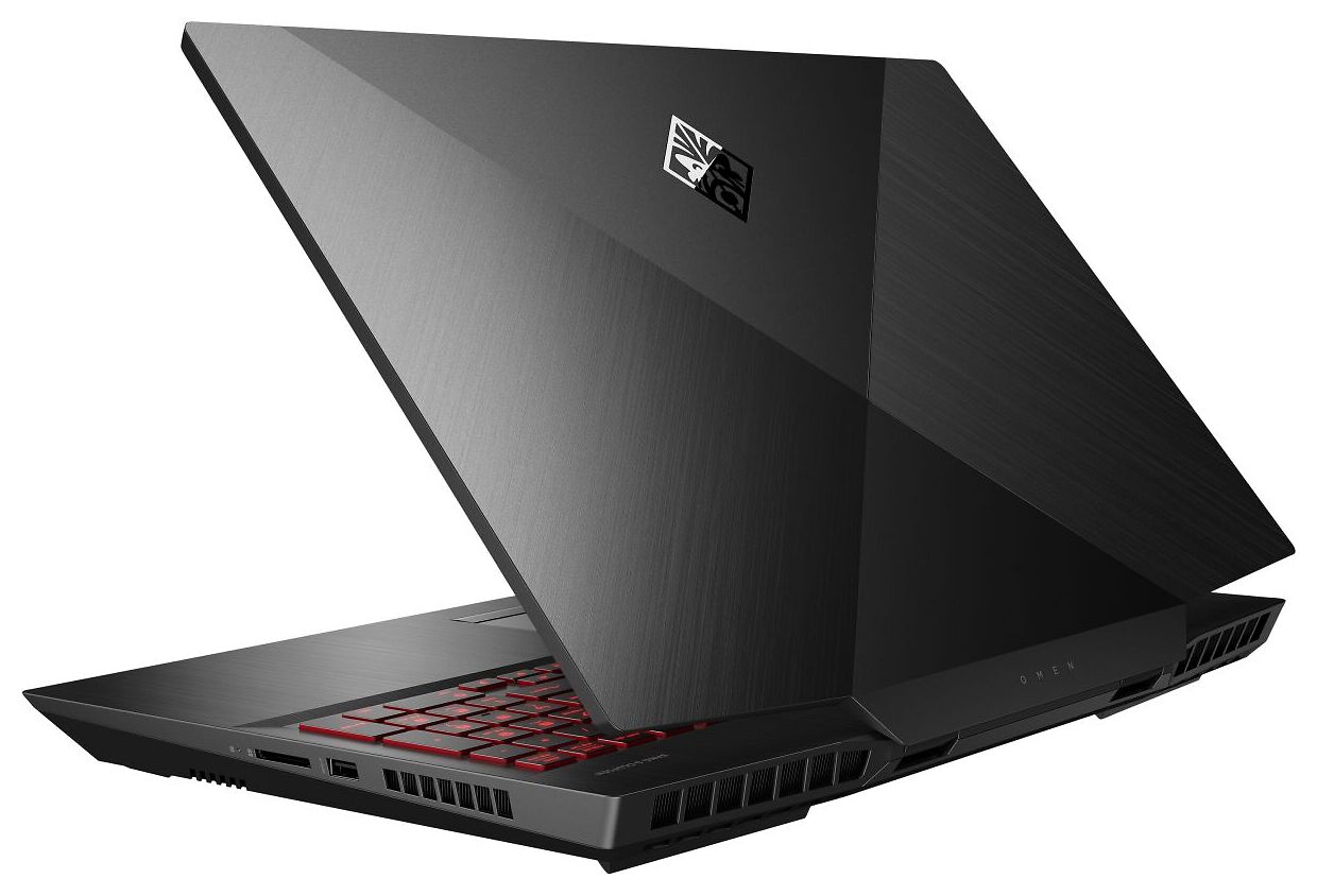

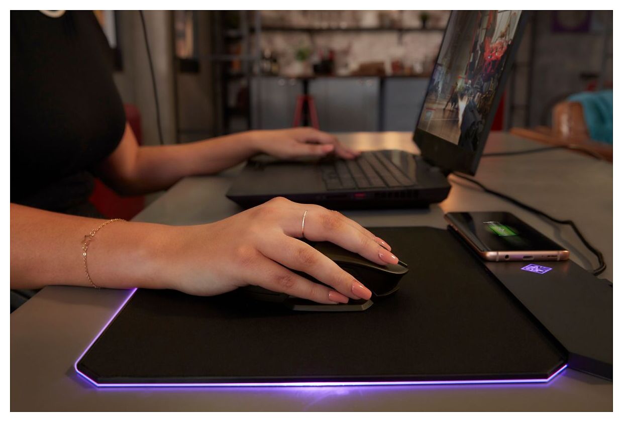

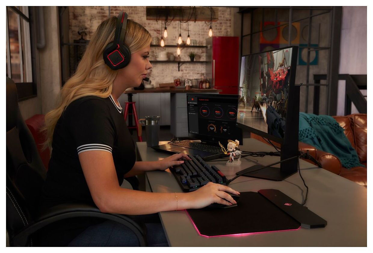

HP OMEN 17-cb0024tx Notebook 17 Specification for Upgrade or Repair
    • 115471
    HP OMEN 17-cb0024tx Notebook 17 Specification for Upgrade or Repair
    This specification for the HP OMEN 17-cb0024tx Notebook can be useful for upgrading or repairing a laptop that is not working. As a community we are working through our specifications to add valuable data like the 17-cb0024tx boardview and 17-cb0024tx schematic. Our users have donated over 1 million documents which are being added to the site. This page will be updated soon with additional information. Alternatively you can request additional help from our users directly on the relevant badcaps forum. Please note that we offer no warranties that any specification, datasheet, or download for HP OMEN 17-cb0024tx Notebook is accurate, safe, error free, or the fix you require.
    Design > Family: OMEN
    Design > Model Name: 17-cb0024tx
    Design > Part Number: 7MT52PA
    Design > Release Date: 27/06/2019
    Design > Series: 17
    Graphics > Discrete Graphics Card Model: NVIDIA GeForce RTX 2070
    Specification > Weight: 2.92kg
    Processor > Processor Generation: 9th gen Intel Core i7
    Product Code: 7MT52PA
    Brand-specific Features > HP Documentation: Yes
    Keyboard > Keyboard Backlit Colour: Red
    Networking > MIMO: Yes
    Networking > Miracast: Yes
    Software > Trial Software: McAfee LiveSafe
    Weight And Dimensions > Depth: 295mm
    Weight And Dimensions > Height: 27mm
    Weight And Dimensions > Weight: 2.92kg
    Weight And Dimensions > Width: 405mm
    HP OMEN 17-cb0024tx Notebook 17 Specification for Upgrade or Repair
    HP OMEN 15-dc1007na Notebook 15 Specification for Upgrade or Repair
    This specification for the HP OMEN 15-dc1007na Notebook can be useful for upgrading or repairing a laptop that is not working. As a community we are working through our specifications to add valuable data like the 15-dc1007na boardview and 15-dc1007na schematic. Our users have donated over 1 million documents which are being added to the site. This page will be updated soon with additional information. Alternatively you can request additional help from our users directly on the relevant badcaps forum. Please note that we offer no warranties that any specification, datasheet, or download for HP...
    09-06-2024, 08:35 AM
    HP OMEN OMEN by 17-cb0588na Notebook 17 Specification for Upgrade or Repair
    This specification for the HP OMEN OMEN by 17-cb0588na Notebook can be useful for upgrading or repairing a laptop that is not working. As a community we are working through our specifications to add valuable data like the OMEN by 17-cb0588na boardview and OMEN by 17-cb0588na schematic. Our users have donated over 1 million documents which are being added to the site. This page will be updated soon with additional information. Alternatively you can request additional help from our users directly on the relevant badcaps forum. Please note that we offer no warranties that any specification, datasheet,...
    09-06-2024, 09:09 AM
    HP OMEN X OMEN X by - 17-ap099na Notebook Specification for Upgrade or Repair
    This specification for the HP OMEN X OMEN X by - 17-ap099na Notebook can be useful for upgrading or repairing a laptop that is not working. As a community we are working through our specifications to add valuable data like the OMEN X by - 17-ap099na boardview and OMEN X by - 17-ap099na schematic. Our users have donated over 1 million documents which are being added to the site. This page will be updated soon with additional information. Alternatively you can request additional help from our users directly on the relevant badcaps forum. Please note that we offer no warranties that any specification,...
    09-06-2024, 08:58 AM
    HP OMEN 15-dc0001na Notebook 15 Specification for Upgrade or Repair
    This specification for the HP OMEN 15-dc0001na Notebook can be useful for upgrading or repairing a laptop that is not working. As a community we are working through our specifications to add valuable data like the 15-dc0001na boardview and 15-dc0001na schematic. Our users have donated over 1 million documents which are being added to the site. This page will be updated soon with additional information. Alternatively you can request additional help from our users directly on the relevant badcaps forum. Please note that we offer no warranties that any specification, datasheet, or download for HP...
    09-06-2024, 06:51 AM
    HP OMEN 15-dc0029na Notebook 15 Specification for Upgrade or Repair
    This specification for the HP OMEN 15-dc0029na Notebook can be useful for upgrading or repairing a laptop that is not working. As a community we are working through our specifications to add valuable data like the 15-dc0029na boardview and 15-dc0029na schematic. Our users have donated over 1 million documents which are being added to the site. This page will be updated soon with additional information. Alternatively you can request additional help from our users directly on the relevant badcaps forum. Please note that we offer no warranties that any specification, datasheet, or download for HP...
    09-06-2024, 06:58 AM
