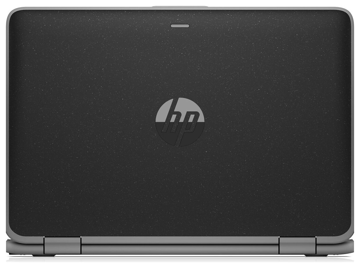

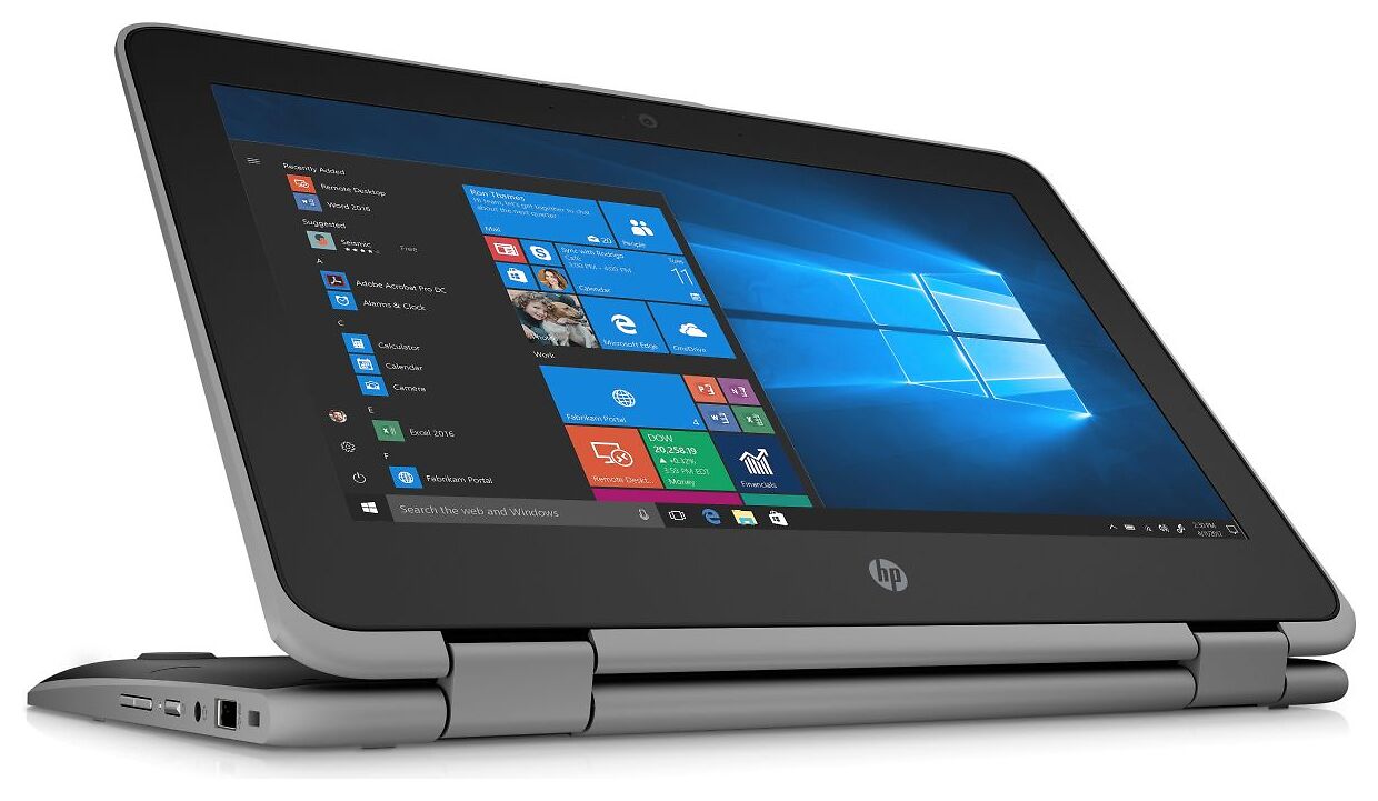

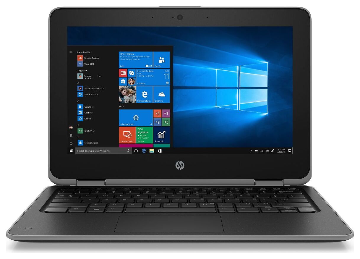

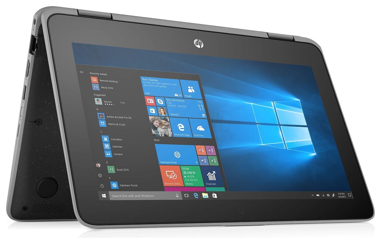

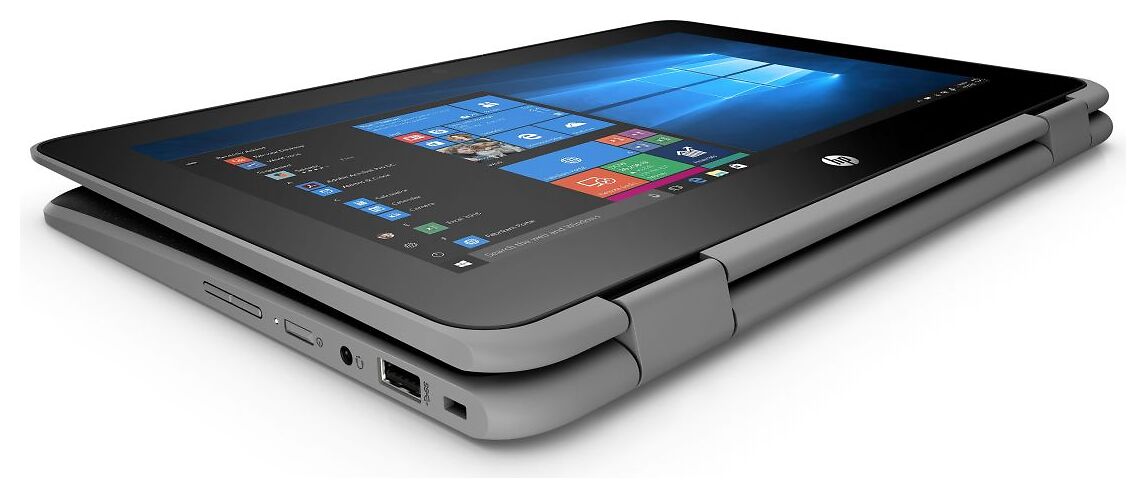

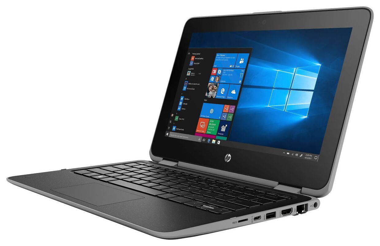

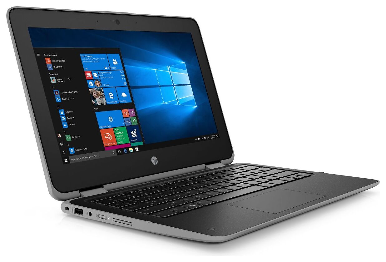

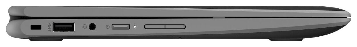

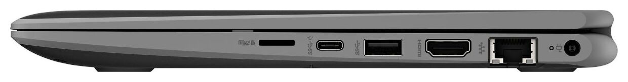

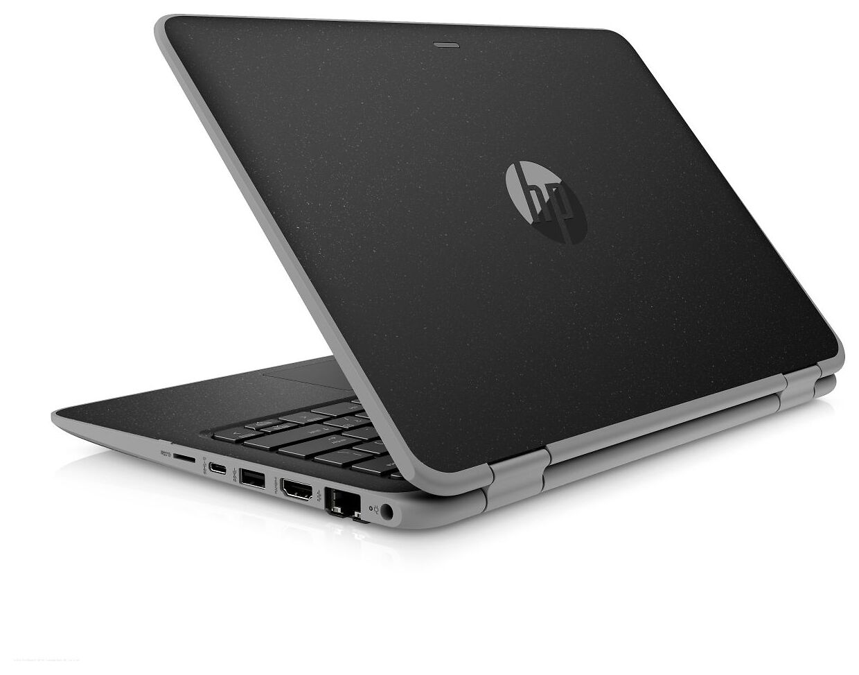

HP ProBook x360 11 G3 EE Hybrid (2-in-1) Specification for Upgrade or Repair
    HP ProBook x360 11 G3 EE Hybrid (2-in-1) Specification for Upgrade or Repair
    This specification for the HP ProBook x360 11 G3 EE Hybrid (2-in-1) can be useful for upgrading or repairing a laptop that is not working. As a community we are working through our specifications to add valuable data like the 11 G3 EE boardview and 11 G3 EE schematic. Our users have donated over 1 million documents which are being added to the site. This page will be updated soon with additional information. Alternatively you can request additional help from our users directly on the relevant badcaps forum. Please note that we offer no warranties that any specification, datasheet, or download for HP ProBook x360 11 G3 EE Hybrid (2-in-1) is accurate, safe, error free, or the fix you require.
    Design > Family: ProBook x360
    Design > Model Name: 11 G3 EE
    Design > Part Number: 7QR74PT
    Design > Release Date: 31/05/2019
    Display > HD Type: HD
    Specification > Battery: 48 Wh
    Specification > Processor: N4000 1.1GHz
    Specification > Weight: 1.44kg
    Memory > Internal Memory: 4GB
    Processor > Processor Family: Intel Celeron N
    Product Code: 7QR74PT
    Camera > Rear Camera: Yes
    Camera > Rear Camera Resolution (numeric): 5MP
    Ports & Interfaces > HDMI Version: 2.0a
    Storage > Storage Media: eMMC
    Weight And Dimensions > Depth: 205.9mm
    Weight And Dimensions > Weight: 1.44kg
    Weight And Dimensions > Width: 300mm
    HP ProBook x360 11 G3 EE Hybrid (2-in-1) Specification for Upgrade or Repair
    HP ProBook x360 ProBook x360 440 G1 Notebook-PC Hybrid (2-in-1) Specification for Upgrade or Repair
    This specification for the HP ProBook x360 ProBook x360 440 G1 Notebook-PC Hybrid (2-in-1) can be useful for upgrading or repairing a laptop that is not working. As a community we are working through our specifications to add valuable data like the ProBook x360 440 G1 Notebook-PC boardview and ProBook x360 440 G1 Notebook-PC schematic. Our users have donated over 1 million documents which are being added to the site. This page will be updated soon with additional information. Alternatively you can request additional help from our users directly on the relevant badcaps forum. Please note that we...
    09-06-2024, 07:00 AM
    HP ProBook x360 Pro x360 Fortis 11 inch G9 Notebook PC Hybrid (2-in-1) Specification for Upgrade or Repair
    This specification for the HP ProBook x360 Pro x360 Fortis 11 inch G9 Notebook PC Hybrid (2-in-1) can be useful for upgrading or repairing a laptop that is not working. As a community we are working through our specifications to add valuable data like the Pro x360 Fortis 11 inch G9 Notebook PC boardview and Pro x360 Fortis 11 inch G9 Notebook PC schematic. Our users have donated over 1 million documents which are being added to the site. This page will be updated soon with additional information. Alternatively you can request additional help from our users directly on the relevant badcaps forum....
    09-07-2024, 05:50 AM
    HP ProBook x360 Pro x360 Fortis 11 inch G9 Notebook PC Hybrid (2-in-1) Specification for Upgrade or Repair
    This specification for the HP ProBook x360 Pro x360 Fortis 11 inch G9 Notebook PC Hybrid (2-in-1) can be useful for upgrading or repairing a laptop that is not working. As a community we are working through our specifications to add valuable data like the Pro x360 Fortis 11 inch G9 Notebook PC boardview and Pro x360 Fortis 11 inch G9 Notebook PC schematic. Our users have donated over 1 million documents which are being added to the site. This page will be updated soon with additional information. Alternatively you can request additional help from our users directly on the relevant badcaps forum....
    09-07-2024, 05:50 AM
    HP ProBook x360 Pro x360 Fortis 11 inch G9 Notebook PC Hybrid (2-in-1) Specification for Upgrade or Repair
    This specification for the HP ProBook x360 Pro x360 Fortis 11 inch G9 Notebook PC Hybrid (2-in-1) can be useful for upgrading or repairing a laptop that is not working. As a community we are working through our specifications to add valuable data like the Pro x360 Fortis 11 inch G9 Notebook PC boardview and Pro x360 Fortis 11 inch G9 Notebook PC schematic. Our users have donated over 1 million documents which are being added to the site. This page will be updated soon with additional information. Alternatively you can request additional help from our users directly on the relevant badcaps forum....
    09-07-2024, 05:50 AM
    HP ProBook x360 435 G7 Hybrid (2-in-1) Specification for Upgrade or Repair
    This specification for the HP ProBook x360 435 G7 Hybrid (2-in-1) can be useful for upgrading or repairing a laptop that is not working. As a community we are working through our specifications to add valuable data like the 435 G7 boardview and 435 G7 schematic. Our users have donated over 1 million documents which are being added to the site. This page will be updated soon with additional information. Alternatively you can request additional help from our users directly on the relevant badcaps forum. Please note that we offer no warranties that any specification, datasheet, or download for HP...
    09-06-2024, 08:10 PM
