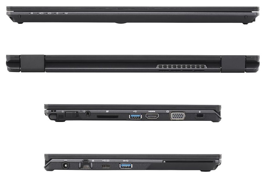

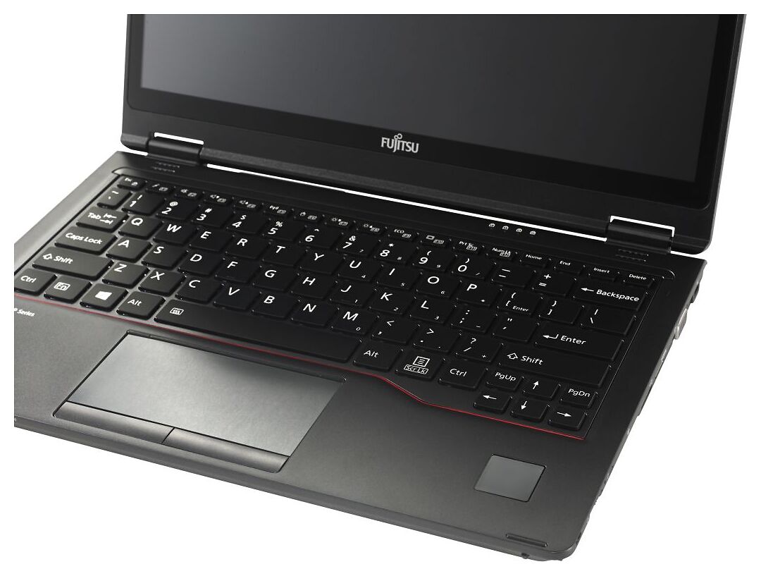

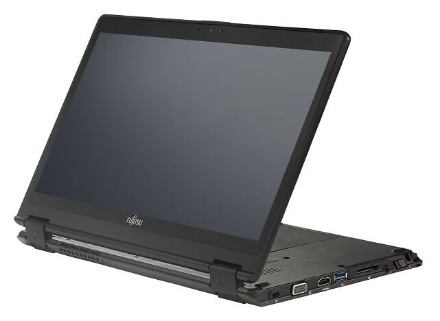

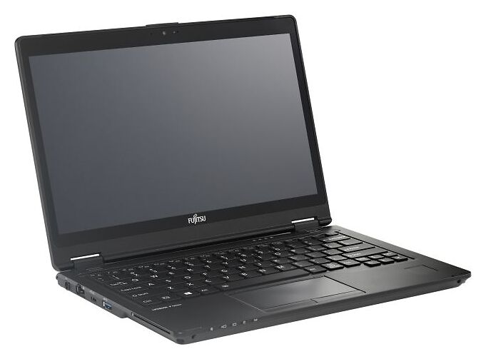

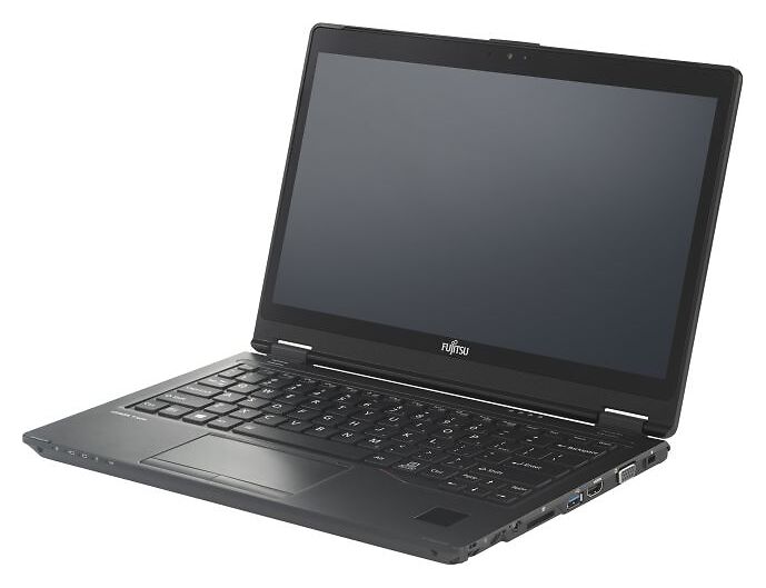

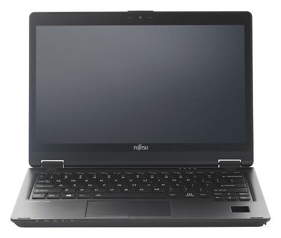

Fujitsu LIFEBOOK U729X Hybrid (2-in-1) U Specification for Upgrade or Repair
    Fujitsu LIFEBOOK U729X Hybrid (2-in-1) U Specification for Upgrade or Repair
    This specification for the Fujitsu LIFEBOOK U729X Hybrid (2-in-1) can be useful for upgrading or repairing a laptop that is not working. As a community we are working through our specifications to add valuable data like the U729X boardview and U729X schematic. Our users have donated over 1 million documents which are being added to the site. This page will be updated soon with additional information. Alternatively you can request additional help from our users directly on the relevant badcaps forum. Please note that we offer no warranties that any specification, datasheet, or download for Fujitsu LIFEBOOK U729X Hybrid (2-in-1) is accurate, safe, error free, or the fix you require.
    Design > Brand: Fujitsu
    Design > Family: LIFEBOOK
    Design > Model Name: U729X
    Design > Part Number: XBUY-U729X-002
    Design > Release Date: 19/05/2019
    Design > Series: U
    Display > Display Diagonal: 12.5 inch
    Display > HD Type: HD
    Specification > Battery: 45 Wh
    Specification > Display Diagonal: 12.5 inch
    Specification > Weight: 1.2kg
    Product Code: XBUY-U729X-002
    Battery > Battery Capacity (Watt Hours): 45Wh
    Weight And Dimensions > Depth: 209mm
    Weight And Dimensions > Height: 18.8mm
    Weight And Dimensions > Width: 299mm
    Fujitsu LIFEBOOK U729X Hybrid (2-in-1) U Specification for Upgrade or Repair
    Fujitsu LIFEBOOK U729X Hybrid (2-in-1) U Specification for Upgrade or Repair
    This specification for the Fujitsu LIFEBOOK U729X Hybrid (2-in-1) can be useful for upgrading or repairing a laptop that is not working. As a community we are working through our specifications to add valuable data like the U729X boardview and U729X schematic. Our users have donated over 1 million documents which are being added to the site. This page will be updated soon with additional information. Alternatively you can request additional help from our users directly on the relevant badcaps forum. Please note that we offer no warranties that any specification, datasheet, or download for Fujitsu...
    09-06-2024, 09:06 AM
    Fujitsu LIFEBOOK U729X Hybrid (2-in-1) U Specification for Upgrade or Repair
    This specification for the Fujitsu LIFEBOOK U729X Hybrid (2-in-1) can be useful for upgrading or repairing a laptop that is not working. As a community we are working through our specifications to add valuable data like the U729X boardview and U729X schematic. Our users have donated over 1 million documents which are being added to the site. This page will be updated soon with additional information. Alternatively you can request additional help from our users directly on the relevant badcaps forum. Please note that we offer no warranties that any specification, datasheet, or download for Fujitsu...
    09-06-2024, 09:06 AM
    Fujitsu LIFEBOOK U729X Hybrid (2-in-1) U Specification for Upgrade or Repair
    This specification for the Fujitsu LIFEBOOK U729X Hybrid (2-in-1) can be useful for upgrading or repairing a laptop that is not working. As a community we are working through our specifications to add valuable data like the U729X boardview and U729X schematic. Our users have donated over 1 million documents which are being added to the site. This page will be updated soon with additional information. Alternatively you can request additional help from our users directly on the relevant badcaps forum. Please note that we offer no warranties that any specification, datasheet, or download for Fujitsu...
    09-06-2024, 09:00 AM
    Fujitsu LIFEBOOK U729X Hybrid (2-in-1) U Specification for Upgrade or Repair
    This specification for the Fujitsu LIFEBOOK U729X Hybrid (2-in-1) can be useful for upgrading or repairing a laptop that is not working. As a community we are working through our specifications to add valuable data like the U729X boardview and U729X schematic. Our users have donated over 1 million documents which are being added to the site. This page will be updated soon with additional information. Alternatively you can request additional help from our users directly on the relevant badcaps forum. Please note that we offer no warranties that any specification, datasheet, or download for Fujitsu...
    09-06-2024, 09:00 AM
    Fujitsu LIFEBOOK U729X Hybrid (2-in-1) U Specification for Upgrade or Repair
    This specification for the Fujitsu LIFEBOOK U729X Hybrid (2-in-1) can be useful for upgrading or repairing a laptop that is not working. As a community we are working through our specifications to add valuable data like the U729X boardview and U729X schematic. Our users have donated over 1 million documents which are being added to the site. This page will be updated soon with additional information. Alternatively you can request additional help from our users directly on the relevant badcaps forum. Please note that we offer no warranties that any specification, datasheet, or download for Fujitsu...
    09-06-2024, 09:06 AM
