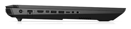

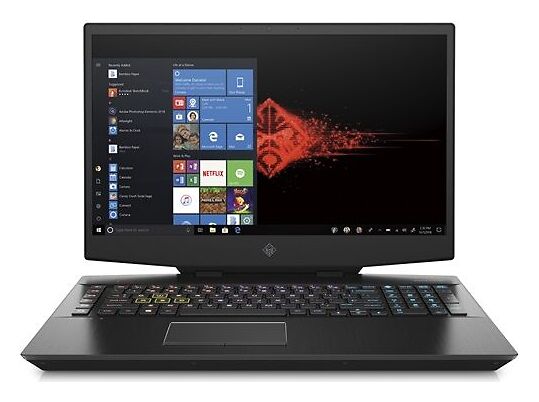

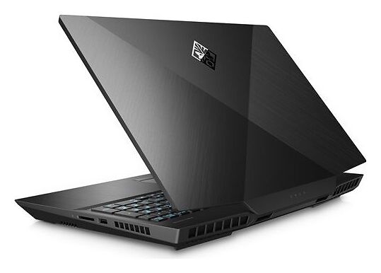

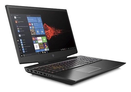

HP OMEN 17-cb0700nd Notebook 17 Specification for Upgrade or Repair
    HP OMEN 17-cb0700nd Notebook 17 Specification for Upgrade or Repair
    This specification for the HP OMEN 17-cb0700nd Notebook can be useful for upgrading or repairing a laptop that is not working. As a community we are working through our specifications to add valuable data like the 17-cb0700nd boardview and 17-cb0700nd schematic. Our users have donated over 1 million documents which are being added to the site. This page will be updated soon with additional information. Alternatively you can request additional help from our users directly on the relevant badcaps forum. Please note that we offer no warranties that any specification, datasheet, or download for HP OMEN 17-cb0700nd Notebook is accurate, safe, error free, or the fix you require.
    Design > Family: OMEN
    Design > Model Name: 17-cb0700nd
    Design > Part Number: 7GN08EA#ABH
    Design > Release Date: 10/05/2019
    Design > Series: 17
    Graphics > Discrete Graphics Adapter Model: NVIDIA GeForce RTX 2070
    Specification > Weight: 3.31kg
    Product Code: 7GN08EA#ABH
    Storage > HDD Interface: SATA
    Storage > HDD Speed: 7200RPM
    Weight And Dimensions > Depth: 295mm
    Weight And Dimensions > Height: 27mm
    Weight And Dimensions > Weight: 3.31kg
    Weight And Dimensions > Width: 405mm
    HP OMEN 17-cb0700nd Notebook 17 Specification for Upgrade or Repair
    HP OMEN 15-dc1007na Notebook 15 Specification for Upgrade or Repair
    This specification for the HP OMEN 15-dc1007na Notebook can be useful for upgrading or repairing a laptop that is not working. As a community we are working through our specifications to add valuable data like the 15-dc1007na boardview and 15-dc1007na schematic. Our users have donated over 1 million documents which are being added to the site. This page will be updated soon with additional information. Alternatively you can request additional help from our users directly on the relevant badcaps forum. Please note that we offer no warranties that any specification, datasheet, or download for HP...
    09-06-2024, 08:35 AM
    HP OMEN OMEN by 17-cb0588na Notebook 17 Specification for Upgrade or Repair
    This specification for the HP OMEN OMEN by 17-cb0588na Notebook can be useful for upgrading or repairing a laptop that is not working. As a community we are working through our specifications to add valuable data like the OMEN by 17-cb0588na boardview and OMEN by 17-cb0588na schematic. Our users have donated over 1 million documents which are being added to the site. This page will be updated soon with additional information. Alternatively you can request additional help from our users directly on the relevant badcaps forum. Please note that we offer no warranties that any specification, datasheet,...
    09-06-2024, 09:09 AM
    HP OMEN X OMEN X by - 17-ap099na Notebook Specification for Upgrade or Repair
    This specification for the HP OMEN X OMEN X by - 17-ap099na Notebook can be useful for upgrading or repairing a laptop that is not working. As a community we are working through our specifications to add valuable data like the OMEN X by - 17-ap099na boardview and OMEN X by - 17-ap099na schematic. Our users have donated over 1 million documents which are being added to the site. This page will be updated soon with additional information. Alternatively you can request additional help from our users directly on the relevant badcaps forum. Please note that we offer no warranties that any specification,...
    09-06-2024, 08:58 AM
    HP OMEN 15-dc0001na Notebook 15 Specification for Upgrade or Repair
    This specification for the HP OMEN 15-dc0001na Notebook can be useful for upgrading or repairing a laptop that is not working. As a community we are working through our specifications to add valuable data like the 15-dc0001na boardview and 15-dc0001na schematic. Our users have donated over 1 million documents which are being added to the site. This page will be updated soon with additional information. Alternatively you can request additional help from our users directly on the relevant badcaps forum. Please note that we offer no warranties that any specification, datasheet, or download for HP...
    09-06-2024, 06:51 AM
    HP OMEN 15-dc0029na Notebook 15 Specification for Upgrade or Repair
    This specification for the HP OMEN 15-dc0029na Notebook can be useful for upgrading or repairing a laptop that is not working. As a community we are working through our specifications to add valuable data like the 15-dc0029na boardview and 15-dc0029na schematic. Our users have donated over 1 million documents which are being added to the site. This page will be updated soon with additional information. Alternatively you can request additional help from our users directly on the relevant badcaps forum. Please note that we offer no warranties that any specification, datasheet, or download for HP...
    09-06-2024, 06:58 AM
