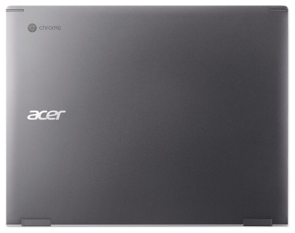

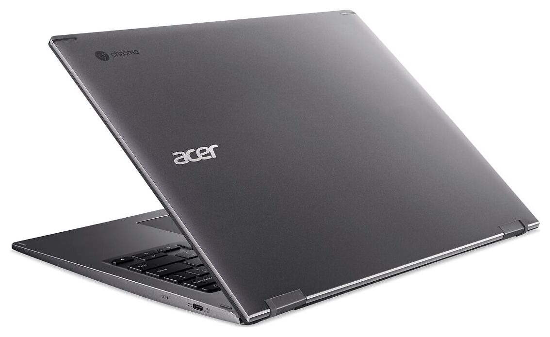

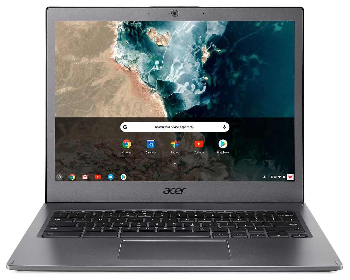

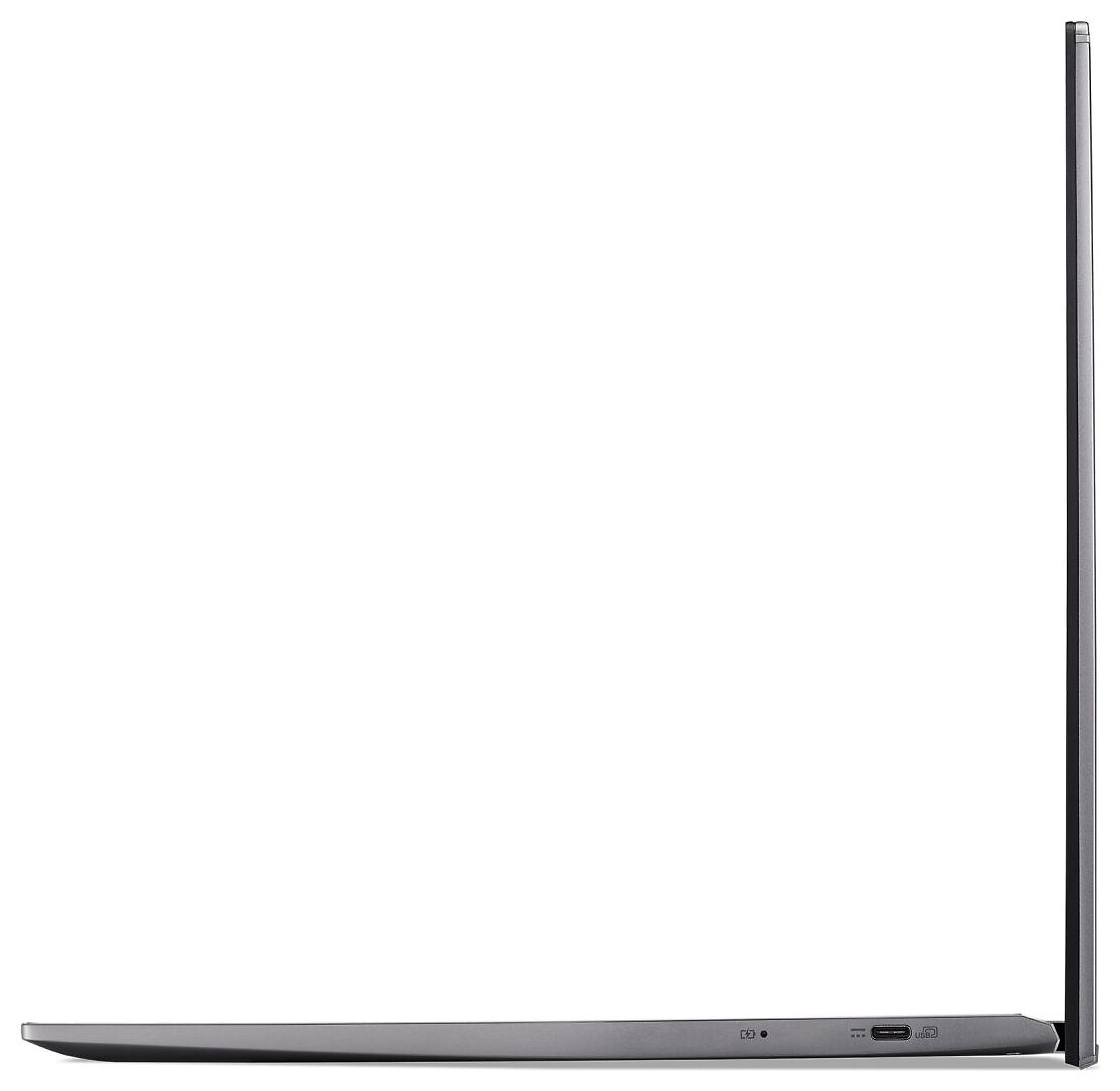

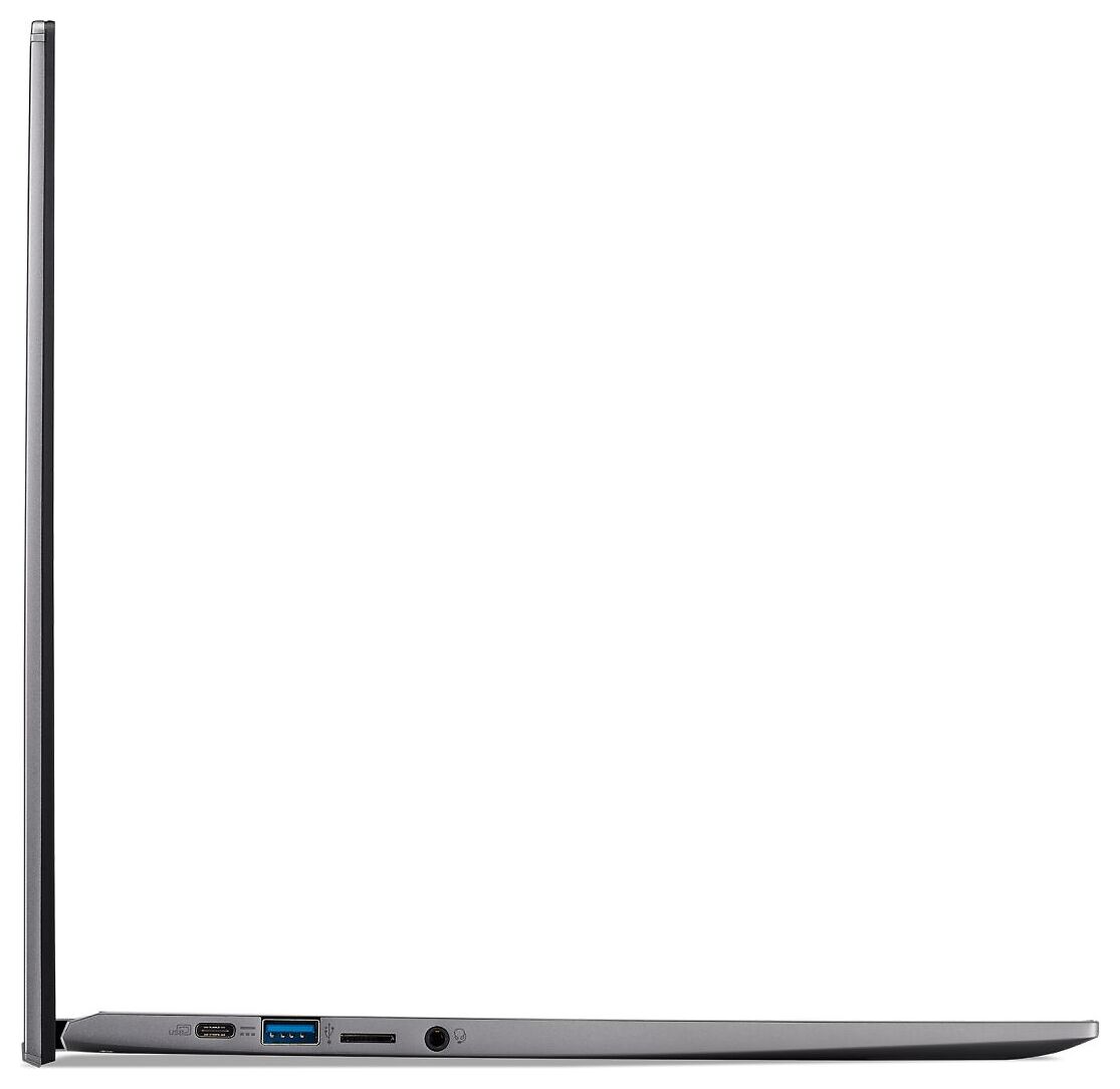

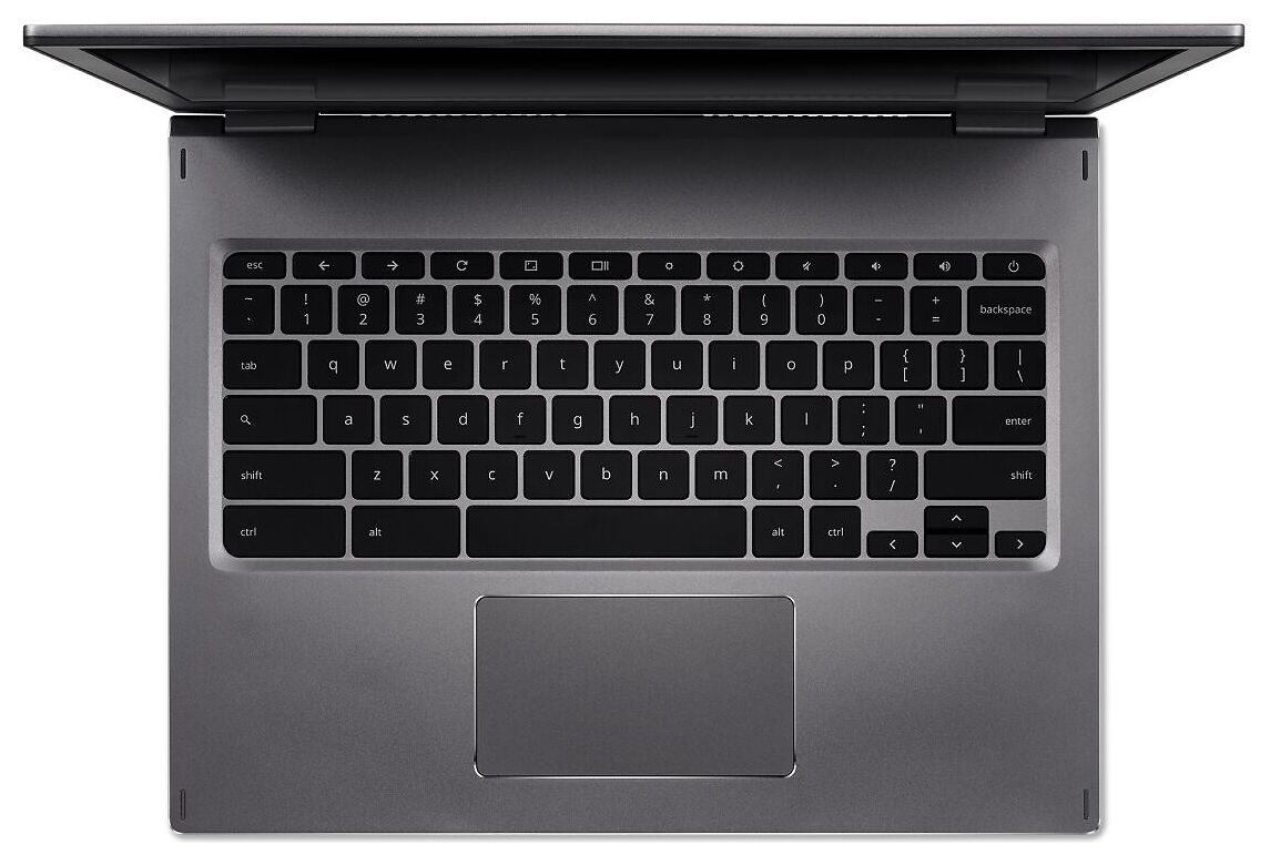

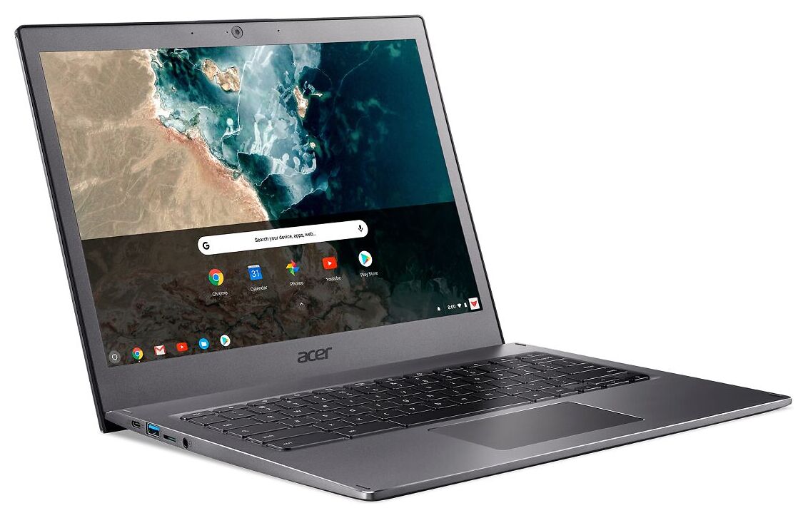

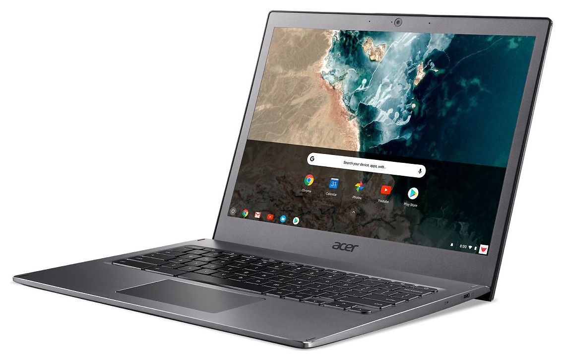

Acer Chromebook CB713-1W-55WG Chromebook 13 Specification for Upgrade or Repair
    Acer Chromebook CB713-1W-55WG Chromebook 13 Specification for Upgrade or Repair
    This specification for the Acer Chromebook CB713-1W-55WG Chromebook can be useful for upgrading or repairing a laptop that is not working. As a community we are working through our specifications to add valuable data like the CB713-1W-55WG boardview and CB713-1W-55WG schematic. Our users have donated over 1 million documents which are being added to the site. This page will be updated soon with additional information. Alternatively you can request additional help from our users directly on the relevant badcaps forum. Please note that we offer no warranties that any specification, datasheet, or download for Acer Chromebook CB713-1W-55WG Chromebook is accurate, safe, error free, or the fix you require.
    Design > Brand: Acer
    Design > Family: Chromebook
    Design > Model Name: CB713-1W-55WG
    Design > Part Number: NX.H1WEH.002
    Design > Product Colour: Grey
    Design > Release Date: 06/05/2019
    Design > Series: 13
    Display > HD Type: Quad HD
    Specification > Battery: 10 hrs 4670mAh
    Specification > Weight: 1.4kg
    Product Code: NX.H1WEH.002
    Battery > Battery Capacity: 4670mAh
    Networking > WLAN Controller Model: Intel Dual Band Wireless-AC 7265
    Storage > Storage Media: eMMC
    Weight And Dimensions > Depth: 245.8mm
    Weight And Dimensions > Height: 17mm
    Weight And Dimensions > Width: 309.5mm
    Acer Chromebook CB713-1W-55WG Chromebook 13 Specification for Upgrade or Repair
    Acer Chromebook C771T-56G3 Chromebook 11 Specification for Upgrade or Repair
    This specification for the Acer Chromebook C771T-56G3 Chromebook can be useful for upgrading or repairing a laptop that is not working. As a community we are working through our specifications to add valuable data like the C771T-56G3 boardview and C771T-56G3 schematic. Our users have donated over 1 million documents which are being added to the site. This page will be updated soon with additional information. Alternatively you can request additional help from our users directly on the relevant badcaps forum. Please note that we offer no warranties that any specification, datasheet, or download...
    09-06-2024, 06:06 AM
    Acer Chromebook CP713-1WN-866Q Chromebook Spin 13 Specification for Upgrade or Repair
    This specification for the Acer Chromebook CP713-1WN-866Q Chromebook can be useful for upgrading or repairing a laptop that is not working. As a community we are working through our specifications to add valuable data like the CP713-1WN-866Q boardview and CP713-1WN-866Q schematic. Our users have donated over 1 million documents which are being added to the site. This page will be updated soon with additional information. Alternatively you can request additional help from our users directly on the relevant badcaps forum. Please note that we offer no warranties that any specification, datasheet,...
    09-06-2024, 07:14 AM
    Acer Chromebook CB713-1W-5549 Chromebook 13 Specification for Upgrade or Repair
    This specification for the Acer Chromebook CB713-1W-5549 Chromebook can be useful for upgrading or repairing a laptop that is not working. As a community we are working through our specifications to add valuable data like the CB713-1W-5549 boardview and CB713-1W-5549 schematic. Our users have donated over 1 million documents which are being added to the site. This page will be updated soon with additional information. Alternatively you can request additional help from our users directly on the relevant badcaps forum. Please note that we offer no warranties that any specification, datasheet, or...
    09-06-2024, 11:05 AM
    Acer Chromebook CB715-1WT-5591 Chromebook 715 Specification for Upgrade or Repair
    This specification for the Acer Chromebook CB715-1WT-5591 Chromebook can be useful for upgrading or repairing a laptop that is not working. As a community we are working through our specifications to add valuable data like the CB715-1WT-5591 boardview and CB715-1WT-5591 schematic. Our users have donated over 1 million documents which are being added to the site. This page will be updated soon with additional information. Alternatively you can request additional help from our users directly on the relevant badcaps forum. Please note that we offer no warranties that any specification, datasheet,...
    09-06-2024, 09:45 AM
    Acer Chromebook CP713-1WN-813G Chromebook Spin 13 Specification for Upgrade or Repair
    This specification for the Acer Chromebook CP713-1WN-813G Chromebook can be useful for upgrading or repairing a laptop that is not working. As a community we are working through our specifications to add valuable data like the CP713-1WN-813G boardview and CP713-1WN-813G schematic. Our users have donated over 1 million documents which are being added to the site. This page will be updated soon with additional information. Alternatively you can request additional help from our users directly on the relevant badcaps forum. Please note that we offer no warranties that any specification, datasheet,...
    09-06-2024, 09:32 AM
