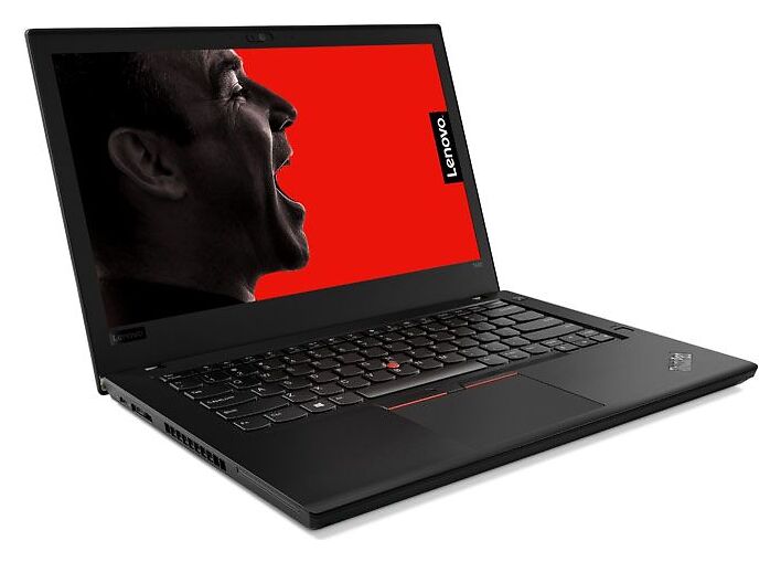

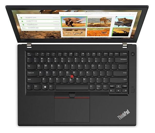

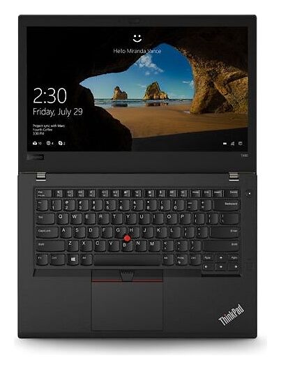

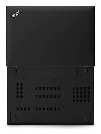

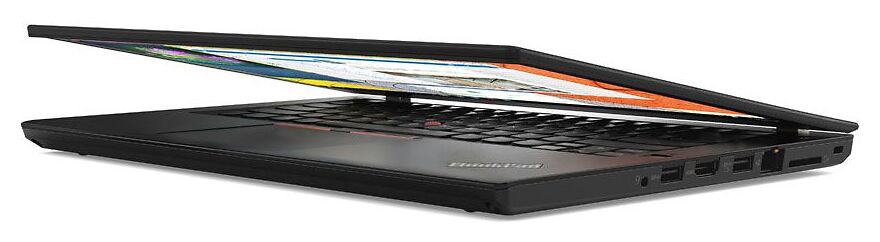

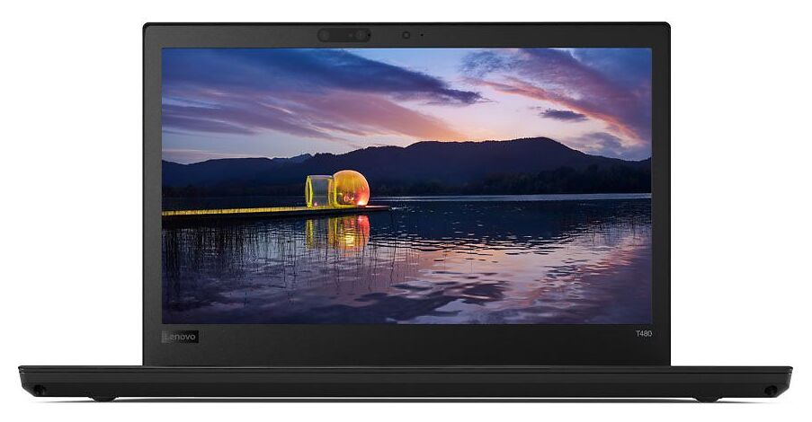

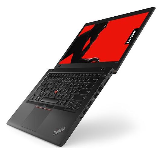

Lenovo ThinkPad T480 Notebook T Specification for Upgrade or Repair
    Lenovo ThinkPad T480 Notebook T Specification for Upgrade or Repair
    This specification for the Lenovo ThinkPad T480 Notebook can be useful for upgrading or repairing a laptop that is not working. As a community we are working through our specifications to add valuable data like the T480 boardview and T480 schematic. Our users have donated over 1 million documents which are being added to the site. This page will be updated soon with additional information. Alternatively you can request additional help from our users directly on the relevant badcaps forum. Please note that we offer no warranties that any specification, datasheet, or download for Lenovo ThinkPad T480 Notebook is accurate, safe, error free, or the fix you require.
    Design > Family: ThinkPad
    Design > Housing Material: FRP (Fiber Reinforced Plastic), Magnesium
    Design > Model Name: T480
    Design > Part Number: 20L6S6KQ02
    Design > Release Date: 20/04/2019
    Design > Series: T
    Display > 3D: No
    Specification > Processor: i7-8650U 1.9GHz
    Product Code: 20L6S6KQ02
    Weight And Dimensions > Depth: 232.5mm
    Weight And Dimensions > Width: 336.6mm
    Lenovo ThinkPad T480 Notebook T Specification for Upgrade or Repair
    Lenovo ThinkPad T480 Notebook T Specification for Upgrade or Repair
    This specification for the Lenovo ThinkPad T480 Notebook can be useful for upgrading or repairing a laptop that is not working. As a community we are working through our specifications to add valuable data like the T480 boardview and T480 schematic. Our users have donated over 1 million documents which are being added to the site. This page will be updated soon with additional information. Alternatively you can request additional help from our users directly on the relevant badcaps forum. Please note that we offer no warranties that any specification, datasheet, or download for Lenovo ThinkPad...
    09-06-2024, 08:20 AM
    Lenovo ThinkPad T480 Notebook T Specification for Upgrade or Repair
    This specification for the Lenovo ThinkPad T480 Notebook can be useful for upgrading or repairing a laptop that is not working. As a community we are working through our specifications to add valuable data like the T480 boardview and T480 schematic. Our users have donated over 1 million documents which are being added to the site. This page will be updated soon with additional information. Alternatively you can request additional help from our users directly on the relevant badcaps forum. Please note that we offer no warranties that any specification, datasheet, or download for Lenovo ThinkPad...
    09-06-2024, 07:42 AM
    Lenovo ThinkPad T480 Notebook T Specification for Upgrade or Repair
    This specification for the Lenovo ThinkPad T480 Notebook can be useful for upgrading or repairing a laptop that is not working. As a community we are working through our specifications to add valuable data like the T480 boardview and T480 schematic. Our users have donated over 1 million documents which are being added to the site. This page will be updated soon with additional information. Alternatively you can request additional help from our users directly on the relevant badcaps forum. Please note that we offer no warranties that any specification, datasheet, or download for Lenovo ThinkPad...
    09-06-2024, 06:20 AM
    Lenovo ThinkPad T480 Notebook T Specification for Upgrade or Repair
    This specification for the Lenovo ThinkPad T480 Notebook can be useful for upgrading or repairing a laptop that is not working. As a community we are working through our specifications to add valuable data like the T480 boardview and T480 schematic. Our users have donated over 1 million documents which are being added to the site. This page will be updated soon with additional information. Alternatively you can request additional help from our users directly on the relevant badcaps forum. Please note that we offer no warranties that any specification, datasheet, or download for Lenovo ThinkPad...
    09-06-2024, 06:38 AM
    Lenovo ThinkPad T480 Notebook T Specification for Upgrade or Repair
    This specification for the Lenovo ThinkPad T480 Notebook can be useful for upgrading or repairing a laptop that is not working. As a community we are working through our specifications to add valuable data like the T480 boardview and T480 schematic. Our users have donated over 1 million documents which are being added to the site. This page will be updated soon with additional information. Alternatively you can request additional help from our users directly on the relevant badcaps forum. Please note that we offer no warranties that any specification, datasheet, or download for Lenovo ThinkPad...
    09-06-2024, 06:34 AM
