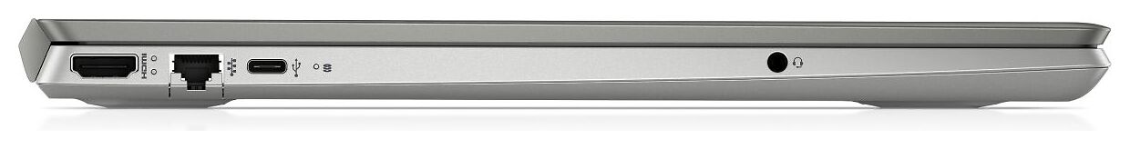

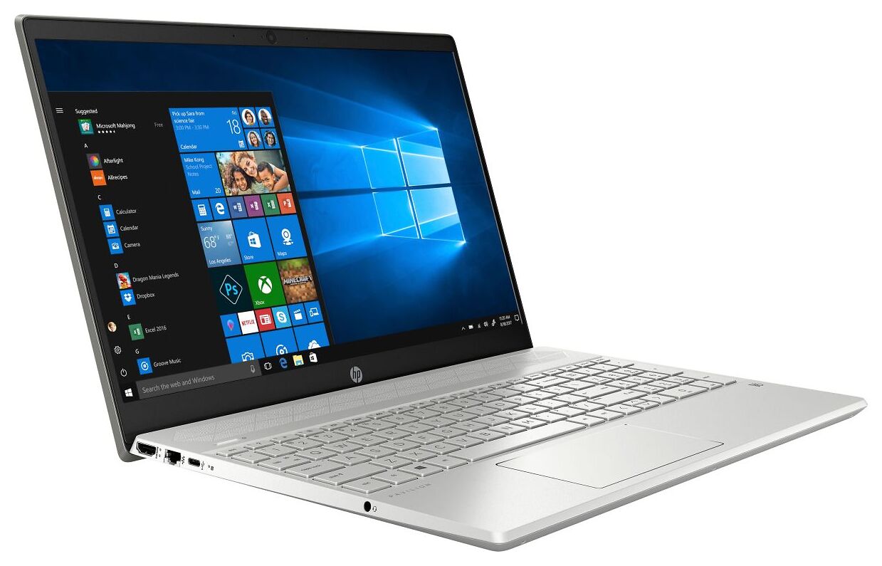

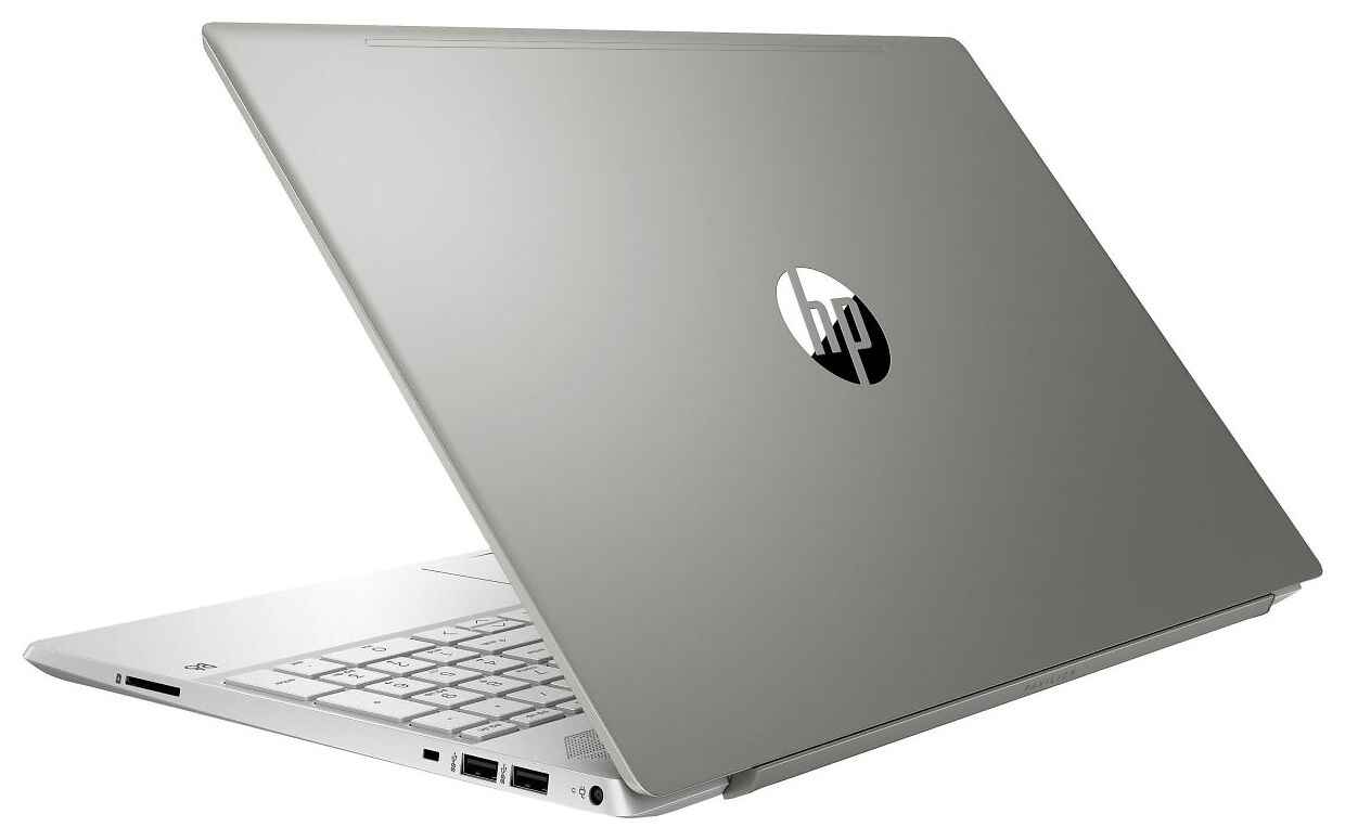

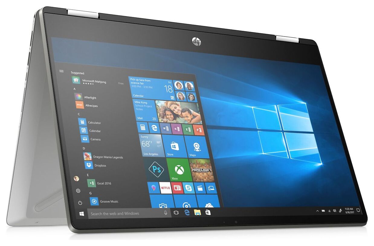

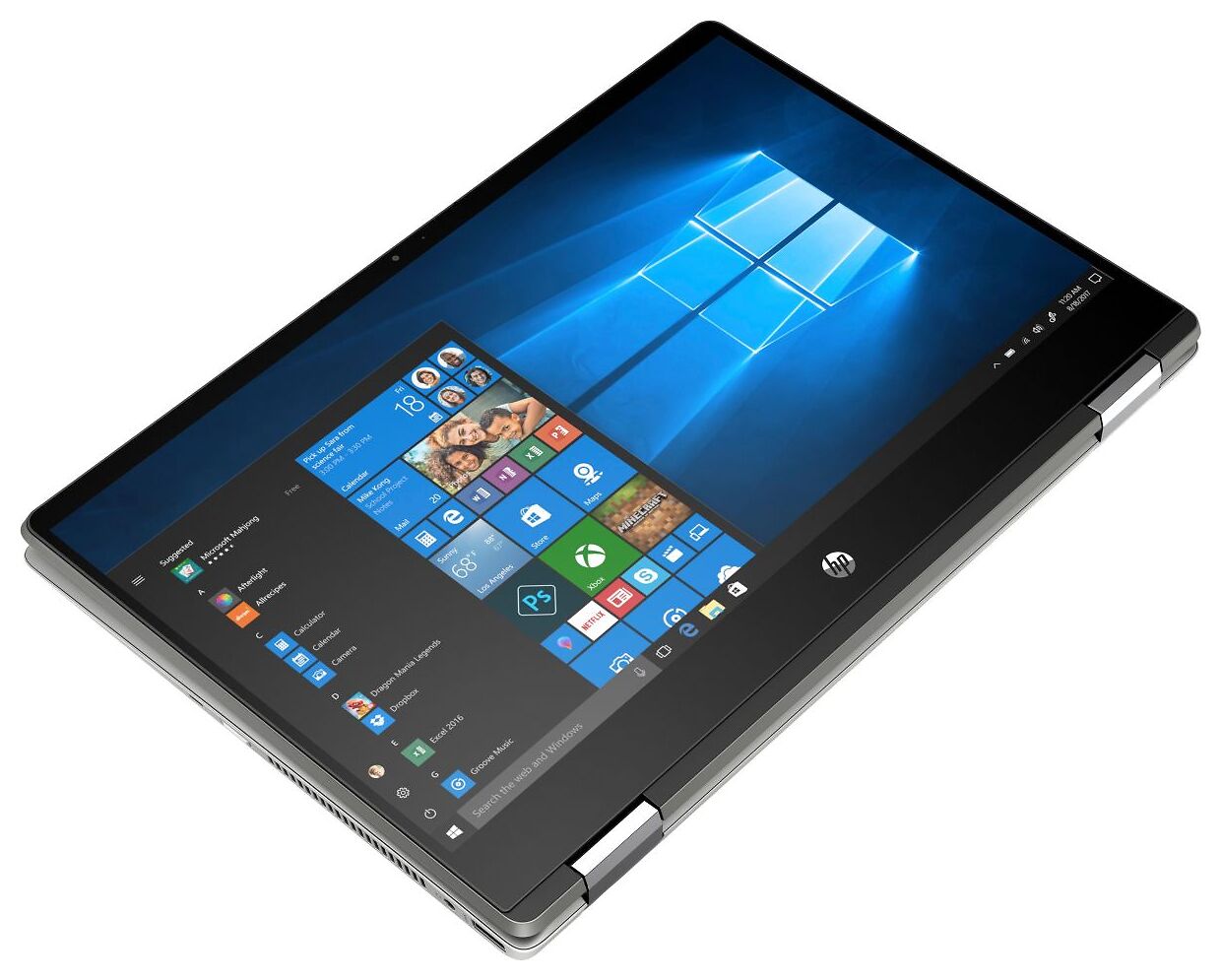

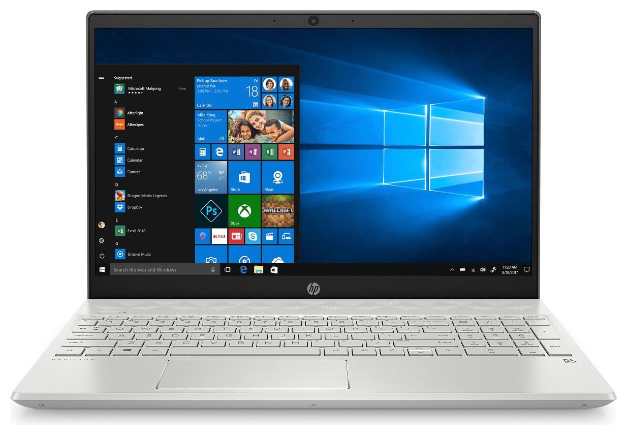

HP ProBook x360 14-dh0008nf Hybrid (2-in-1) Specification for Upgrade or Repair
    HP ProBook x360 14-dh0008nf Hybrid (2-in-1) Specification for Upgrade or Repair
    This specification for the HP ProBook x360 14-dh0008nf Hybrid (2-in-1) can be useful for upgrading or repairing a laptop that is not working. As a community we are working through our specifications to add valuable data like the 14-dh0008nf boardview and 14-dh0008nf schematic. Our users have donated over 1 million documents which are being added to the site. This page will be updated soon with additional information. Alternatively you can request additional help from our users directly on the relevant badcaps forum. Please note that we offer no warranties that any specification, datasheet, or download for HP ProBook x360 14-dh0008nf Hybrid (2-in-1) is accurate, safe, error free, or the fix you require.
    Design > Family: ProBook x360
    Design > Model Name: 14-dh0008nf
    Design > Part Number: 6LD56EA
    Design > Release Date: 20/03/2019
    Graphics > Discrete Graphics Adapter Model: NVIDIA GeForce MX130
    Specification > Battery: 41 Wh
    Specification > Weight: 2.1kg
    Product Code: 6LD56EA
    Battery > Quick Charge: Yes
    Networking > MIMO: Yes
    Networking > Miracast: Yes
    Networking > Wi-Fi Standards: 802.11b, 802.11g, 802.11n, Wi-Fi 5 (802.11ac)
    Performance > Electronic Compass: Yes
    Performance > Gyroscope: Yes
    Storage > HDD Interface: SATA
    Storage > HDD Speed: 5400RPM
    Storage > SSD Capacity: 128GB
    Weight And Dimensions > Depth: 222.9mm
    Weight And Dimensions > Height: 20.5mm
    Weight And Dimensions > Width: 324mm
    HP ProBook x360 14-dh0008nf Hybrid (2-in-1) Specification for Upgrade or Repair
    HP ProBook x360 ProBook x360 440 G1 Notebook-PC Hybrid (2-in-1) Specification for Upgrade or Repair
    This specification for the HP ProBook x360 ProBook x360 440 G1 Notebook-PC Hybrid (2-in-1) can be useful for upgrading or repairing a laptop that is not working. As a community we are working through our specifications to add valuable data like the ProBook x360 440 G1 Notebook-PC boardview and ProBook x360 440 G1 Notebook-PC schematic. Our users have donated over 1 million documents which are being added to the site. This page will be updated soon with additional information. Alternatively you can request additional help from our users directly on the relevant badcaps forum. Please note that we...
    09-06-2024, 07:00 AM
    HP ProBook x360 440 G1 Hybrid (2-in-1) Specification for Upgrade or Repair
    This specification for the HP ProBook x360 440 G1 Hybrid (2-in-1) can be useful for upgrading or repairing a laptop that is not working. As a community we are working through our specifications to add valuable data like the 440 G1 boardview and 440 G1 schematic. Our users have donated over 1 million documents which are being added to the site. This page will be updated soon with additional information. Alternatively you can request additional help from our users directly on the relevant badcaps forum. Please note that we offer no warranties that any specification, datasheet, or download for HP...
    09-06-2024, 07:11 AM
    HP ProBook x360 440 G1 Hybrid (2-in-1) Specification for Upgrade or Repair
    This specification for the HP ProBook x360 440 G1 Hybrid (2-in-1) can be useful for upgrading or repairing a laptop that is not working. As a community we are working through our specifications to add valuable data like the 440 G1 boardview and 440 G1 schematic. Our users have donated over 1 million documents which are being added to the site. This page will be updated soon with additional information. Alternatively you can request additional help from our users directly on the relevant badcaps forum. Please note that we offer no warranties that any specification, datasheet, or download for HP...
    09-06-2024, 06:58 AM
    HP ProBook x360 440 G1 Hybrid (2-in-1) Specification for Upgrade or Repair
    This specification for the HP ProBook x360 440 G1 Hybrid (2-in-1) can be useful for upgrading or repairing a laptop that is not working. As a community we are working through our specifications to add valuable data like the 440 G1 boardview and 440 G1 schematic. Our users have donated over 1 million documents which are being added to the site. This page will be updated soon with additional information. Alternatively you can request additional help from our users directly on the relevant badcaps forum. Please note that we offer no warranties that any specification, datasheet, or download for HP...
    09-06-2024, 06:58 AM
    HP ProBook x360 440 G1 Hybrid (2-in-1) Specification for Upgrade or Repair
    This specification for the HP ProBook x360 440 G1 Hybrid (2-in-1) can be useful for upgrading or repairing a laptop that is not working. As a community we are working through our specifications to add valuable data like the 440 G1 boardview and 440 G1 schematic. Our users have donated over 1 million documents which are being added to the site. This page will be updated soon with additional information. Alternatively you can request additional help from our users directly on the relevant badcaps forum. Please note that we offer no warranties that any specification, datasheet, or download for HP...
    09-06-2024, 06:58 AM
