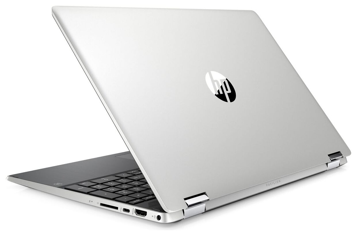

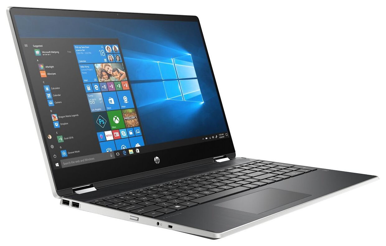

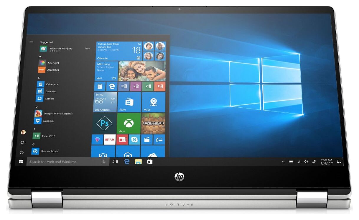

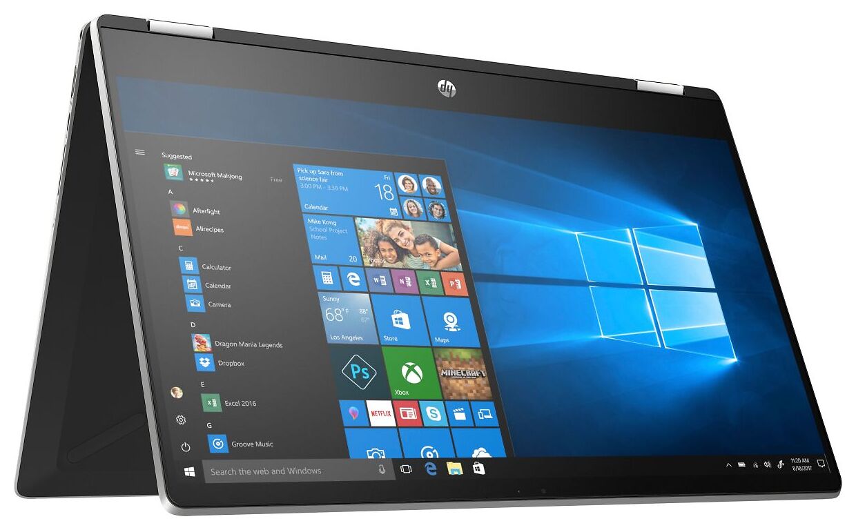

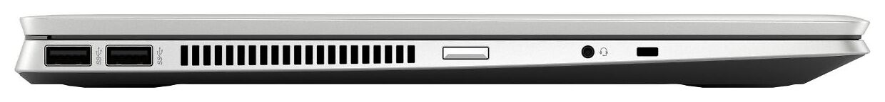

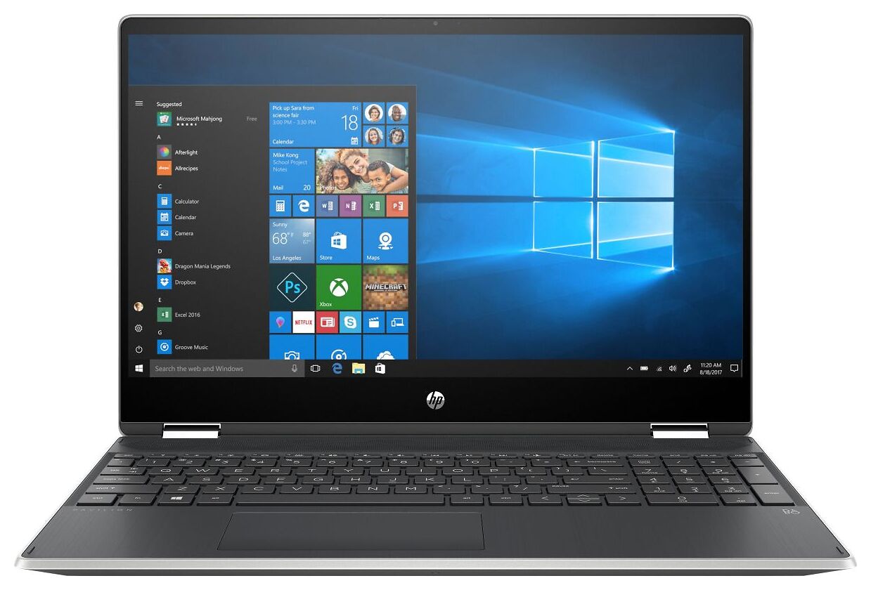

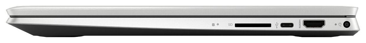

HP Pavilion x360 15-dq0805nz Hybrid (2-in-1) 15 Specification for Upgrade or Repair
    HP Pavilion x360 15-dq0805nz Hybrid (2-in-1) 15 Specification for Upgrade or Repair
    This specification for the HP Pavilion x360 15-dq0805nz Hybrid (2-in-1) can be useful for upgrading or repairing a laptop that is not working. As a community we are working through our specifications to add valuable data like the 15-dq0805nz boardview and 15-dq0805nz schematic. Our users have donated over 1 million documents which are being added to the site. This page will be updated soon with additional information. Alternatively you can request additional help from our users directly on the relevant badcaps forum. Please note that we offer no warranties that any specification, datasheet, or download for HP Pavilion x360 15-dq0805nz Hybrid (2-in-1) is accurate, safe, error free, or the fix you require.
    Design > Family: Pavilion x360
    Design > Model Name: 15-dq0805nz
    Design > Part Number: 6VJ28EA
    Design > Product Colour: Grey, Silver
    Design > Release Date: 20/03/2019
    Design > Series: 15
    Specification > Battery: 41 Wh
    Product Code: 6VJ28EA
    Battery > Quick Charge: Yes
    Performance > Electronic Compass: Yes
    Performance > Gyroscope: Yes
    HP Pavilion x360 15-dq0805nz Hybrid (2-in-1) 15 Specification for Upgrade or Repair
    HP Pavilion x360 Pavilion x360 - 15-dq0007na Hybrid (2-in-1) 15 Specification for Upgrade or Repair
    This specification for the HP Pavilion x360 Pavilion x360 - 15-dq0007na Hybrid (2-in-1) can be useful for upgrading or repairing a laptop that is not working. As a community we are working through our specifications to add valuable data like the Pavilion x360 - 15-dq0007na boardview and Pavilion x360 - 15-dq0007na schematic. Our users have donated over 1 million documents which are being added to the site. This page will be updated soon with additional information. Alternatively you can request additional help from our users directly on the relevant badcaps forum. Please note that we offer no...
    09-06-2024, 09:10 AM
    HP Pavilion x360 Pavilion x360 - 14-dh1000na Hybrid (2-in-1) 14 Specification for Upgrade or Repair
    This specification for the HP Pavilion x360 Pavilion x360 - 14-dh1000na Hybrid (2-in-1) can be useful for upgrading or repairing a laptop that is not working. As a community we are working through our specifications to add valuable data like the Pavilion x360 - 14-dh1000na boardview and Pavilion x360 - 14-dh1000na schematic. Our users have donated over 1 million documents which are being added to the site. This page will be updated soon with additional information. Alternatively you can request additional help from our users directly on the relevant badcaps forum. Please note that we offer no...
    09-06-2024, 03:30 PM
    HP Pavilion x360 Pavilion x360 14-cd0830nd Notebook 14 Specification for Upgrade or Repair
    This specification for the HP Pavilion x360 Pavilion x360 14-cd0830nd Notebook can be useful for upgrading or repairing a laptop that is not working. As a community we are working through our specifications to add valuable data like the Pavilion x360 14-cd0830nd boardview and Pavilion x360 14-cd0830nd schematic. Our users have donated over 1 million documents which are being added to the site. This page will be updated soon with additional information. Alternatively you can request additional help from our users directly on the relevant badcaps forum. Please note that we offer no warranties that...
    09-06-2024, 07:00 AM
    HP Pavilion x360 Pavilion x360 - 15-cr0011nr Hybrid (2-in-1) 15 Specification for Upgrade or Repair
    This specification for the HP Pavilion x360 Pavilion x360 - 15-cr0011nr Hybrid (2-in-1) can be useful for upgrading or repairing a laptop that is not working. As a community we are working through our specifications to add valuable data like the Pavilion x360 - 15-cr0011nr boardview and Pavilion x360 - 15-cr0011nr schematic. Our users have donated over 1 million documents which are being added to the site. This page will be updated soon with additional information. Alternatively you can request additional help from our users directly on the relevant badcaps forum. Please note that we offer no...
    09-06-2024, 06:51 AM
    HP Pavilion x360 Pavilion x360 14-cd0938nd Notebook 14 Specification for Upgrade or Repair
    This specification for the HP Pavilion x360 Pavilion x360 14-cd0938nd Notebook can be useful for upgrading or repairing a laptop that is not working. As a community we are working through our specifications to add valuable data like the Pavilion x360 14-cd0938nd boardview and Pavilion x360 14-cd0938nd schematic. Our users have donated over 1 million documents which are being added to the site. This page will be updated soon with additional information. Alternatively you can request additional help from our users directly on the relevant badcaps forum. Please note that we offer no warranties that...
    09-06-2024, 07:00 AM
