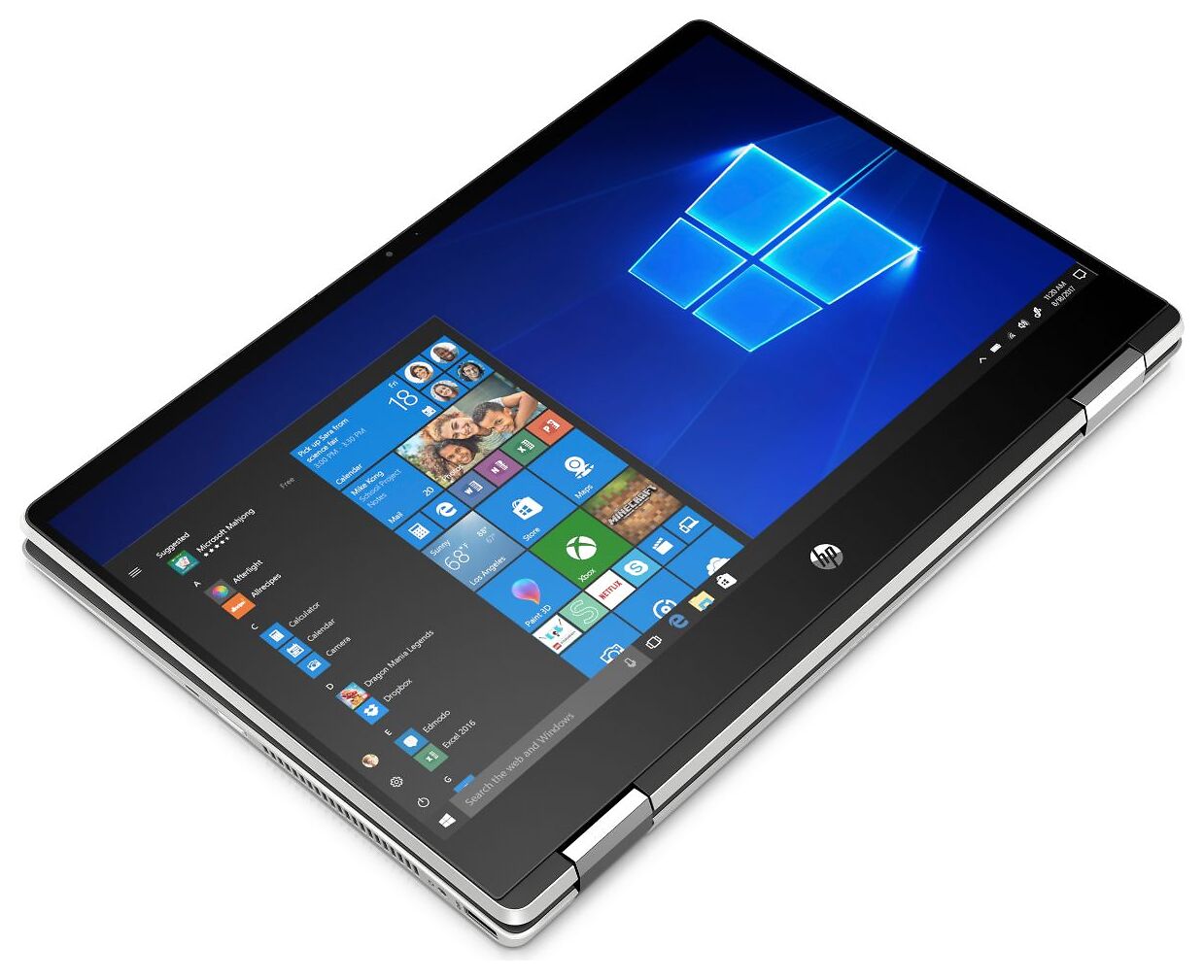

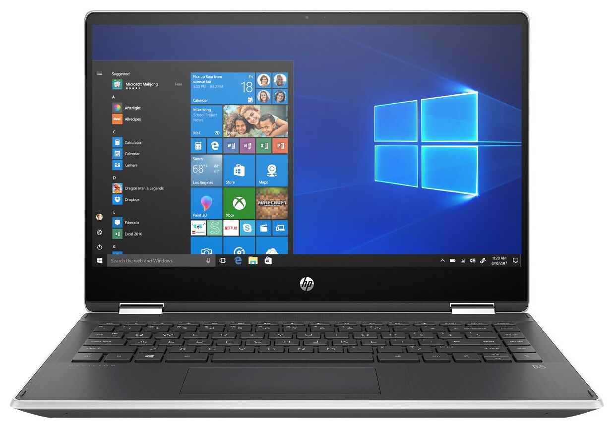

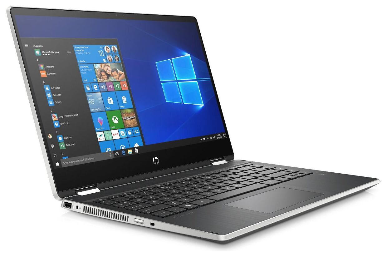

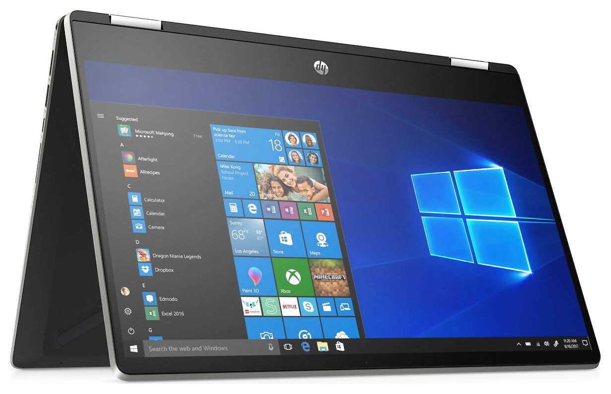

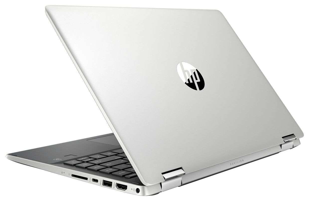

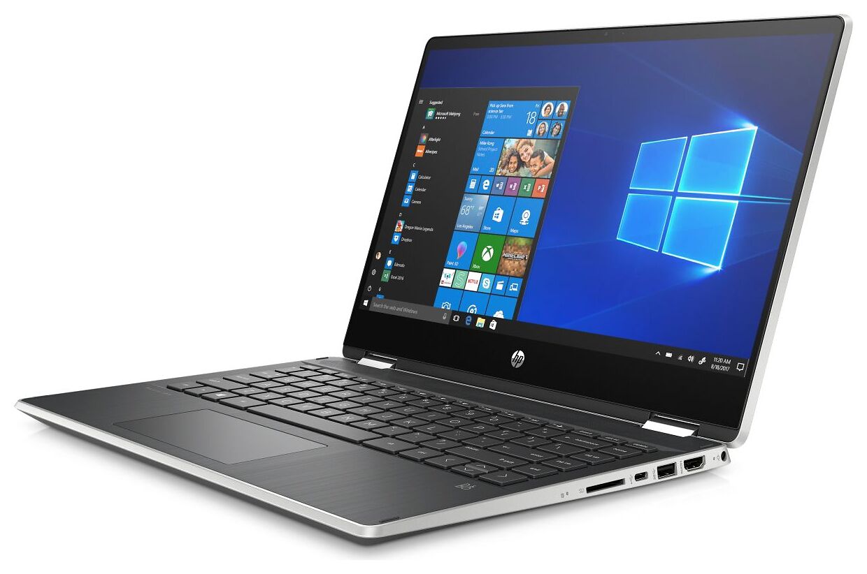

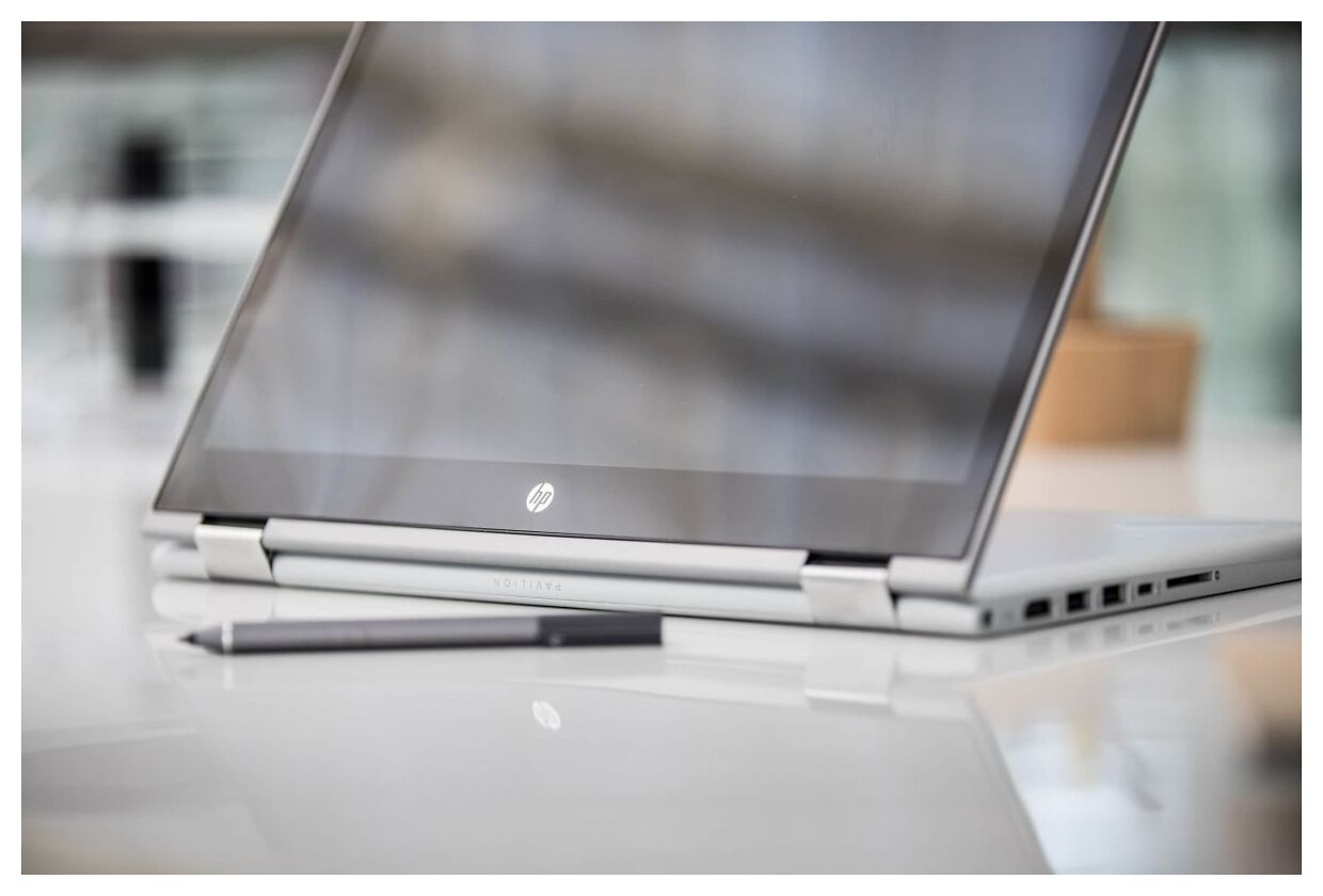

HP Pavilion x360 14-dh0005nf Hybrid (2-in-1) 14 Specification for Upgrade or Repair
    HP Pavilion x360 14-dh0005nf Hybrid (2-in-1) 14 Specification for Upgrade or Repair
    This specification for the HP Pavilion x360 14-dh0005nf Hybrid (2-in-1) can be useful for upgrading or repairing a laptop that is not working. As a community we are working through our specifications to add valuable data like the 14-dh0005nf boardview and 14-dh0005nf schematic. Our users have donated over 1 million documents which are being added to the site. This page will be updated soon with additional information. Alternatively you can request additional help from our users directly on the relevant badcaps forum. Please note that we offer no warranties that any specification, datasheet, or download for HP Pavilion x360 14-dh0005nf Hybrid (2-in-1) is accurate, safe, error free, or the fix you require.
    Design > Family: Pavilion x360
    Design > Model Name: 14-dh0005nf
    Design > Part Number: 6LK98EA
    Design > Release Date: 20/03/2019
    Design > Series: 14
    Display > HD Type: HD
    Display > Panel Type: SVA
    Specification > Battery: 41 Wh
    Specification > Weight: 1.59kg
    Product Code: 6LK98EA
    Battery > Quick Charge: Yes
    Networking > MIMO: Yes
    Networking > Miracast: Yes
    Networking > Wi-Fi Standards: Wi-Fi 5 (802.11ac), 802.11b, 802.11g, Wi-Fi 4 (802.11n)
    Performance > Electronic Compass: Yes
    Performance > Gyroscope: Yes
    Storage > SSD Capacity: 128GB
    Weight And Dimensions > Depth: 222.9mm
    Weight And Dimensions > Height: 20.5mm
    Weight And Dimensions > Weight: 1.59kg
    Weight And Dimensions > Width: 324mm
    HP Pavilion x360 14-dh0005nf Hybrid (2-in-1) 14 Specification for Upgrade or Repair
    HP Pavilion x360 Pavilion x360 - 15-dq0007na Hybrid (2-in-1) 15 Specification for Upgrade or Repair
    This specification for the HP Pavilion x360 Pavilion x360 - 15-dq0007na Hybrid (2-in-1) can be useful for upgrading or repairing a laptop that is not working. As a community we are working through our specifications to add valuable data like the Pavilion x360 - 15-dq0007na boardview and Pavilion x360 - 15-dq0007na schematic. Our users have donated over 1 million documents which are being added to the site. This page will be updated soon with additional information. Alternatively you can request additional help from our users directly on the relevant badcaps forum. Please note that we offer no...
    09-06-2024, 09:10 AM
    HP Pavilion x360 Pavilion x360 - 14-dh1000na Hybrid (2-in-1) 14 Specification for Upgrade or Repair
    This specification for the HP Pavilion x360 Pavilion x360 - 14-dh1000na Hybrid (2-in-1) can be useful for upgrading or repairing a laptop that is not working. As a community we are working through our specifications to add valuable data like the Pavilion x360 - 14-dh1000na boardview and Pavilion x360 - 14-dh1000na schematic. Our users have donated over 1 million documents which are being added to the site. This page will be updated soon with additional information. Alternatively you can request additional help from our users directly on the relevant badcaps forum. Please note that we offer no...
    09-06-2024, 03:30 PM
    HP Pavilion x360 Pavilion x360 - 15-cr0011nr Hybrid (2-in-1) 15 Specification for Upgrade or Repair
    This specification for the HP Pavilion x360 Pavilion x360 - 15-cr0011nr Hybrid (2-in-1) can be useful for upgrading or repairing a laptop that is not working. As a community we are working through our specifications to add valuable data like the Pavilion x360 - 15-cr0011nr boardview and Pavilion x360 - 15-cr0011nr schematic. Our users have donated over 1 million documents which are being added to the site. This page will be updated soon with additional information. Alternatively you can request additional help from our users directly on the relevant badcaps forum. Please note that we offer no...
    09-06-2024, 06:51 AM
    HP Pavilion x360 Pavilion x360 - 14-cd0999nf Hybrid (2-in-1) 14 Specification for Upgrade or Repair
    This specification for the HP Pavilion x360 Pavilion x360 - 14-cd0999nf Hybrid (2-in-1) can be useful for upgrading or repairing a laptop that is not working. As a community we are working through our specifications to add valuable data like the Pavilion x360 - 14-cd0999nf boardview and Pavilion x360 - 14-cd0999nf schematic. Our users have donated over 1 million documents which are being added to the site. This page will be updated soon with additional information. Alternatively you can request additional help from our users directly on the relevant badcaps forum. Please note that we offer no...
    09-06-2024, 07:07 AM
    HP Pavilion x360 Pavilion x360 - 15-dq1004na Hybrid (2-in-1) 15 Specification for Upgrade or Repair
    This specification for the HP Pavilion x360 Pavilion x360 - 15-dq1004na Hybrid (2-in-1) can be useful for upgrading or repairing a laptop that is not working. As a community we are working through our specifications to add valuable data like the Pavilion x360 - 15-dq1004na boardview and Pavilion x360 - 15-dq1004na schematic. Our users have donated over 1 million documents which are being added to the site. This page will be updated soon with additional information. Alternatively you can request additional help from our users directly on the relevant badcaps forum. Please note that we offer no...
    09-06-2024, 12:18 PM
