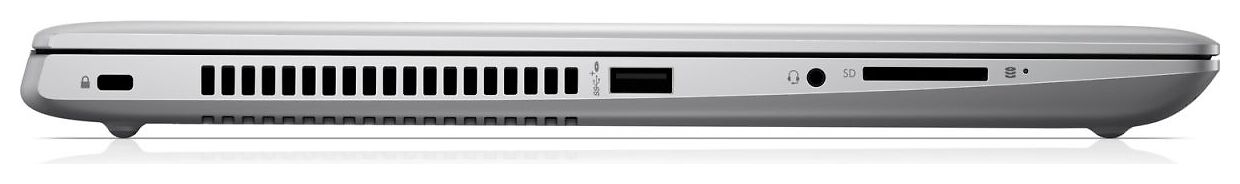

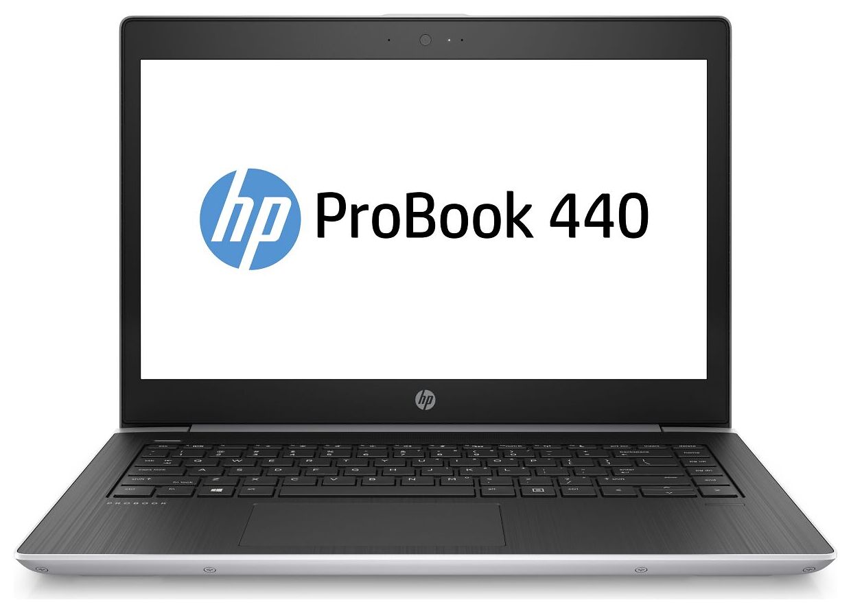

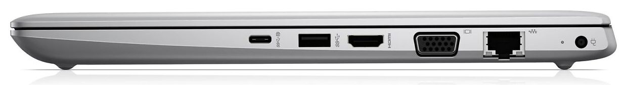

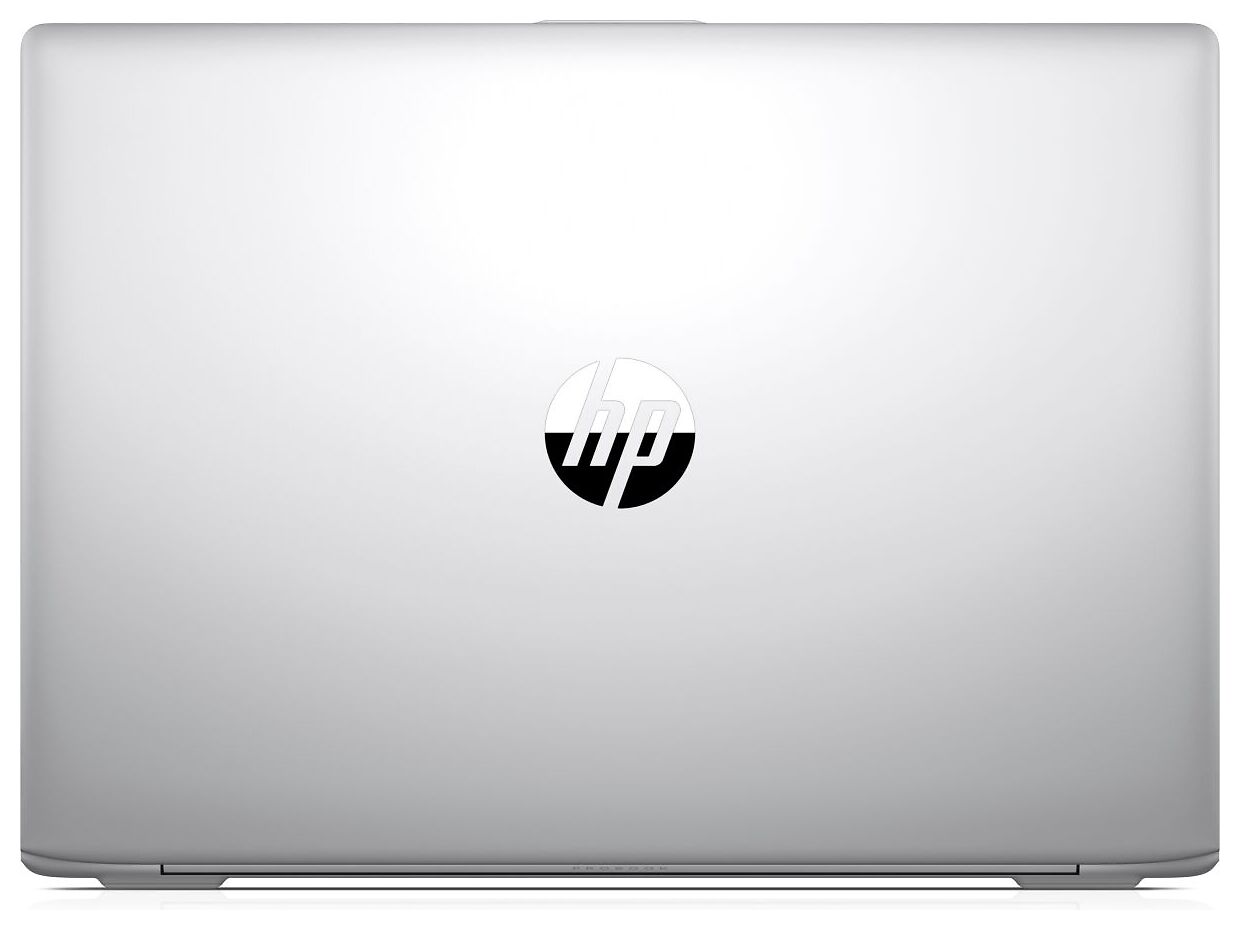

HP ProBook 440 G5 Notebook 400 Specification for Upgrade or Repair
    HP ProBook 440 G5 Notebook 400 Specification for Upgrade or Repair
    This specification for the HP ProBook 440 G5 Notebook can be useful for upgrading or repairing a laptop that is not working. As a community we are working through our specifications to add valuable data like the 440 G5 boardview and 440 G5 schematic. Our users have donated over 1 million documents which are being added to the site. This page will be updated soon with additional information. Alternatively you can request additional help from our users directly on the relevant badcaps forum. Please note that we offer no warranties that any specification, datasheet, or download for HP ProBook 440 G5 Notebook is accurate, safe, error free, or the fix you require.
    Design > Family: ProBook
    Design > Model Name: 440 G5
    Design > Part Number: 3DB71ELIFE2T
    Design > Release Date: 04/03/2019
    Design > Series: 400
    Specification > Weight: 1.63kg
    Product Code: 3DB71ELIFE2T
    S/PDIF Out Port: No
    Storage > HDD Interface: SATA
    Storage > HDD Size: 2.5"
    Storage > HDD Speed: 5400RPM
    Storage > Storage Media: HDD
    Weight And Dimensions > Depth: 238mm
    Weight And Dimensions > Height: 20mm
    Weight And Dimensions > Weight: 1.63kg
    Weight And Dimensions > Width: 336mm
    HP ProBook 440 G5 Notebook 400 Specification for Upgrade or Repair
    HP ProBook 450 G5 + Casio G-SHOCK Notebook 400 Specification for Upgrade or Repair
    This specification for the HP ProBook 450 G5 + Casio G-SHOCK Notebook can be useful for upgrading or repairing a laptop that is not working. As a community we are working through our specifications to add valuable data like the 450 G5 + Casio G-SHOCK boardview and 450 G5 + Casio G-SHOCK schematic. Our users have donated over 1 million documents which are being added to the site. This page will be updated soon with additional information. Alternatively you can request additional help from our users directly on the relevant badcaps forum. Please note that we offer no warranties that any specification,...
    09-06-2024, 08:16 AM
    HP ProBook 450 G5 + LaserJet Pro M15w Notebook 400 Specification for Upgrade or Repair
    This specification for the HP ProBook 450 G5 + LaserJet Pro M15w Notebook can be useful for upgrading or repairing a laptop that is not working. As a community we are working through our specifications to add valuable data like the 450 G5 + LaserJet Pro M15w boardview and 450 G5 + LaserJet Pro M15w schematic. Our users have donated over 1 million documents which are being added to the site. This page will be updated soon with additional information. Alternatively you can request additional help from our users directly on the relevant badcaps forum. Please note that we offer no warranties that...
    09-06-2024, 08:16 AM
    HP ProBook 470 G5 Notebook 400 Specification for Upgrade or Repair
    This specification for the HP ProBook 470 G5 Notebook can be useful for upgrading or repairing a laptop that is not working. As a community we are working through our specifications to add valuable data like the 470 G5 boardview and 470 G5 schematic. Our users have donated over 1 million documents which are being added to the site. This page will be updated soon with additional information. Alternatively you can request additional help from our users directly on the relevant badcaps forum. Please note that we offer no warranties that any specification, datasheet, or download for HP ProBook 470...
    09-06-2024, 06:06 AM
    HP ProBook 450 G5 + 3 year NBD Onsite Warranty Notebook 400 Specification for Upgrade or Repair
    This specification for the HP ProBook 450 G5 + 3 year NBD Onsite Warranty Notebook can be useful for upgrading or repairing a laptop that is not working. As a community we are working through our specifications to add valuable data like the 450 G5 + 3 year NBD Onsite Warranty boardview and 450 G5 + 3 year NBD Onsite Warranty schematic. Our users have donated over 1 million documents which are being added to the site. This page will be updated soon with additional information. Alternatively you can request additional help from our users directly on the relevant badcaps forum. Please note that we...
    09-06-2024, 07:30 AM
    HP ProBook 470 G4 + VH240a Notebook 400 Specification for Upgrade or Repair
    This specification for the HP ProBook 470 G4 + VH240a Notebook can be useful for upgrading or repairing a laptop that is not working. As a community we are working through our specifications to add valuable data like the 470 G4 + VH240a boardview and 470 G4 + VH240a schematic. Our users have donated over 1 million documents which are being added to the site. This page will be updated soon with additional information. Alternatively you can request additional help from our users directly on the relevant badcaps forum. Please note that we offer no warranties that any specification, datasheet, or...
    09-06-2024, 06:08 AM
