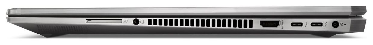

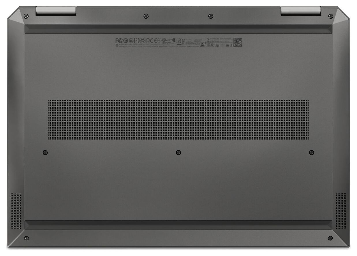

HP ZBook Studio x360 G5 Mobile workstation Studio x360 Specification for Upgrade or Repair
    HP ZBook Studio x360 G5 Mobile workstation Studio x360 Specification for Upgrade or Repair
    This specification for the HP ZBook Studio x360 G5 Mobile workstation can be useful for upgrading or repairing a laptop that is not working. As a community we are working through our specifications to add valuable data like the Studio x360 G5 boardview and Studio x360 G5 schematic. Our users have donated over 1 million documents which are being added to the site. This page will be updated soon with additional information. Alternatively you can request additional help from our users directly on the relevant badcaps forum. Please note that we offer no warranties that any specification, datasheet, or download for HP ZBook Studio x360 G5 Mobile workstation is accurate, safe, error free, or the fix you require.
    Design > EAN/UPC Code: 0193808568732, 193808568732, 0193808569111, 193808569111, 0193808569234, 193808569234, 0193808569227, 193808569227, 0193808569029, 193808569029, 0193808569067, 193808569067, 0193808569166, 193808569166, 0193808569210, 193808569210, 0193808803338, 193808803338, 0193808569005, 193808569005, 0193808569128, 193808569128, 0193808569173, 193808569173, 0193808569012, 193808569012, 0193808569050, 193808569050, 0193808569104, 193808569104, 0193808569524, 193808569524, 0193808569159, 193808569159, 0193808569197, 193808569197, 0193808569203, 193808569203, 0193808569241, 193808569241, 0193808569258, 193808569258, 0193808568992, 193808568992, 0193808569081, 193808569081, 0193808569135, 193808569135, 0193808569180, 193808569180, 0193808569074, 193808569074
    Design > Family: ZBook
    Design > Model Name: Studio x360 G5
    Design > Part Number: 5UC45EA
    Design > Release Date: 01/03/2019
    Design > Series: Studio x360
    Graphics > Discrete Graphics Adapter Model: NVIDIA Quadro P1000
    Graphics > Discrete Graphics Card Model: NVIDIA Quadro P1000
    Specification > Battery: 95.6 Wh
    Specification > Weight: 2.26kg
    Memory > ECC: No
    Product Code: 5UC45EA
    Battery > Battery Capacity: 95.6 Wh
    Battery > Battery Capacity (Watt Hours): 95.6Wh
    Brand-specific Features > HP Security Tools: HP Device Access Manager, HP FingerPrint Sensor, HP Password Manager, HP Power On Authentication, HP Security Manager, HP Sure Click, HP BIOS Config Utility (BCU), HP Client Catalog, HP Driver Packs, HP System Software Manager (SSM), HP Manageability Integration Kit Gen2, HP BIOSphere with Sure Start Gen4, HP Secure Disk Erase, HP Host Based Mac Address
    Brand-specific Features > HP Software Provided: HP Clear Sound Amp
    Weight And Dimensions > Height: 20.4mm
    Weight And Dimensions > Height (front): 8.8mm
    Weight And Dimensions > Height (rear): 1.87 cm
    Weight And Dimensions > Weight: 2.26kg
    HP ZBook Studio x360 G5 Mobile workstation Studio x360 Specification for Upgrade or Repair
    HP ZBook Studio x360 G5 Mobile workstation Studio x360 Specification for Upgrade or Repair
    This specification for the HP ZBook Studio x360 G5 Mobile workstation can be useful for upgrading or repairing a laptop that is not working. As a community we are working through our specifications to add valuable data like the Studio x360 G5 boardview and Studio x360 G5 schematic. Our users have donated over 1 million documents which are being added to the site. This page will be updated soon with additional information. Alternatively you can request additional help from our users directly on the relevant badcaps forum. Please note that we offer no warranties that any specification, datasheet,...
    09-06-2024, 06:58 AM
    HP ZBook Studio x360 G5 Mobile workstation Studio x360 Specification for Upgrade or Repair
    This specification for the HP ZBook Studio x360 G5 Mobile workstation can be useful for upgrading or repairing a laptop that is not working. As a community we are working through our specifications to add valuable data like the Studio x360 G5 boardview and Studio x360 G5 schematic. Our users have donated over 1 million documents which are being added to the site. This page will be updated soon with additional information. Alternatively you can request additional help from our users directly on the relevant badcaps forum. Please note that we offer no warranties that any specification, datasheet,...
    09-06-2024, 08:23 AM
    HP ZBook Studio x360 G5 Mobile workstation Studio x360 Specification for Upgrade or Repair
    This specification for the HP ZBook Studio x360 G5 Mobile workstation can be useful for upgrading or repairing a laptop that is not working. As a community we are working through our specifications to add valuable data like the Studio x360 G5 boardview and Studio x360 G5 schematic. Our users have donated over 1 million documents which are being added to the site. This page will be updated soon with additional information. Alternatively you can request additional help from our users directly on the relevant badcaps forum. Please note that we offer no warranties that any specification, datasheet,...
    09-06-2024, 07:05 AM
    HP ZBook Studio x360 G5 Mobile workstation Studio x360 Specification for Upgrade or Repair
    This specification for the HP ZBook Studio x360 G5 Mobile workstation can be useful for upgrading or repairing a laptop that is not working. As a community we are working through our specifications to add valuable data like the Studio x360 G5 boardview and Studio x360 G5 schematic. Our users have donated over 1 million documents which are being added to the site. This page will be updated soon with additional information. Alternatively you can request additional help from our users directly on the relevant badcaps forum. Please note that we offer no warranties that any specification, datasheet,...
    09-06-2024, 09:37 AM
    HP ZBook Studio x360 G5 Mobile workstation Studio x360 Specification for Upgrade or Repair
    This specification for the HP ZBook Studio x360 G5 Mobile workstation can be useful for upgrading or repairing a laptop that is not working. As a community we are working through our specifications to add valuable data like the Studio x360 G5 boardview and Studio x360 G5 schematic. Our users have donated over 1 million documents which are being added to the site. This page will be updated soon with additional information. Alternatively you can request additional help from our users directly on the relevant badcaps forum. Please note that we offer no warranties that any specification, datasheet,...
    09-06-2024, 09:37 AM
